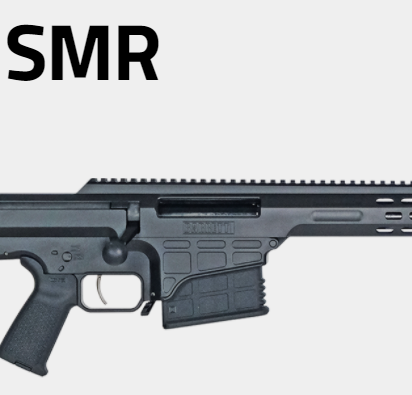

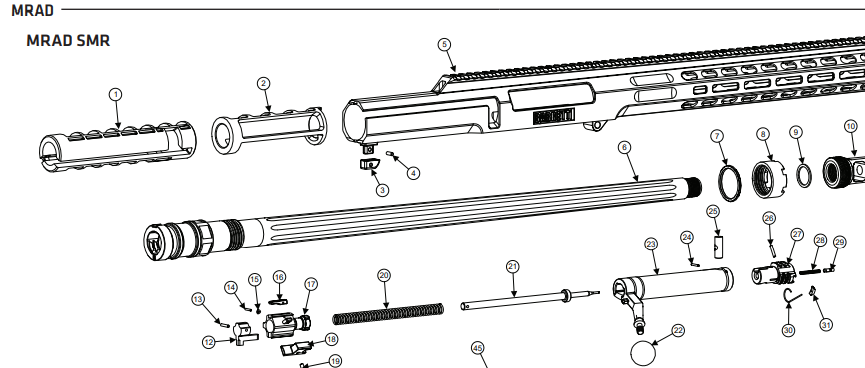

Here is your answer @OrDad From their own website: no bolts for barrel conversion, The Single Mission Rifle name comes from the fact that the rifle is set from the factory in only one caliber, unlike the interchangeable barrel ability of the standard MRAD. The primary distinction of the SMR is the free float barrel which is held in the upper receiver with a standard barrel nut. Source: https://barrett.net/products/firearms/mrad-smr/

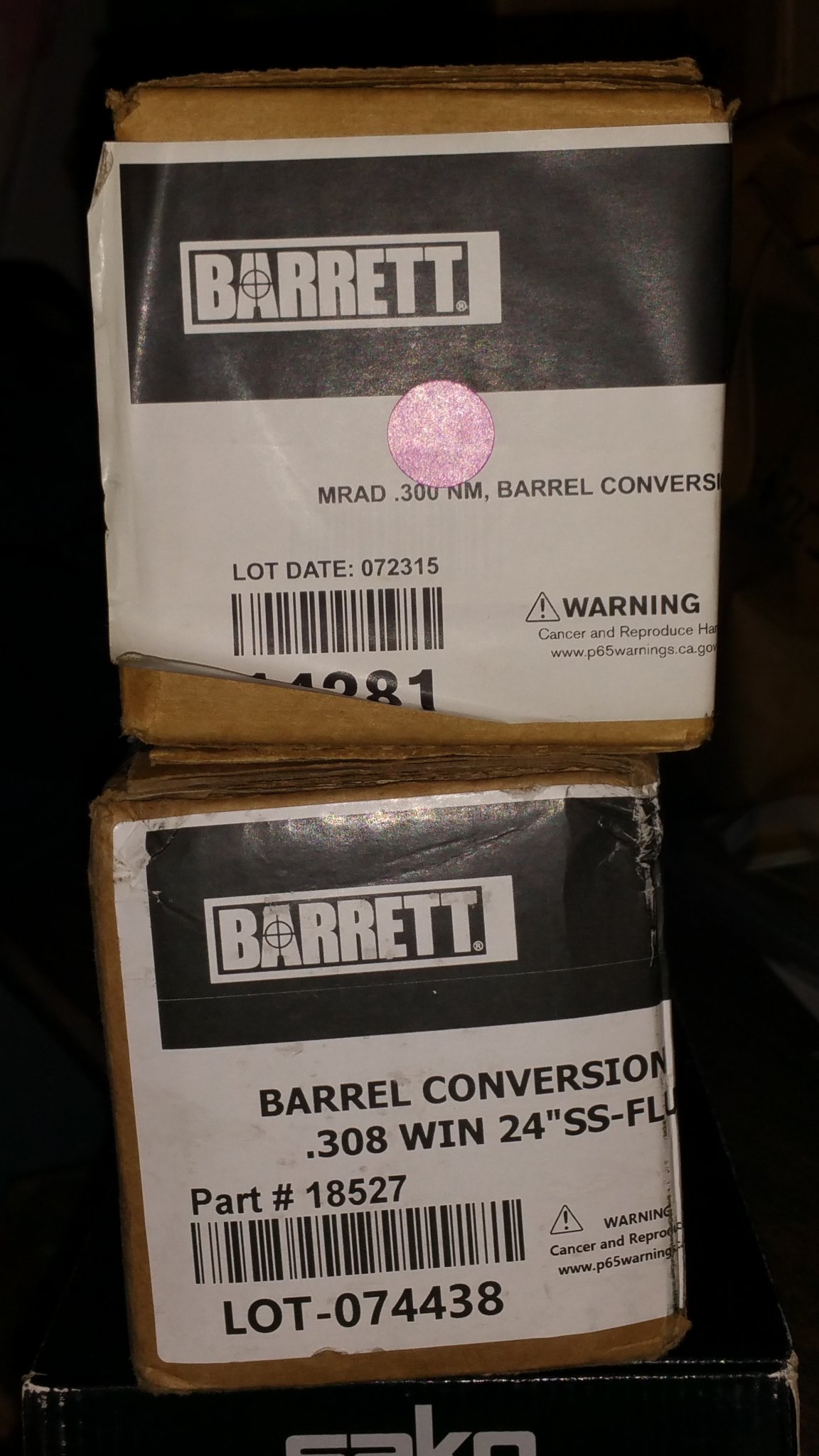

Selling my .308-Win Barrel Conversion Kit (24" SS Fluted) on GunBroker ... starting at $995. Only 50-ish rounds through it. Need to generate funds for something else I want. Wife says "No new unfunded gun stuff" ... and given my history, she's righteous to say that. FYI ... in case anyone is interested. Don't weep for my loss ... I have four other barrels I'm all shooting regularly. It was either buy all the reloading crap at ridiculous prices and shoot it more often, or sell it and use the money for other stuff I need (aka: "want").

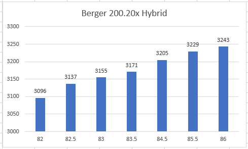

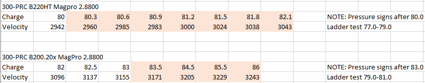

I'm still working it, but I'm close. My first ladder tests were too lightly charged and didn't have the velocity I was looking for. I bumped that up and my next ladder tests showed early pressure signs (heavy bolt, ejector swipes, etc.). I've got two "tweener" tests loaded for the next nice weather day, and I expect them to be fairly revelatory. They are:
  • 300-PRC MRAD, Hornady 1x-fired, Berger 220-HT, Accurate MagPro, Charged 77.2 to 79.0 in 0.3 increments
  • 300-PRC MRAD, Hornady 1x-fired, Berger 200.20x-H, Accurate MagPro, Charged 79.2 to 81.0 in 0.3 increments
I'll be looking for velocity flat-spots to do some final group testing within these ranges.
Previously I saw the start of pressure signs above 80.0 on the Berger 220's, and pressure above 83.0 on the Berger 200's (tables below).
I really liked the look of the velocity curve on the 200.20x Bergers (bar chart below), but the pressure was just too high. Still working it, but that's where I am so far.

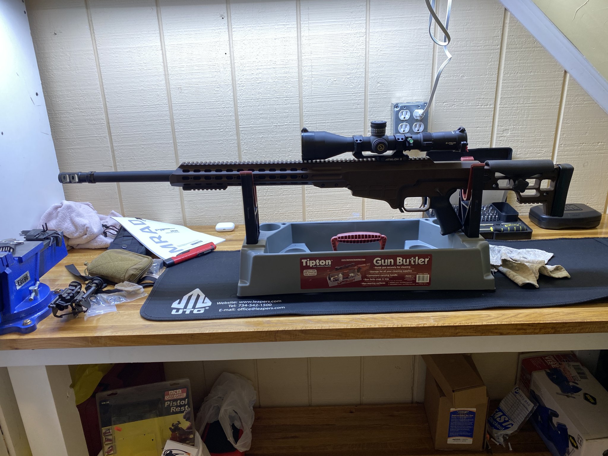

A little job I did yesterday. Adding M-Lok slots to an MRAD.
That looks cool as hell...
Can I trade you the rifle for the machine? I mean, I'll let you use it anytime you want...
Seriously, can't wait to get it in hand, it's pretty obvious your attention to detail I think and I appreciate that.
I'll be sure to show it off here in full regalia when I get it back too.

Can anyone definitively confirm that an MRAD SMR cannot support either a barrel conversion to a different barrel or that a custom barrel cannot be installed to support a different caliber (i.e .308 to 300 Norma)? Thank you much!
You might want to call or email Barrett and ask about the barrel maker to see if it will work on the smr:
The barrel makers kit will not work on the SMR. Post #1409 addresses that guys question.
The SMR is for guys that can make do with the fixed barrel and non-folding stock.
I'm sure it has it's benefits but the drawbacks are obvious. It really comes down to what you plan on doing with it.
I might need that done to mine if I don’t sell it, wggats that job run? Barrett said they would recoat the rifle for $350 I used to want it in ODG.
I don't have the price completed yet but the initial estimate was less than that and combined with the machine work it really made it a no-brainer. The estimate was very reasonable. And as you can see, the work to make those slots went lickety split, for sure took more time to upload the program than it did to cut it out.

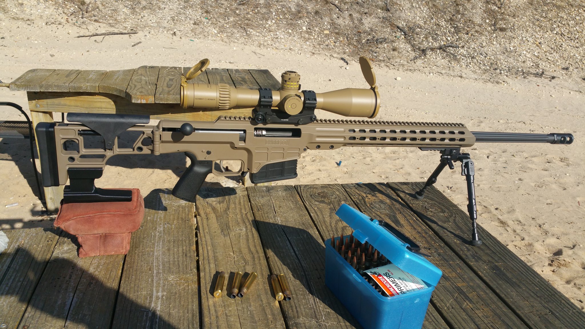

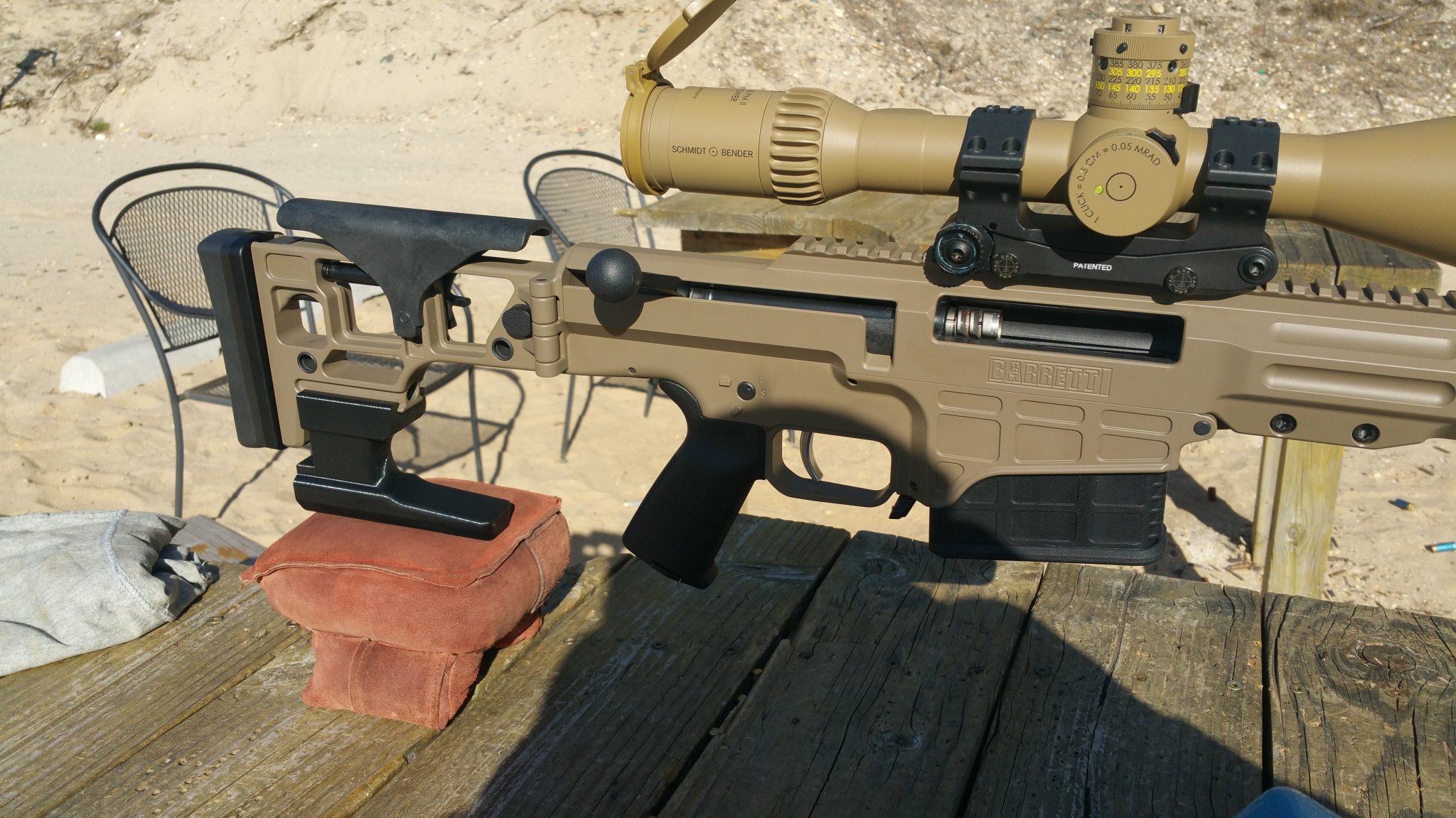

Finally got out to the range today, been 2 months... Snow and Work... yuck!

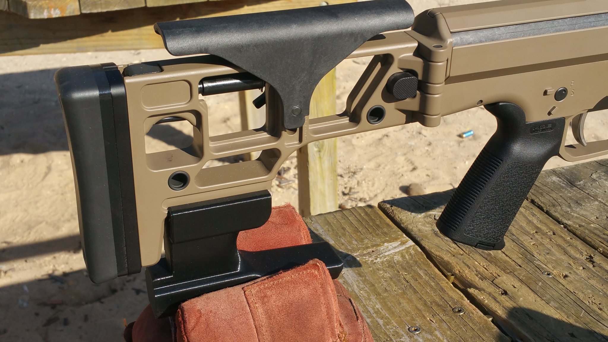

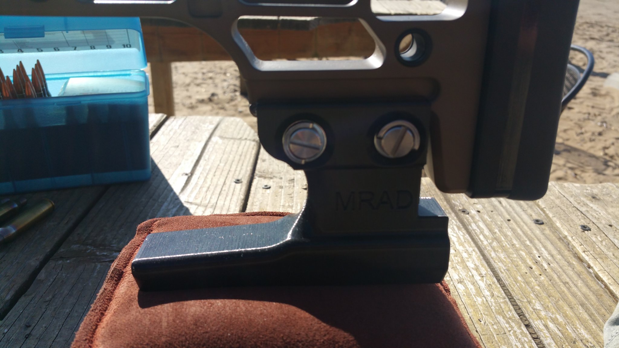

Got a new bag rider from pfl338 to try out on the MRAD, this new design is way better then the first one I got from him. Fully fits the butt stock rail.
Got a new 308 barrel for it too. Only had about 30 mins @ the range before they closed, no time to test it :(
