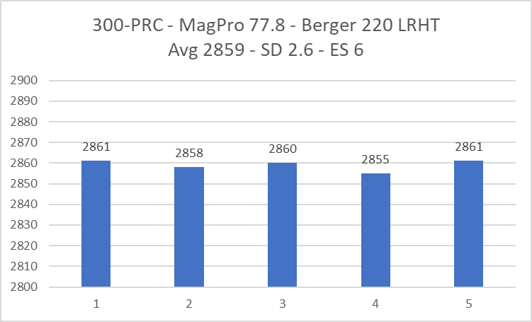

AWESOME ... I'm getting really close to a reference load on my 300-PRC barrel. Might even be there. Here are the results of my last test at 100 yards ... with all five rounds pretty much in the same hole. Now it's time to shoot out to 1000 or so and true up the BC. Might also load up some around 78.2 and see if I can coax it over 2900 fps . I just need a nice shooting day from Mother Nature ... who seems a little pissed off right now.

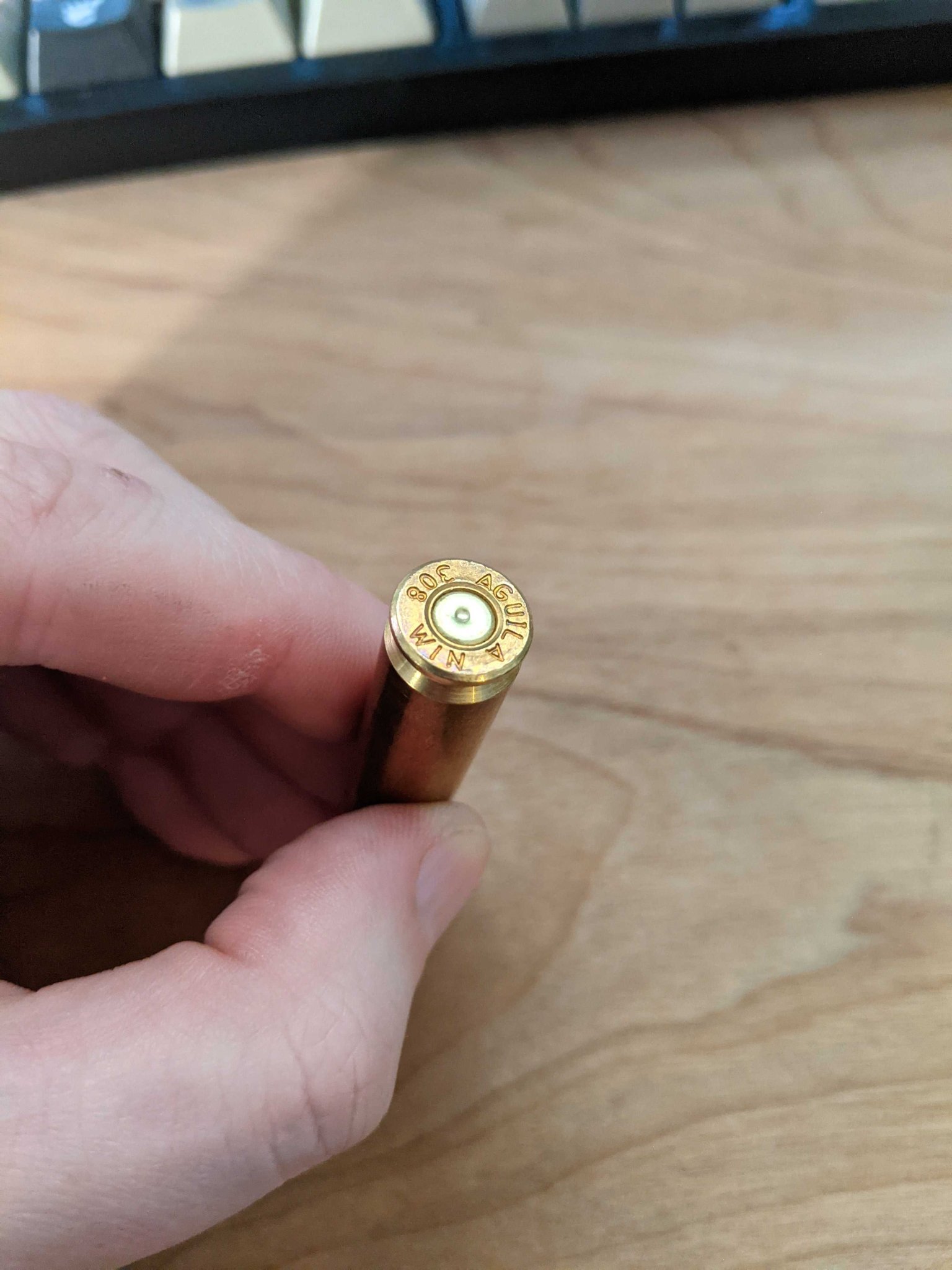

So I went out to shoot the MRAD today with some new ammo and out of the first box of 20 I had 10 misfires. Does this look like its failing to hit hard enough? If so is there anything on the MRAD I could check for? I shot one round out of the second box and it misfired as well. I have no other ammo to try right now but the last stuff I had there were no issues.
Check that your barrel is seated and screws are tight. What brand, mfg, ammo etc can you provide?
That definitely looks like a light primer strike or that the case is too far forward from the bolt head.
Also check that the firing pin is not hanging up in grease, packing debris, whatever. I don't think anyone ships guns with 'grease' in them any more. But once upon a time...
The advice about barrel setback is probably good.
That was my thought. Loosen the two barrel set screws, pull out the barrel, orient it correctly (notch up) when it goes back in, and seat it against the closed bolt to set the headspace. If it's still not hitting the primers solidly, get some other factory ammo and try. If still has problems, definitely call Barrett. Their CS has been really good to me over the past three MRAD-years.

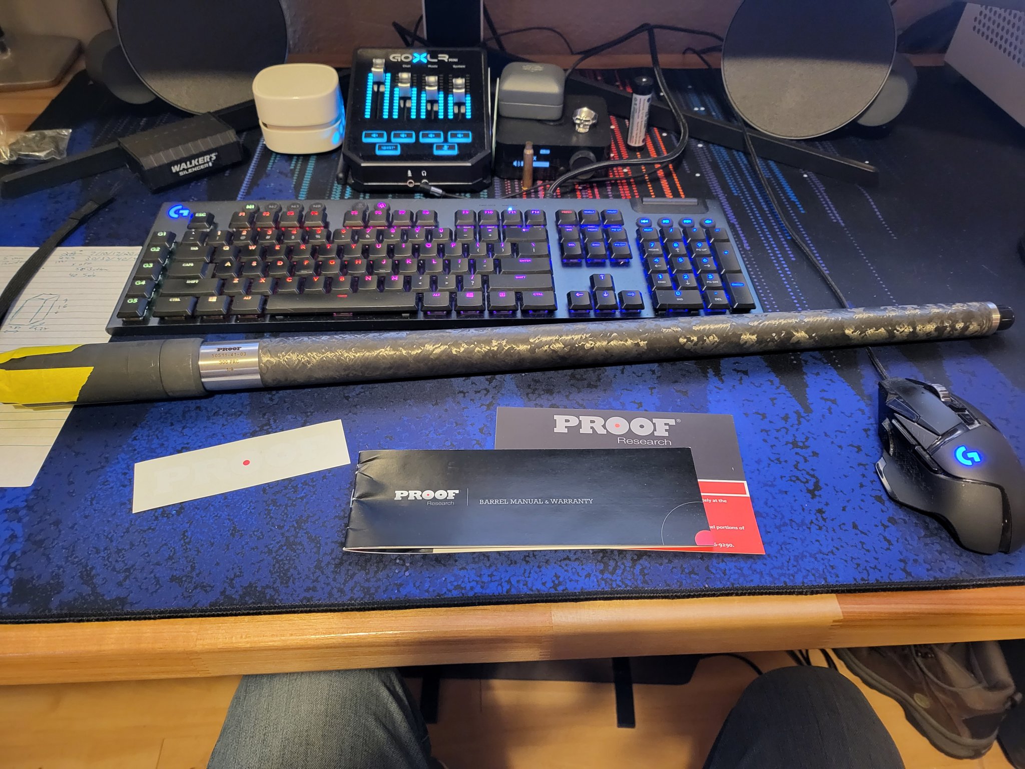

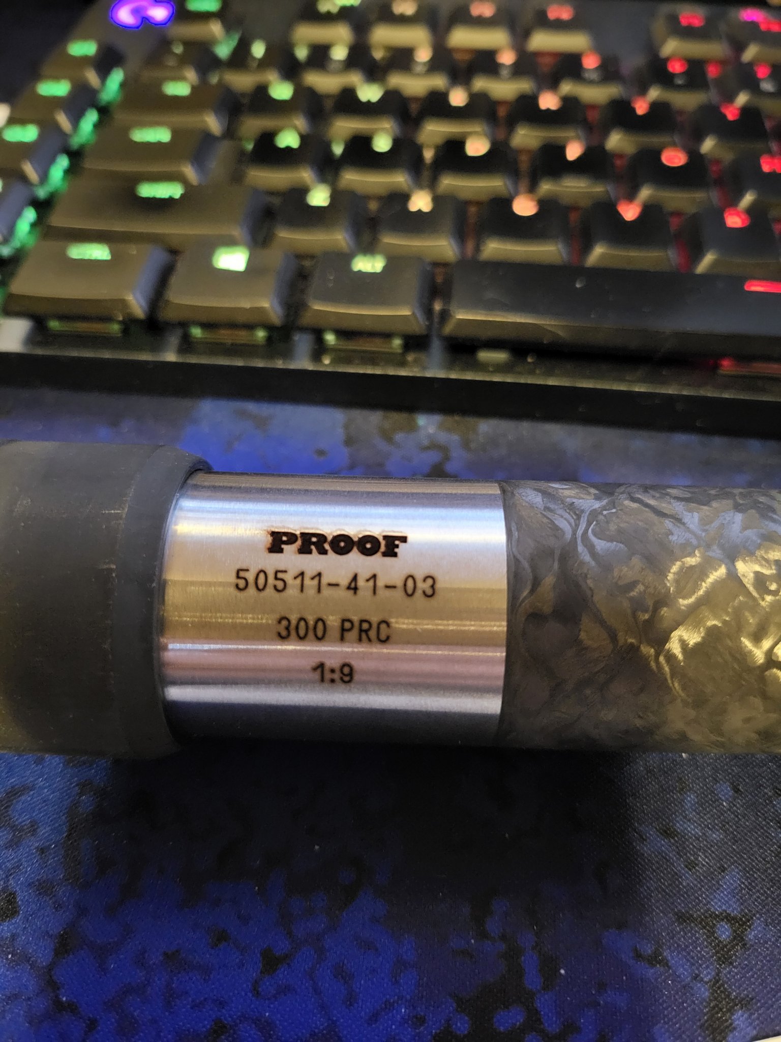

Proof Research does the full build still need to order a B magazine.

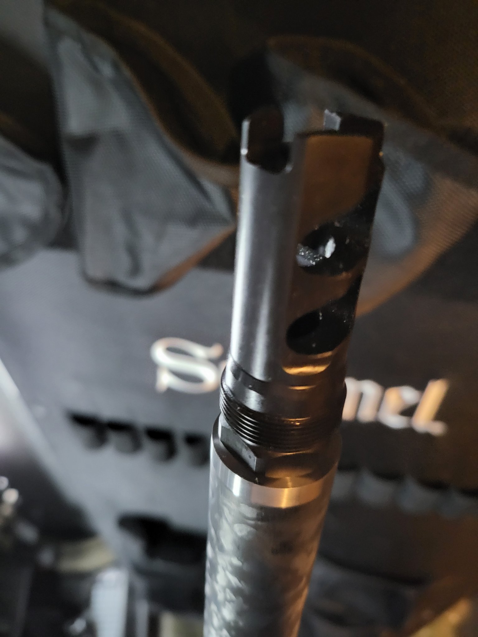

Yeah the brake is by Rearden and works with all my suppressors. I rarely shoot unsuppressed now and days. My 6.5CM has the same brake so it works for the dedicated can for the MRAD.
As fair as weight I havent been able to find what the steel Barrett version is in weight. Proof says the 26" is 5lbs 3oz. But my 6.5CM 24" barrel is 6lbs 10oz
