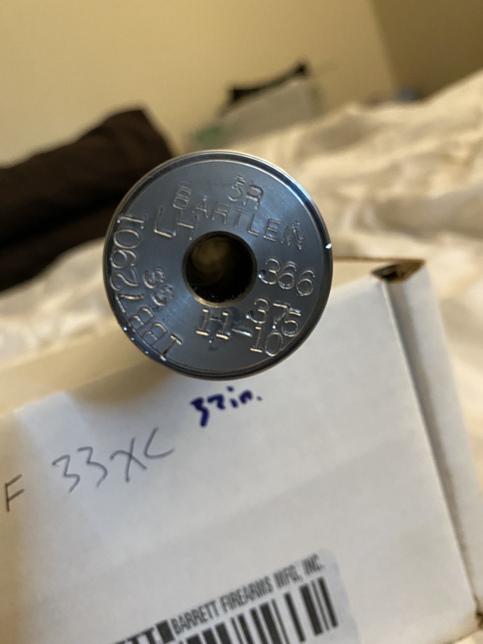

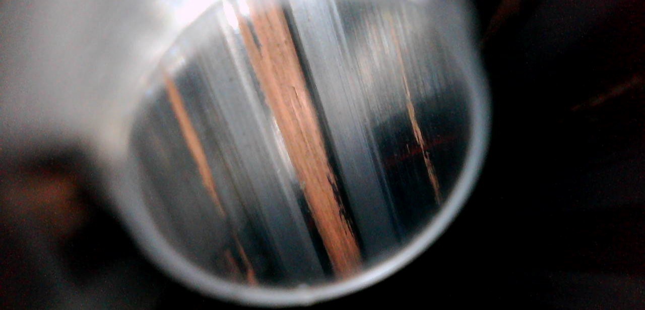

Maybe you can help me. Today I received a .338 Lapua MRAD barrel direct from Barrett. I haven't fired it yet. I scoped the barrel and found these rust colored streaks from the muzzle back about 9 inches. I went through 5 cleaning cycles with a mild solvent and the patches came out clean. The substance remains. Do you think it's rust? It looks the same as it did prior to cleaning.
I would contact Barrett
Shoot it! I doubt it’s rust. They come in those vacuum sealed bags. Kinda looks like copper. Shoot it, if it doesn’t shoot we’ll give Barrett a call.

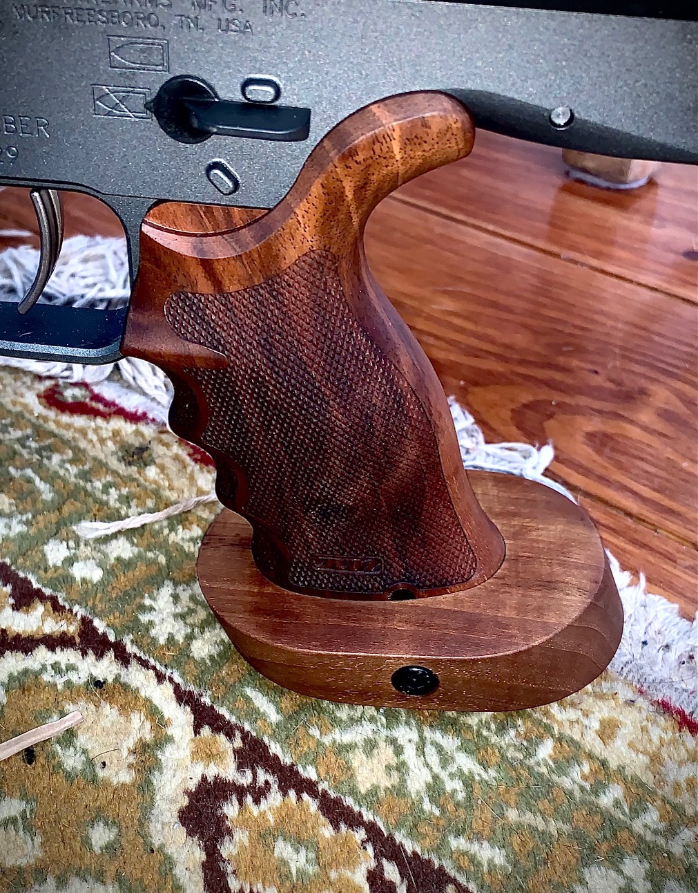

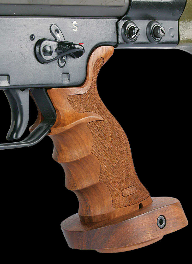

Company in Germany makes this for an AR frame... fits the MRAD. It's spendy. Probably delicate and probably wildly impractical. But I love Palm-rest grips and have on a couple of other rifles. And they are amazing with a bag. I think this is going to be my Christmas Present to myself... Meh... $300 is like an afternoon on the range. What the heck. Wood on a black rifle always looks classy!
That full-length/partial tripod rail posted above also looks like a worthy accessory.
Cheers,
Sirhr

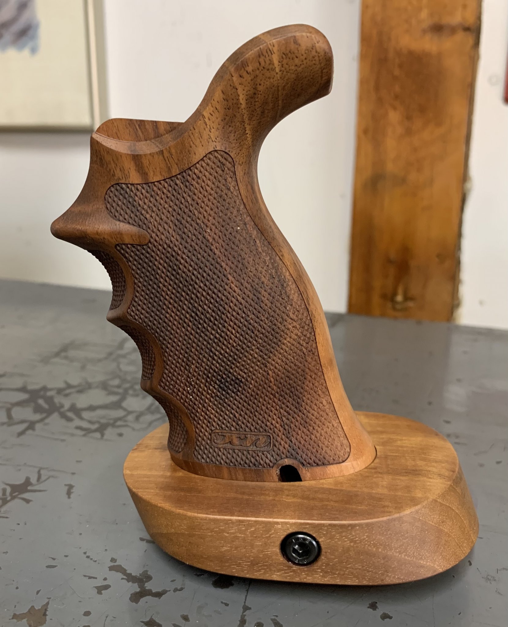

Need to do a bit of Woodworking Saturday to get it on the MRAD trigger guard. But it will fit.
Those Germans sure know how to make some nice stuff!!! Pix Sat when I get it all fitted!

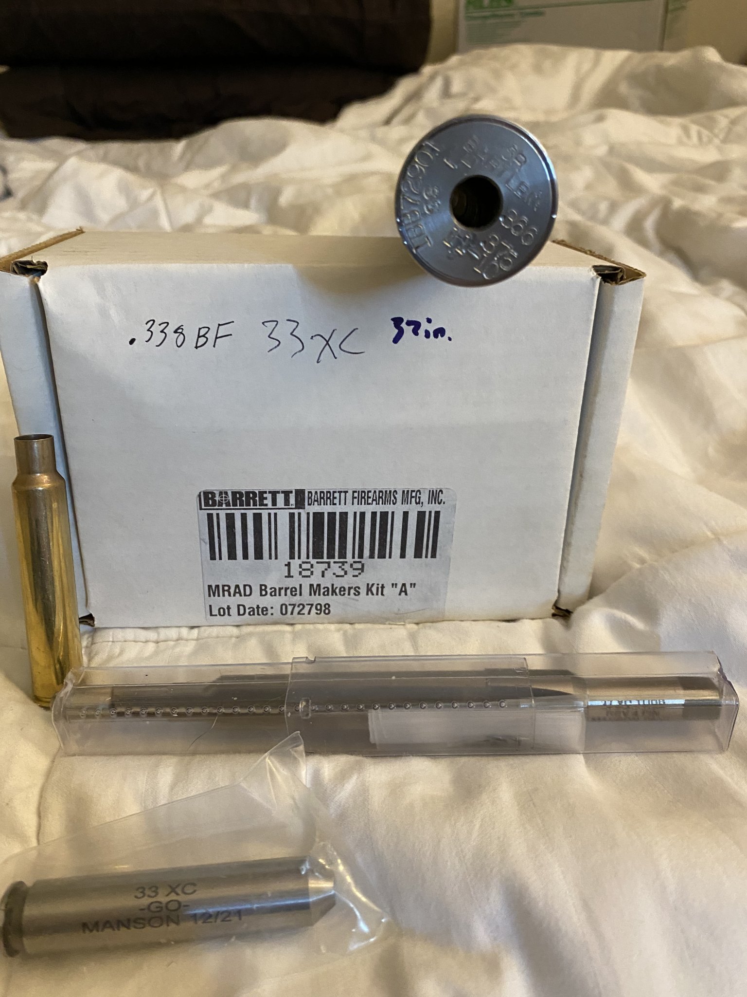

Yea, you can do it. You have to single feed though. Working on it right now myself. Bartlein 32inch 37xc mod BB left hand, gain twist 1/11 to 1/10. I have a ton of sierra .375's from when I played with a cheyatc improved- recoil was not pleasant with 144 grains of powder.
Edited to add- there is a good thread somewhere on the net where Ryan Pierce has a lot of experience with 33xc for hunting but by 300 rounds said he was losing .25 inch of rifling every 100rounds or something to that effect. I have a barrel and another extension in 338 and was planning on doing a 33xc also but i think i might stick with lapua for that for the longer barrel life.

Bugholes is spinning me up a 33XC 30" Bartlein ModBB when the Maker's kit arrives in mid-March. In response to the barrel burner post above, folks just can't help themselves when it comes to wringing out every last bit of velocity out of their barrel. I plan on NOT running right to the ragged edge on velocity when developing the load.
As a side note, I called Barrett and asked them about running my AM338 can with an extra 400-500 fps over 338LM. Their response was "no problem". The 275gr Badlands solids I have planned should run about 20-30% higher ft-lbs than the 338LM so not much of an extra burden on the platform. I also have (200) 285gr Warner Flatlines to play with.
Not sure I would be comfortable with the 37 or 41XC in the Barrett. There is a 2-inch portion of the maker's kit machining that is 1.1". That puts the chamber wall for the .585 bolt face at 0.2575". I read somewhere it should be minimum of 0.30". I am headed to Texas in mid-April for 2 days of one-on-one ELR training with Chase Stroud. Depending on how that goes, I would like to do a dedicated 41xc build using a 1.35" barrel and corresponding action.

33xc is about a half-inch longer than 338LM case. You can single feed all day long. I've read you have to break the action and remove the bolt to eject an unfired round but I will find out for sure soon.

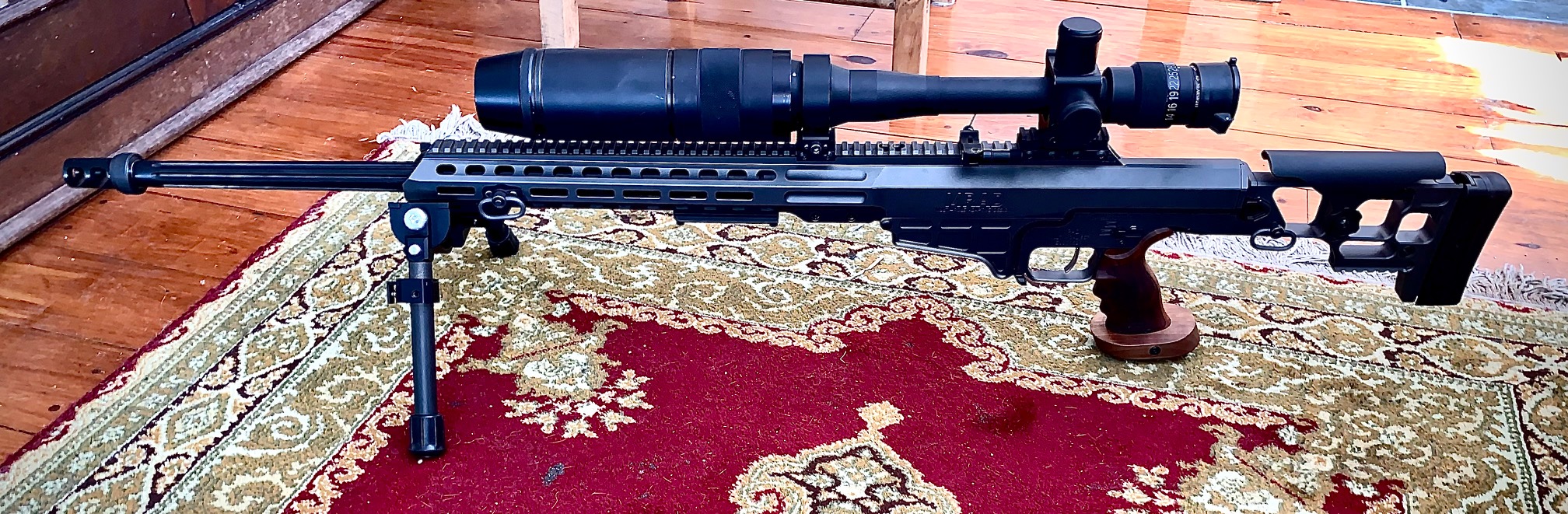

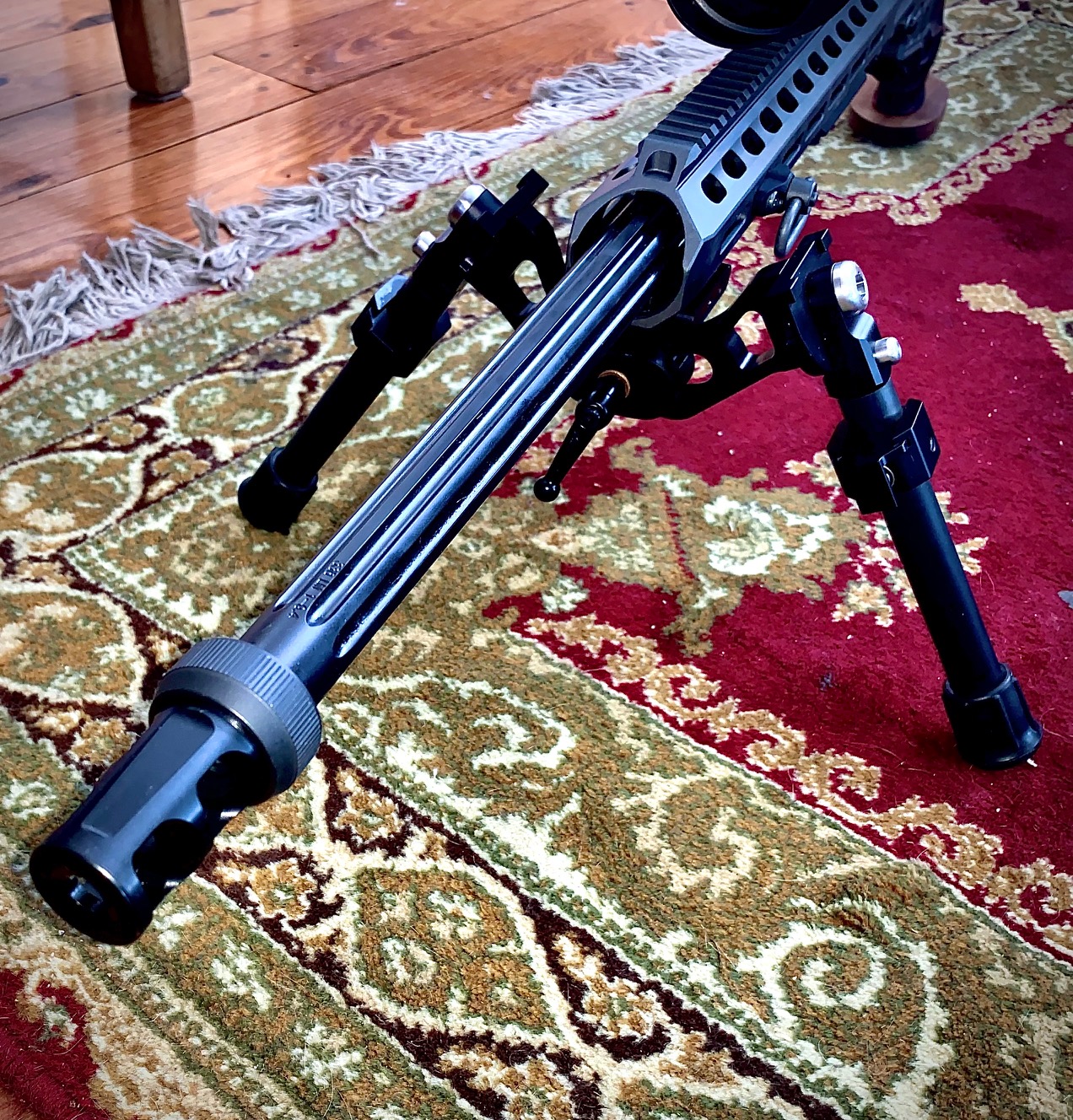

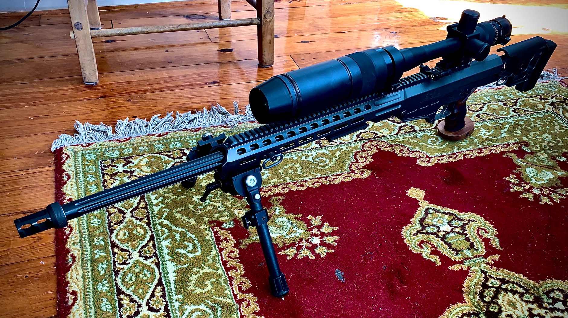

Finally after weeks of pulling parts together, my MRAD is ready to go!
.338 (working on getting a .300 NM barrel done). USO SN-9 scope... external adjustable. LRA bipod. And a Karl Nill Grip from Germany. It's actually an AR-15 grip and required some minor inletting/fitting. But only took about an hour and it's beautiful! I have some pictures in the Metalworking and Woodworking for Guns thread showing the fitting if anyone wants to use the PSG-1 style grip. It is dead nuts comfortable!
Now if spring would just get here! Meh, not long now!

Fireforming rounds all loaded up... some top notch solid bullets ready to load after that! Did I mention... winter sucks?
Well, off to my next project while I wait for a chance to really wring this one out!

oops, I didn't realize it was an AR15 grip.. I thought you had to do some wood working to get it on there. (y)
I just pulled the PDF
MRAD PDF
Post 177. Shows the process. It's an AR-15 grip, but the MRAD is slightly different in the trigger guard. So very slight woodworking and it fits like a glove!

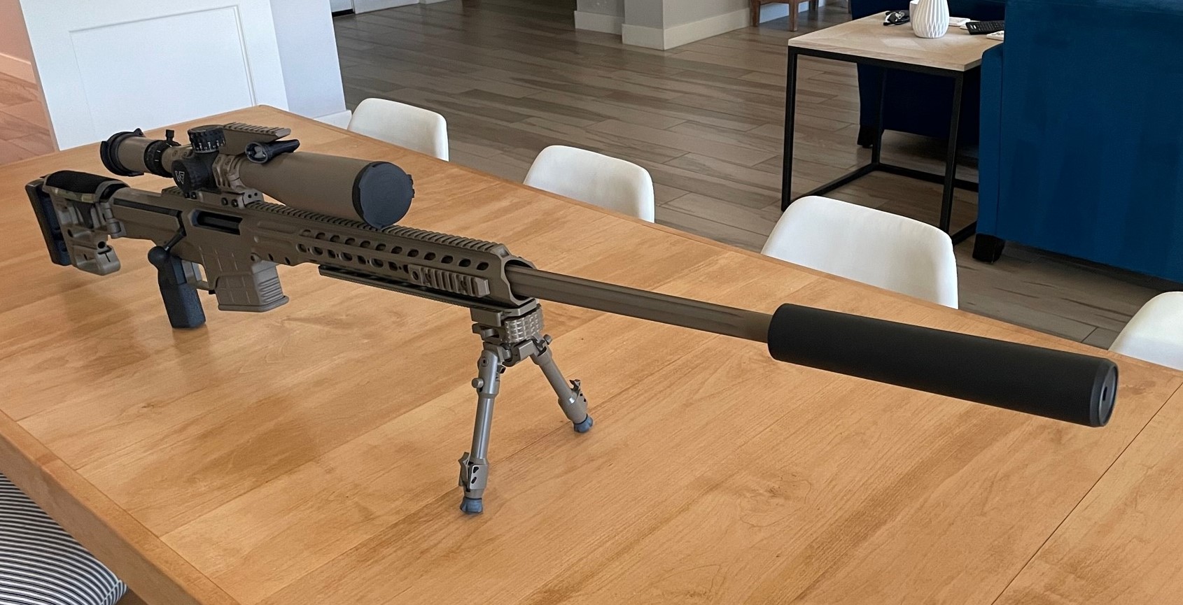

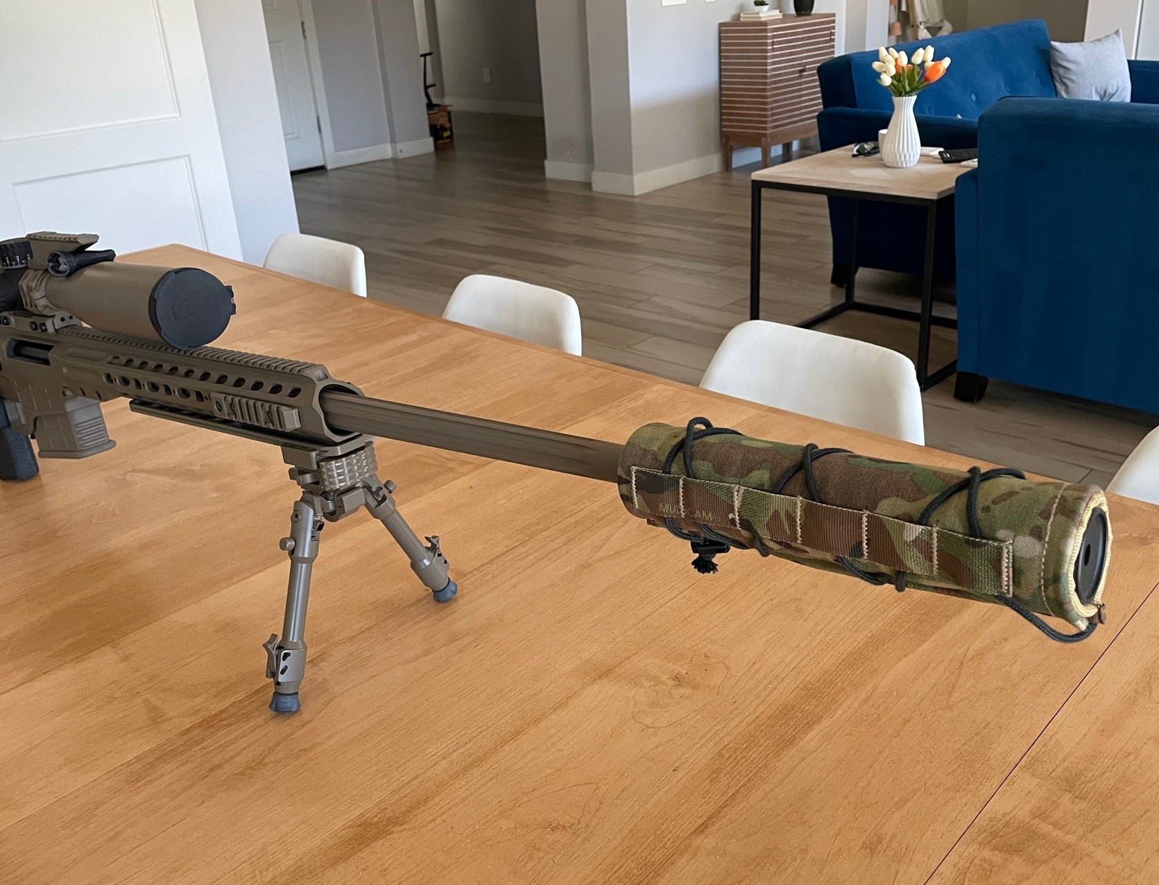

So I've been dealing with health issues, etc., and haven't made any firearm related purchases in about a year, saving up for home repairs and have a few sticks I haven't even fired yet, but finally got my MRAD/Mk22 setup handled. Still haven't been able to take it out to shoot, haven't been shooting in over a year now! Longest I've ever gone in like 40 years. As close to a Mk22 as you can get. Barret is currently still filling military orders so yeah, they're not easy to come by in any form.
This isn't work that LRI did though. I can't say much more, sworn to secrecy. Bottom line is it's best not to send these rifles off for "custom" work. I wish I could say more. Like a Glock, best to keep it stock. More than one version so best to do your homework before buying one. They look the same on the outside but barrels aren't compatible with older uppers for one (without a factory modification that requires complete removal of the retaining bolts).
Of course I had to put the NV shit on it just for cool guy points. Suppressor is an Elite Iron Sierra SD.

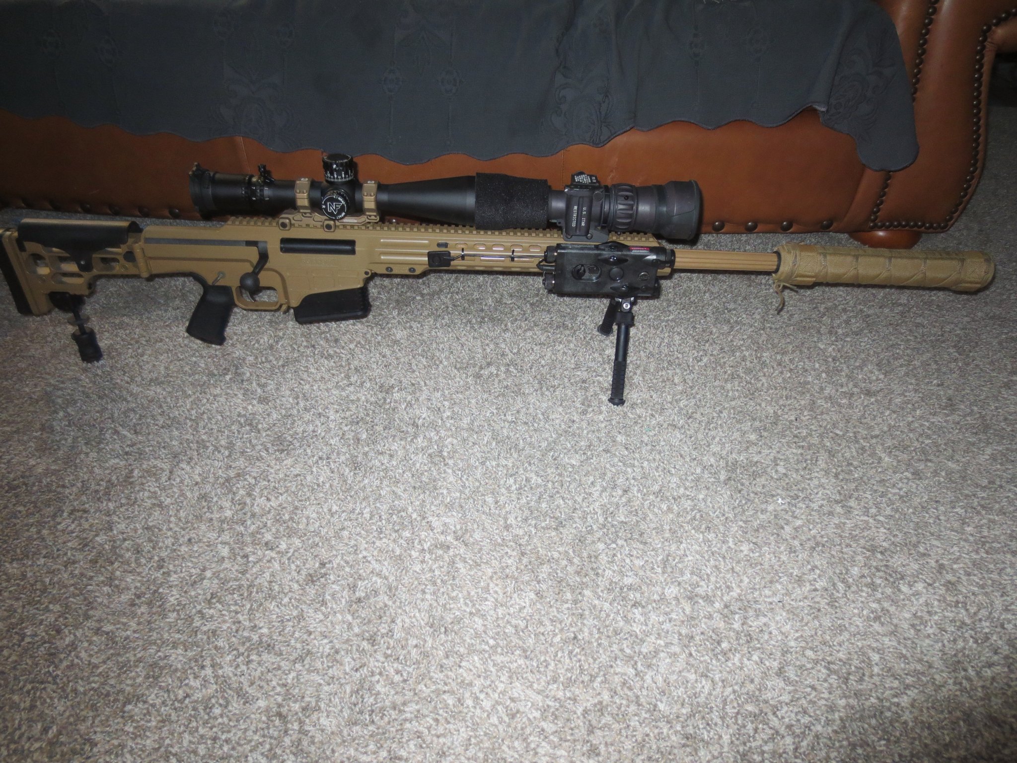

Mk22 24in. .338LM with Elite Iron .338 Sierra suppressor and wrap, 5-25x ATACR with Tremor 3 r...JPG
