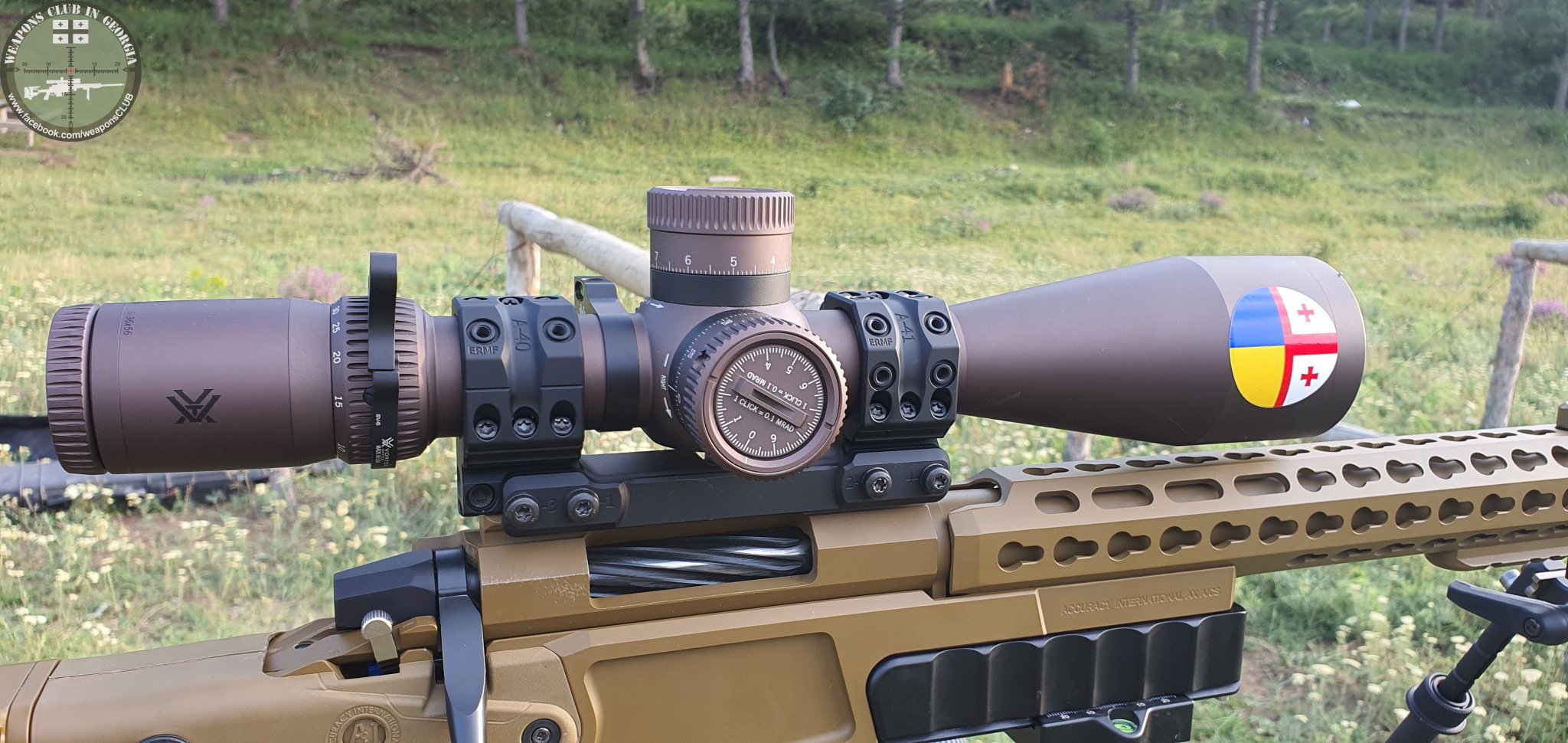

I just upgraded my Razor Gen 2 to the Gen3 that is 6x and I think it's fine. Think it complements the Tugentsen well. View attachment 7942170
Digging up an old post here but, what height mount are you running on this setup? I get my MRAD in a few days and already have a Razor Gen 3 in a 1.181” Spuhr mount I’m going to pull of another rifle. Pretty confident the objective wont clear the rail with that height so curious what the best height is. Thanks in advanced.
1.181 is too low, I put 1.5 on gen 3.
