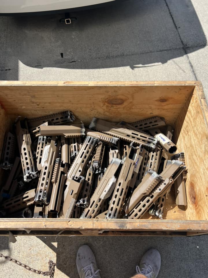

Saw these two pictures on Facebook... lol
  • Wow
Reactions: JulianD
That is interesting and makes me wonder how one would know this...
Looks like they made it out of the factory. Its intersting think about the inspection process in the field(?). Eg, if there were some gross failures (cracks?) and then they x-rayed a bunch of them or something (?). or if there was a geometry problem that showed up, where something basically wasn't straight.

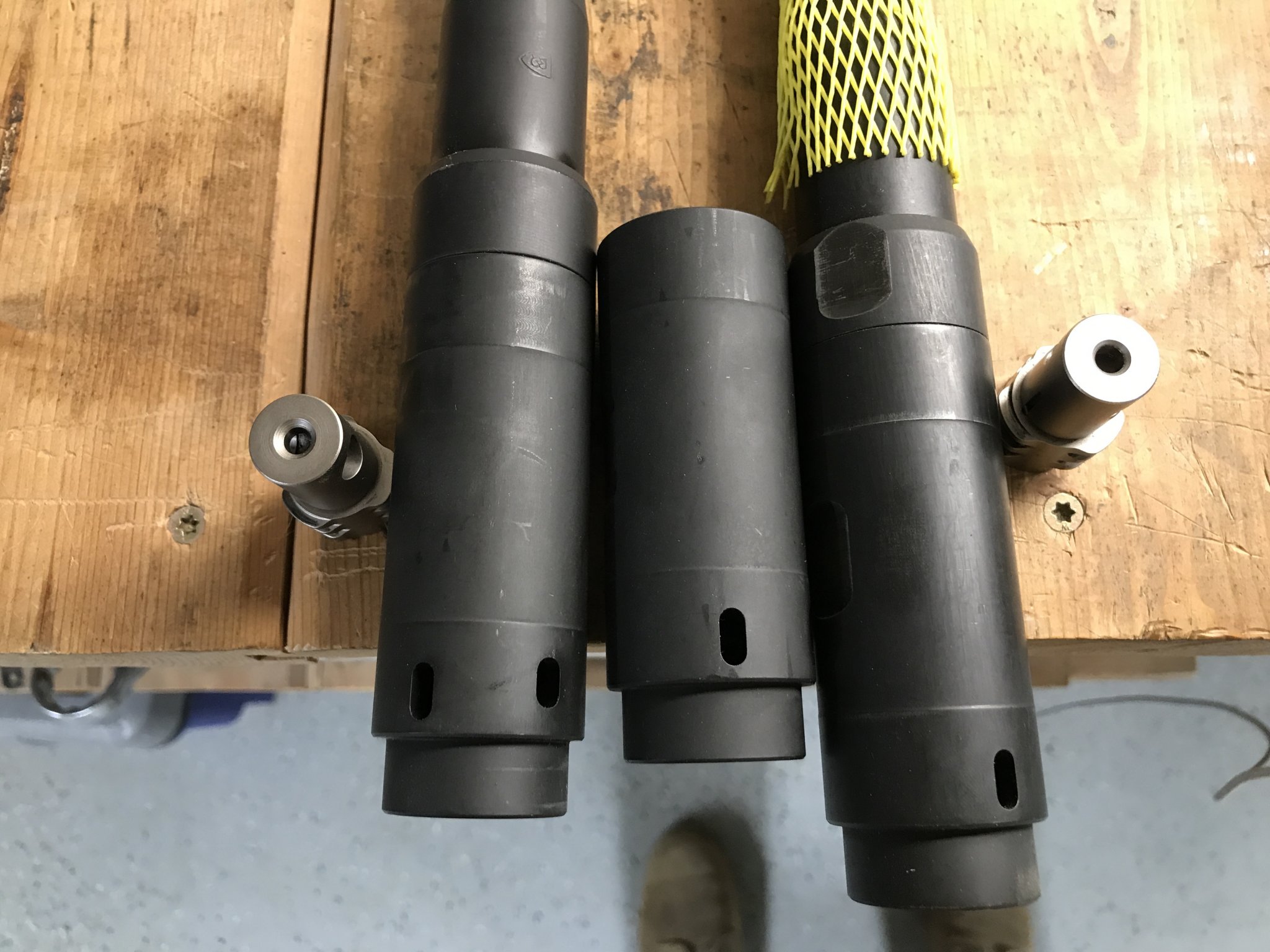

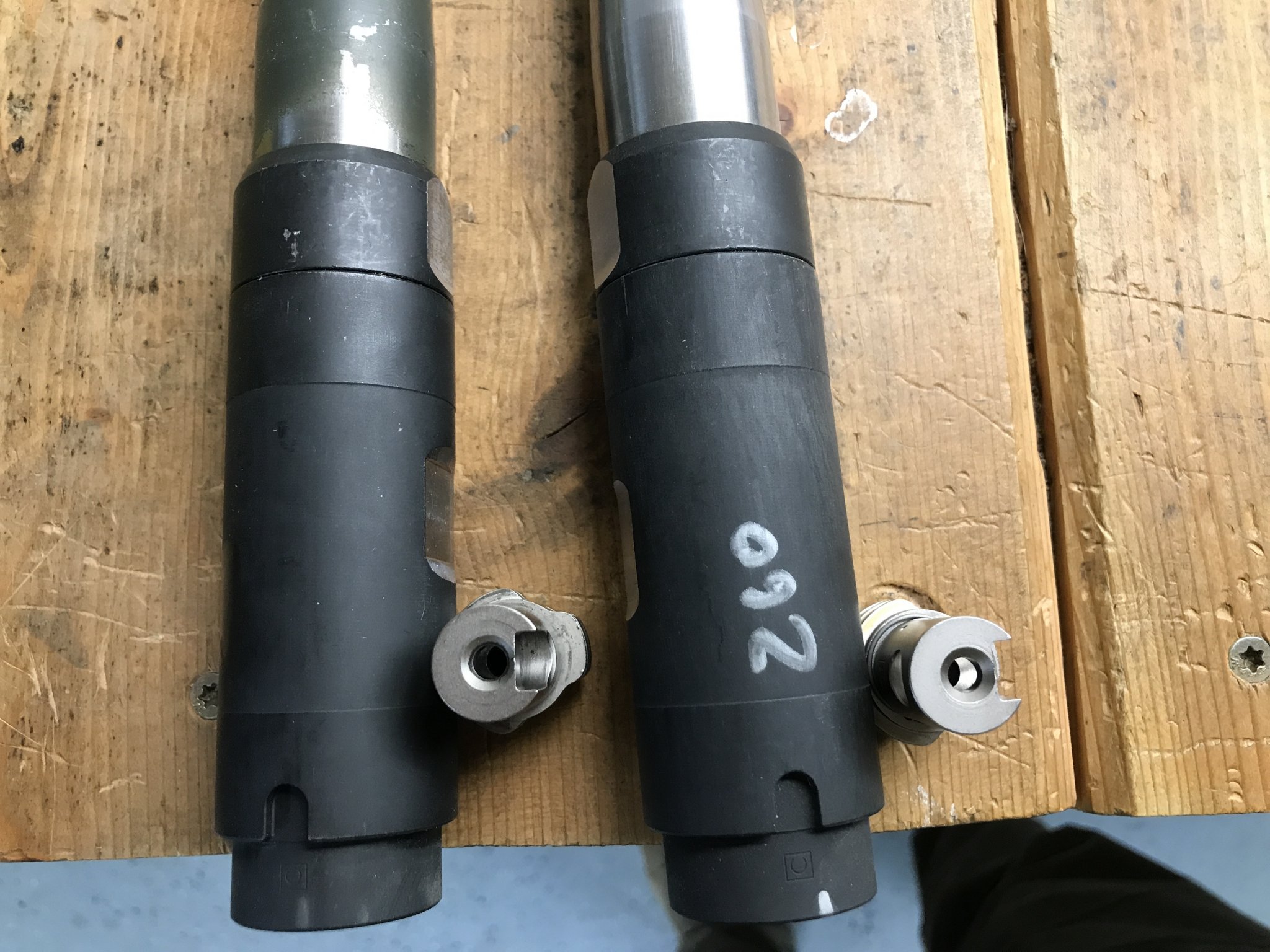

I wanted to weigh in on the MRAD barrels my MRAD is CJ0019XX. Best I can tell and have been able to verify with my own extensions and one from a friend of mine. Barrett has four different barrel extensions. The original extension from the large bolt designed MRAD (friends gun .585 bolt) up until the MK22 era are all the same. You can use any bolt on any extension. I have been able to take a bolt from the AJ series .585 bolt face and put a .540 or .470 bolt in the same extension. The three pictured extensions will take all three bolt sizes. The left bolt is 308 (.470) and the right bolt is 300 WM (.540). Note that these bolts do not have acut out at the back for the cam pin retention mechanism. My rifle is a 300 PRC and you can rebarrel the rifle just like any other but will be limited what barrel blank because you have to have a long tenon section for the extension.
  • Love
Reactions: Ehtacs and BURZ
As mentioned above the other three extensions are different. They are made to ONLY take the same size bolt it was shipped with. You can not put a .470 bolt in a .540 or .585 extension. You can take a .470 and use it in another .470 extension. I think Barrett did this to make the gun GI proof. Notice these bolts are the same and can be used in either extension. My 300 PRC bolt (not shown) also has the cut out at the rear of the bolt and will not fit into these extensions nor my original 300 WM extension (non cut out bolt) nor any other size extension.
Keep in mind I am not addressing differences in headspace from one bolt to another within the same bolt face size from extension to extension. Headspace needs to be set for the bolt you are using with the extension being used.
Hopefully my explanation makes sense.

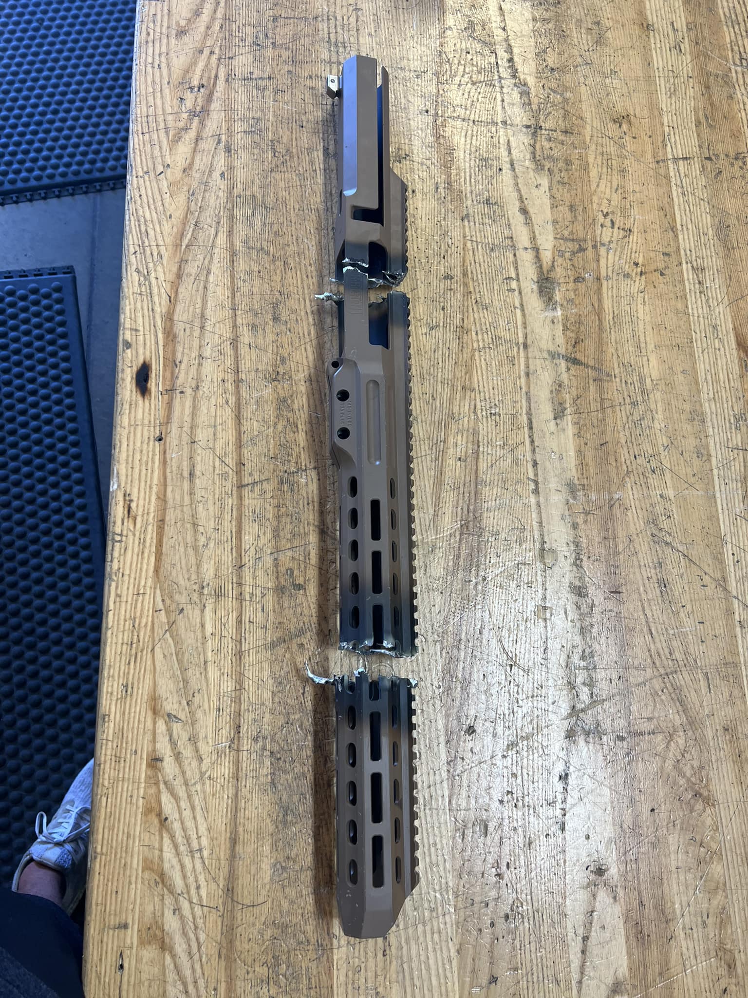

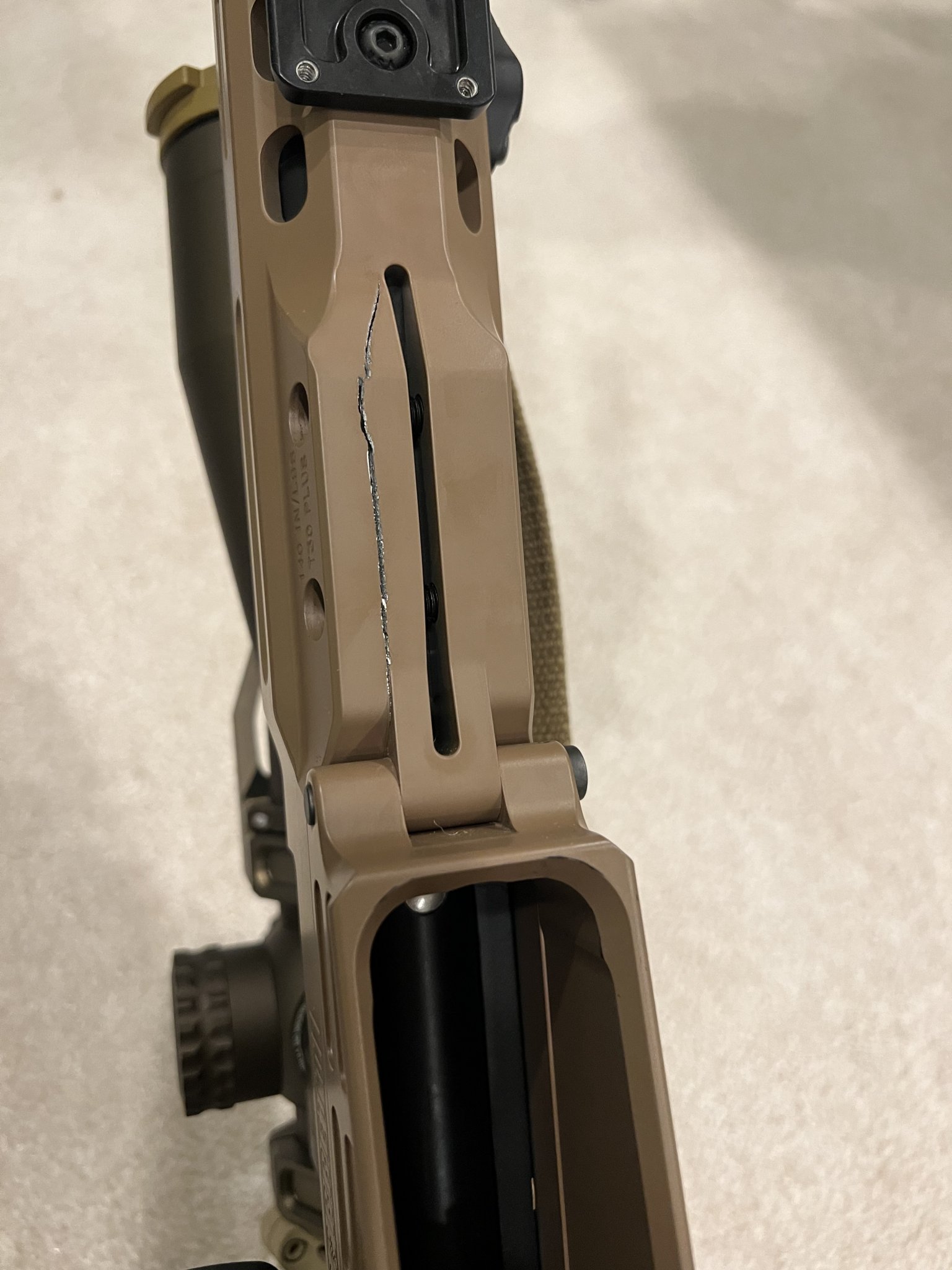

Bad Day:cry:I guess my Mk22 MRAD is toast.... I just discovered a significant crack in the receiver while cleaning my gun room. Last time I shot the rifle the accuracy dropped off significantly at the end of the day. I thought it was me and went home. I hope Barrett will take car of me??
Yup call customer service
Reactions: jmornoinf and BURZ
I wonder if this is the issue that was posted up above. Metallurgical issues on issued MK22's
Reactions: ilikebmxbikes
