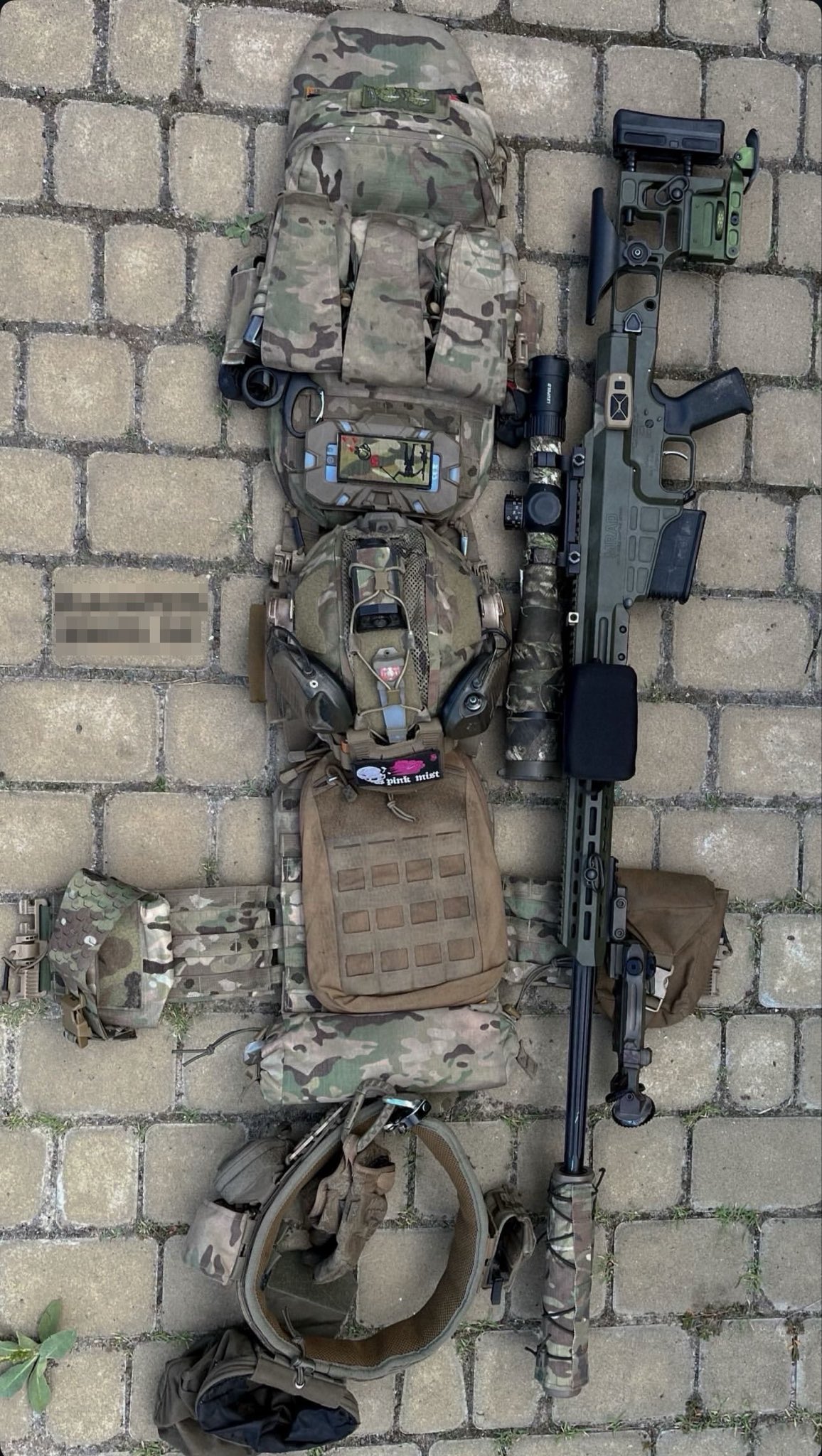

I have this exact weapon 2.3k rounds using 6.5CM 139gr Lapua reloaded, never had a single failure with it nor with the firing pin. At some point it comes down how you use your bolts and take care of 'em, the millitary will find some issues with the mk22 that you'll not see in the civilian area. Heads up most people don't take care of anything that is granted to them because they did not spend any money to play/train with it.

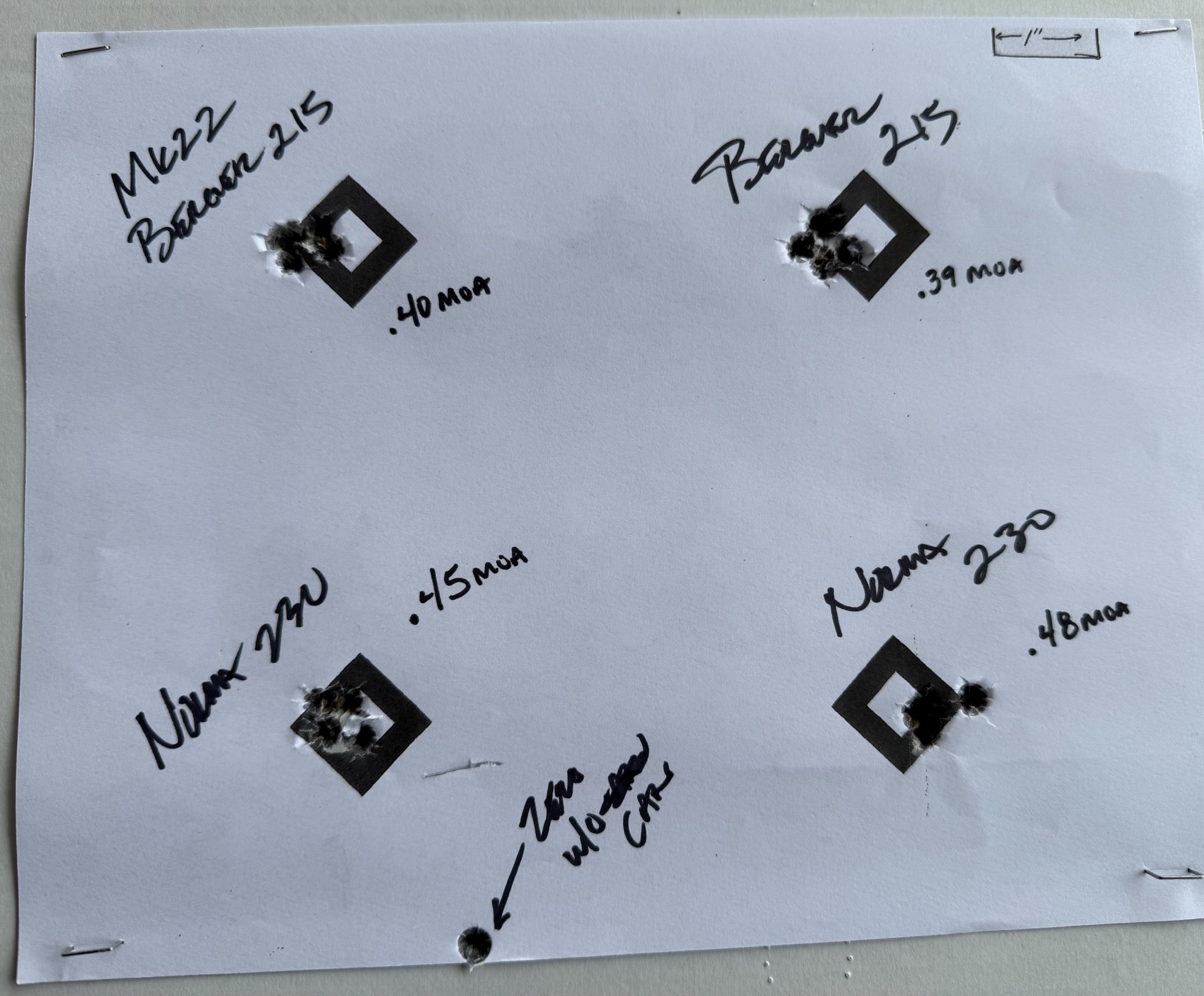

Quick range report regarding POI shift;
Earlier there was some commentary regarding a POI shift based on front support/bipod location. There is an ongoing thread in the Semi-Auto sub-forum where folks are talking about this and testing it for themselves. I am using a recent production MK22 rifle, 300 NM barrel, with the AML338 suppressor. I have a full length ARCA rail. After moving the bipod as far forward as possible and then rearward, I observed zero measureable shift in my groups.
If anyone has observed different I'd be interested to hear their testing protocol to see if I can recreate their results.

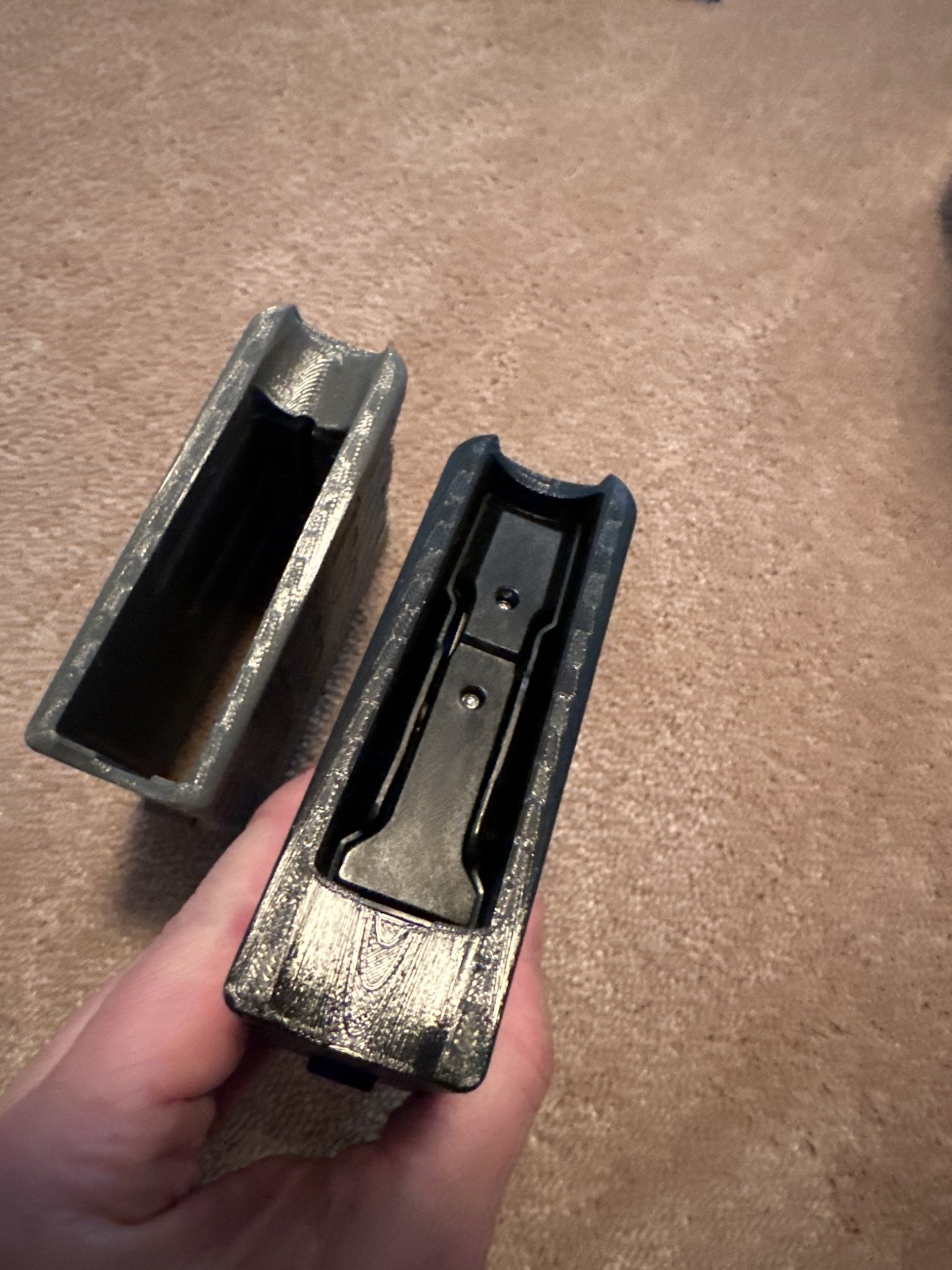

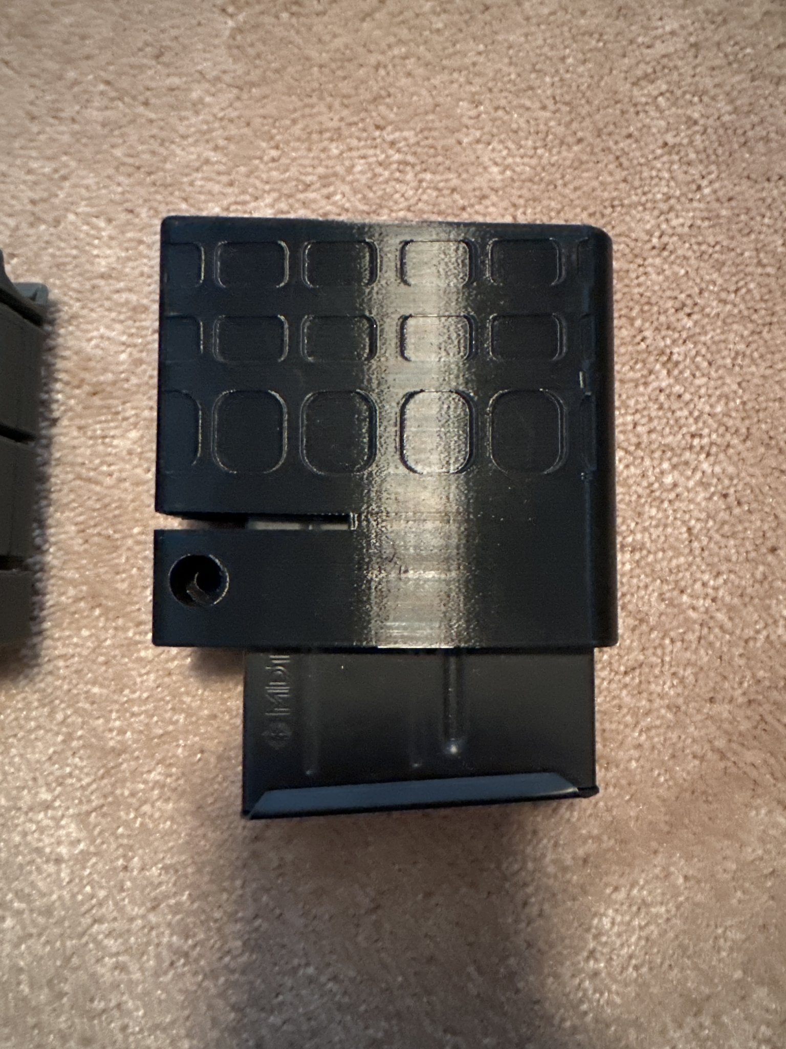

There is a dude i found on ebay that can 3d print you a mag shell and then insert the mdt mag into... I'll post some pics tomorrow of what it took to run wsm/saum cases.
