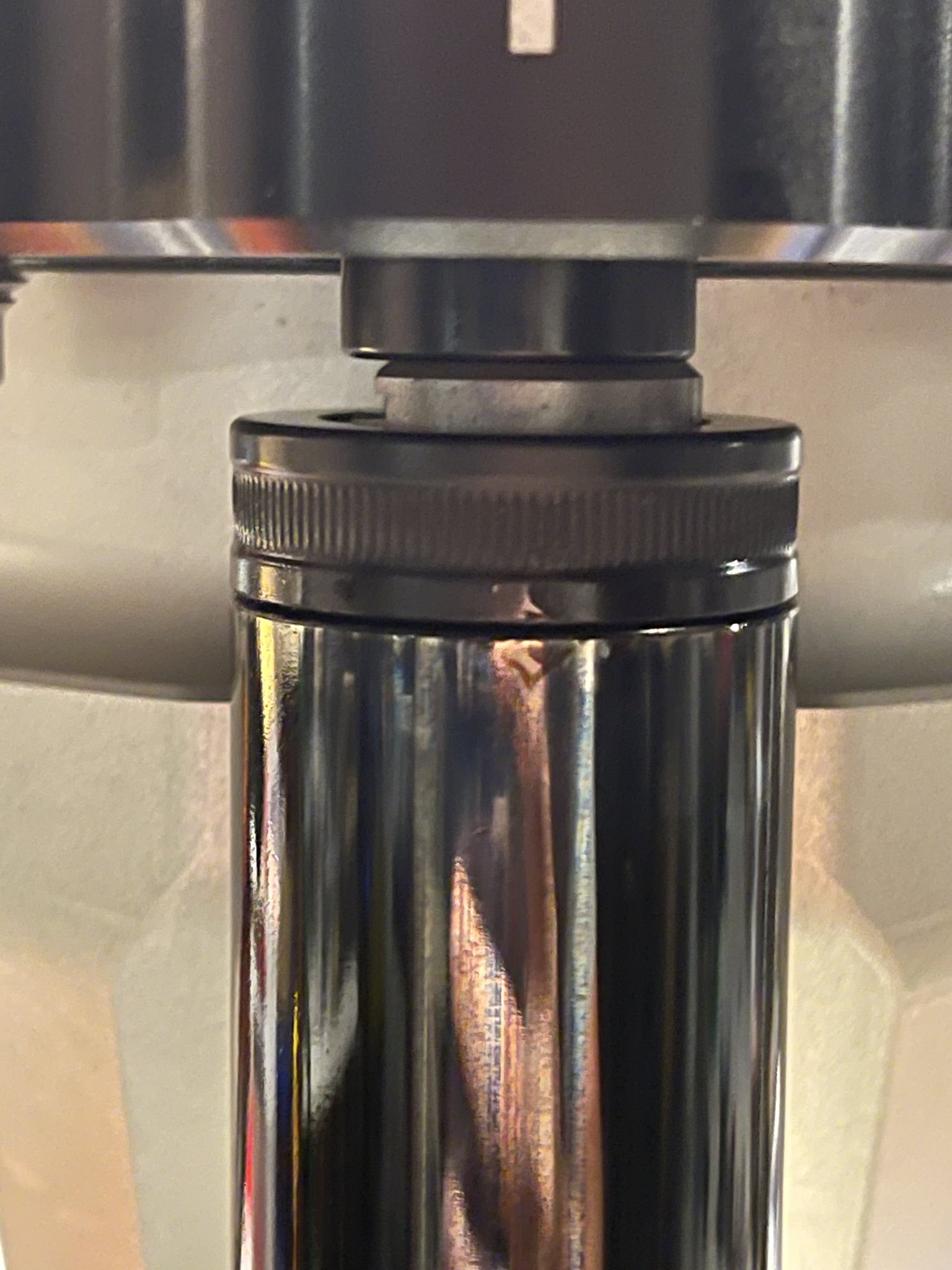

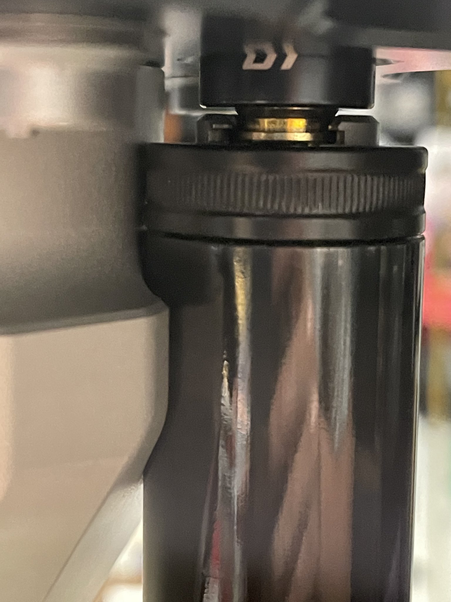

Hoping someone can tell me what I’m doing wrong- can’t seem to bump the shoulder at all even with using all the shims.
I did just like their YouTube video said- ram all the way up, screw in die to touch, lower ram, screw in a little more (did about 1/4 turn).
Now with brass in the die the ram doesn’t touch the shell holder despite having cam-over I can feel.
I put all of the shims in (on top of the bushing) and I’m not getting any bump.
.268 bushing, alpha brass.
Thanks guys
Thanks guys

update: seeing ucsfl05’s picture of the shell holder not contacting the die got me to thinking… i spray alcohol/lanolin lube on the cases in a loading block that comes up and prevents lube from the bottom 1/2” of the case. now, since i’m not using a mandrel or expander, i lubed only the outside of the cases by spraying them in a ziplock bag, then tossing. also let the alcohol completely evaporate using a fan. first two cases bumped .007”! so i took out all 4 shims, turned the die out so it just holds a thin piece of paper at top of stroke. i don’t think the decapping rod was hitting the inside of the case, but i moved it out one notch just to be sure, too. perfect .002” bump on 87 out of 87 cases! could the previous cases have been sticking on the last bit due to insufficient lube? or maybe it was the decapping rod. anyway, it’s now perfect.
If the bottom of the die isn’t making contact with the top of the shell plate holder with brass inside than shaving any amount off the bottom of the die won’t do anything. There has to be something that is bottoming out and preventing contact and it can’t be the shoulder because that would be getting bumped back if it was. I have seen this first hand in the zero press with the sac die and with a bullet central micron precision die. I have no idea what the cause is and sac couldn’t really give an answer. I have the area 419 shell plate kit and with that I’ve been able to get my desired bump on all my brass.
Agree. I haven't seen that issue on mine. I have the die set so the A419 shell holder contacts the the die at full stroke. As a test, anyone having this issue should try removing the decapping pin or mandrel and then size the brass just to take them out of the equation.
@Danrobberg & @HemiPowrd – Can't thank you enough for the response here. Good to know I'm not going crazy in dealing with this issue! Just to confirm, the Area419 shellholder system fills the gap between the top of the ram and the bottom of die, correct? That way (1) you're getting contact between the shellholder and the die to ensure consistent sizing, and most importantly (2) solves the issue of not being able to get enough shoulder bump?
I haven’t sized any cases with the sac die on mine yet but helped a buddy set his up and he has a zero press as well. We had to give it more of a cam over than normal. I chambered two dasher barrrels for him and his son. Both shoot Peterson brass but different lots. One chamber is about 1.5 thousandths longer than the other. We could get it set up to size the slightly longer brass perfectly but no matter what we did (add shims and change all the Redding shell plate holders) we could not get any bump on the slightly shorter brass. So when he switches back and forth he has to screw the die in further to get more cam over and the problem is solved. There is still a slight gap between the shell holder and the base of the die. We haven’t tried the zero shell holders on his set up yet. I’m waiting for my bushing for a 22gt sac die before I size it in mine. But my micron die does the same thing, with no brass the shell holder touches base of die. When brass is inserted there is a small gap. Not sure how to explain that. There is no decapping pin or expander in the micron die I have set up. Maybe it’s something with the zero press? Also just to eliminate another possibility make sure the turret is tightened down with the torque wrench provided.
@Danrobberg – Thanks for the info. Same here. Getting shoulder bump when I do a bit more cam over I can get the bump I want, but it feels like it defeats some of the point of a Zero when you aren't hitting that hard stop. Getting pretty consistent sizing (about 0.001" extreme spread in sizing differences between cases). Or is that kind of sizing difference "great" and I'm just being extra picky here?
