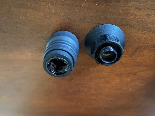

Night Vision The Official: Steiner C35 Thermal Clip-on Review and User Thread!
Just got my Burris eyepiece, and unless there is something I am missing it does not work as expected. It actually makes things worse. It has a rubber cup that slips over the ocular on the C35, it does not thread on. When looking through it, the screen looks a bit smaller and out of focus. Rotating the focus ring does not help. I'm planning to return it unless someone else gets theirs and figures out what I am doing wrong.
Going to wait a few days to see if any of you have any better luck, cause sometimes I am not the sharpest knife in the drawer.
Maybe adjust the focus on the C35? Mine doesn't come apart, btw.
Call Burris
I'm getting mine tomorrow. I'll report on findings.
Mine just arrived from EuroOptic and seems to work just fine. Super tight eyebox, but that was expected. Definitely magnifies the image and the rubberized mounting cup seems to hold on pretty solidly. Took 2-3 CCW turns of the eyepiece to extend it into full sharpness and maximum magnification, but it hit a firm stop and didn’t come apart into two pieces like the one above.
Got mine today as well and same experience as mentioned here
Reactions: jcook119
Thanks JWramp, your comments made me realize what I was doing wrong. I put it back on, and turned the eyepiece a couple of turns until it focused properly. If I keep turning it will come apart as shown above, but that's several turns past the focus point so I am not concerned about it. I am happy now, thanks for the info.
Reactions: wizardpc and jwramp

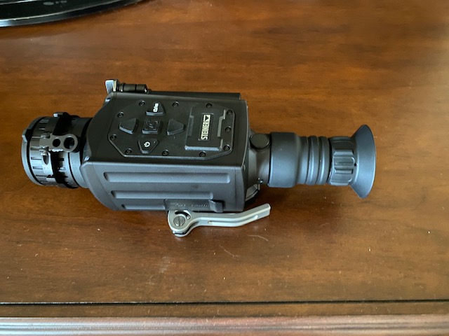

For those of you who have sent your C35 back to Steiner because of issues with the clamp:
What issues were you having?
If it wasn't getting tight enough, how loose was it?
What did they do to fix it?
Reason I ask is I slapped it on yesterday to shoot a groundhog in the daytime with it to get some practice and use it as an opportunity to check zero. I finally killed it, but I was very obviously impacting to the right. This was not a far shot. It was approximately 50 yards and I was shooting off of a RRS tripod and shooting a Giessele Super Duty rifle with a Nomad 30 suppressor and the E-brake, so this should have been extremely easy.
Had just shot the same setup without thermal at much smaller targets at 200 yards and it wasn't even a challenge.
Im just wondering if there is the tiniest bit of slop in the clamp that could account for my experience yesterday.
Thanks in advance gentlemen.

My C35's stock clamp was loose on my KAC SR15 URX4 handguard pic rail, it was loose enough for me to shift it by hand pushing it towards the muzzle end and back rearwards towards the stock but every other pic rail I had for my other firearms it was perfectly stable and could not be easily shifted by my arm strength just my KAC URX4 handguards on my 16" and 11.5".
I contacted Steiner and they sent a brand new clamp to replace the original one and it fixed my issue.
Reactions: Glassaholic
Good to know.
I always felt like mine locked up tight but after my misses I tried rocking and twisting it. I think any movement is all in my head because it’s definitely not obvious.
It sure looks like you could take out the screw on the throw lever and put a shim under the leaf spring looking thing. It floats in there and is captured by the lever. Pop can shim?
I contacted Steiner so I'll see if the new mount helps first.
Received this reply from Steiner:
"With the mount un-latched, you can loosen the 4 screws underneath the mount and remove it from the clip on.
Once it is removed, there are two large screws that can be tightened. Tighten the screws until snug and then a little past that.
This should correct the loose mounting."
Does this make any sense to those that have had the mount off?
Yes, that’s exactly what I did with mine (including some Loctite blue) and it took all my wobble out.
Yeah, the mount is held in place with 4 screws into the C35 body and the mount itself is two pieces held together with two larger screws.
This is the post I made with how much torque I set for each screw, but this is not official values just something I felt like is good amount: https://www.snipershide.com/shootin...and-user-thread.7124087/page-15#post-10507672

I ordered the burris 1x eye peice for the C35, hoping it would make useing it as a scanner better, and was super unimpressed by it. It zoomed in on the screen a little bit but cut off a good bit of the corners. I sent it back as looking through it without an eye peice is fine enough.
