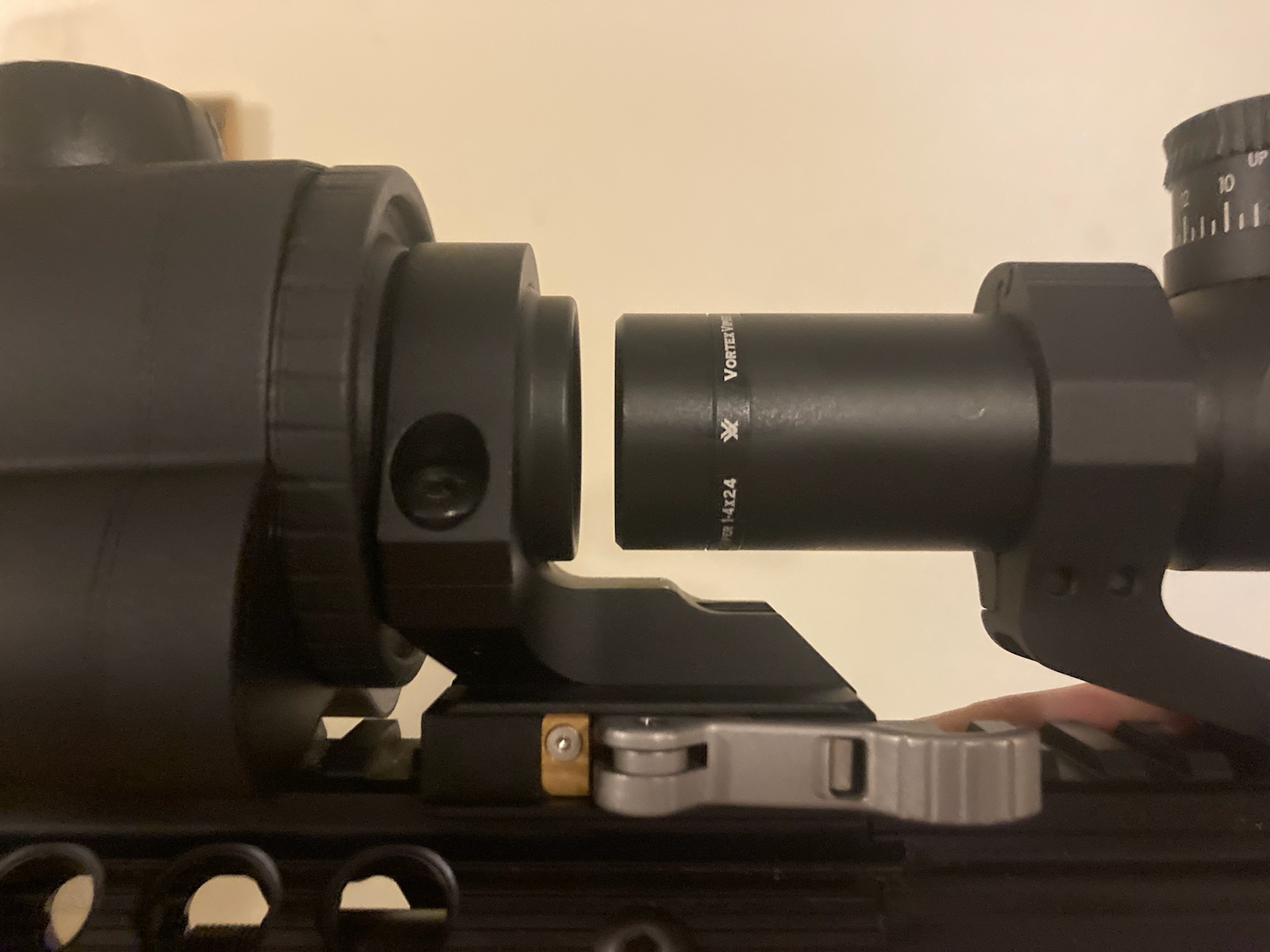

It rail mounts with caveats. Credit Trash Panda for figuring out you can flip a Burris clip. For a 1.5" mount, you're limited to about a 34mm objective bell unless you start shaving... could happen...
What extension is screwed onto the Steiner to allow the Burris clip on to clamp around it? The pictures of the Steiner don't appear to have as much rear extension as is pictured in post 1227.
