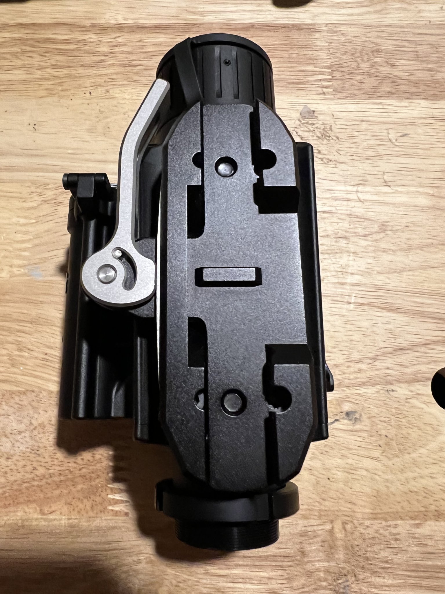

I just realized my mount is backwards compared to the other units in this thread. The lever is on the wrong side. Back to Steiner she goes.
No need for that I think. My mount with the lever had a little bit of play in it even when latched down the whole way, so I unscrewed the base plate and was able to get to the screws for the mount itself (if that makes sense).
So maybe unscrew the bottom 4 screws and see if you can get to the baseplate and unscrew that, then twist it around and mount it in the correct direction.
Can't you just unscrew and refit?
Unfortunately no, the screw heads are inside the unit.
Thank you! I’ll give that a shot.

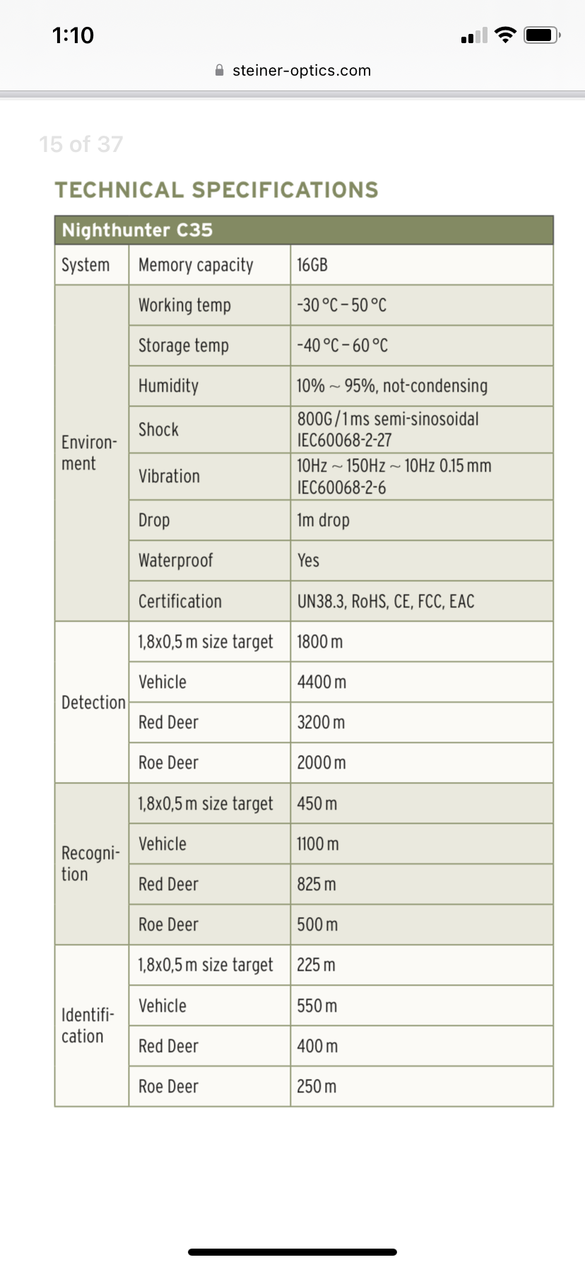

800 g's would be a phenomenally abusive recoil impulse. I used the Robinette recoil force calculator to do some tinkering and the results were surprising and a little terrifying. From what I can see you could shoot an unbraked 8lbs 338LM with 300gr pills at 2740 and pull off a tit over half of that 800 g's rating. Such a rifle would be right up at the limits of human endurance. I would say that either there's something wrong with those calculators, unlikely, or there's not really a recoil limitation that any of us are going to care about since we'd all be putting these on rifles that have an NV bridge or a full length top rail and anything likely to have one of those is also almost certain to have either a brake or a suppressor or both on it and it's likely to weigh a hell of a lot more than a pencil barrel walking around hunting rifle. I would surmise though that the more recoil violence you subject the unit to with each trigger pull the fewer trigger pulls it will live through and the greater the odds that your next trigger pull will be the one to roll up the curtain send your C35 off to join the choir invisible. Assuming near-zero but non-zero plastic deformation of either the concrete or the C35 resulting in a stop time of .001 seconds you could drop it a little over 3 feet onto concrete and not exceed that g rating. I think we're ok with these on our bigass heavy chassis'd .338LM's. My .338 doesn't really abuse me as much as my .300wm does. I'm sure my C35's will agree.
Does anyone know the g-rating of a Oasys UTM (not UTM-X) just out of curiosity?
Here’s where I saw it….
Reactions: Eliteuas
Interesting….here I was thinking I was limited to 3
I'm now wholly unconcerned about my plans tomorrow that involve the C35 and my lightweight 6.5 Creedmoor gas gun.
I wouldn't throw caution directly to the wind but a common AR-10 in 6.5CM has about the recoil impulse of a light bolt action 7.62x39 so I wouldn't be concerned at all. I would caution the people thinking about putting these on boomers that failure modes to do with recoil tolerance are rarely instant. Everything you can do to slow the recoil impulse (increase effective inertia by adding weight, using a brake/suppressor, aggressive bipod loading, etc...) will likely still be important for maximum device longevity.

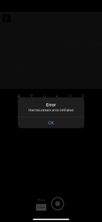

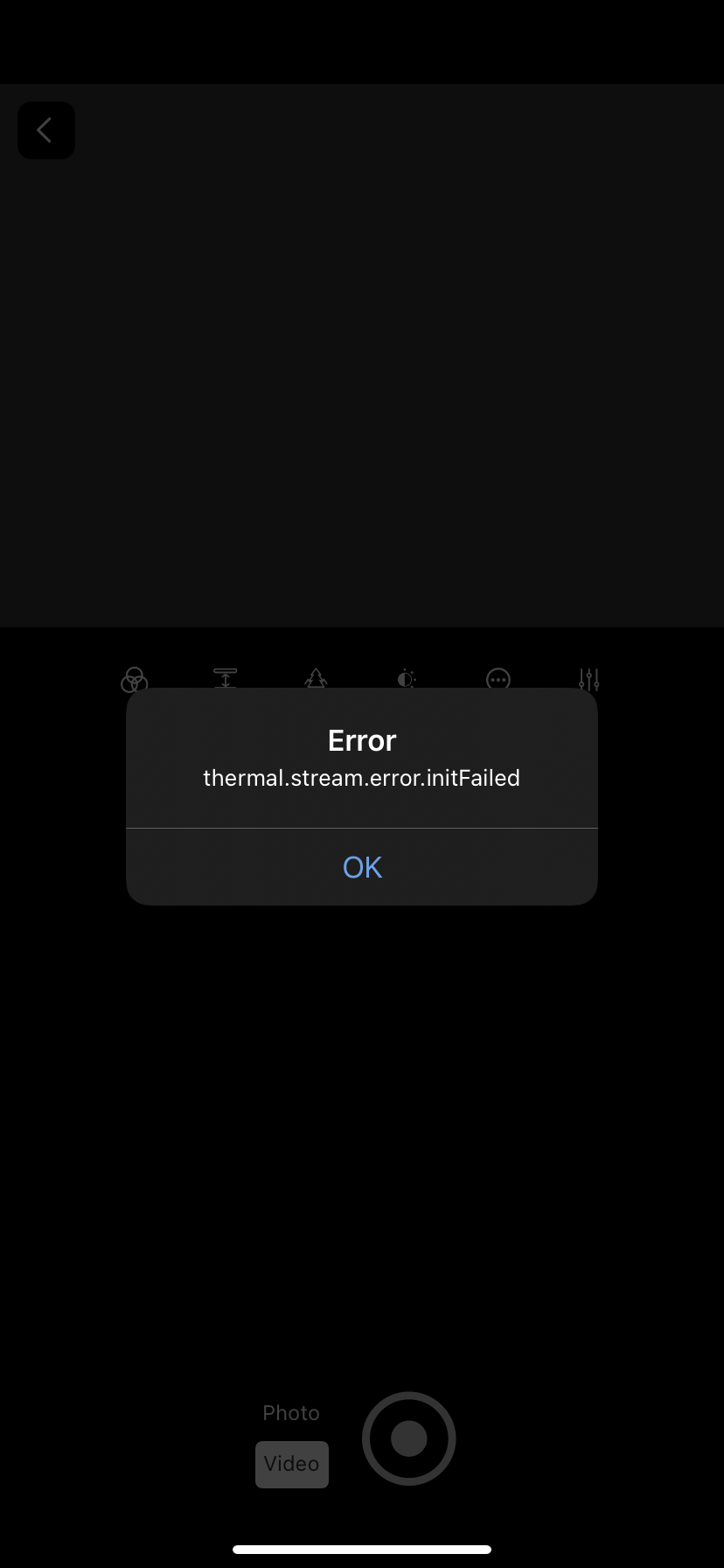

Anyone able to get theirs to stream to an iPhone?
Just got mine Friday and can’t get it to display on the phone.
I can connect and adjust the settings but no image comes across.
Wondering if it’s a setting on my phone I’m missing or a defective unit.
I have not had any problem using my iPhone. I if course had to enable the Bluetooth.
Bluetooth or just the wifi connection? My Bluetooth is enabled either way but there’s only a wifi connection for the C35.
Keep getting this:
Keep getting this:
I used Bluetooth, using the App, to aid in focusing because once I am behind the rifle I can't reach the focus, so I was back and forth too much. I have not used the WiFi side of the App for streaming. Sorry I haven't had mine very long either nor had time to try everything.
That interesting, I’m not seeing a way to connect through Bluetooth only. Nor do I see how I could adjust the focus through the app.
It’s just the Steiner connect app right?
Sorry, I should have clarified. I do not adjust the focus in the App. I am able to get out from behind the rifle and to he side so I can adjust the focus and see the focus in the App.
