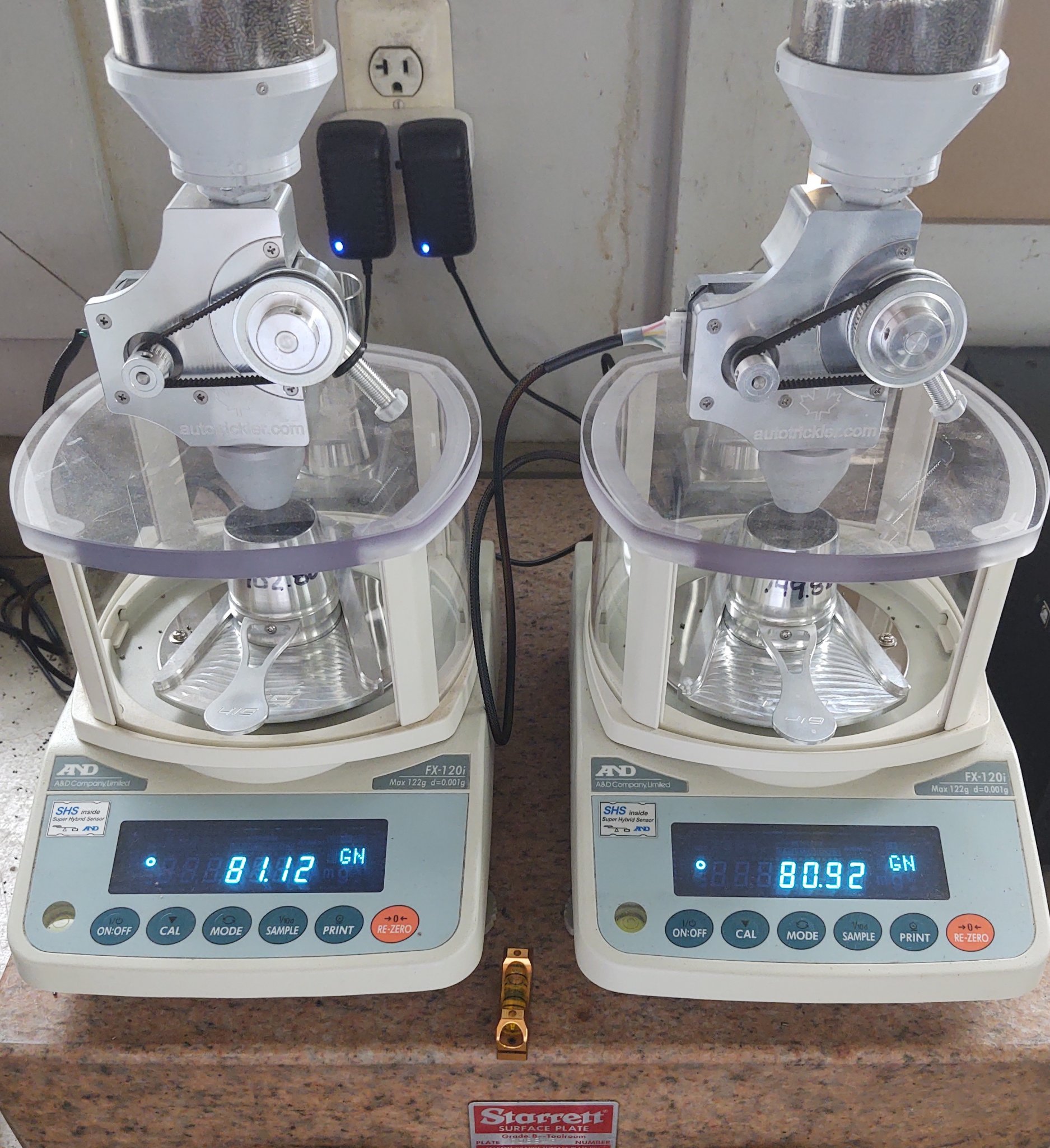

    Travis shoots 81 grains of Retumbo in his Norma. This should give him a SD in the upper 40's😂😂😂.

    1 gr of powder in 300 NM is about 50 fps, 0.2 gr is about 10 fps.

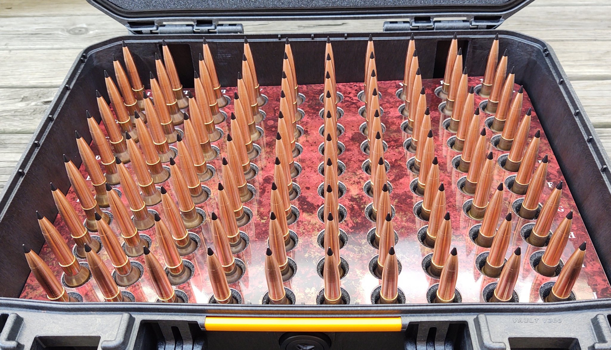

    The .416 is ready for the 3 mile attempt! Hopefully we get some favorable conditions next weekend!

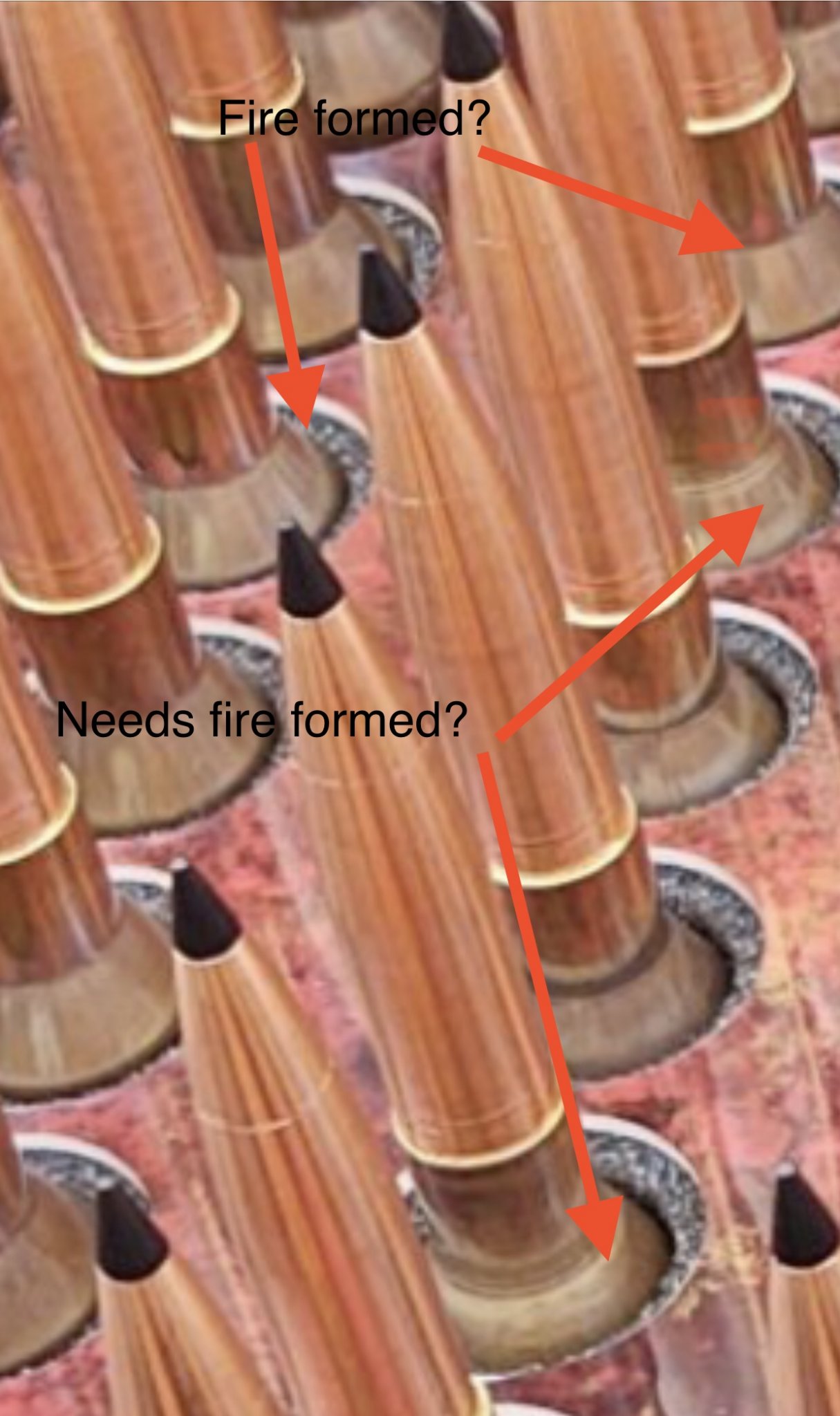

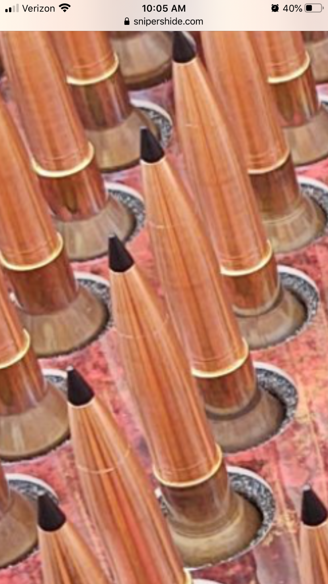

    Are some cases fire formed and others are not?
    Shoulder on left most two columns appears to be different than the other eight columns.
    More radius vs defined shoulder angle from neck to body.
    Could easily be optical delusion though.

    You've got a really good eye! I purchased a Warner Tool resize die for the .416. The body bushing inside the die broke on the very first piece of brass I resized. I guess it was my fault. I was using imperial lube and you're not supposed to. Well I wanted to resize the brass that I fired during my pressure test and accuracy testing and the replacement bushing wasn't going to be finished before our trip. As an emergency backup, I purchased a f/l resize die from CH4D. Those last couple rows were once fired and resized with that die. It leaves a small radius at the base of the necks, but they close fine in the chamber.

    And how many have you hydraulically dented because of improper application? Its not that it wont work in most cases, but when improperly applied, problems occur. And in some situations, like the one we have here, the wax simply does yield enough lubricity.
    I wouldn't think a die case bushing shouldn't break on 1st piece of brass resized. It sounds like a heat treat issue to brittle. I worked in steel heat treat years ago in Aerospace and when we had parts fail it usually due to improper heat treat or quench.
    Reactions: Geno C.
    Yea, could be. Double drawn and Rockwell tested good, so I just don't know,for sure.
    Had one other from the same lot in460 Styre
    Do the same thing. Al the rest are out there working fine. Both appeared dry of lube when I got them returned. Shit happens!
