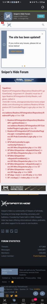

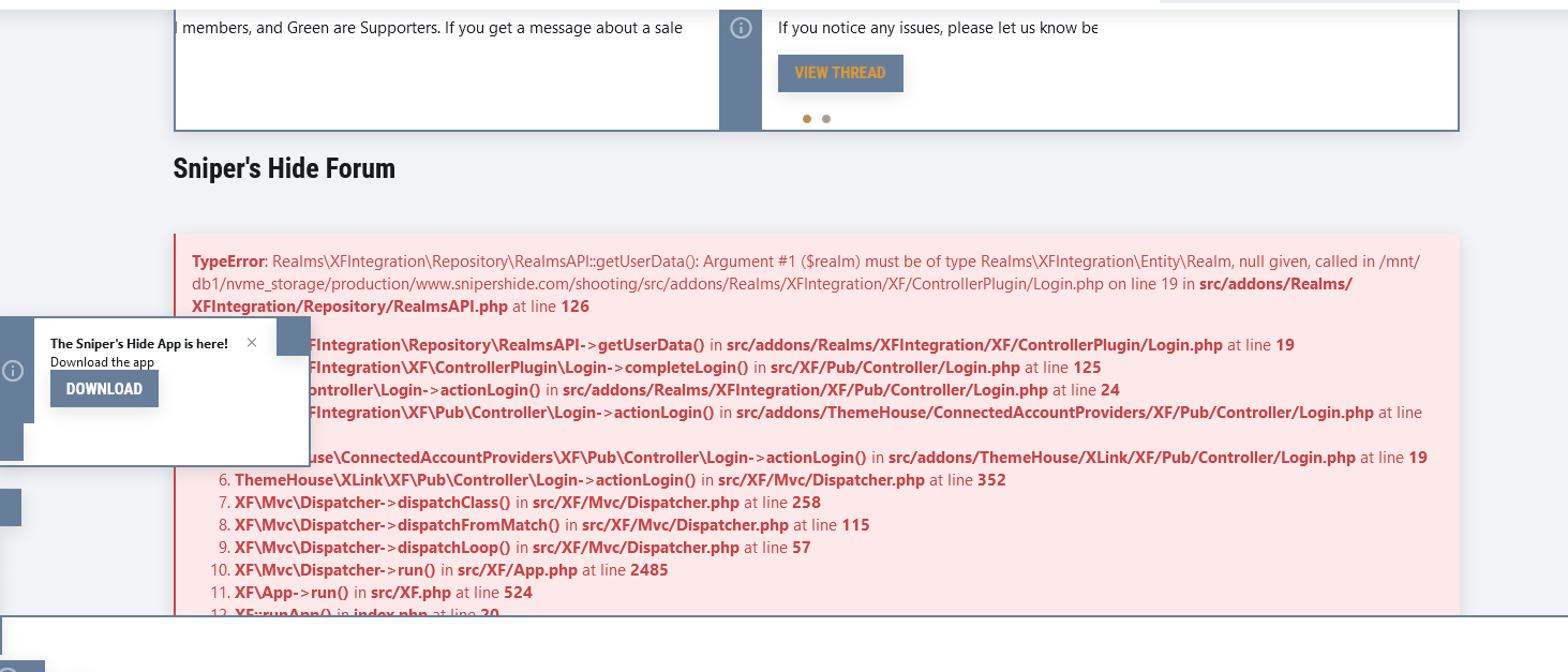

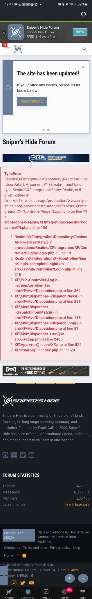

NOW , when I get into the site and get past the "I'm over 18 verification , everything is good BUT when I click onto the "log in" I get this
TypeError: Realms\XFIntegration\Repository\RealmsAPI::getUserData(): Argument #1 ($realm) must be of type Realms\XFIntegration\Entity\Realm, null given, called in /mnt/db1/nvme_storage/production/www.snipershide.com/shooting/src/addons/Realms/XFIntegration/XF/ControllerPlugin/Login.php on line 19 in src/addons/Realms/XFIntegration/Repository/RealmsAPI.php at line 126
  1. Realms\XFIntegration\Repository\RealmsAPI->getUserData() in src/addons/Realms/XFIntegration/XF/ControllerPlugin/Login.php at line 19
  2. Realms\XFIntegration\XF\ControllerPlugin\Login->completeLogin() in src/XF/Pub/Controller/Login.php at line 125
  3. XF\Pub\Controller\Login->actionLogin() in src/addons/Realms/XFIntegration/XF/Pub/Controller/Login.php at line 24
  4. Realms\XFIntegration\XF\Pub\Controller\Login->actionLogin() in src/addons/ThemeHouse/ConnectedAccountProviders/XF/Pub/Controller/Login.php at line 84
  5. ThemeHouse\ConnectedAccountProviders\XF\Pub\Controller\Login->actionLogin() in src/addons/ThemeHouse/XLink/XF/Pub/Controller/Login.php at line 19
  6. ThemeHouse\XLink\XF\Pub\Controller\Login->actionLogin() in src/XF/Mvc/Dispatcher.php at line 352
  7. XF\Mvc\Dispatcher->dispatchClass() in src/XF/Mvc/Dispatcher.php at line 258
  8. XF\Mvc\Dispatcher->dispatchFromMatch() in src/XF/Mvc/Dispatcher.php at line 115
  9. XF\Mvc\Dispatcher->dispatchLoop() in src/XF/Mvc/Dispatcher.php at line 57
  10. XF\Mvc\Dispatcher->run() in src/XF/App.php at line 2485
  11. XF\App->run() in src/XF.php at line 524
  12. XF::runApp() in index.php at line 20
Them I have to go back to the top of your post and click on FORUMS and all is good.
Maybe I need to delete the link in my favorites and start over ???
