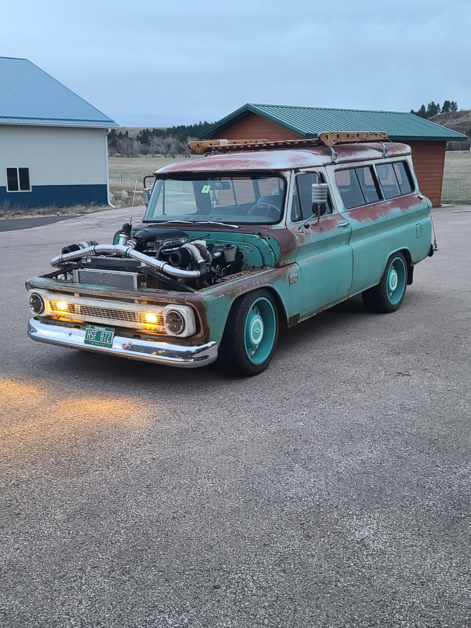

Maggie’s The Suburbanator. . .
Any details on this beast?
My "motor tuner guy" Josh's creation.
Easily one of the sharpest motorheads I've ever met. He has a serious predilection for the weird. Lol.
Wilwood disk brakes on all 4 corners. Engine is a "Ghetto Coyote" setup he put together with a pair of turbos. I don't know what trans, but it does have a trans brake.
Suspension is an air ride setup he made along with the exhaust cutouts.
The thing is a freak and riots of fun to toodle around in. He's a rather clever dude.
A great friend!

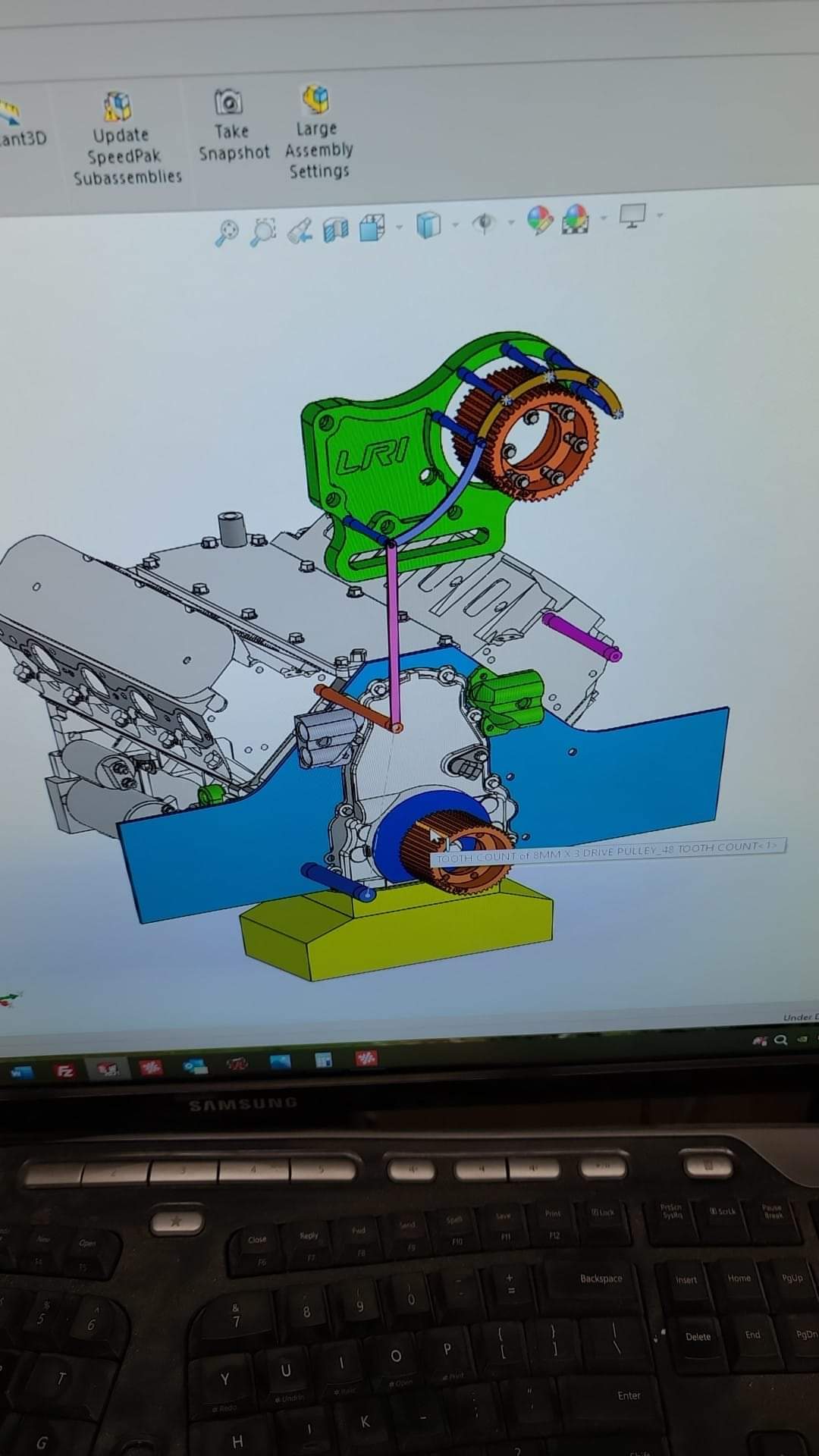

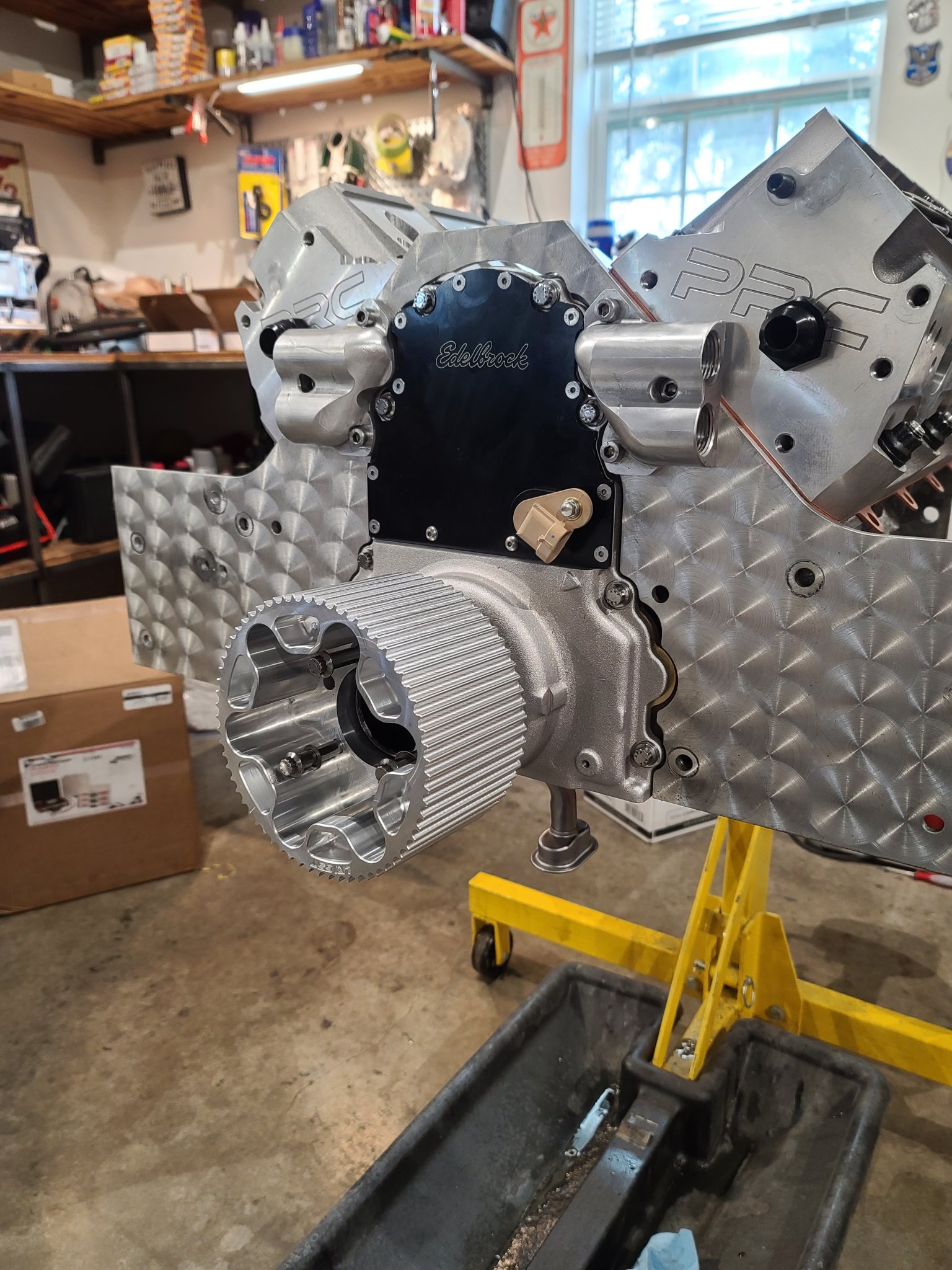

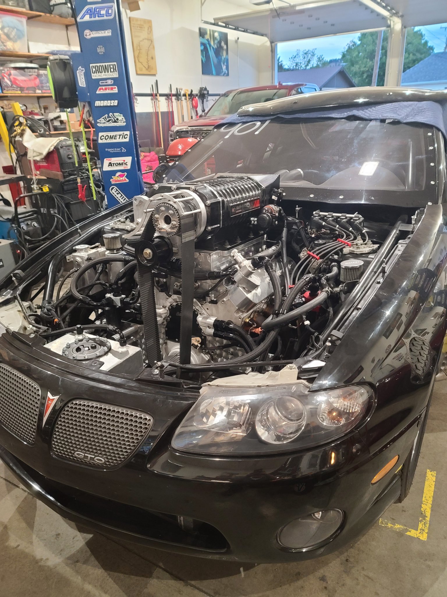

If you want creativity we can go there...
HoOdRaT. Our 6.0L motor with an 8.3L Whipple. I made the entire blower drive from scratch, pulleys included. In fact, anything shown in bar stock machine AL I made.
Heads are one of a kind. Top fuel hooped with the H2O passages welded up. They run completely independent of the block for coolant. Cathedral ports just cause I like to be a dick and prove shit can work if you throw enough effort at it.
A great friend!
