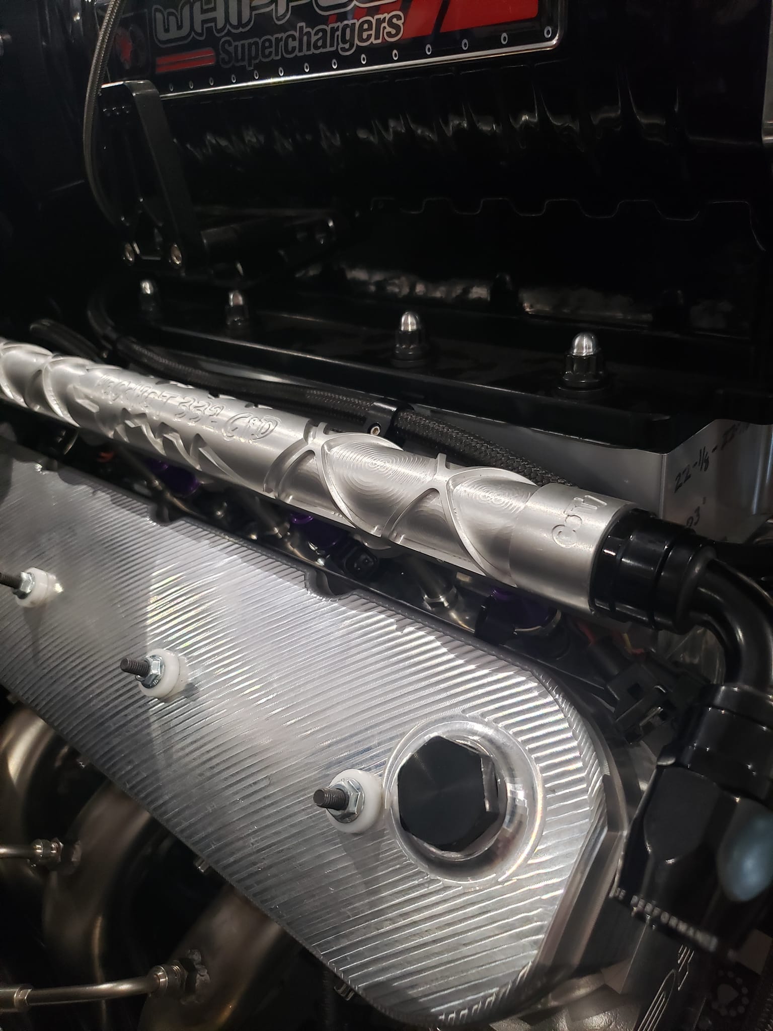

New engine program for this year. Bigger holes, more squeeze, and more boost. Tigging up the coolant ports on the heads as I went to copper head gaskets and top fuel rings. With ARP CA625 head studs, this should manage the 12.5:1 static compression and 40psi boost. The block is now...www.snipershide.com

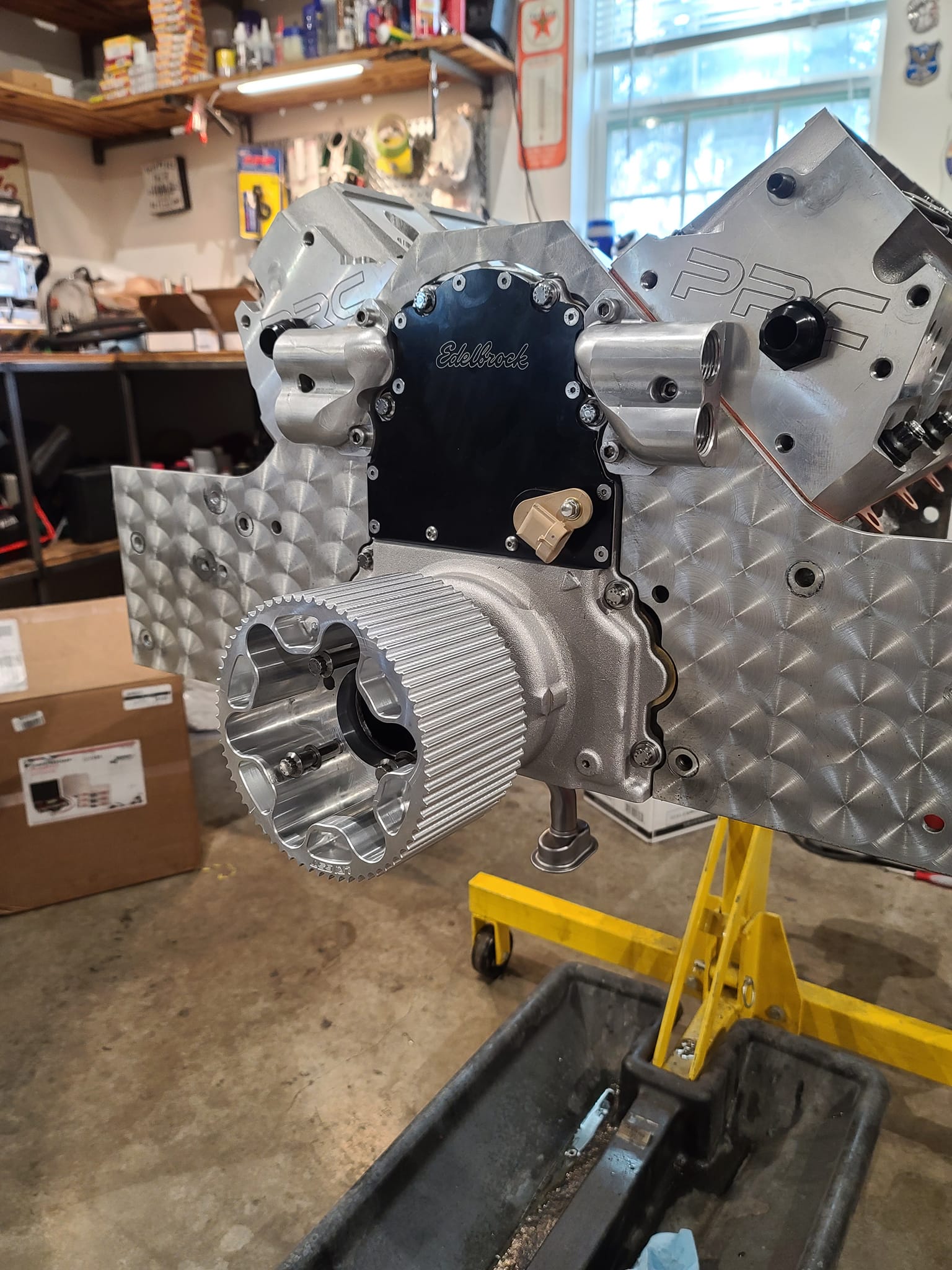

Blower drive pulley. This is the "small one". I bumped it up considerably this year. Were knocking on 40lbs of "sneeze" now.
The new 65T version I did a couple months ago.
Head unit and belt guard Eric and I made last summer.

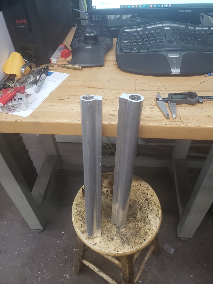

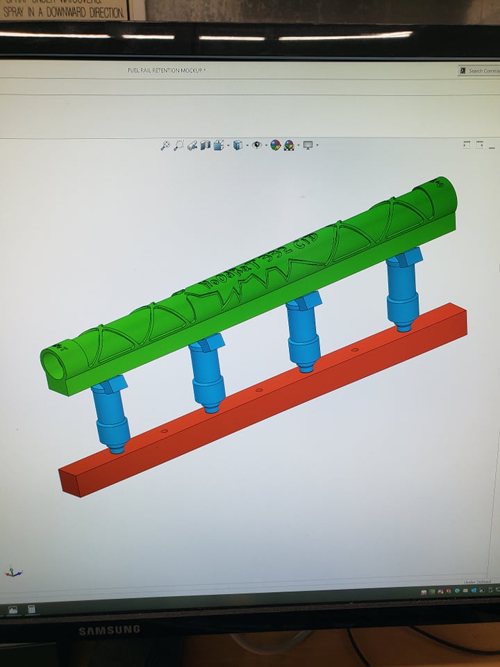

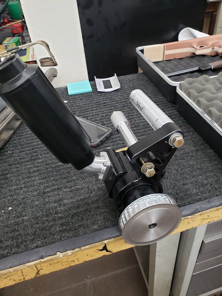

-12AN size fuel rails. I bought the raw extrusions and had some fun with em right after buying our new VF3SS. The belt driven fuel pump that feeds these things is just as absurd. 15gpm@100psi. We consume roughly 3.5 gallons of methanol per burnout/8th-mile pass.

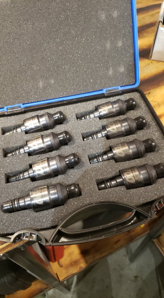

700lb/hr injectors. We run these up top to keep the rotors wet. I mix a quart of Klotz oil in a drum of fuel. Keeps the valves and rings happy and it adds a smidge of hydrocarbon to the fuel so that plug reading doesn't require a Oujia board. The manifold has ID2600 injectors.

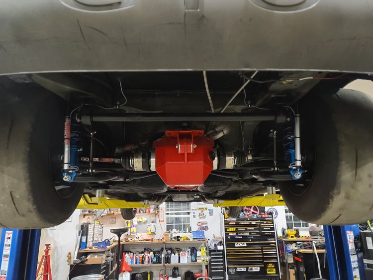

The IRS setup. Travel sensors from LowDollar Motorsports. I ended up making the reluctor wheel we use for the traction control on the drive shaft. Everyone I found is super narrow and invites "noise" in the hall effect sensor that picks up the signal. Running it fatter seems to clean it up. We see a nice linear track on the data logs.

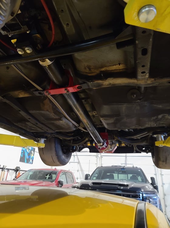

Carbon drive shaft. Lets see Proof make one of these, lol.

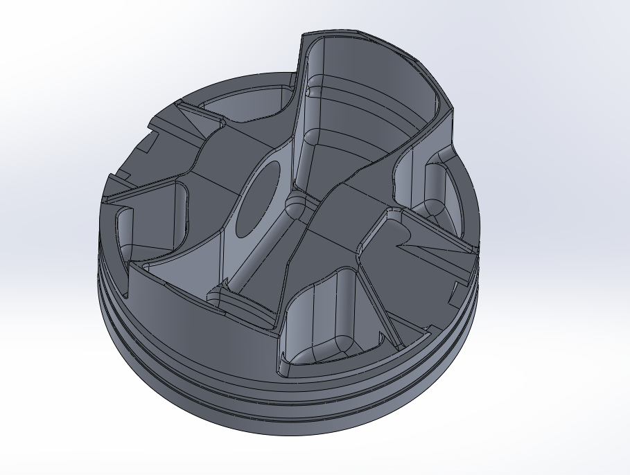

Something I've been tinkering with. Billet pistons... Not there yet, but it's close.

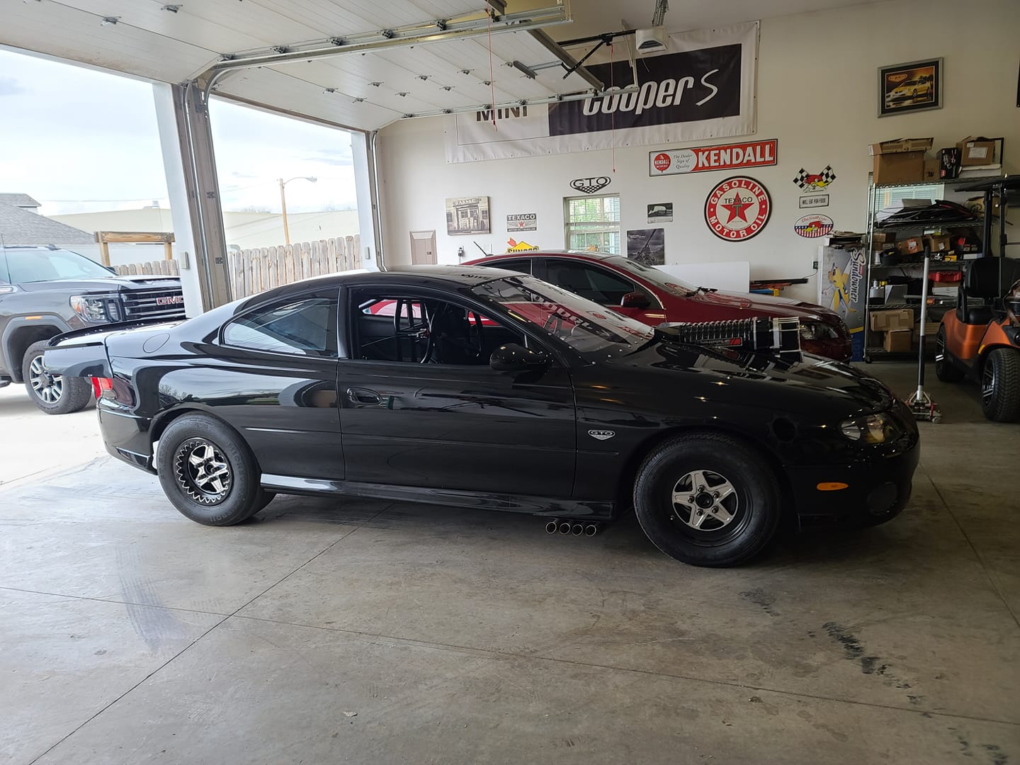

At 1.1 seconds indicated wheel speed was right at 66mph. Over the next 3/10 of a second, it jumped to almost 170mph. (PARTEH, lol)
Lol, that’s fucking hilarious. Real deal drag cars are absurd in the best ways possible
I like that the car is loosely built around the blowerHere's what this dumb thing looks like.
We joke that we all played with too many HotWheels cars as children.
Made some passes last night with the racin' car. We pulled 20 degrees of timing out of the motor off the hit to try and soften the launch. (This is a sort of crap shoot as radial tires often respond better to be smacked so that the sidewall stays "stuck", but we tried it anyway as the other pathway didn't work for shit) Timing then was ramped back in over a 1.2-second interval. The 60' sucked ass with a 1.7. (We've been 1.23 before) At 1.1 seconds indicated wheel speed was right at 66mph. Over the next 3/10 of a second, it jumped to almost 170mph. (PARTEH, lol)
Needless to say, Eric was peddling the snot out of it after that. The shock sensor logs resembled something from the San Andres Fault.
Lesson:
The motor makes some onion. Now we just gotta figure out how to make it stick on no-prep tracks. Not the easiest thing to do with an IRS rear end, but it makes it fun regardless.
Good times.
