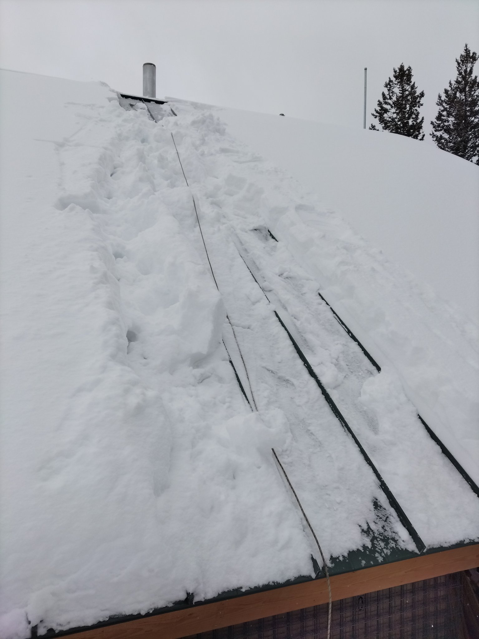

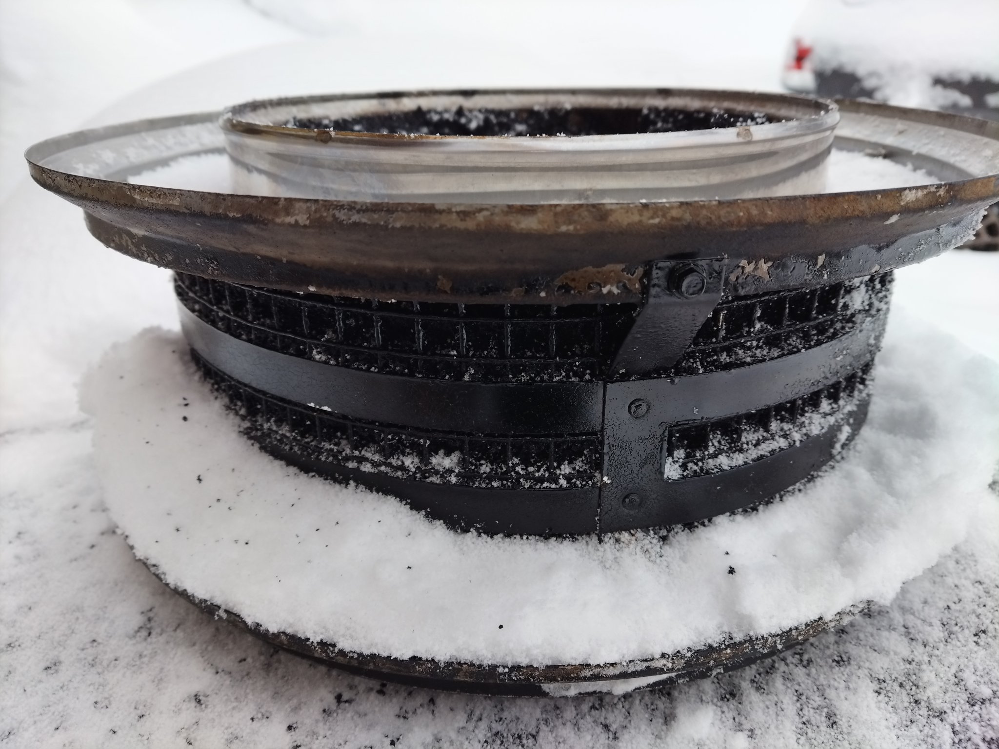

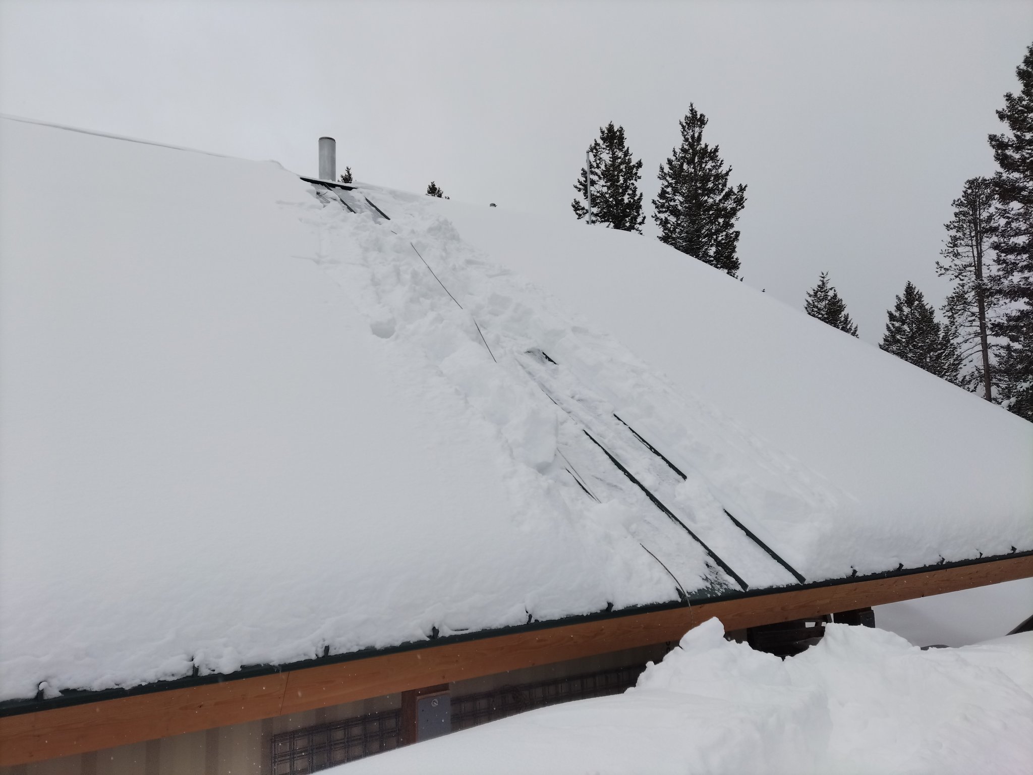

Had to climb up on my roof this morning.
Last couple nights, the house was filling up with smoke every time I opened the door to the stove to load more wood into it, just enough to give me a sore throat and make the house smell like a camp fire.

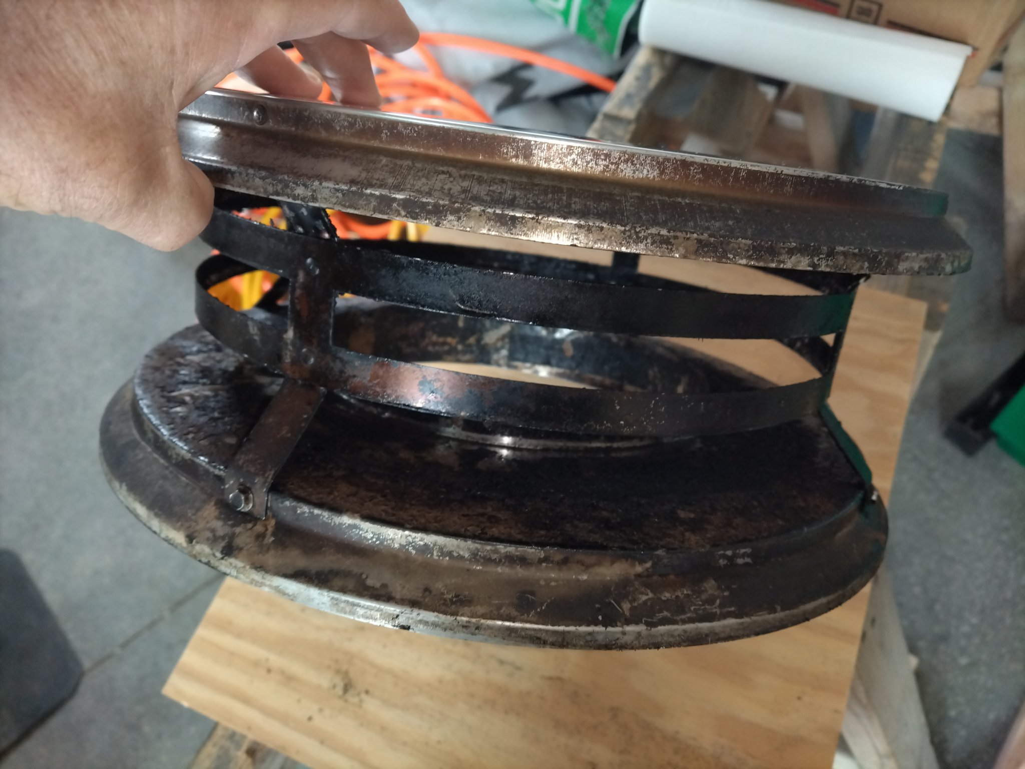

Found the spark arrestor in the chimney cap clogged with cresol. Been in the mid-20's last few days, and snowing constantly. I don't like the house too warm, so the wood burner has been dampened down quite a bit, especially at night when I go to bed. Think the combination of that, and the snow created the perfect storm.
It was a challenge getting on the roof, but luckily there was a thin glaze of ice on the steel panels that actually provided a little bit of traction, but the last eight feet it was bare steel and slick, and the anchor that I installed on the roof was just out of reach, but after several attempts, I was able to grab it and pull my self up on the ridge. Another good thing, the seven feet of snow piled up at the bottom of the roof allowed me to transition to the roof without needing a ladder.
Once the cap thaws out, that damn spark arrestor screen is getting removed permanently.

That's at least twice every winter for me. I live in Louisiana and the humidity here seems to increase the creosote buildup. I removed the screen one year and started finding dead birds in the heater, so I put it back in. I use a bristle brush to clean the pipe while the cap's off. I have a shingle roof and very seldom see snow here.

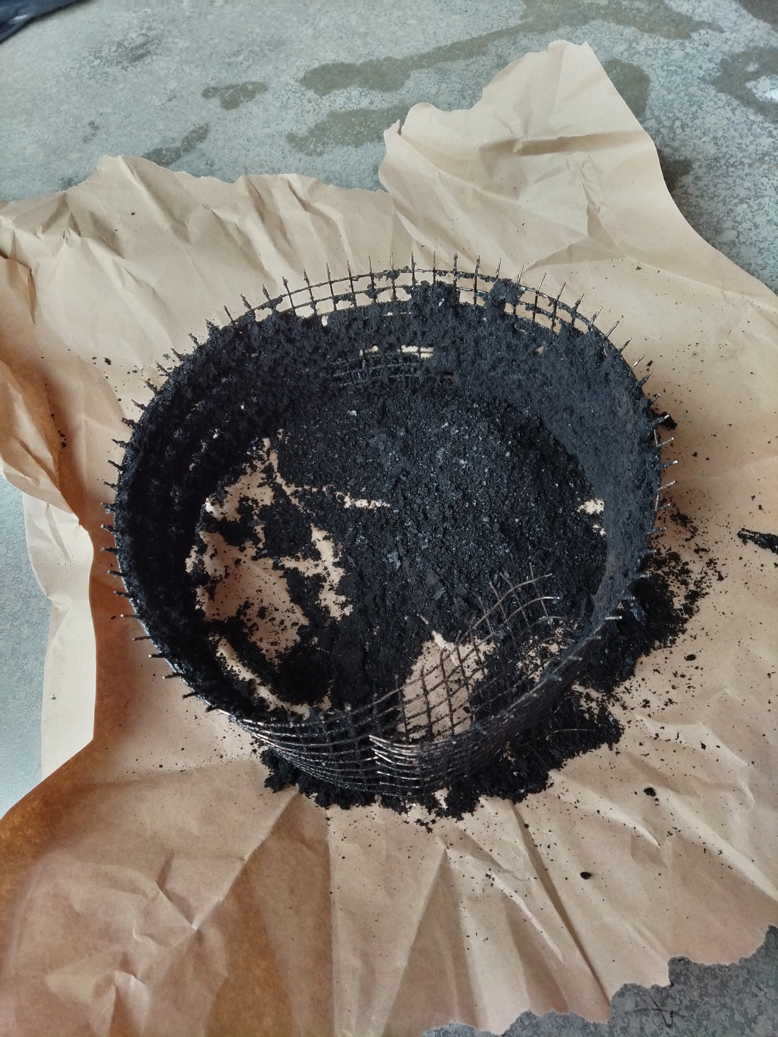

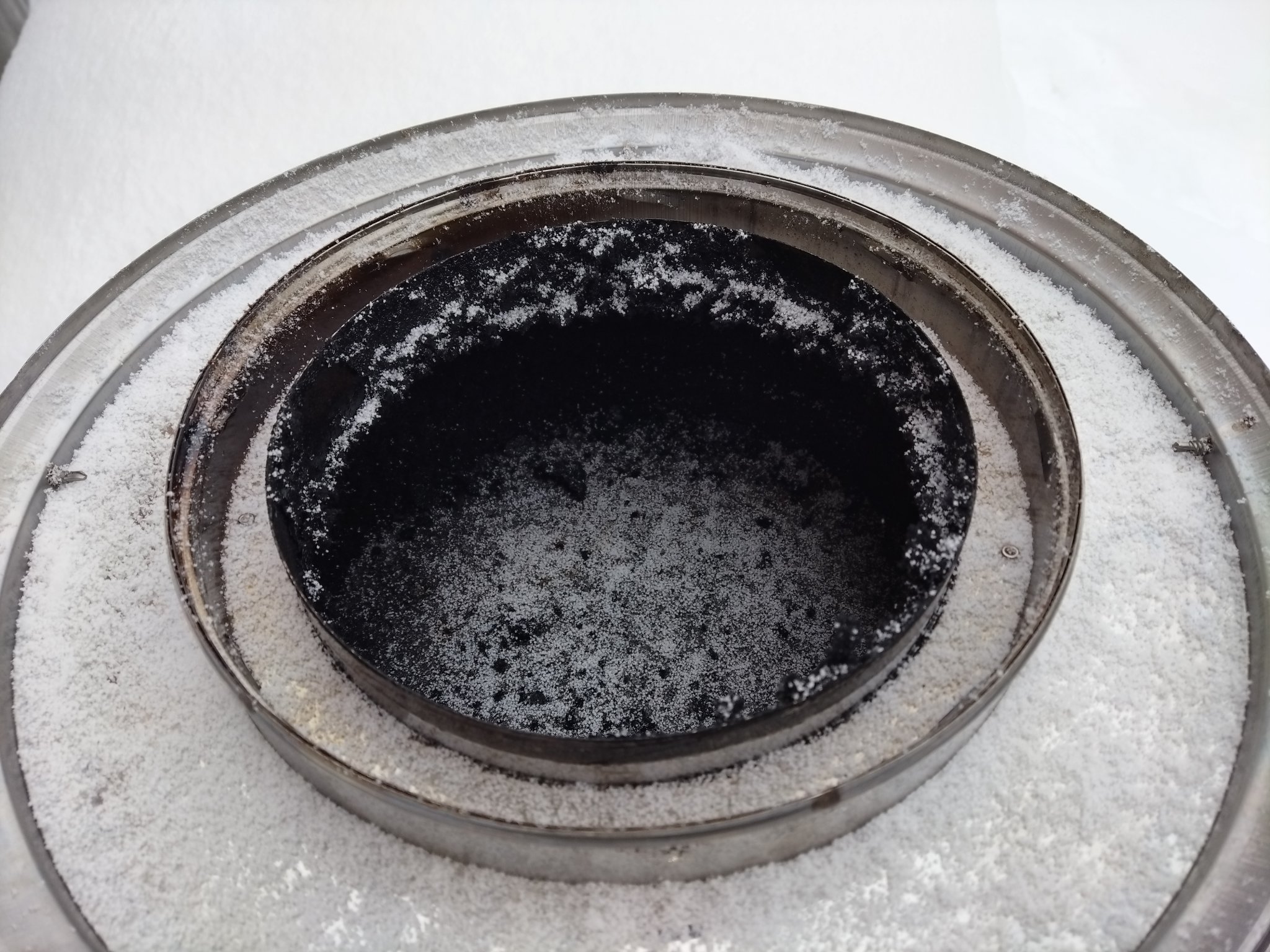

The cresol built up inside the cap was like spray in bed liner, and tough to remove, lucky there wasn't much to speak of in the pipe. Screen now removed.
Rope is staying put, I've got an antenna I need to put up this Summer so I can reliably hit repeaters, as the metal roof prevents me from transmitting from inside without an outside antenna.

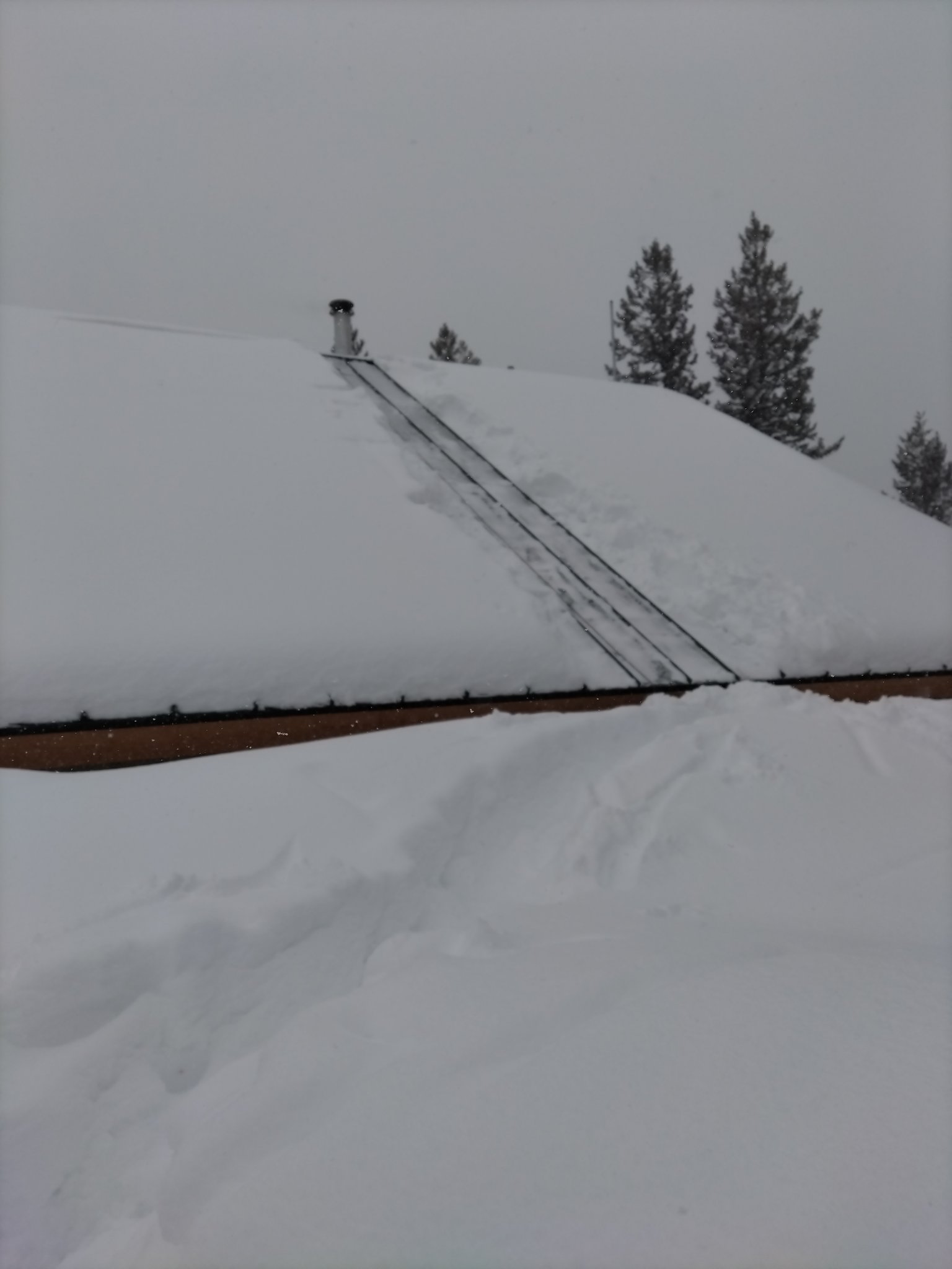

View attachment 8351521View attachment 8351523View attachment 8351524
Your cap looks like it would still keep birds out without the screen. Mine's wide open.
Meh, I use some good ole oak and get the flames jumping up the chimney. cleans it out fine as long as you don't let the creosote get too thick. Usually 2 to 3 times a year. Probably shit for the pipe in the cabin as it's single wall, but the bottom 4 feet usually glow when I clean it out.

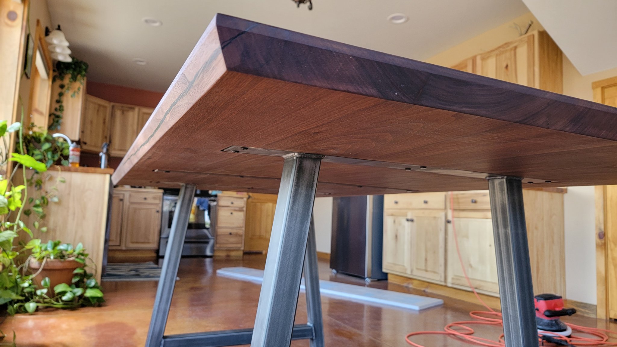

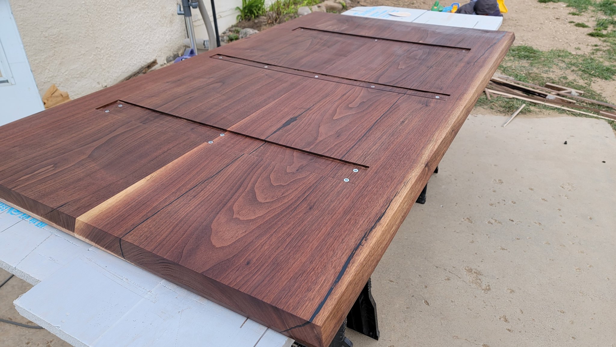

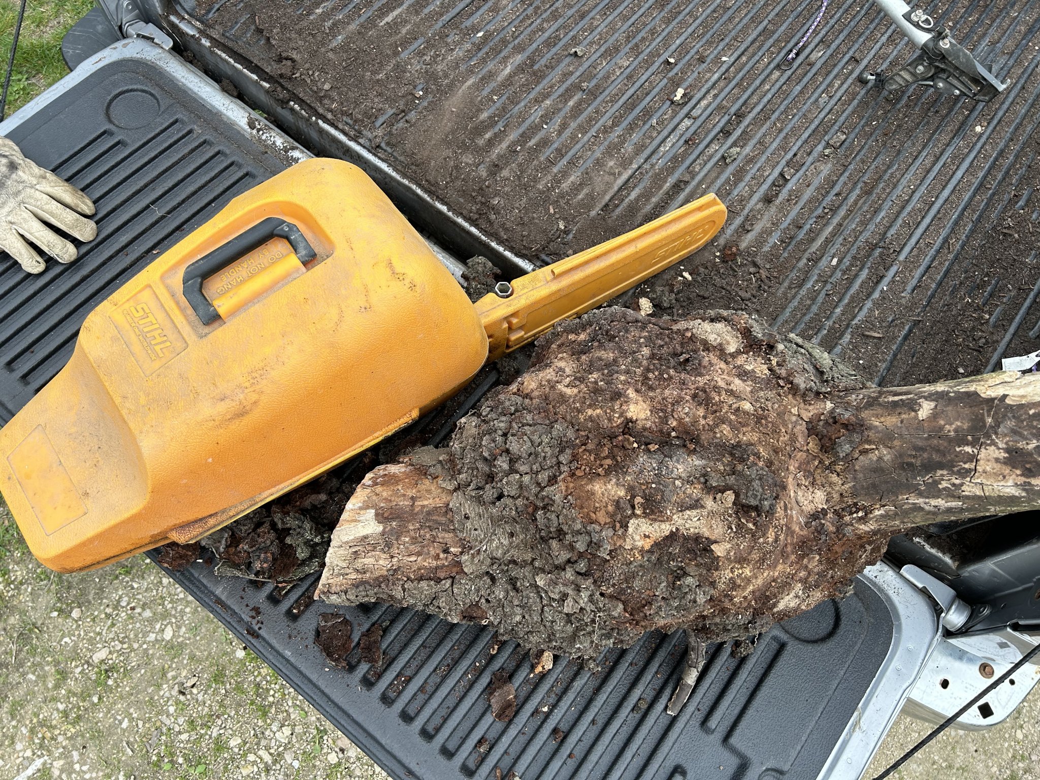

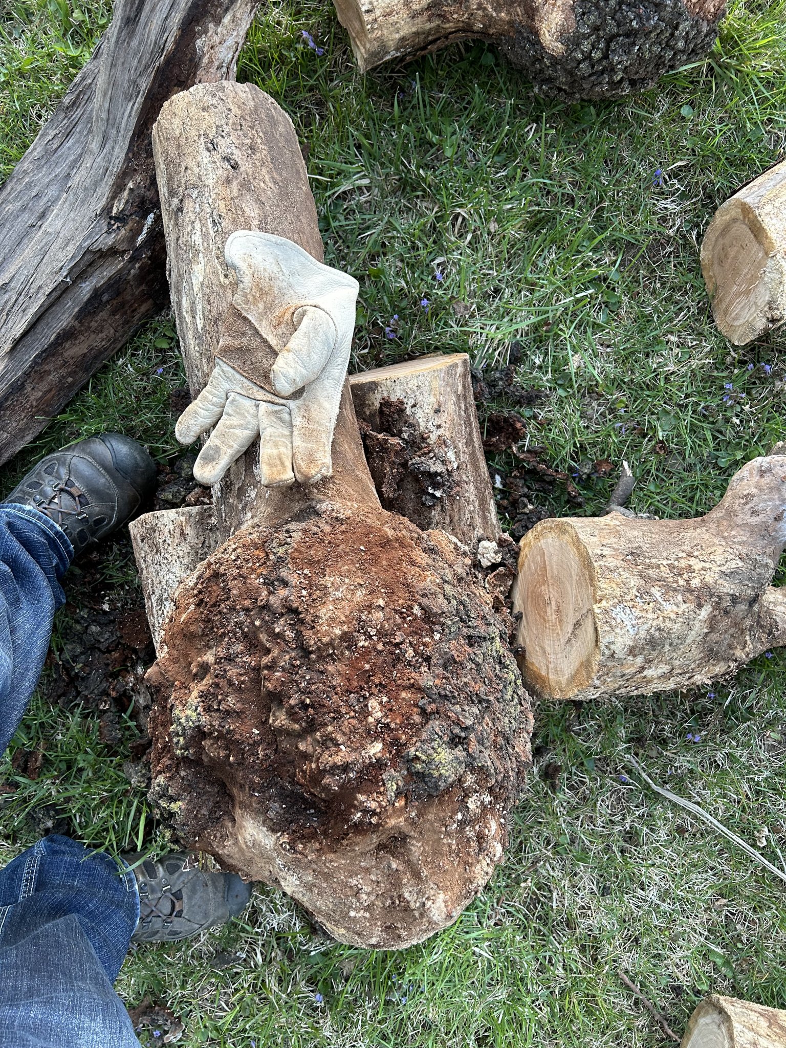

A pair of cherry trees blew the tops off back a couple of years ago. On the neighbors property. Visiting with him over the weekend and asked if he would mind if I harvested the burls. Found a half dozen over all. These were the biggest.
I’d take them off of your hands if they’ll fit in a flat rate box. They can be used for many things and I’m sure the guys you work with would be happy! I’d likely slab them into 1 inch thick slabs unless they had truly exceptional figure, and in that case I’d cut 1/8” veneers out of it.
Nice.
If you harvested the wood it fits here. It also fits over in Wood Shop.
Maybe also metalworking if you made the legs.
