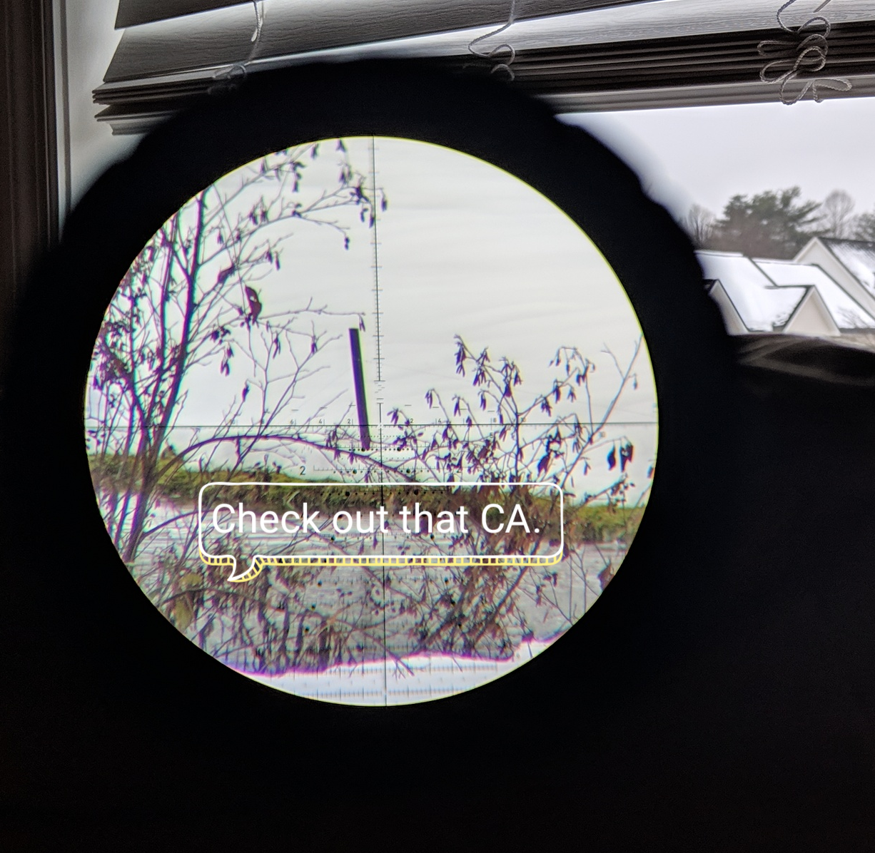

    To all you guys who have complained about chromatic aberration, I apologize to you.
    See, in my heart, I laughed at you and thought my eyes were superior to yours. I own a k624 and scoffed at all the complaints of CA, because I never saw it. Surely all you CA complainers were just whiny little bit**s.
    Well, I stand corrected. Today I looked through a new scope at the snow covered landscape and thought I was tripping on LSD.. the colors would have been amazing if they weren't in a $3200 scope.
    Anyway, no longer will I feel smugly superior, I have joined the ranks of CA true believers.
    And yes, for all you CA apologists, I DO think it would have made me miss a target. :)
    All kidding aside, I won't tell you what scope it was. My experience with the K624 leads me to believe that CA can show up on a scope by scope basis. I looked at that same scene through the k624, no CA. But I will post a picture.
    Holy shit...I have a Vortex Crossfire II 6-24X50 scope that cost me $250 and it has none of that. Some CA at 24X but it's about 10% of that ...noticeable but not all that bad, $3200 and that much CA?

    I wouldn't be too quick to evaluate the amount of CA based on that photo. You can induce a lot of CA that is not visible to your eye under normal conditions by how you align the camera to the scope.
    I do not doubt the OP's words, but you can not compare what you see with your eye through your scope with a picture taken with a camera under uncontrolled conditions.

    Trust me, I have no dog in this fight, I didn't even believe CA was much of a thing before this scope.
    The CA was worse with my eye. The picture actually kind of lessened it.

    This is worth noting. My T5Xi had hardly any CA if your pupil was perfectly centered on the optical axis. Anytime I got off center at all, it would get bad, and getting really off center would make it really bad. You can do the same thing with a phone - make the CA look way worse with the camera positioning than it really is when viewed through the scope normally.
    My SWFA HD 5-20 has a little bit when you get really off axis, but almost none the rest of the time. I could take 2 pictures through the same scope and make it seem much worse or much better than it is depending on which one I show you.

    I am not arguing with that at all. The only point I am making is that judging the amount of CA by looking at a through the scope a picture is not a good way to go.
    Also, if the scope was not set-up for your eye correctly, the amount of CA you see can be notably higher than it would be otherwise.

    Yup...it's annoying AF. It does make me laugh because there are people that dislike people that dislike CA i guess they just attached part of their soul to their optic idk.. My point of contention has always been it's not that big of a deal until a certain price point. Past a certain point i expect little to none...
    Without knowing what manufacturer it is they obviously use the tremor 3..so there's that. Sample size is also a factor sometimes even at that price point.
