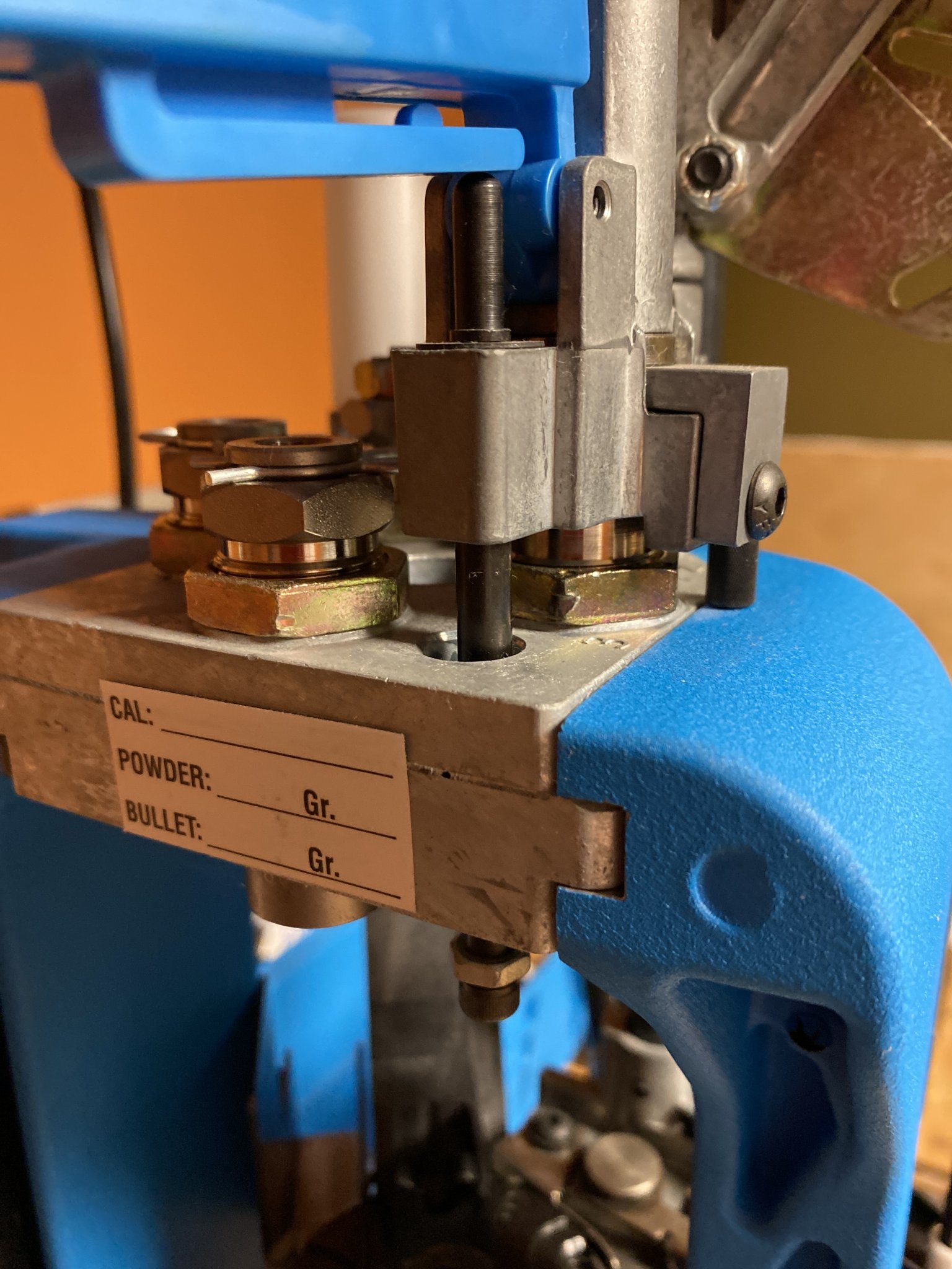

The primers don’t always seat as precise as I like them to be. The dillons die holder thing wiggles to much also. There are 3rd party die holder things however that are rubber coated that fit snug (if you didn’t know).

No not shellholder plate. The thing that the dies screw into

Toolhead is what you’re looking for. The factory Dillon tool heads float, so there is a little bit of play between the toolhead and the frame of the press, but differing pressures from simultaneous operations (decapping, sizing, seating, etc.) can impact the die alignment in any one of those operations. There are aftermarket toolheads that are secured in the frame eliminating that play between the tool head and the frame. The individual dies are “floated” using die rings that allow a little play. This allows for better alignment of each operation without one of the simultaneous operations on a progressive press impacting another operation. I use Armanov toolheads and die rings and am very happy with them. I’ve heard good thing about Whidden’s set up as well.
With a few modifications such as this I‘m very happy with the results for my rifle ammo. I don’t use the Dillon powder measure for my rifle loads but rather use a funnel in its place and hand drop the powder from my AutoTrickler. I also have a co-ax and Zero press but still load a lot of rifle on the Dillon. Most case prep is still done on my Dillon 750 - it’s just easy.

Ah, as mentioned above, that's toolhead. I misread- I thought "primers don't seat as precisely" and "wiggles too much" were one connected thought. My bad. I have applied coffee as appropriate.
Re: float in the toolhead - it needs some level of play, either via floating rings or the toolhead fit. How you get there is a debate I feel borders on personal preference.
