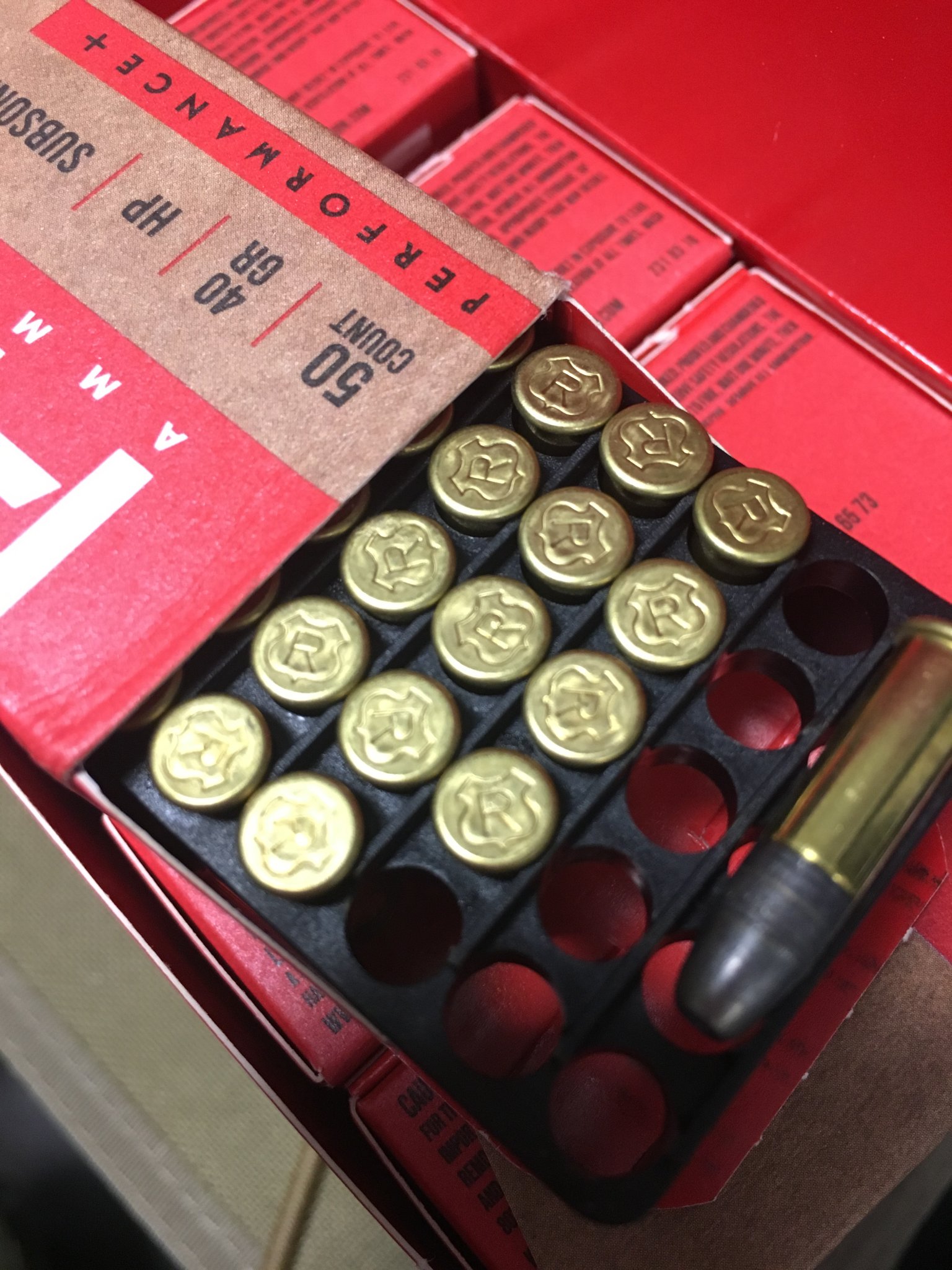

    Received mine yesterday and function tested it in a bolt gun suppressed and my stock ruger 10/22. Both functioned flawlessly. The suppressed bolt gun was dead quiet. Here’s a headstamp pic for those who asked.

    So it's RWS/Geco.

    I agree, it would be great to know which one is being rebranded. The pricing falls in line with what Geco has been selling for recently, although the Geco Semi-Auto is running a little higher than the Bolt Action, or at least it was when I bought a case a few weeks ago.

    I think we've already determined its RWS HP SS. It usually goes for $0.11-$0.12/rd, so about half off.
