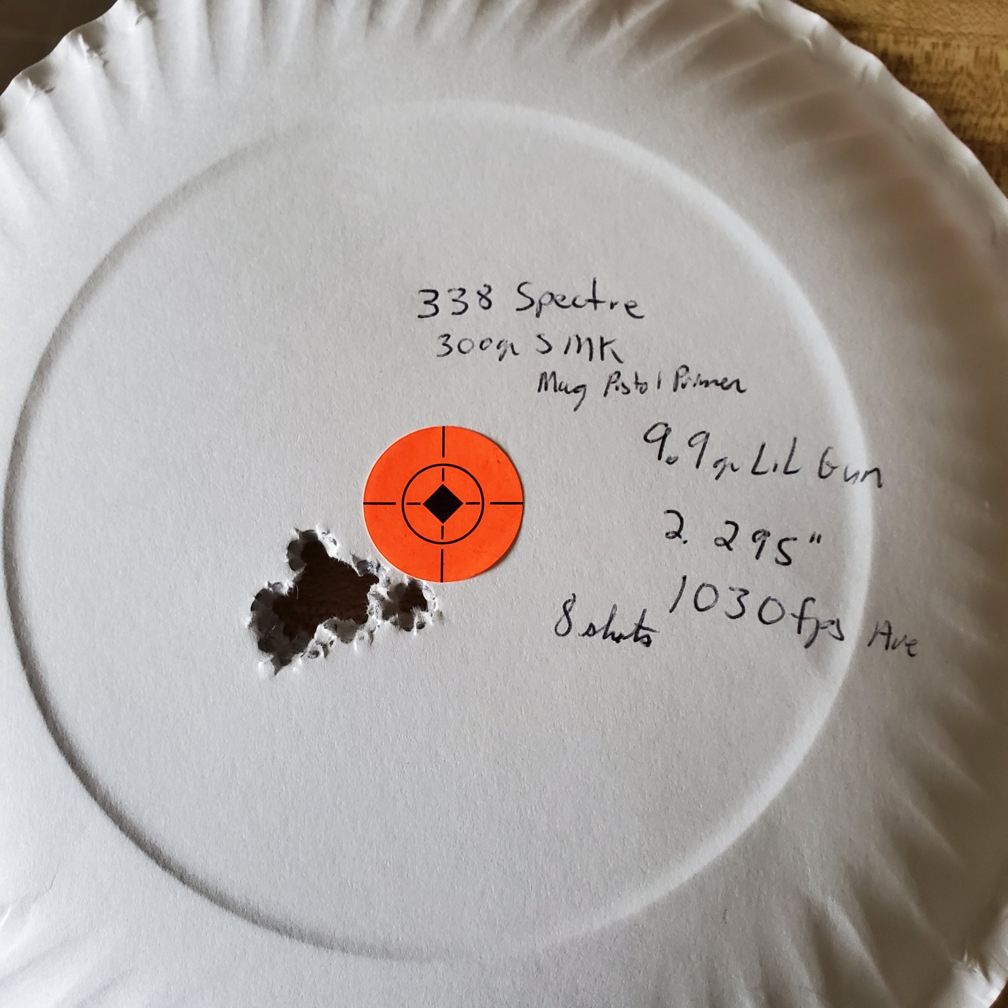

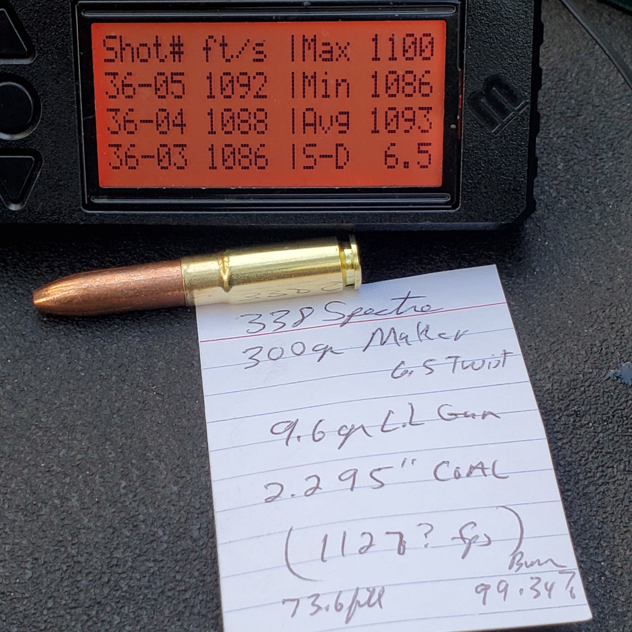

Pic of 338 spectre the slightly shorter length vs the 338 ARC. These two are better performing cartridges for subs, excellent accuracy and low velocity spreads.
The 338 Spectre every bullet has been accurate from 160 gr Barnes supers to 350 gr Maker (handloads) with single digit standard deviations...this should be very similar to what the 338 ARC will do.

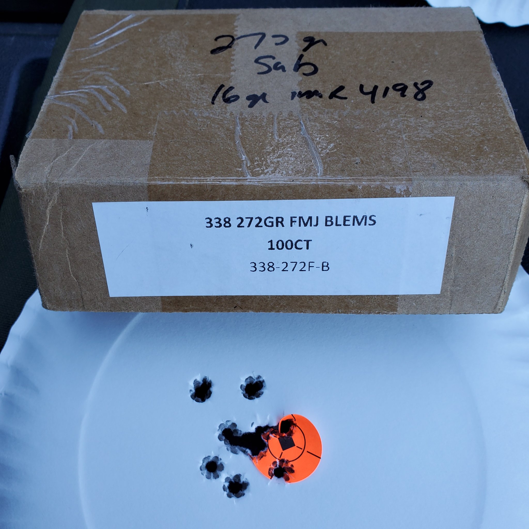

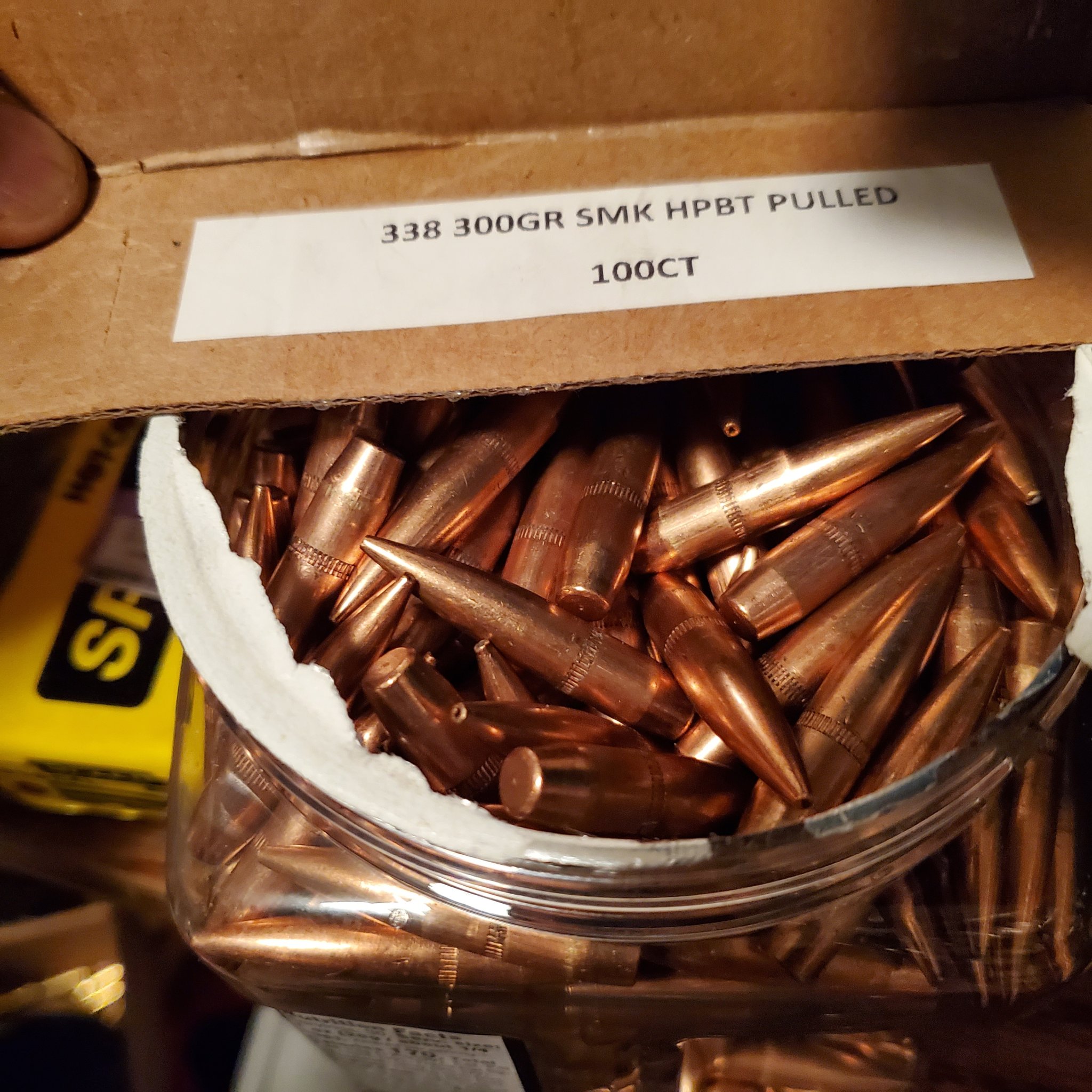

But since I waste a lot of ammo, and decided to try some factory 2nds and pulled bullets.
American Reloading has the 272 gr FMJ on sale .30 each shipped and 300 SMK pulled for .56 ea shipped.
Bought 500 ea to try.

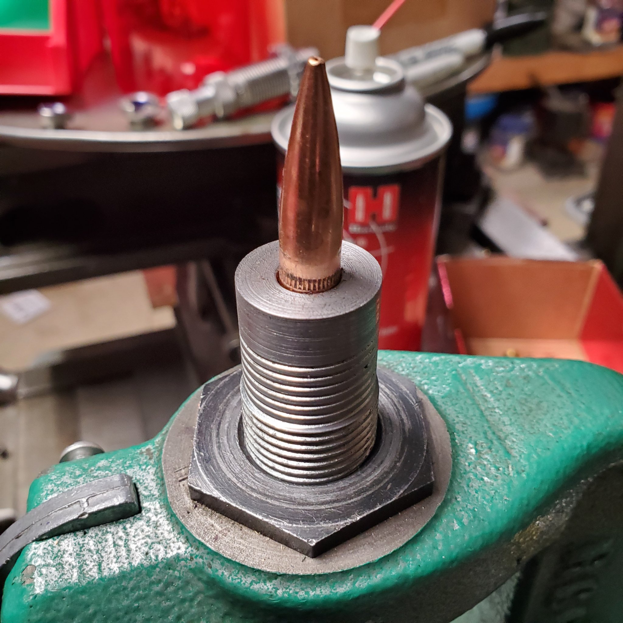

The 272 gr I got were good to go as the arrived ... the 300 gr SMK need to be sized.
Pull marks mess up the OD.
Made a sizing die and sized them all. One could use Lee bullet sizing die in .338" but I made mine .3378" to get the pulling dings out so they seat nice in the case.

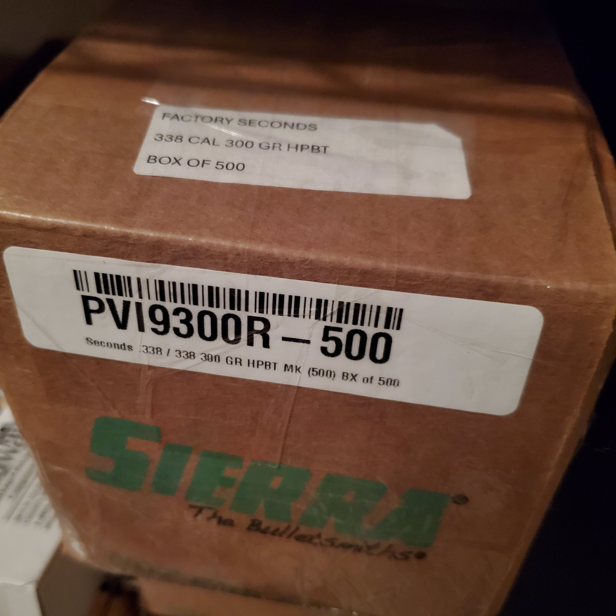

The Sierra factory 2nds were .47 ea no sizing needed.
I shot alot of the 272 gr FMJ and find accuracy typical of most FMJ bullets, good for plinking, but not the best in accuracy.
Sized 300 SMK. Running through the homebuilt die.
Factory 2nds from Sierra are not pulled bullets no sizing necessary.
Next 272 FMJ subs

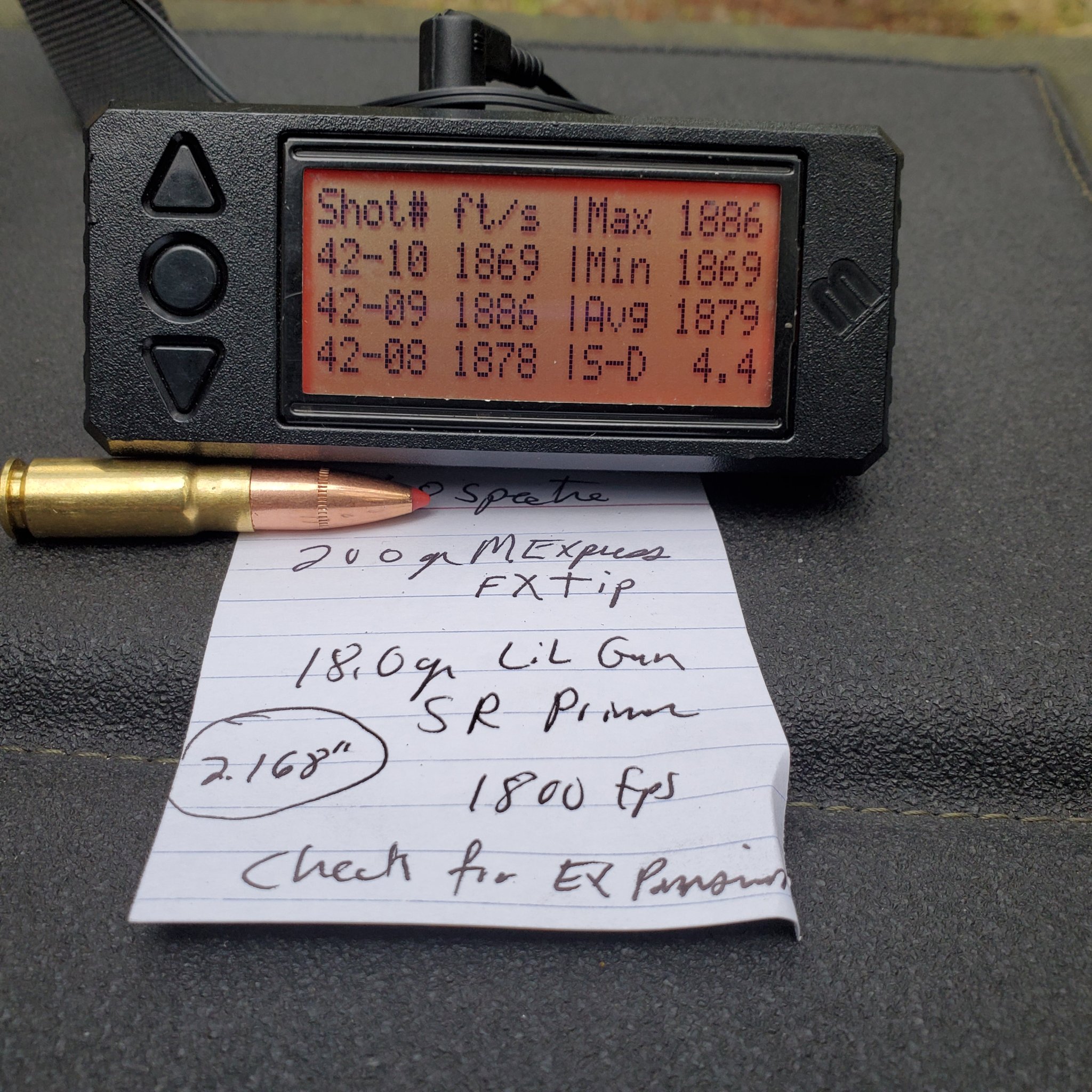

Next resized 300 gr SMK supersonic load.
Which shoots good in my rifle.
DO NOT shoot in 3 twist this is a high velocity load for bolt guns and 6.5 twist.
It hits the target hard and has a fair amount og recoil, as it tends to knock over the target, when shooting steel.

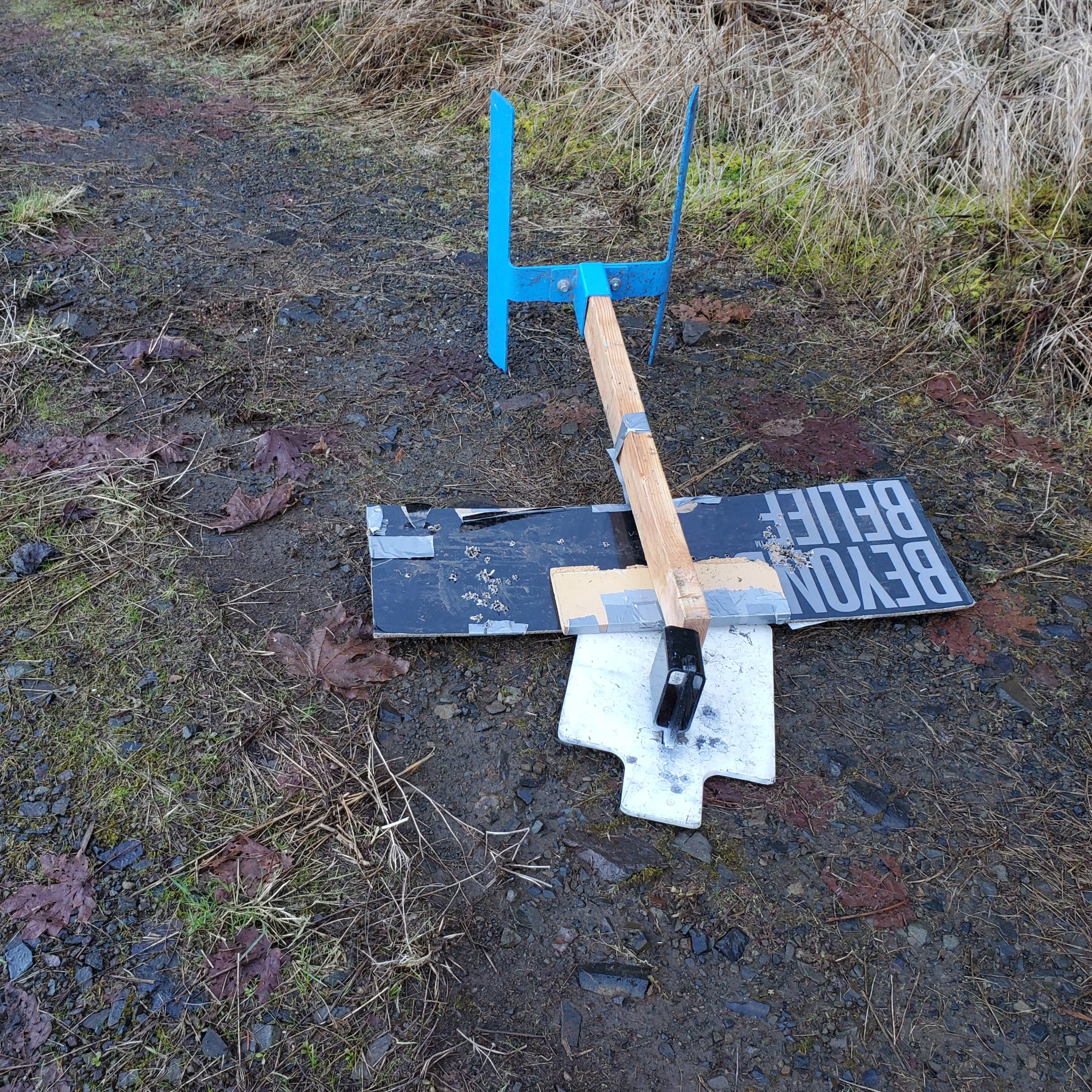

Just for informational purposes on what might work for you getting the cost down when shooting the 8.6 Blackout.
My choice is stay with the 300 gr match bullets, and use factory 2nds or pulled resized seem to be accurate, as shown.

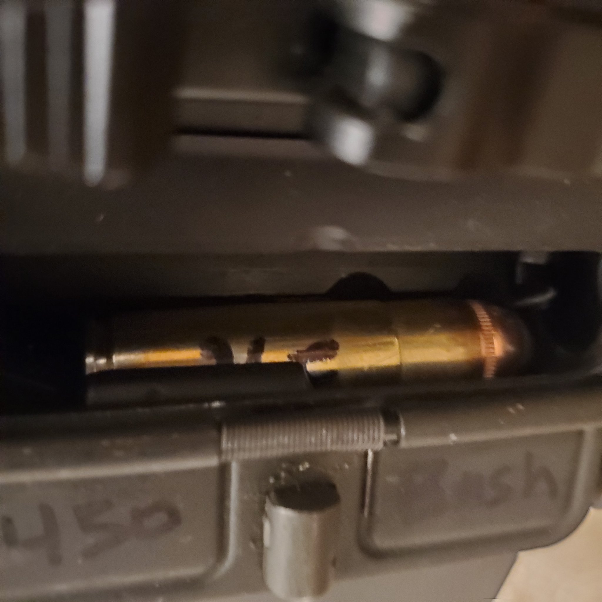

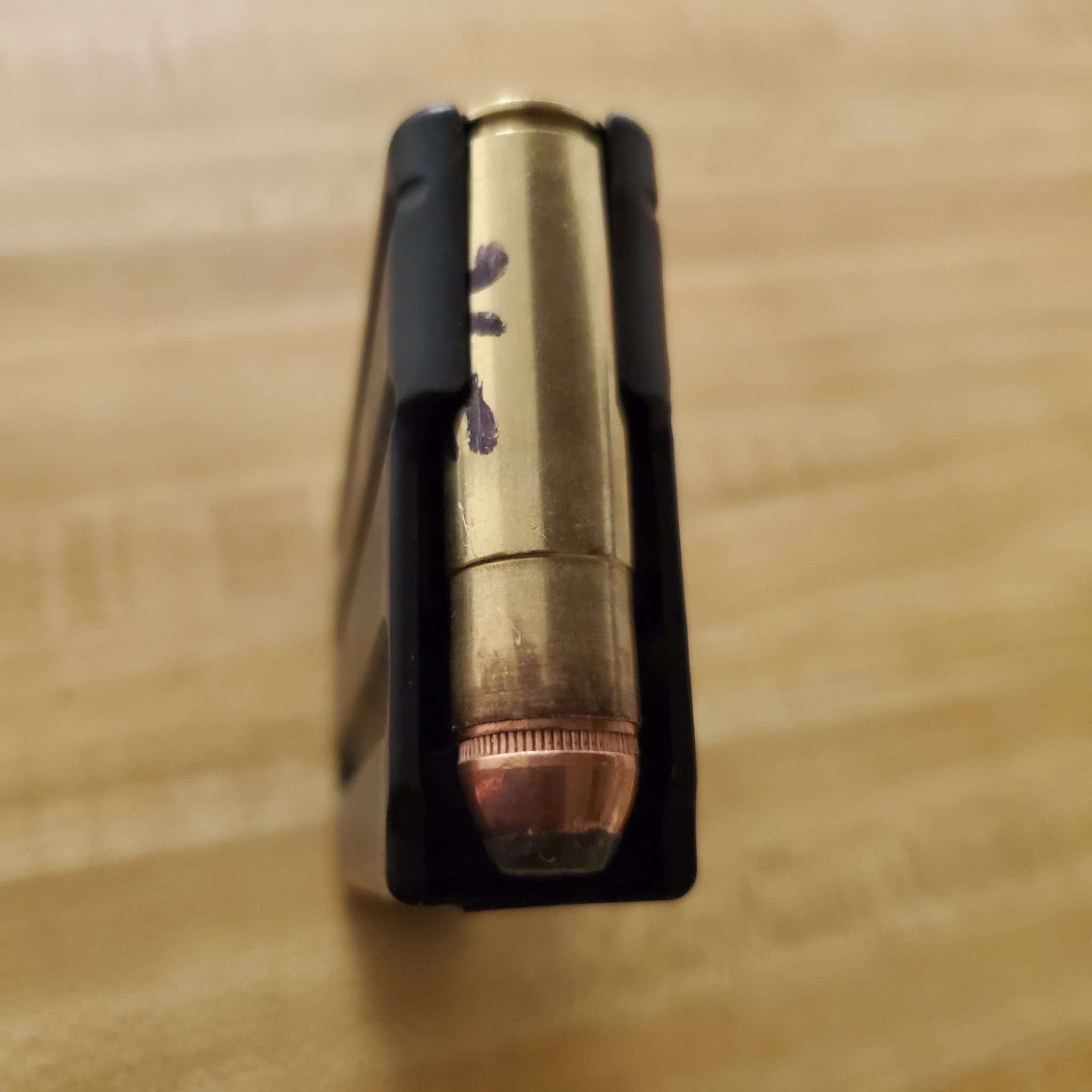

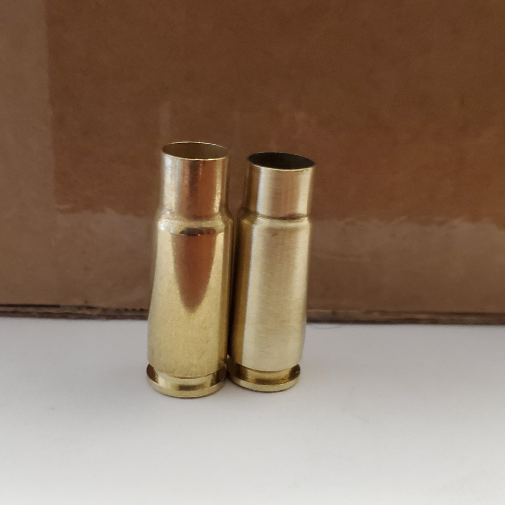

So I had to see if it is possible, and yes it is, but would require quite a bit of machining
The 450 bushmaster mags will work with some machining, and so will the brass... cut the solid head down and new extractor groove cut.
Now you have .510 cal AR 15 but only for short bullets, 300 gr soft point supers to 350 gr copper subs .510 HG Lehigh Defense bullets that expand at 900 fps.
But you'd have to machine a 16" AR 15 barrel from a blank, with a 450 bushmaster barrel extension.
I have the 510 whisper reamer, I could do that.
Anyone interested, besides me.
