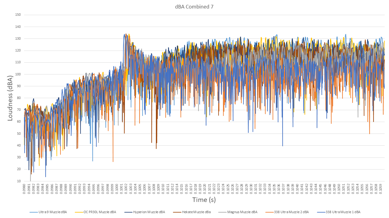

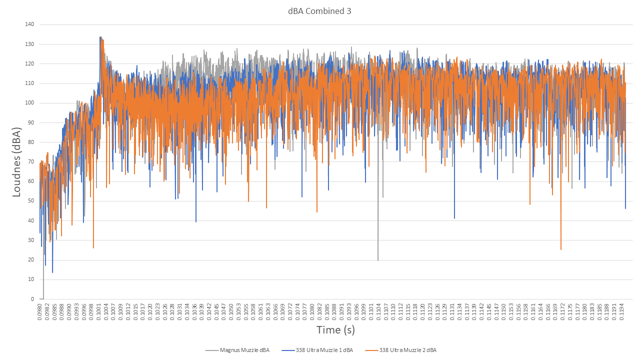

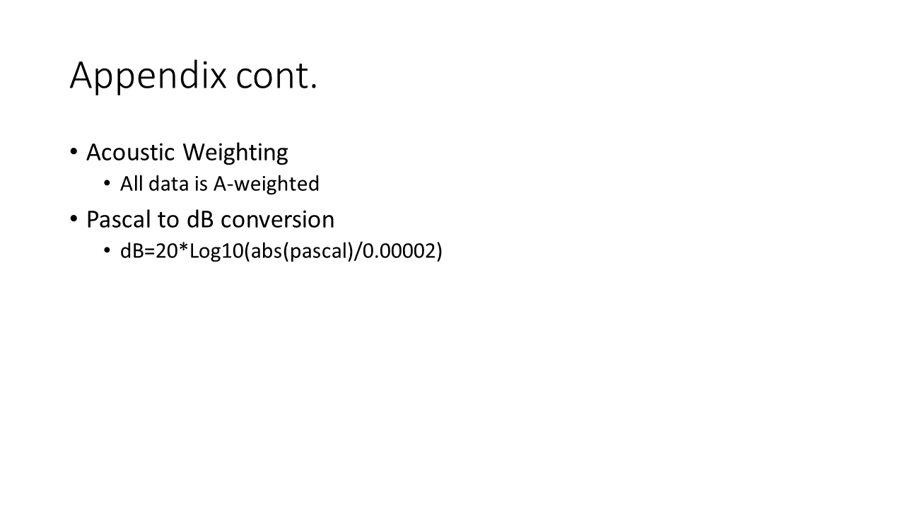

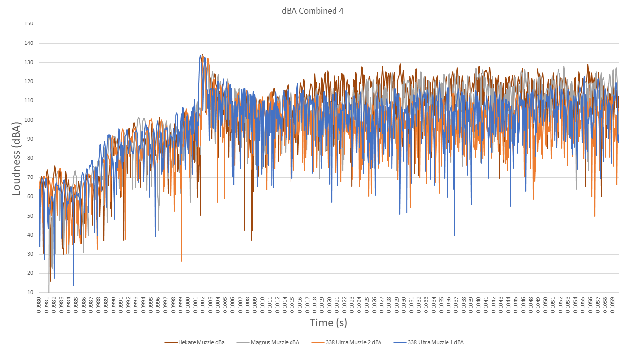

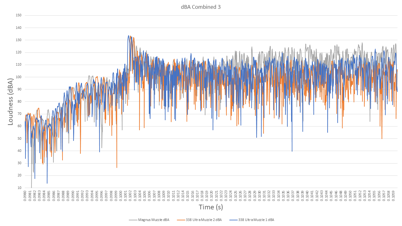

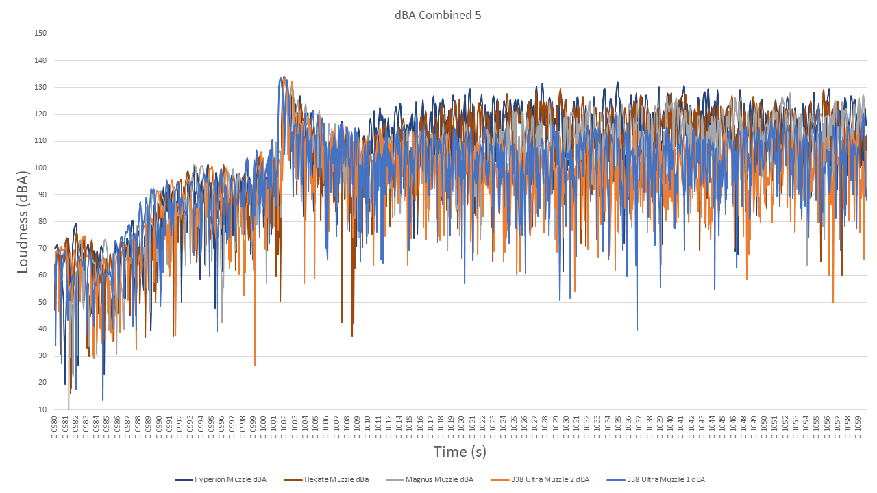

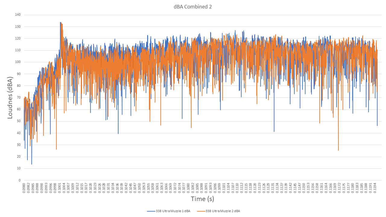

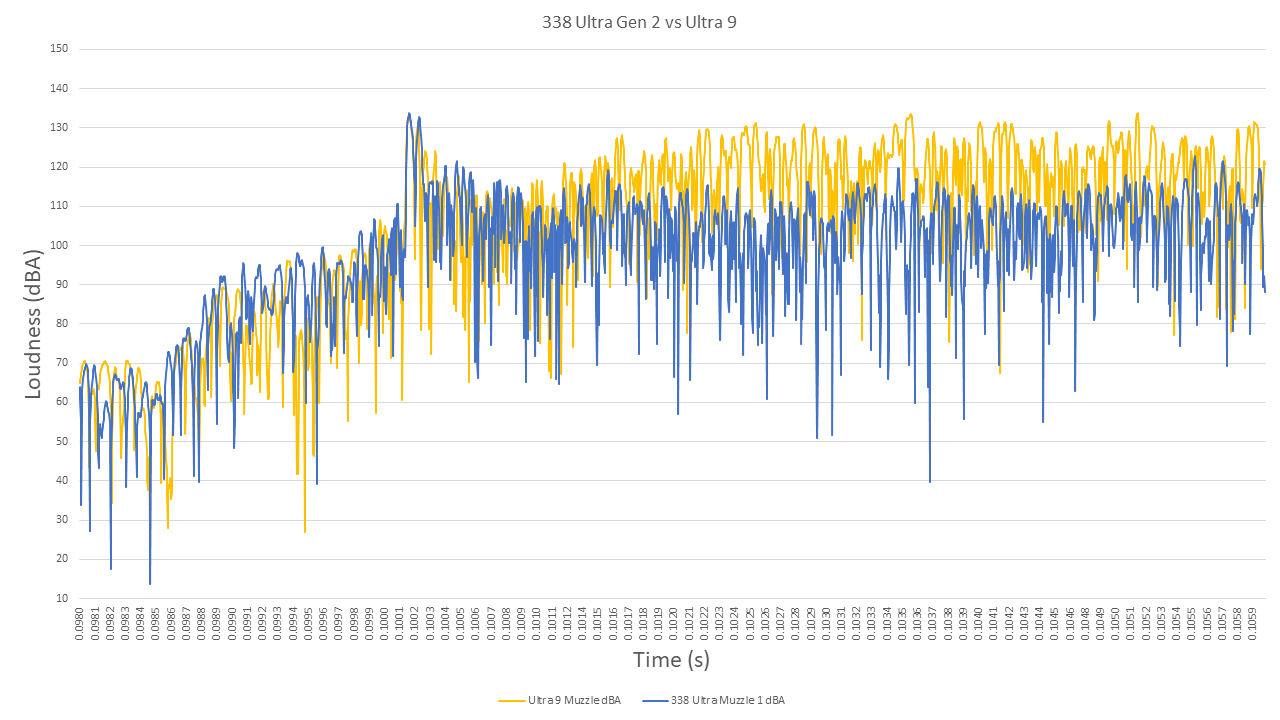

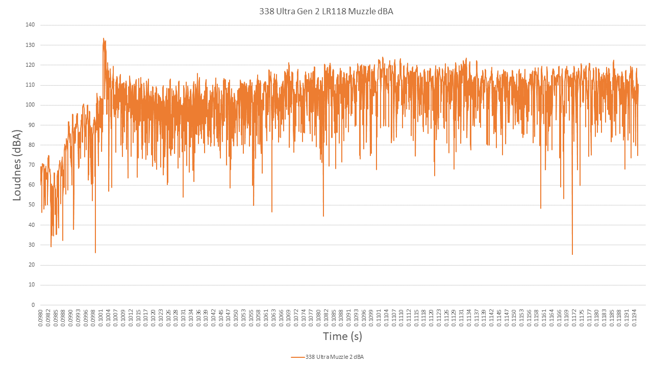

Well the title pretty much sums it up. In trying to be as transparent as we can here is a short video explaining how we get the numbers we do. This is the first of many education videos to come. We want you guys to understand what we can see with the PULSE and how and why we use the numbers we do.
Close ups of the plots
