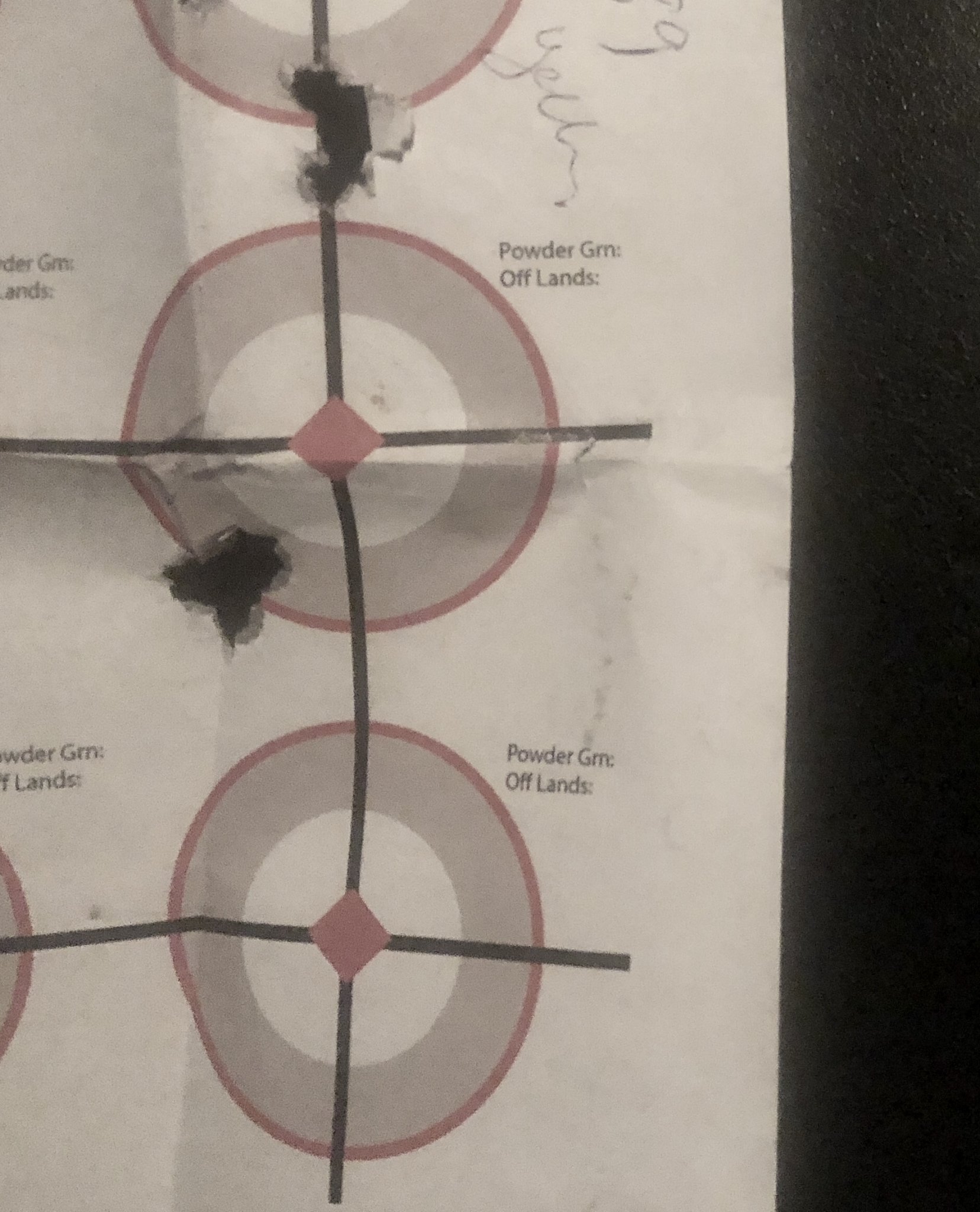

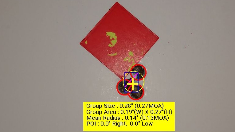

Shooting some hand loads for the first time. I will do more testing soon but in the meantime... One group is really small but the other group has hardly any vertical spread. I'm assuming that the small vertical spread is better specifically for long range and the fact that the side to side is probably me. Which load would you focus on?
View attachment 7011904View attachment 7011905
Did you aim at the same place with the same scope settings? If not that is a fairly large offset for a 100 yard group.
There is a pretty significant POI shift from load to load, especially with different weight bullets. It's repeatable.

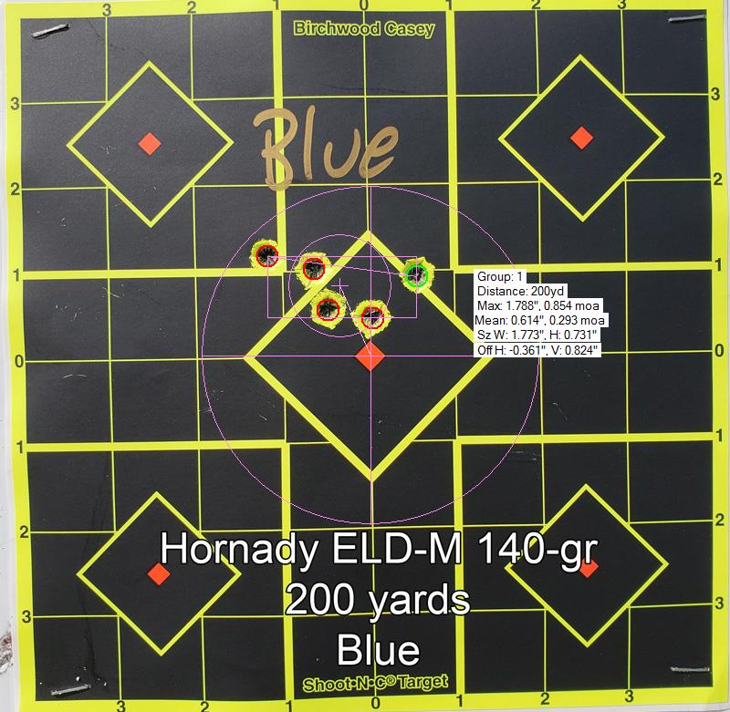

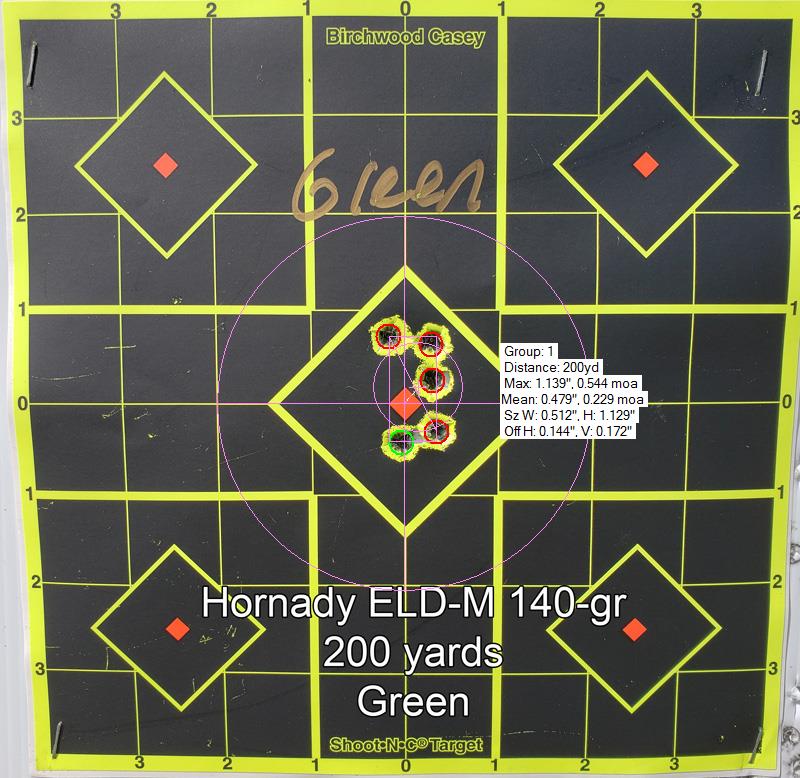

So, for example... Which of these two wins the day? (I don't have the chrono data for them.) Green? Or, Blue? :) This was Load Development Pack #1... so, it's five different powder loads.
Green - smaller group, more vertical spread. (Is it me, the shooter? Or, is it the velocities - ES?)
Blue - Larger group, smaller vertical spread. (Again... is it me causing the horizontal spread? The wind?)
Taking the external variables - shooter and wind - out of the equation is the challenge!

So... obviously, the longer the distance, the more the environment (wind) will be a variable. Do most of you guys do load development at 100 yards? Or longer?
Thanks for your input! Love this forum!
IMO, blue wins, but needs some seat depth tweaking. If you were shooting well.
EDIT: that much vertical at 200 with green would be disastrous a 1K, I myself could not shoot that style target at 100, nevertheless farther out. I like small dots(dot reticle), or drawing crosshairs with magic marker

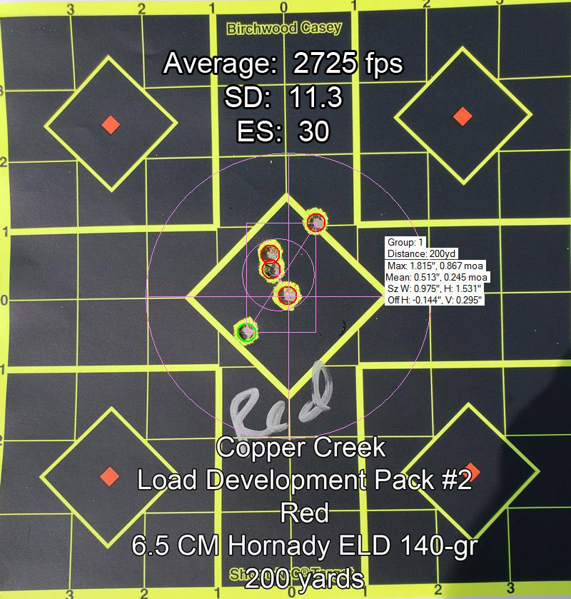

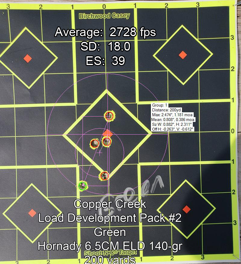

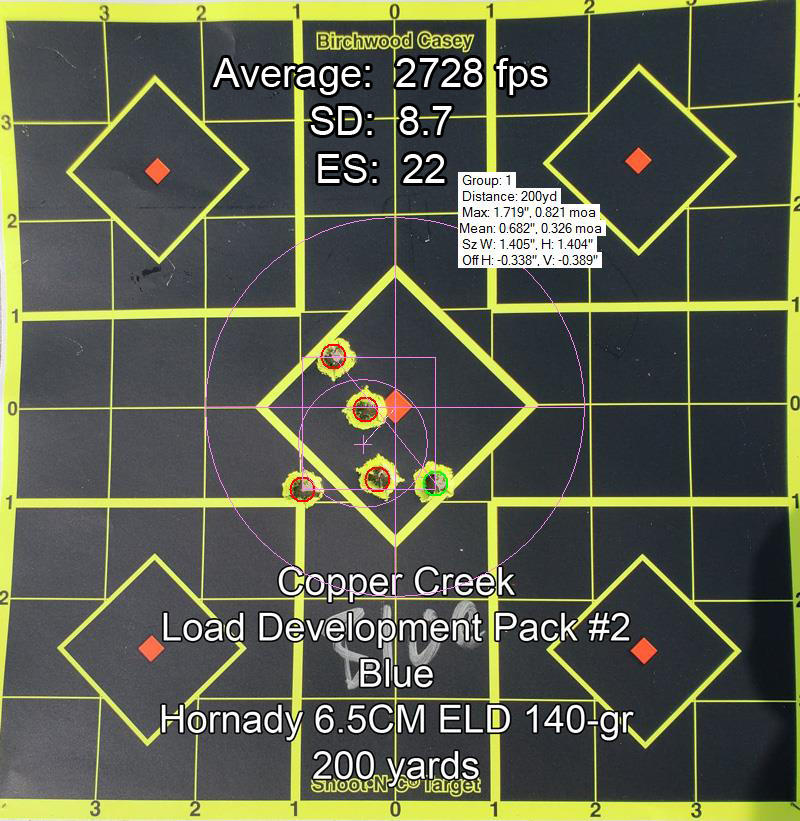

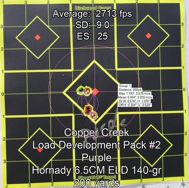

OK... So, with Copper Creek... LDP #1 is five different powder loads. You pick the "best" one and tell Copper Creek. Then they send you LDP #2, which is the powder load that was deemed best from LDP #1, in five different seating depths.
But, you say "Blue" wins. I picked Green. Hmmmm. OK.
So, they sent me LDP #2. Here are the results from that. I went with the "Black" seating depth (excluded the "flyer"). I also got some chrono data this time.
So, the final combo was "green (powder) - black (seating depth). Honestly, I don't think I really accomplished much, as there seems to be no real consistency. And, I blame myself for that. This was 7 months ago, so I'm a better shooter now. I wonder if I should start over with a new LDP #1?

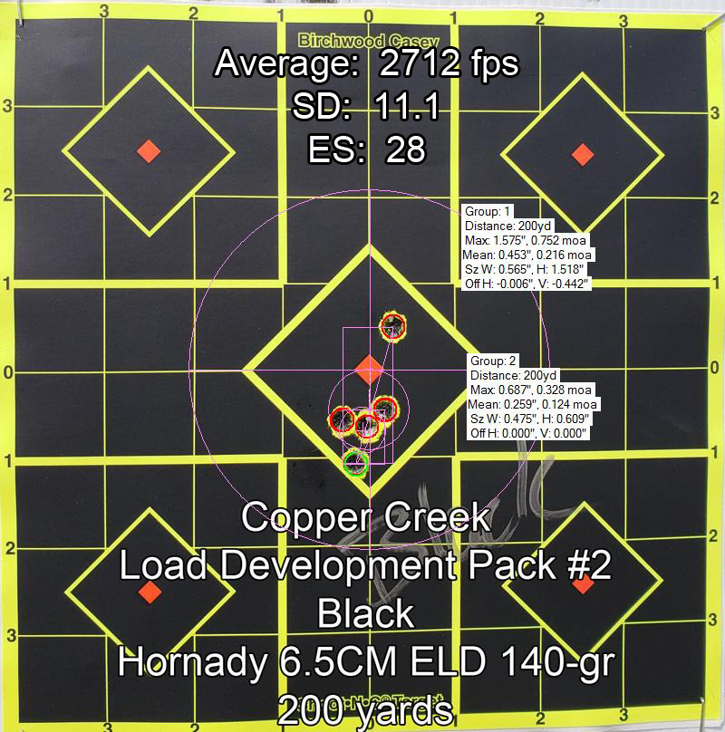

Black... I ran the group analysis with and without the "Flyer."
Whattaya think? Sorry for hijacking this thread. Should I have started a new thread? Thanks for your help!

Well, green still the worst or close from added pics, Black stands out as the best, then purple and blue 3rd. I'm looking for minimal vertical dispersion.
The 2nd group of target pics is from LDP #2. They all are using the "Green" powder load from LDP #1. So, the 2nd group of target pics is LDP #2 with different seating depths. So, the different colors in LDP #2 are for different seating depths.
My final "recipe" was "green-black" (powder - seating depth).
My point is that if I chose the wrong powder load (Green) from LDP #1, the LDP #2 test is kind of "moot," eh?
That all said... I sent Josh of Copper Creek an email asking him if I chose the wrong powder load. He said, "no." He stood by the recommendation to pick the smallest overall group size (rather than the smallest vertical dispersion).
Thanks again for indulging this sort-of-a-noob's questions.

I wrote “I’d take your smallest 100 yard groups, then i’d use the lowest average SDs to override that decision.”
So if the groups at 100 are almost the same... right? And in you need a tie beaker (as the op was asking earlier), you are now suggesting take the smallest group of factory rounds that might have jacketed up velocity spreads over one that’s really buttoned down?
If one factory round group has a 25/SD 70ES and shoots 3/8” at 100 it is completely nuts to choose that over another almost identical Sub -1/2” load, that has single digit SDs and low ES people in this group.
If you as a benchrest guy can help me understand why I should choose the smaller 100 yard group with higher SDs for long range please do.
So if the groups at 100 are almost the same... right? And in you need a tie beaker (as the op was asking earlier), you are now suggesting take the smallest group of another factory rounds that might have jacketed up velocity spreads.
I'm missing something, where is his 3/8" group, and where is 1/2"?
What you’re missing as we suggested that between the skill level and wind he brings his testing into 100 yards. He has not shot at 100 yards.
I don’t care what size the group is and how much “shooter” he has in the groups. If the groups are nearly the same and he has difficulty in choosing, is the point. I’ve seen rounds with 100 ft./s variance shoot nice enough groups at 100 yards.. You have to weed out a factory round that has jacked up velocities.
And I certainly am not talking about group sizes that different greatly. I’m talking about a tiebreaker.
Remember he’s not reloading.
Edited to add that we might all be talking past each other. If I wasn’t looking for a tiebreaker between two groups I certainly would pick the smallest group. I think he needs to perform the test up close to make sure that his shooting is not influencing the group.
I don’t care what size the group is and how much “shooter” he has in the groups. If the groups are nearly the same and he has to choose is the point. I seen rounds with 100 ft./s variance shoot nice groups at 100 yards.. You have to weed out a factory around that has jacked up velocities.
I got it, you were bringing the 200 yrd numbers back to 100. I still say the only thing he has shot that stands a chance at distance is his 2nd pic, blue.
If he has 1" of vertical spread at 200, it'll be 3-4" at 500, 10" or more at 1K
