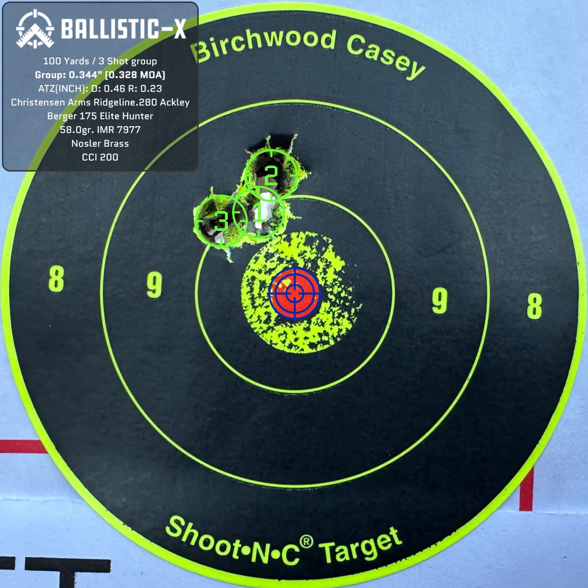

Not at all. I can run those speeds all day and my primers are still round. I have a 24" Proof CF 1-8 on my rifle.

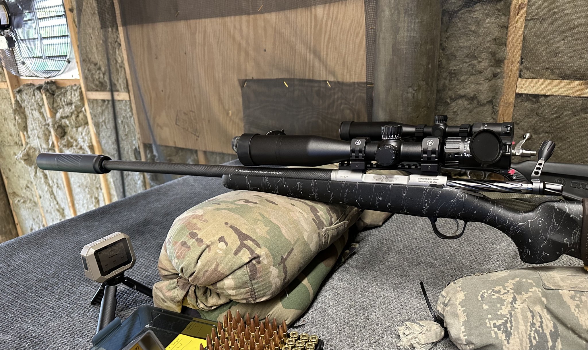

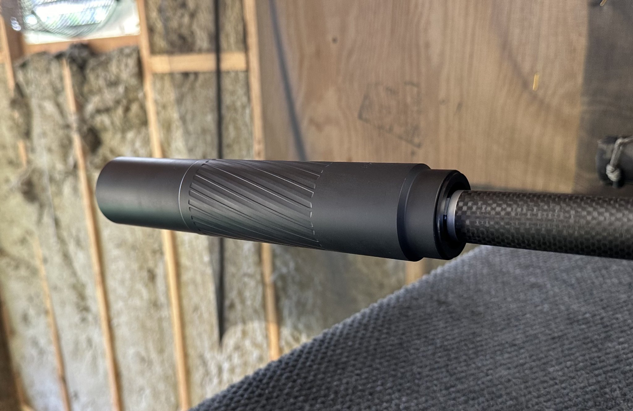

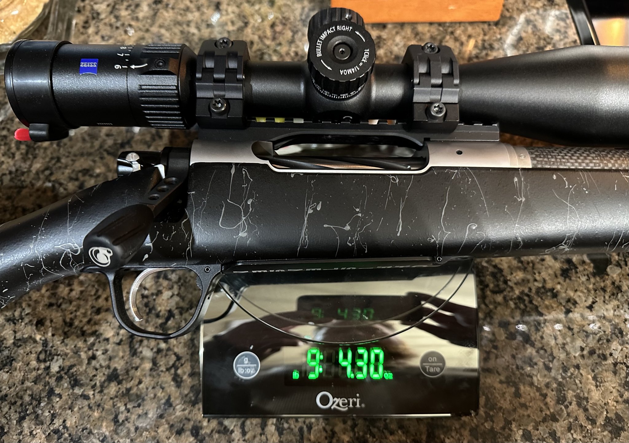

I recently went 280ai. Recoil is mild and easy to shoot. Mine shoots factory 140 accubonds at 3250fps and factory 160 accubond / 162 eldx precision hunter at over 2800, that will fill 99% of your hunting needs. If you reload performance can be higher and I don’t see any issues finding components. I’m seeing more and more factory loads available in many of the local gun stores. The Nosler 140 and 160 accubond stuff is all over around here along with the hornady 162 precision hunter.

I really like my Christensen Arms Ridgeline 24" .280 AI... Light, nimble, handles good, shoots even better than it looks.
The internal magazine allows me to seat the Berger 175 Elite Hunters 0.022" off the lands and still feed just fine. 👍🏼
