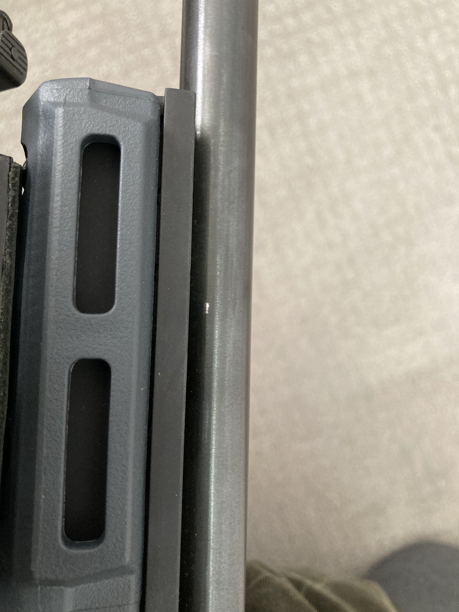

So I finally got my KRG Bravo and made the swap. My order fell through the cracks over the holidays at my LGS so sorry it took so long to report back.
You can see in the pictures where my barrel was contacting a rib in the factory stock. I took a measurement with calipers after getting it in the Bravo and it is only off slightly (.004”) to the right. As far as manufacturing tolerances go that is nothing. The problem with my rifle was definitely the stock and not a crooked barrel in the receiver. YMMV
You can see in the pictures where my barrel was contacting a rib in the factory stock. I took a measurement with calipers after getting it in the Bravo and it is only off slightly (.004”) to the right. As far as manufacturing tolerances go that is nothing. The problem with my rifle was definitely the stock and not a crooked barrel in the receiver. YMMV View attachment 7537345View attachment 7537347
Nothing wrong with that fit, thanks for posting

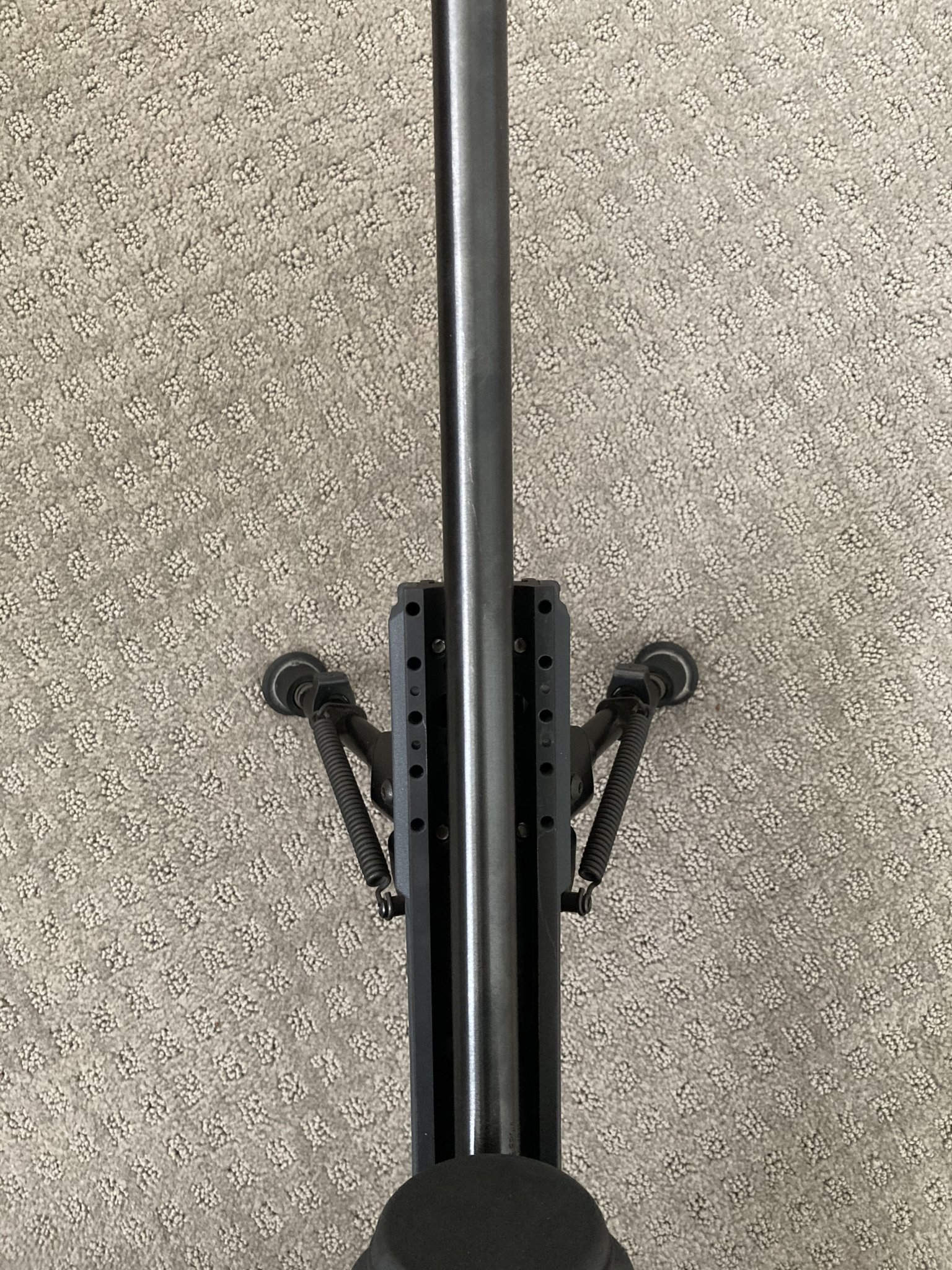

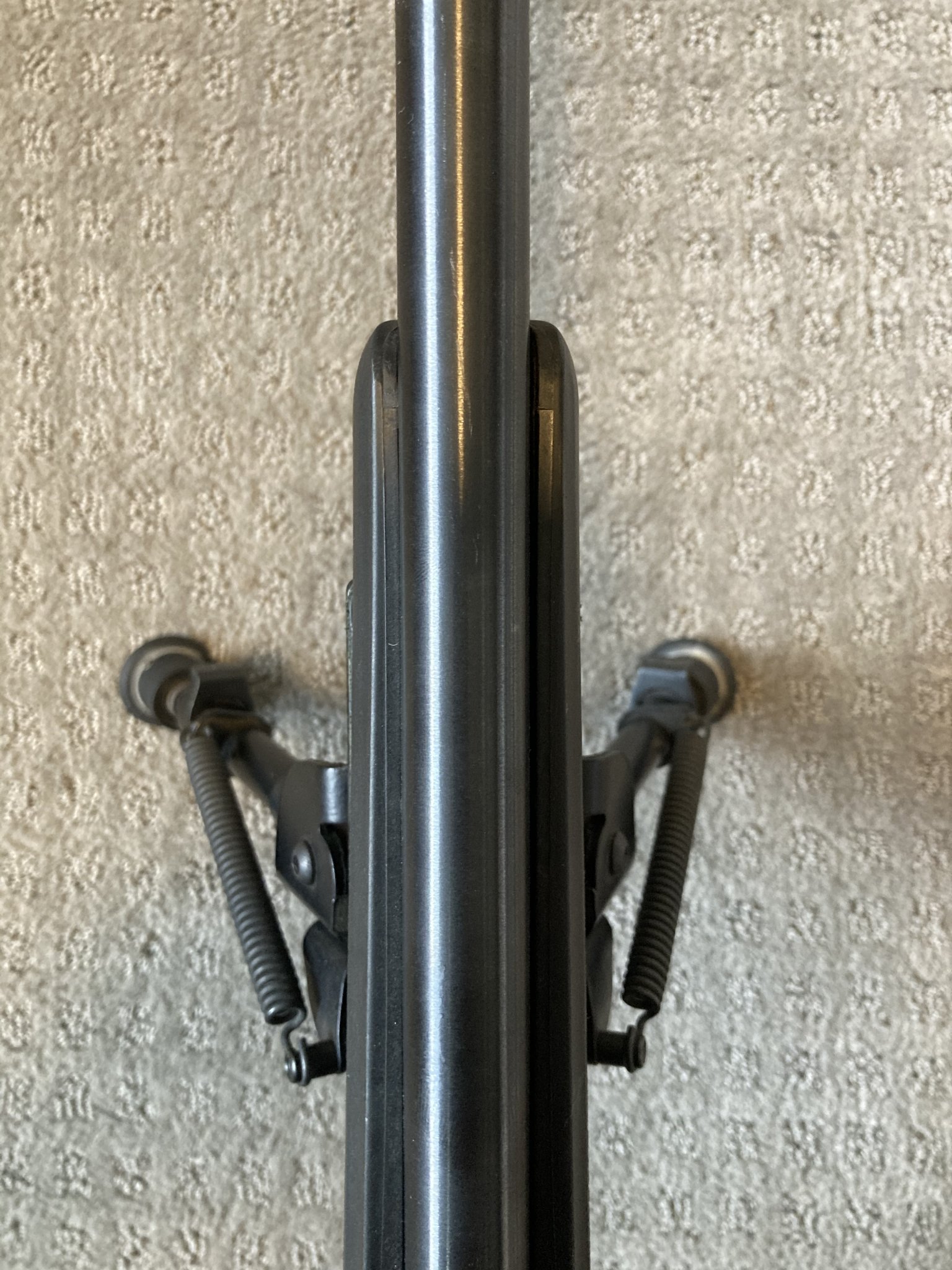

CAN SOMEONE HELP!!!! I had the same issues when it was not until I put in new stock that I noticed the 16 inch barrel is ever so slightly to the left. I have spoke to a ton of people including dealers and they say this is common but not an issues with accuracy. The distributer said not normal but not abnormal??? What? Its such a hassle to send back. I'm thinking of getting an aftermarket match barrel but worry that after spending all that money it will have the same issues. This is the pic of the barrel in the fore end. Im sure its not the stock because when I put back the barrel action in the original plastic stock you can see that the left side is touching or closer than the right side of barrel. Does anybody have ideas?
Make sure you have it in the stock correctly, the recoil lug in the stock fits very tightly into the receiver (in mine it does). If not seated right it will be cocked a little.
Mike
I double check again but I’m sure it’s on properly.
Like I mention when putting on original stock it’s the same. You gave me idea, I will try without lug and see if it cant’s a lot then I’ll see how the action relates to this lug.
