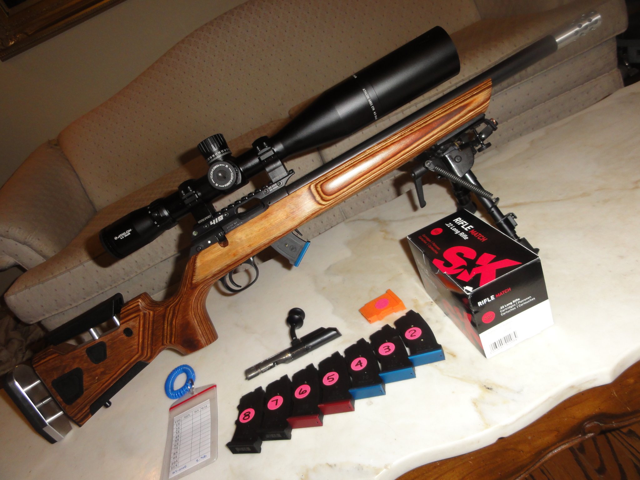

I have a 452 and a 455 CZ that have impressed me with their accuracy. I customized the 452 by adding a hooded barrel band front sight and fitting a Micro adjustable rear peep sight. The 455 has a 16.5 threaded sporter weight barrel that I use suppressed with a Swarovski 3-9 scope. It has an after market scope rail and I have replaced several internal parts and springs. Both rifles are more capable than me. I’m like you, I want a 22 rifle to increase my basic skills and transfer them to my center fire rifles.
I have no experience with the Tikka 22 but have a CTR in 6.5 Creedmoor that is the most accurate factory rifle I have ever shot. Tikka rifles are fantastic for their cost. I’m going to compare the two brands very carefully, and “pull the trigger on one” soon. I want a heavier barrel PRS style mini rifle that is affordable to shoot.
What say you? I should add the new CZ 457 is what I’m leaning towards.

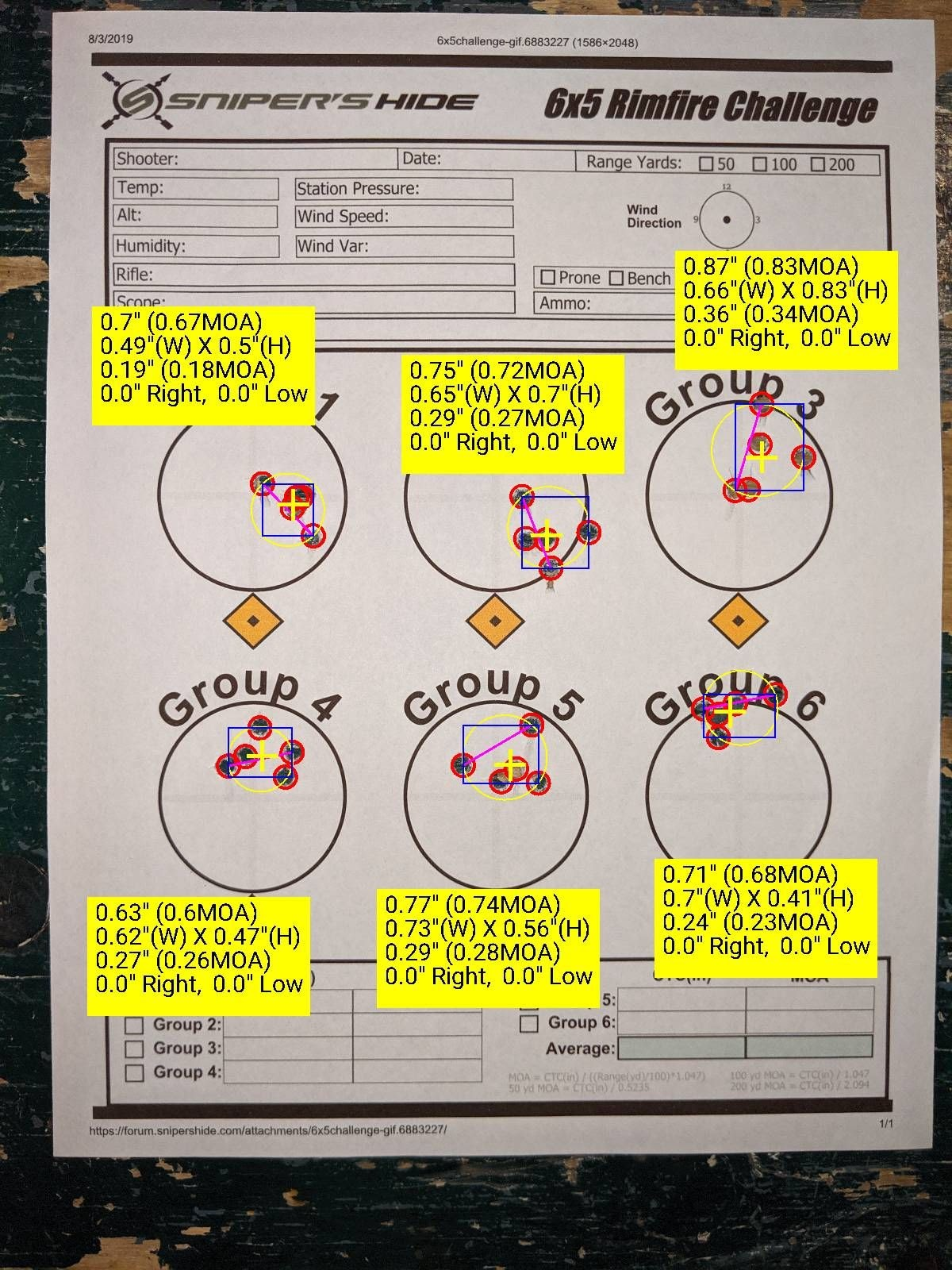

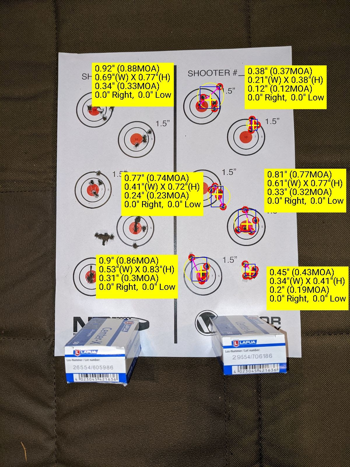

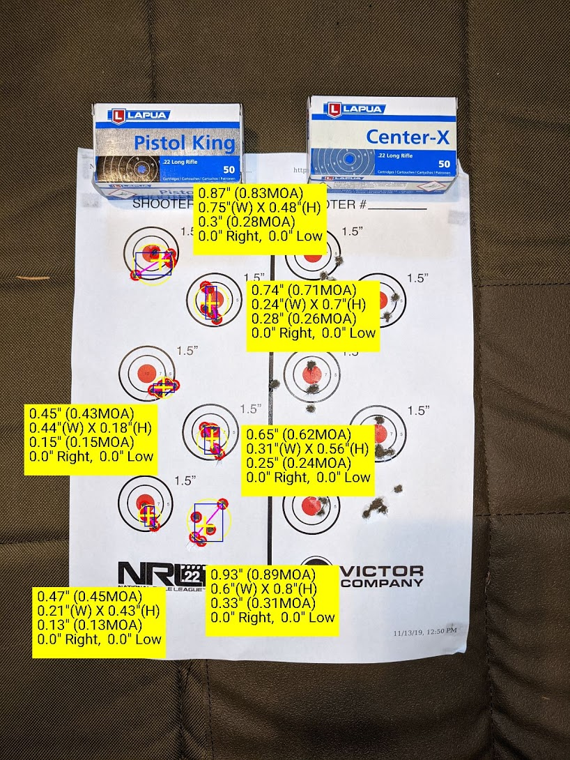

This was my factory T1X @ 100 yards.
This is my modified T1X w/ an IBI barrel.

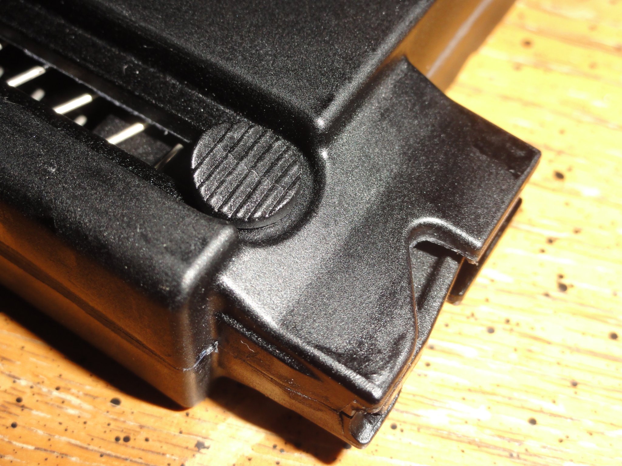

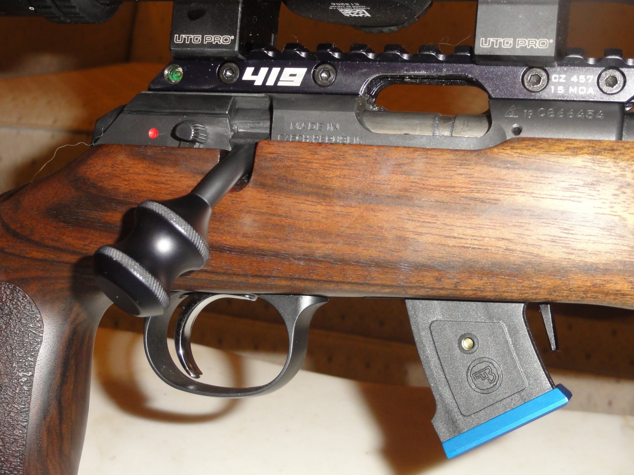

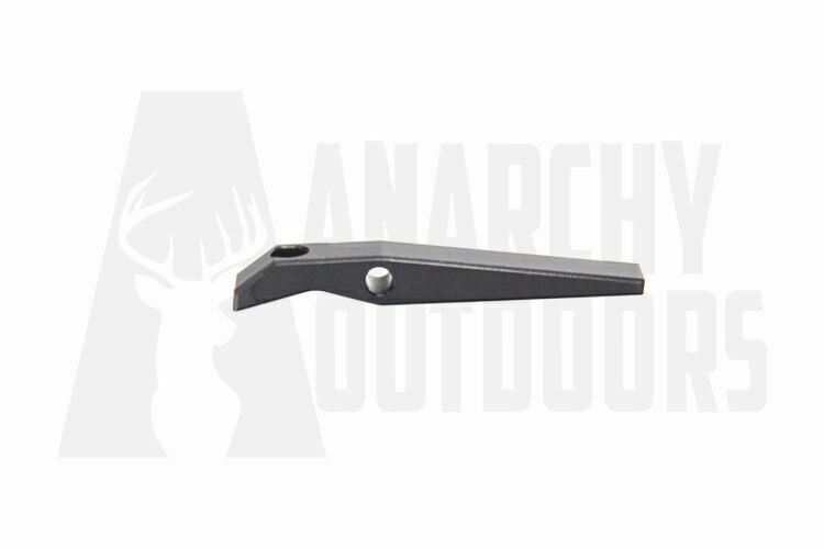

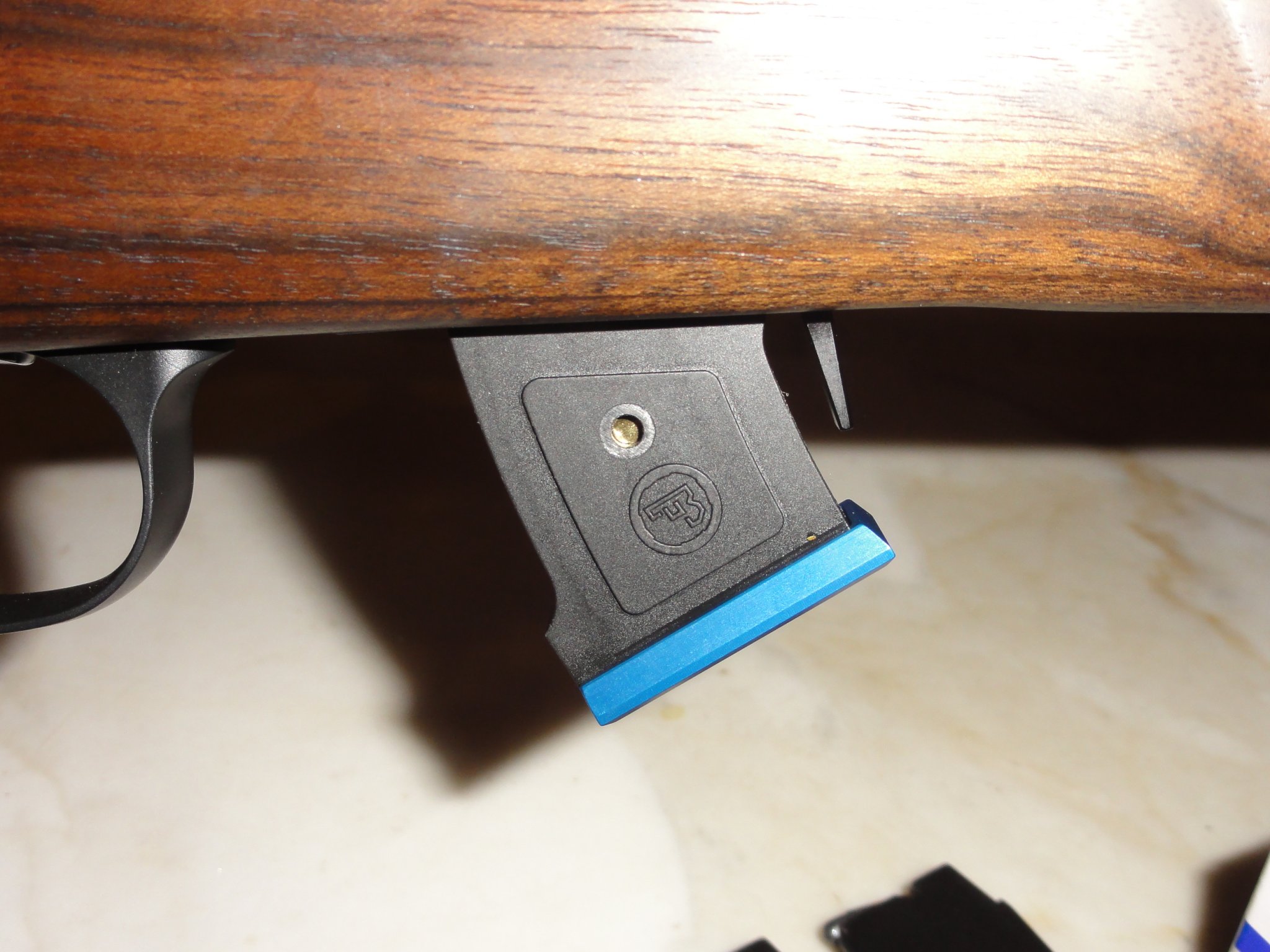

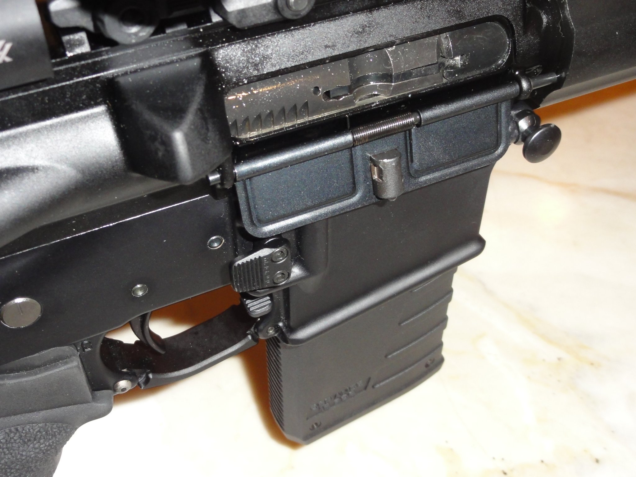

I cant compare the Timney to the CZ trigger but I can tell you that with a spring change and a little lapping of the CZ sear, you can get the trigger down to a safe, crisp 10 ounces. I have a Vudoo with a Trigger Tech Diamond set to 8 ounces and I really cant tell the difference between the two units. My CZ 457 MTR is my second favorite rifle. So much so that I bought a Trijicon 5-50x56 scope for her. CZ may not guarantee sub MOA groups but I can tell you that my factory gun does it.

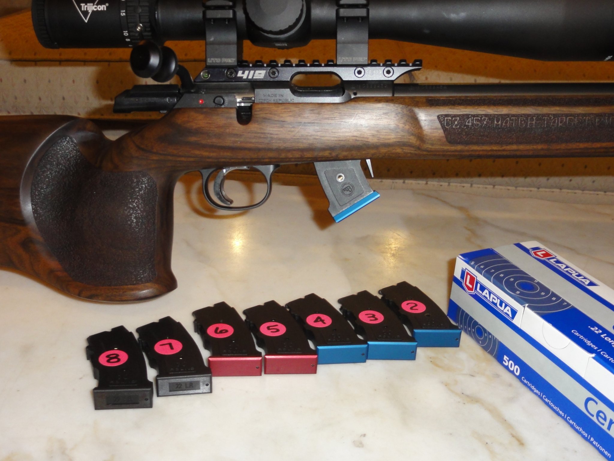

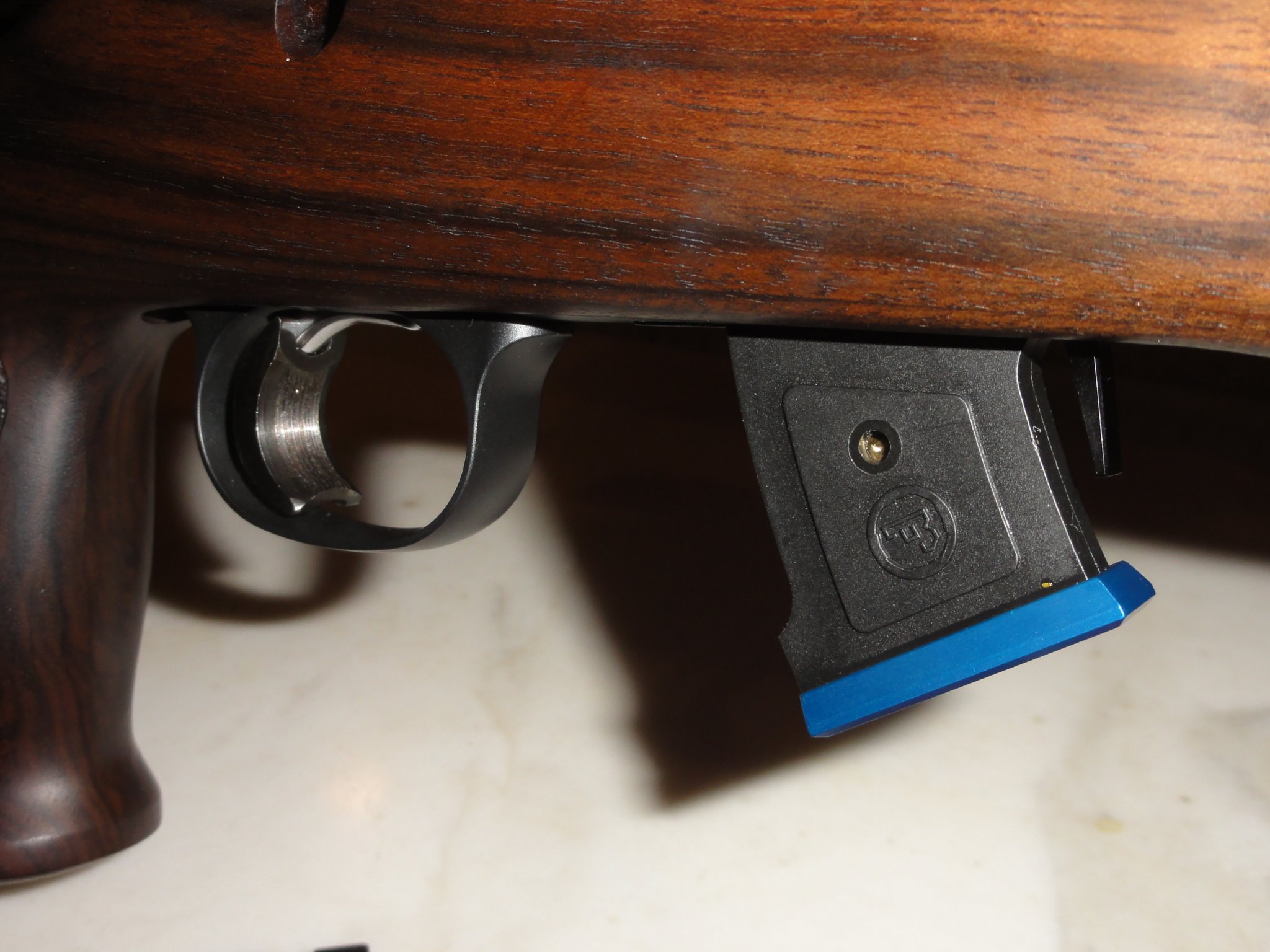

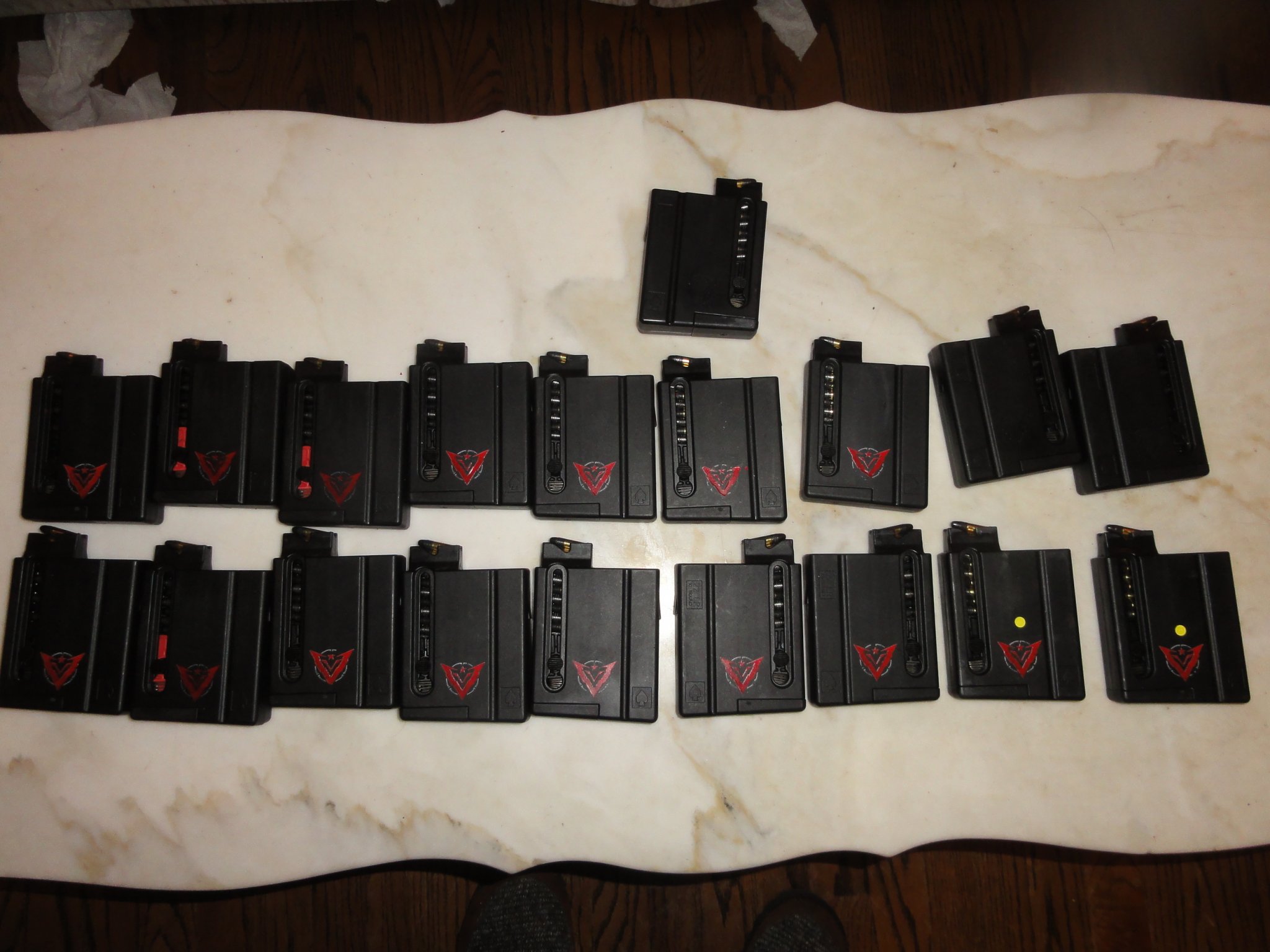

CZ also does have 10 round mags and DIP have extended mag releases. I would consider an AREA 419 bolt knob an
absolute must. It is cheap, gives you better leverage to open and close and it feels great.
EDIT: Anarchy Outdoors has an extended mag release that is the same cost but much better. The DIP is only .080" longer than the factory release. The AO sticks out 1/2" beyond the stock. The old ACE #21 and #22 fit the 457 triggers as well.
Best of luck
Shawn

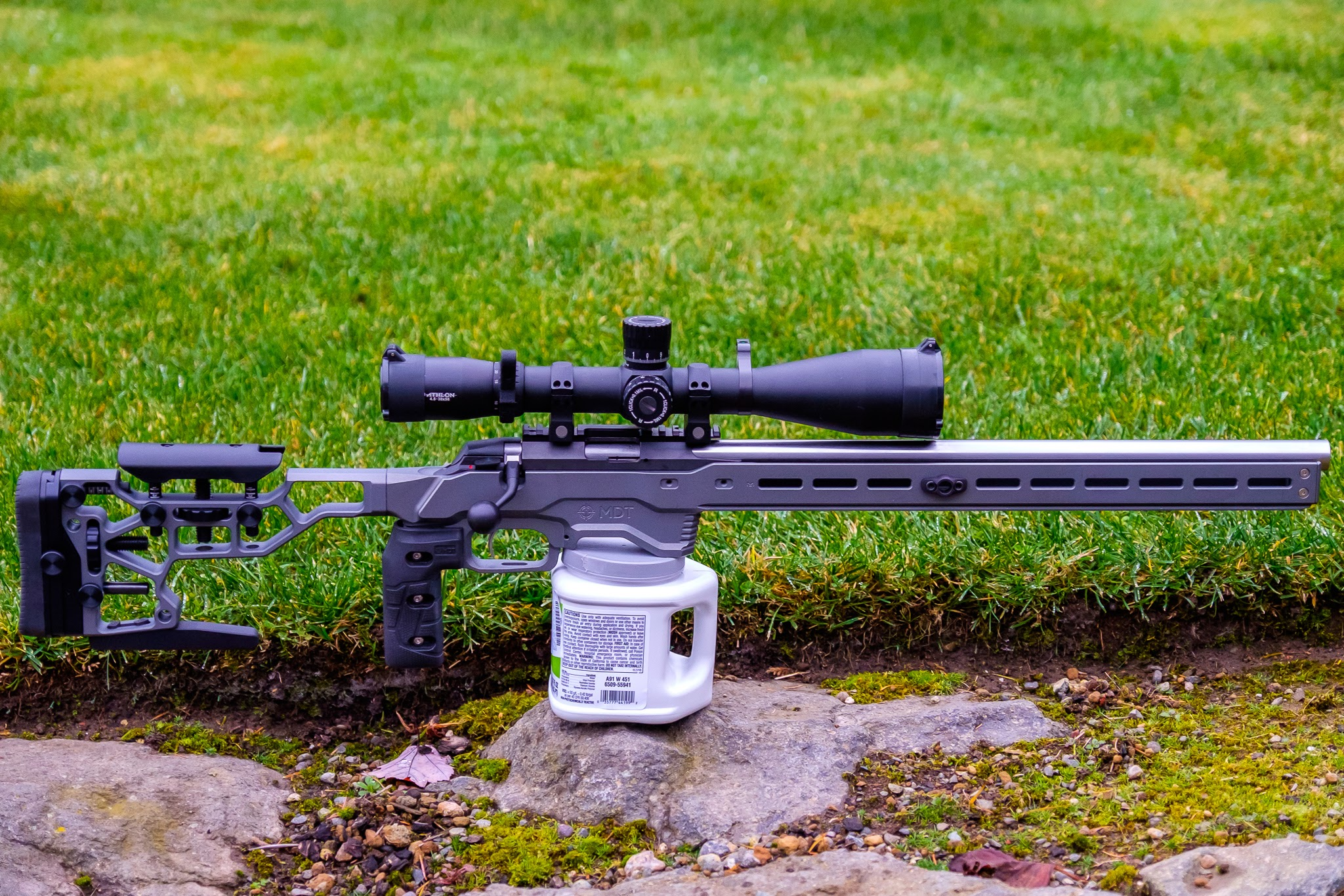

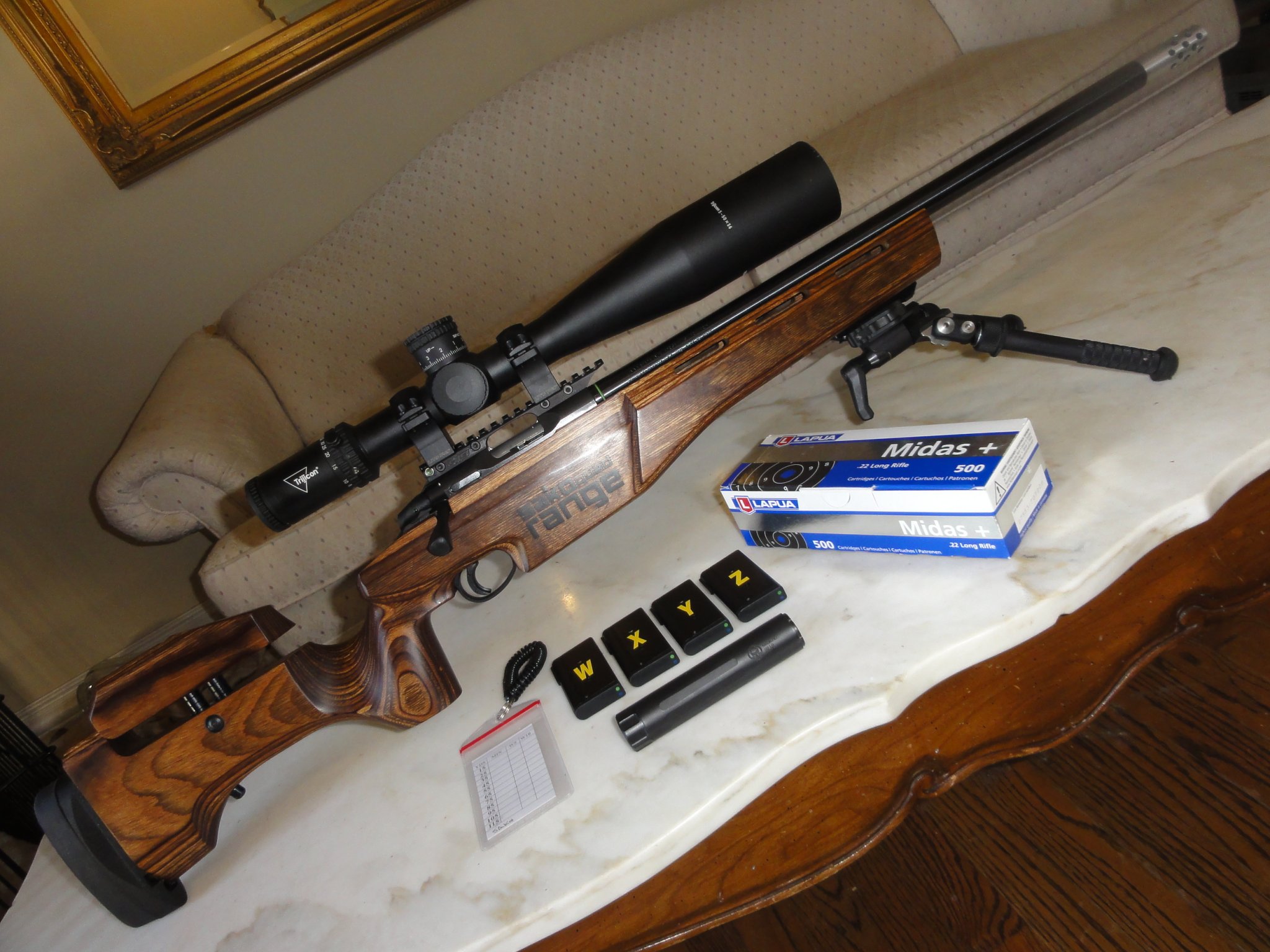

Little pod,
I'm just starting to look at a T1X and all of it's options, can you help me out?
Does MDT make a chassis with a shorter forend? How long is that bbl? What chassis type is that?
As I recall, mine is a LSS XL Gen 2. I love it !
How does the magazine fit into the mag well?
Is that the factory bolt?
Any information that you can offer up would be greatly appreciated.
thanks so much
Shawn Carroll
Little pod,
thanks so much
Shawn Carroll
I have the MDT ACC Chassis, and yes the fore-end is long. Their Tikka T3 SA inlet fits the T1X, at least for their ACC chassis, you might want to ping them to see if that's the same for all of their other chassis. It should be, but it's good to confirm.
It is a 20" barrel. If I had to do it again, I probably would have gotten 22" just for aesthetics :). It's an International Barrels Inc barrel (IBI). Chambered in Win52D. If I had to do it again, I probably would have gotten it chambered in Eley EPS, or LR Match.
Magazine fits in the mag well pretty well. It's not perfect, but I have no issues mag changing it. As in, instead of pushing the mag directly straight up, I push it in at a slight angle since the T1X magazine hump hits the AICS mag release area. It doesn't sound as bad as I describe it, but there is a tiny angle I insert it at before I push straight up. I've never had a failure to change mags in any of my comps.
The bolt is factory, the knob is a Sterk Swept Back Bolt Handle. I love the handle.
It also has the short throw like your CZ 457, like 50-60 degrees or something like that.
Other tidbits...
12 round mag extension coming in Shot Show from a few different accessory vendors.
Factory barrel is pretty decent, but IBI barrel is a bit tighter... it's also harder to feed as my Win52D chambering is pushing the round into the rifling as it's chambered. So need to chamber it fast and not slow to get momentum to make it smooth into the rifling.
If I had to do it again, I might have gotten a chassis that was slightly shorter, or a 22" barrel :)

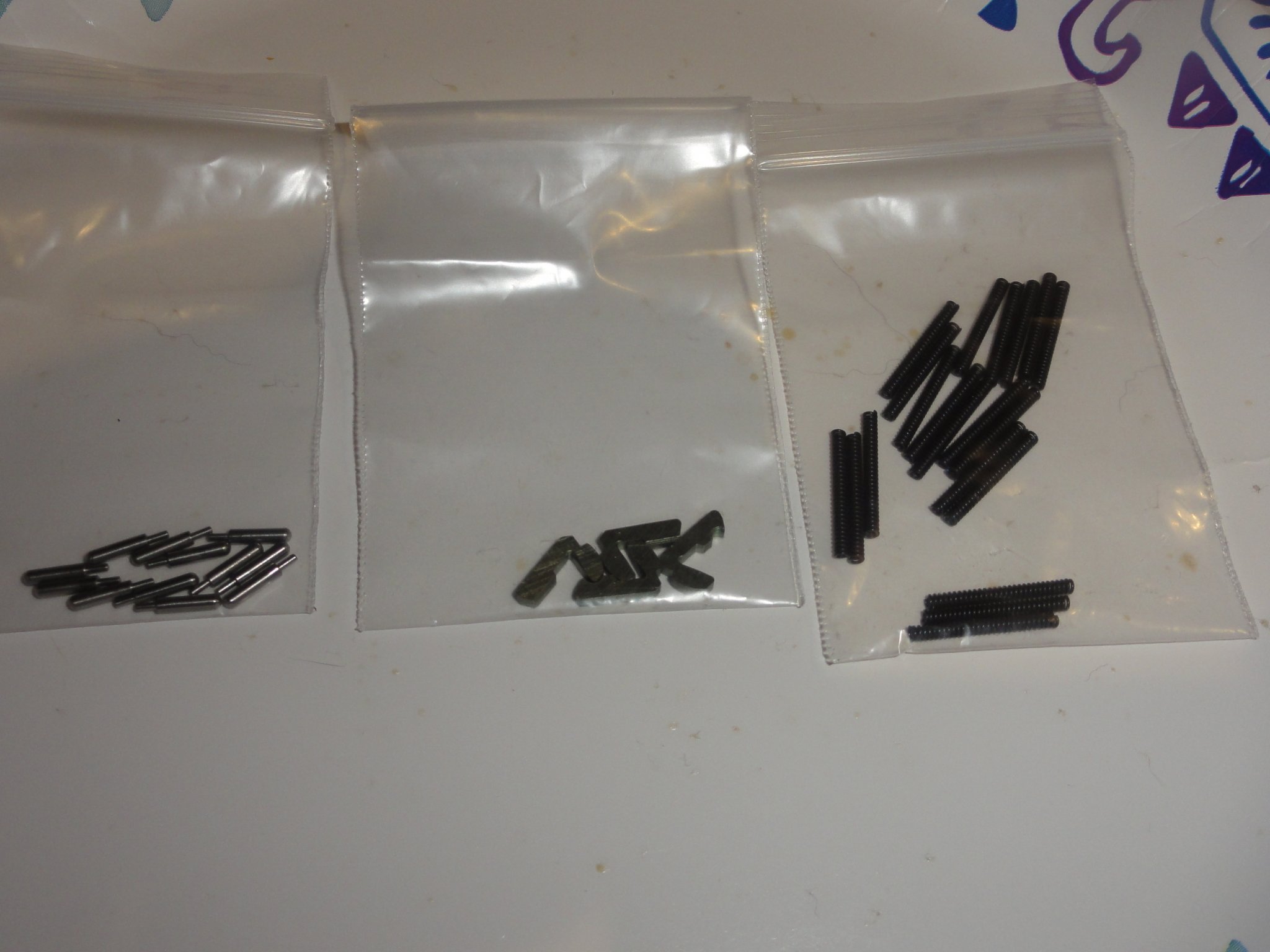

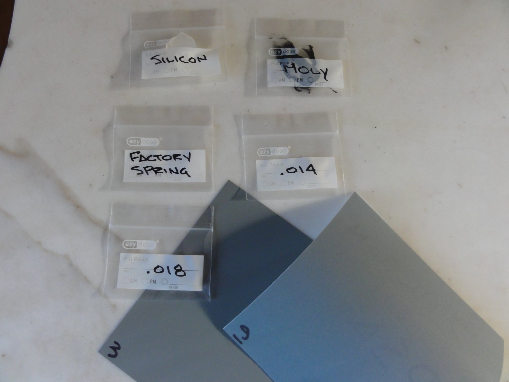

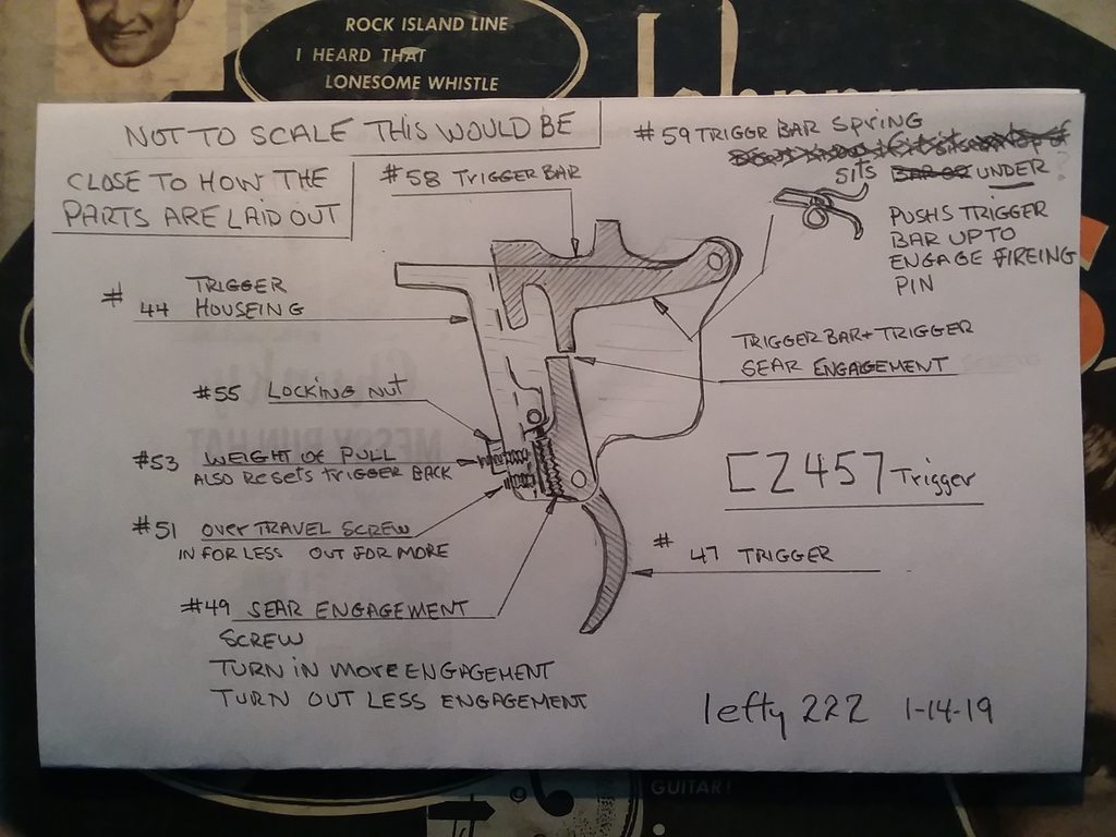

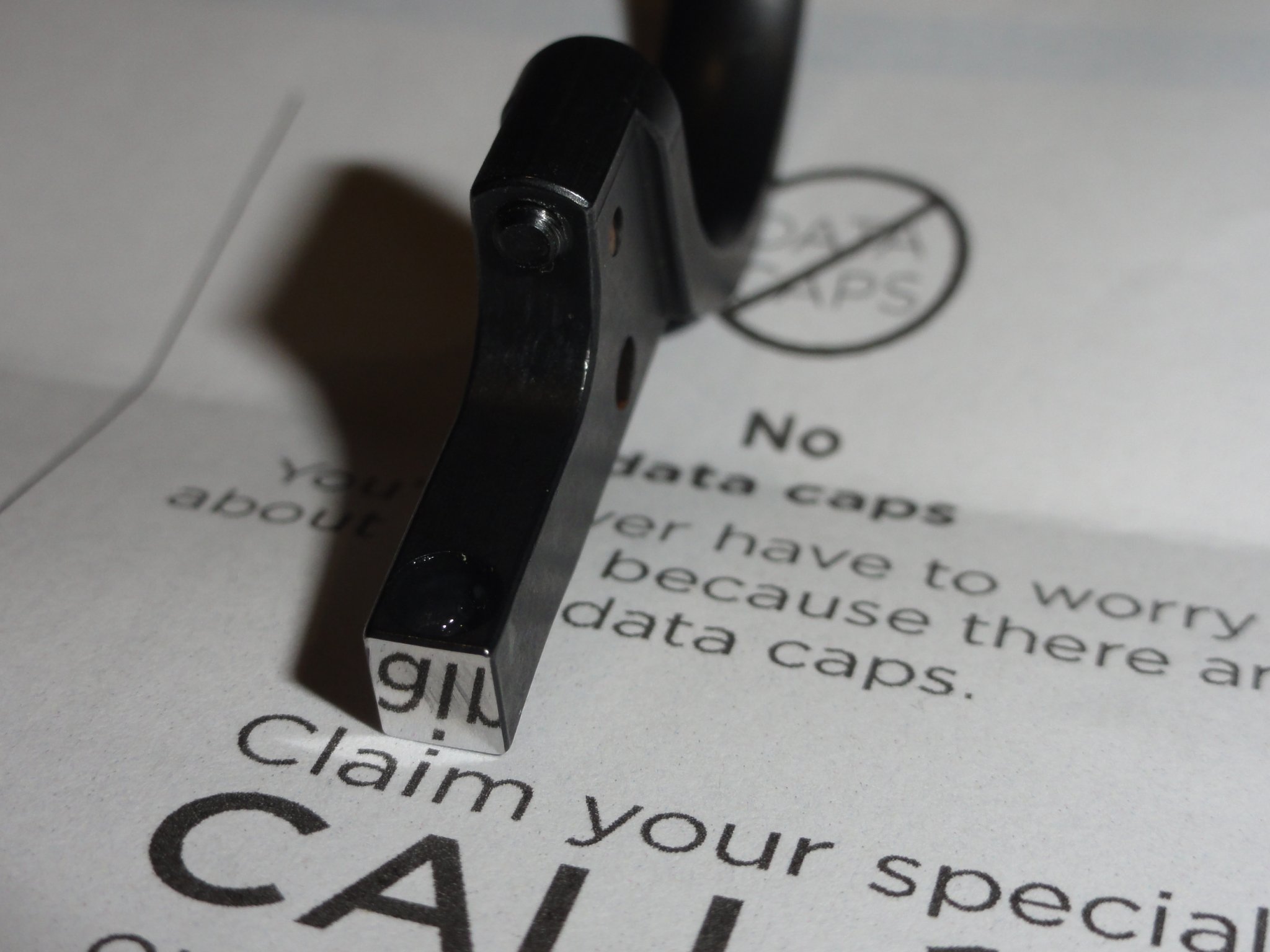

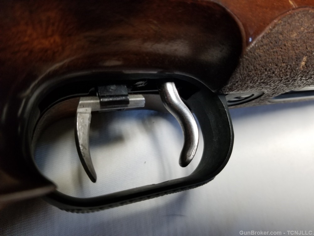

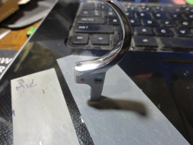

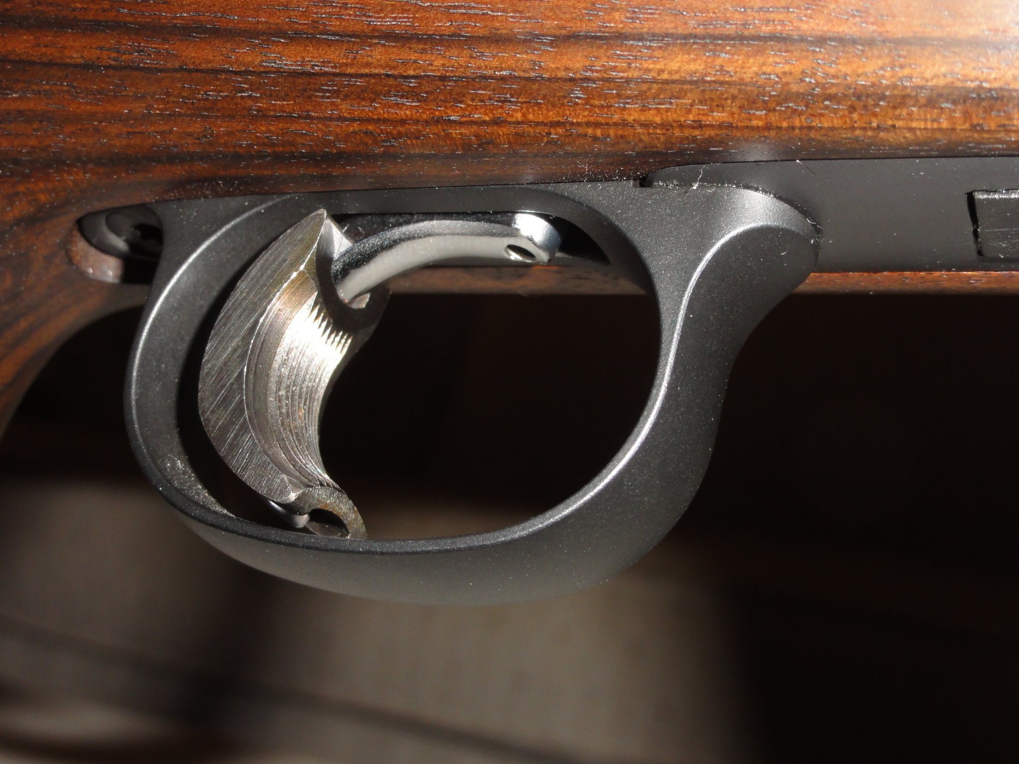

Hello Forge,
What did you ever do about your gun choice? I cant compare the 457 trigger to the Timney but I can say that the 457 unit
can be changed into a really nice trigger with just a little work. Just lap the trigger sear and change out one spring and it is easy to
achieve a crisp 10 oz. unit. One reason that it so easy is that the trigger sear is so large. You can see in photo marked TRG4, that it will
stand on it's end unsupported. Anyway, I would not be surprised if you end up with a CZ 457 at some point. It's a very nice rifle, I have three. I held the Chassis the other day and it is nice. Once you adjust the stock you can lock it out to prevent any wobble.
I would suggest the AREA 419 "clamp on" style rail and the bolt knob. Anarchy Outdoors has the best extended magazine release. It sticks out
half an inch below the stock. Also the old ACE trigger shoe #22 is nice to have as well. A #21 will also fit.
Keep in mind that the sketch below has a mistake on #49, turning in the screw provides less engagement. Lefty 222 did a pretty good job on it.
If you go with a cheaper DIP or scar rail that uses set screws to retain the rail, you should put some lead shot under the set screws to
prevent receiver damage. ( Divots & scratches ) The DIP extended mag release is nice but it only adds .080" of length over the factory release.
Best of luck
Shawn

Do you have any kind of extended magazine release?

You will like and never have problems with the Vudoo poly mags, I just happen to be a mag nut. I may get an aluminum mag purely for photo's. btw.... I would not bother with the logo on the mags because it comes off fairly easy when I toss them around.

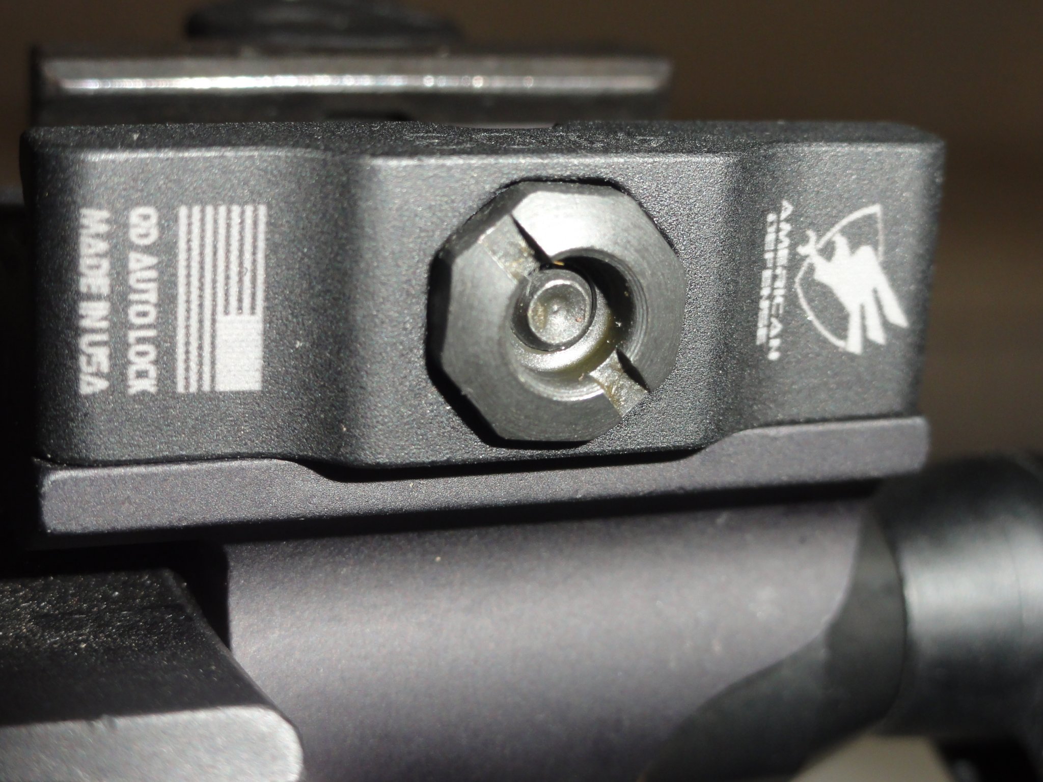

In the prior two months, I picked up the Sako Quad Range and the CZ At-One. They are both really nice guns to shoot.
It may seem like I'm going backwards but I'm still interested in the T1X. Also a Zermatt, B14R, Lithgow among others.
At least my Olympic air rifles used cheap ammo! Say 15.00 per 500. Some of the .22LR ammo seems ridiculous. LoL

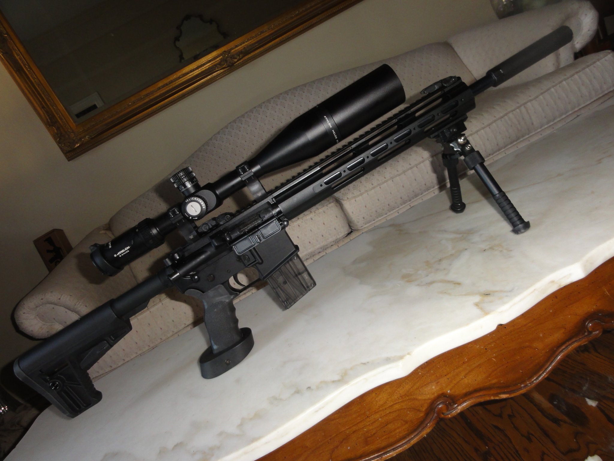

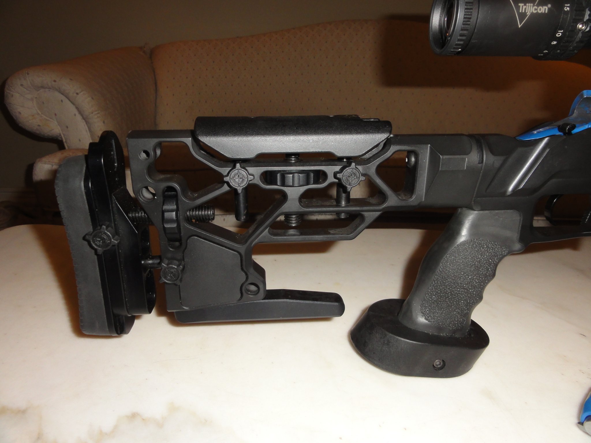

Are you going to put weights on your V22? Why? one more thing... You may know, the MDT rear rifle stock comes in a standard length and a short length. It looks like your old T1X used the standard one. Although the short stock costs
100.00 bucks more, it is one inch shorter and would let you be able to adjust your LOP. That is the one I had to buy
to preserve the adjustment. Shown in the last photo.
Shawn

Regarding my Vudoo... I ended up getting a 18" Kukri SS with a 40 moa rail. I got the MDT ACC Chassis, and I didn't know there was a way to get a shorter LOP. The default LOP that comes with the rifle is 13.5" and it works for me so that's great. I had been testing different configurations and 13.5" is what I like. Maybe when I go through training with lowlight this summer he'll correct me and then I'll have to figure something else out! Right now I sent my new R700 chassis over to a friend on the hide who's cutting off 1 m-lok slot and rounding it and re-installing the end plate. That reduces exactly 2". If I cut off 2 m-lok slots, I believe it reduces it 3.5", so I just stuck with 1 slot being cut off. I also got it re-cerakoted to look like this pattern - Not sure how it will turn out
When I ran my T1X with the MDT I asked MDT to also send me the aluminum backplate which reduces 0.5lbs off the back of the rifle. I wanted to get my rifle balanced right at the front of the mag well so it could sit nicely on a bag on a barricade. To do that, I had to lighten up the backplate by 0.5lbs, and then also add 2 sets of external weights to the front. That made the rifle around 14-15 lbs. Kind of hefty for standing stages. I'm not sure how the Vudoo will balance out. I ordered a set of 5 internal weights to see where it will balance. Also with the aluminum 12rnd magazine, that will also add another 0.5 lbs right at the mag well, so in an actual loaded situation I might need even more weight up front! I don't think I can make the stock any lighter...
The MDT ACC chassis might not have been the right choice for rimfire, but we'll play with it. I've been liking that Grayboe NEO chassis more and more, I just wish it had a machined in arca rail. https://grayboe.com/shop/neo/. Their reactor plugin seems cool too. I would go with the JP APAC chassis but man that is $$.

Finally got my T1x after a week and half delivery time and a 4 day ffl delay..
Got out and put 15 5 shot groups down range at 50yds
Halfway through I pulled the plastic barrel thing... and lowered trigger to around 1.5lbs. Tomorrow I’ll instal the spring kit.
All shot off magpul bipod.
Averaged 0.41” or 0.78MOA
Was expecting it to shoot like this with match ammo, but not this good with cci sv.. couldn’t be happier, since I can’t afford the good ammo..

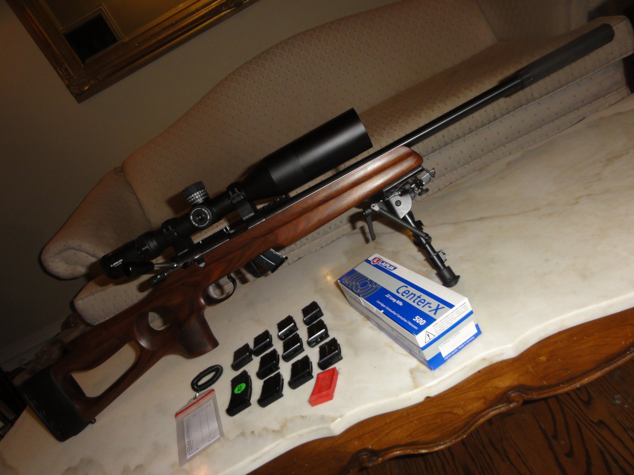

Hey Chuck,
By now you probably know...... CZ has ten round magazines as well as five rounder's. The Anarchy Outdoors extended mag release is the best for me because it sticks out 1/2" beyond the stock. I like the AREA 419 rail because it clamps to the receiver and wont damage the gun the way set screws will . Bob at DIP suggested putting lead shot under the set screws to protect my receiver. Although that is a good idea, sooner or later I'm going to allow the lead shot to fall out during a cleaning or scope swap and my poor gun will pay the price. I feel the 419 bolt knob is a must have item as well. It totally enhances the feel of the rifle. I initially struggled with it's peculiar appearance but it functions great !! It seems like FN makes a knob that works too.

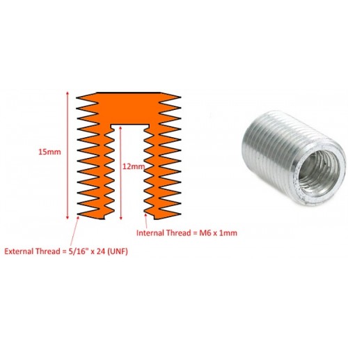

Just an fyi.... Lumley makes a handy adapter that goes from 6M to 5/16-24 for bolt knob applications.
More fyi.... The old ACE #21 and #22 trigger shoes fit the 457 triggers.
And one last thing... A simple lap job to the trigger sear and a spring swap will get you a really great, safe 10 oz. trigger. Again, this is on the 457 trigger unit. Kiss of Death did his trigger and he is getting a 7.6 oz. pull. 10 oz. is easy peazy
for anyone to accomplish. The kit that he used came with 3 and 9 micron AO lapping film and four springs. Two of .014" wire and two of .018" wire diameter.
Lefty 222 did a nice job on the 457 trigger sketch but he realized that he labeled #49 backwards. Turning the screw in yields less engagement.
Hope this is helpful to somebody
Shawn

shawn
@AirGunShawn Yeah, the ten round mag wasn't available when I was deciding. That would be welcome add, I'm sure. I'm pretty locked into the Tikka now and like doing some of the upgrades; i.e. DIP bolt knob, Muzzle brake, 25moa scope rail, and now waiting for Oryx chassis. Should be here mid-March.
I had some FTF problems early on but have got that debugged now. Accuracy is good with quality ammo 100-230yd. It's good with just about anything you feed it at 50yds.
I would also consider, if i liked the savage , send it to bug holes for a bartlein barrel
I had a Savage Mk II for less than two weeks, It was plenty accurate for me and the ex police sniper that bought it
but I just hated the Accu-trigger unit and it's blade safety. I do my best to keep stock components. Replacing springs, lapping sears, changing bolt knobs and doing small stuff is fine. I have a Kriss Defiant that I'm very close to putting a KIDD 20" S.S. bbl. into, but that will be my first and hopefully last bbl. swap. The Kriss uses good materials and has good fit and finish, most of the gun
is very nice. I am having problems with accuracy and I wont allow much of that.
I only bought the Kriss to help me keep up in the local get together matches every month. I don't want to losse
because my poor choice of gun. All ties go to the fastest time.
I should have stayed with my bolt guns. .
