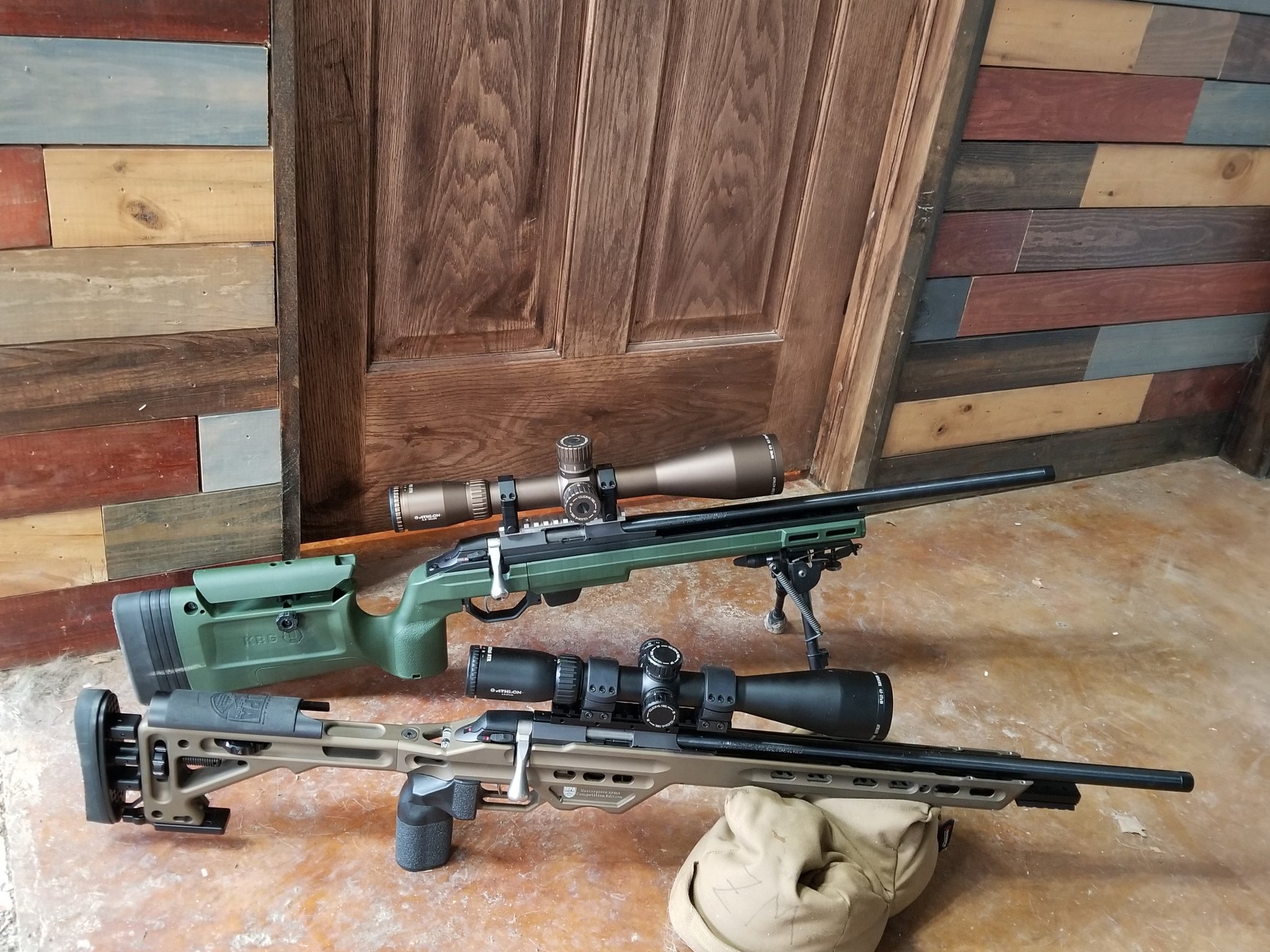

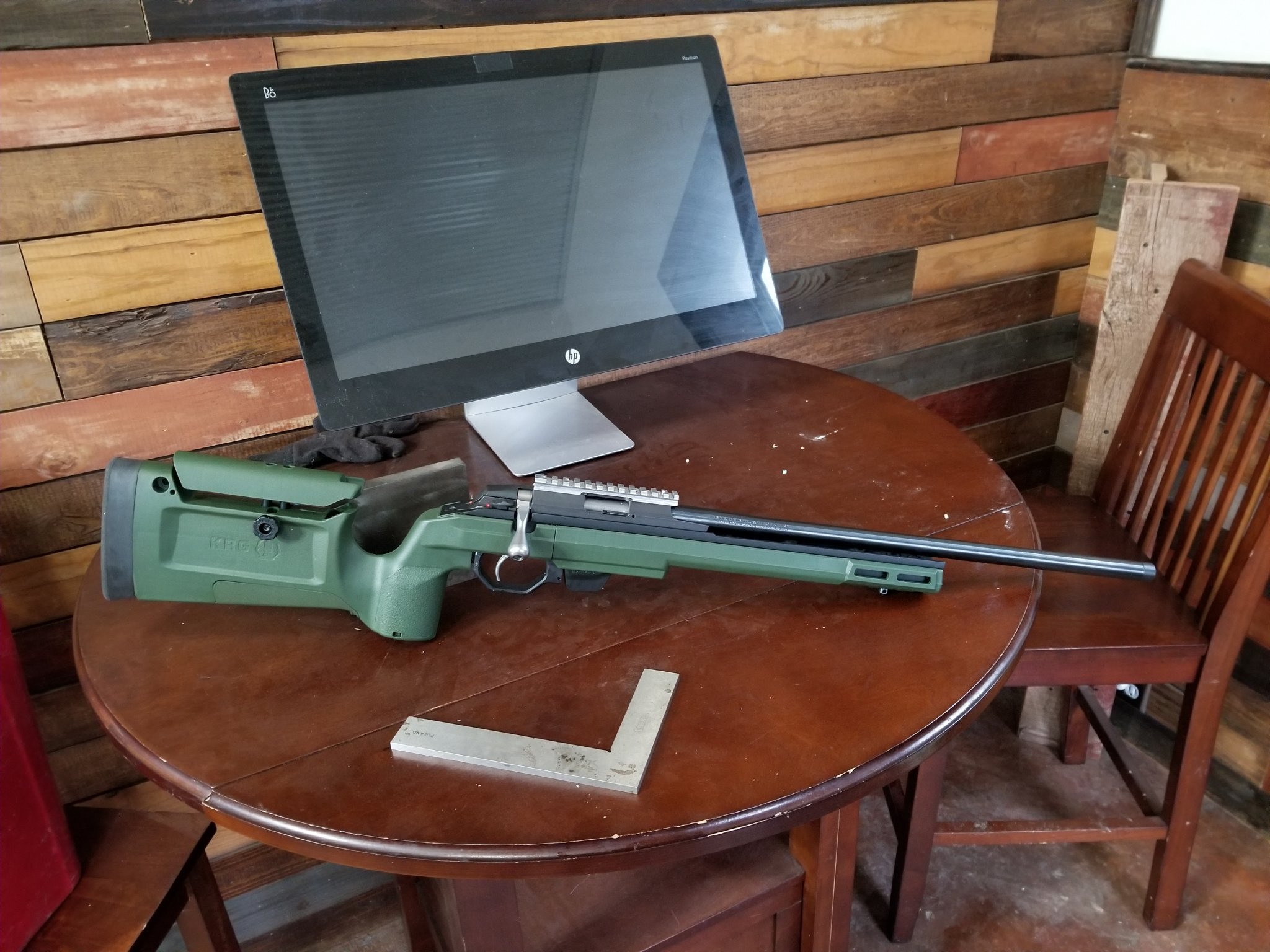

The T1x in a modified KRG bravo, had to do a little more modifications than hoped but it is aliveView attachment 6978969
Looks great, I'm picking my T1x up soon and have a tan bravo ready to go. Mind mentioning the mods required? I know the bolt stop might be one, would be interested to see or hear how the mag area went too.
I've modified an AI AX chassis from rem700 to tikka and a Sako trg stock to tikka (before bravos were around).

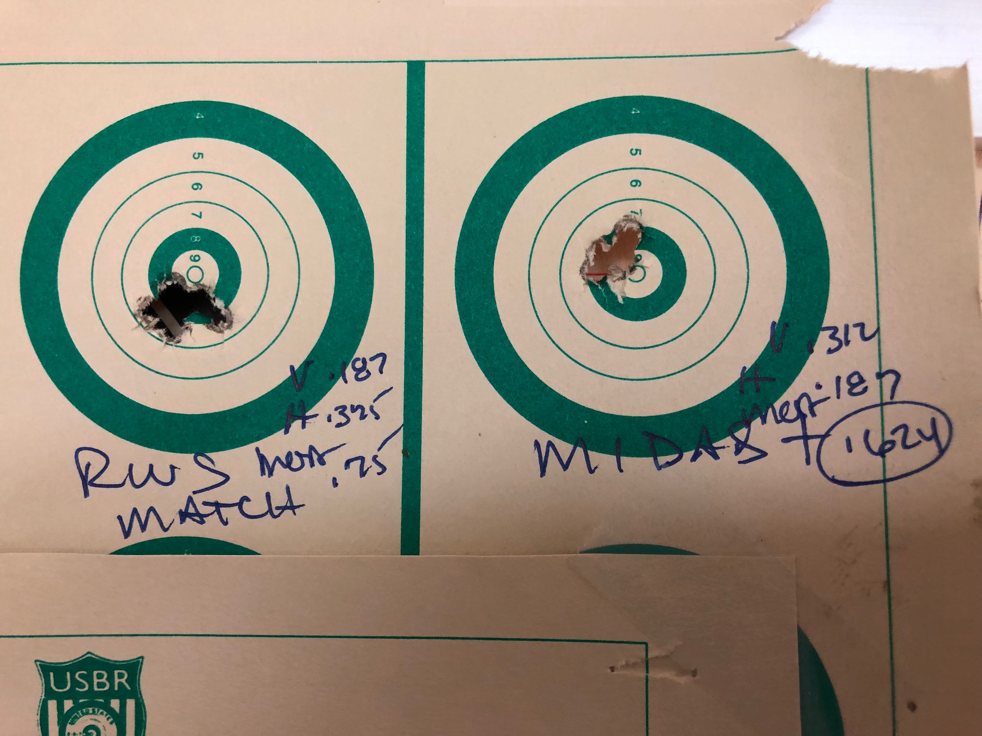

I ran tests on different rounds (see attached) through the T1X (received it last week). temp 54, light rain, wind 0-4 @ 1-2 o'clock. Rifle has 200 rounds through it after the test. All 10 shot @ 50yd, w/bipod and rear bag. trigger set to 2#.
thought I would share..
That Lapua Midas group :oops:(y) Nice shooting!
thanks, I could not believe the difference from the others, so ran a 5 shot follow-up, and added RWS match that missed the first firing.
@cannoncrossfire

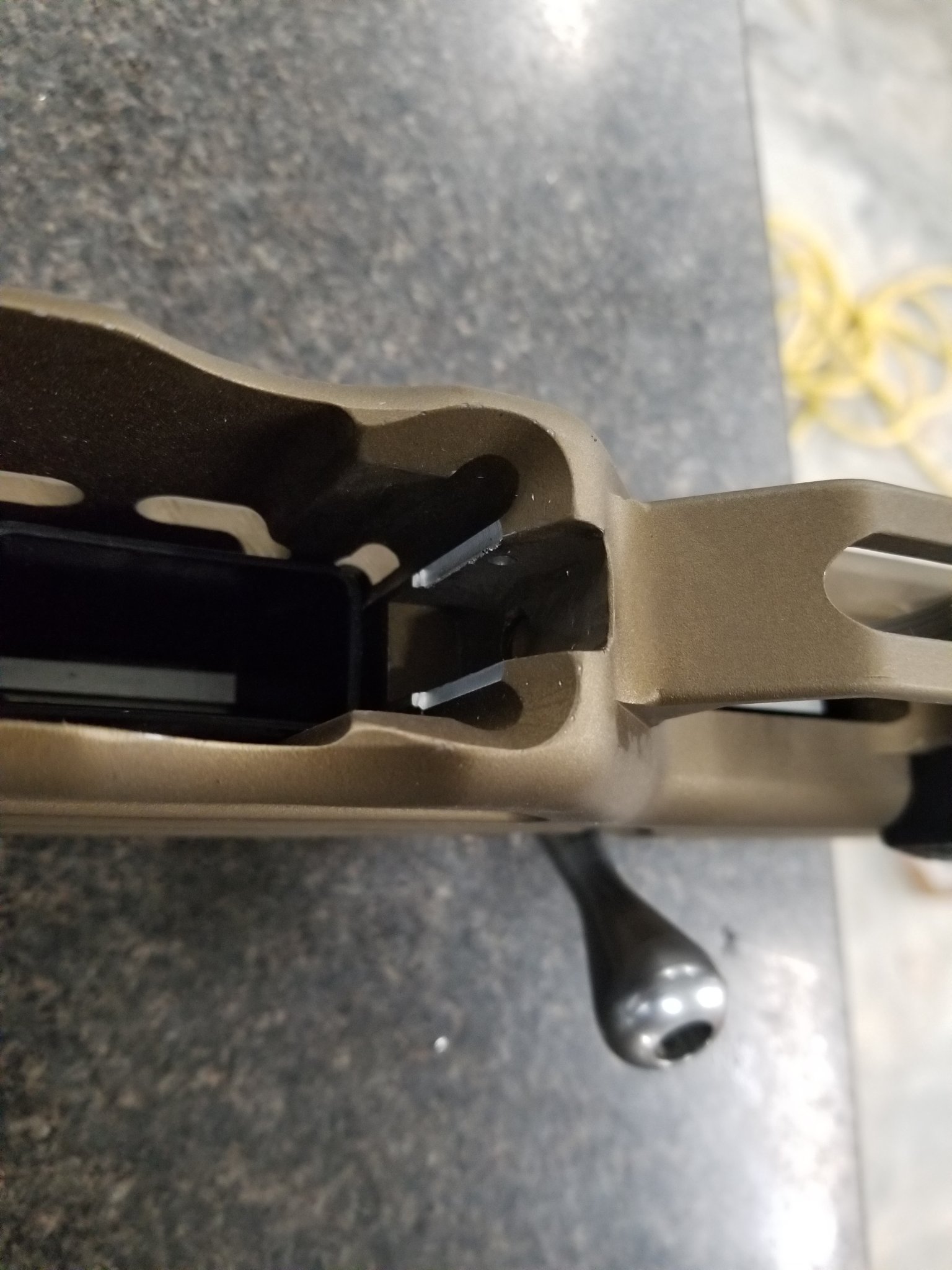

The chassis backbone is attached to the triggergaurd by a button head screw in front and the action screw in back.
Unfortunately the T1x mag housing bolts to the action with a rather large metric shcs. (See my post a few pages back for pictures) You will have to reengineer the front triggergaurd attachment as you have to mill through hole for the button head to provide clearance for the shcs. I trimmed the head of the shcs on a lathe to minimize the amount of material removed but still cut all the way through the centersection of backbone and down into the triggergaurd.To allow the mag to seat the front of the triggergaurd will have to be milled to allow for the basepad as the mag seats.
@Massoud did a really good job of skeletonizing the triggergaurd so plan your front attachment well, there isn't a lot of extra "meat" a traditional solid xlr/mdt/mcree would be a lot easier to modify probably

Thanks, and thank you for your kind words. Actually, this is my first 22LR, since I was a kid. The T1X is out of the box. Champions Choice is local for me (middle Tennessee), they have all the ammo brands. I became a Tikka fan about a year ago when I bought the T3X TAC A1 in 6.5CM. It shot 1/2 MOA or better for over 2000 rounds ( I shoot a lot, and precision hand load). I am now at 2600, and it is shooting 1/2+. Lands are getting too far away, so in the process or rebarreling (going to try 6CM in a Broughton barrel 1:8). I bought a second 6.5CM Tikka so I could keep shooting. it is not as good as the first, but still a 1/2MOA +/- rifle..

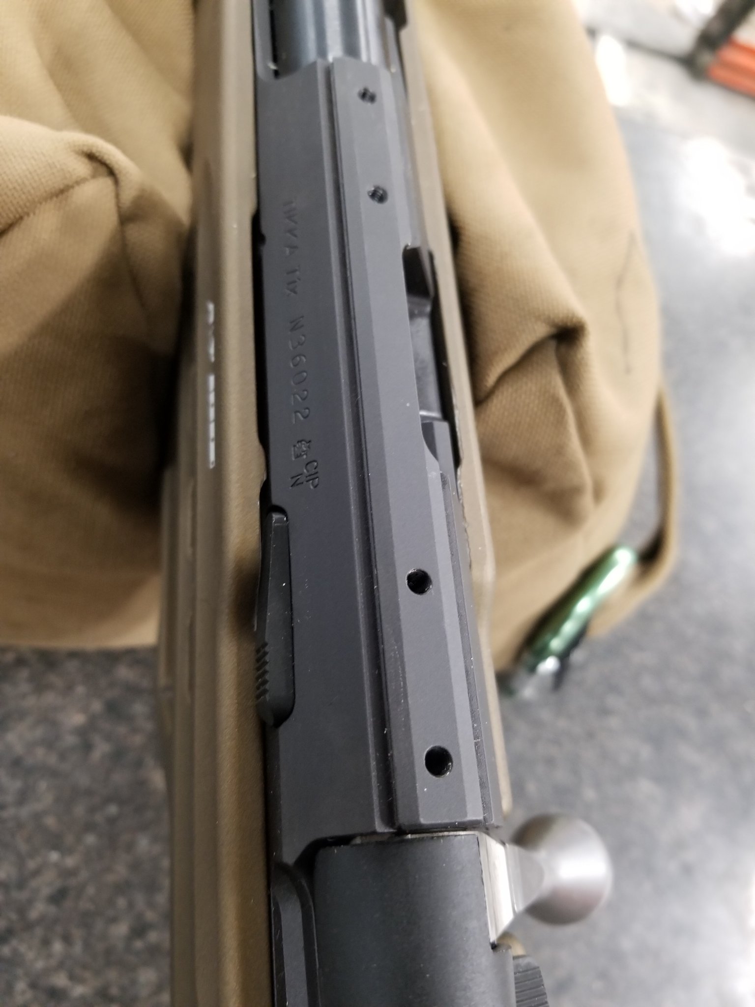

I got my KRG bravo for a tikka in the mail today, it can be made to fit the T1x buy it is not going to be a simple mill a clearance cut, you have to completely cut away where the triggerguard
Mounts to the chassis in front and go into the triggergaurd a ways, the trighergaurd will need some spacers made and drilled and tapped for flat head screws through the side of the chassis ....when I am done the stock will still be usable by a centerfire tikka

As far as I know, I am the 1st to fit a T1x to a KRG. Several people in this thread have said it can't be done but look at the pictures of my rifle 1 page back. It is possible you just need to be willing to make it work. I wish it was a plug and play option , and knowing how big of a Tikka supporter KRG is , I am sure it will be someday but I doubt it in the short term.

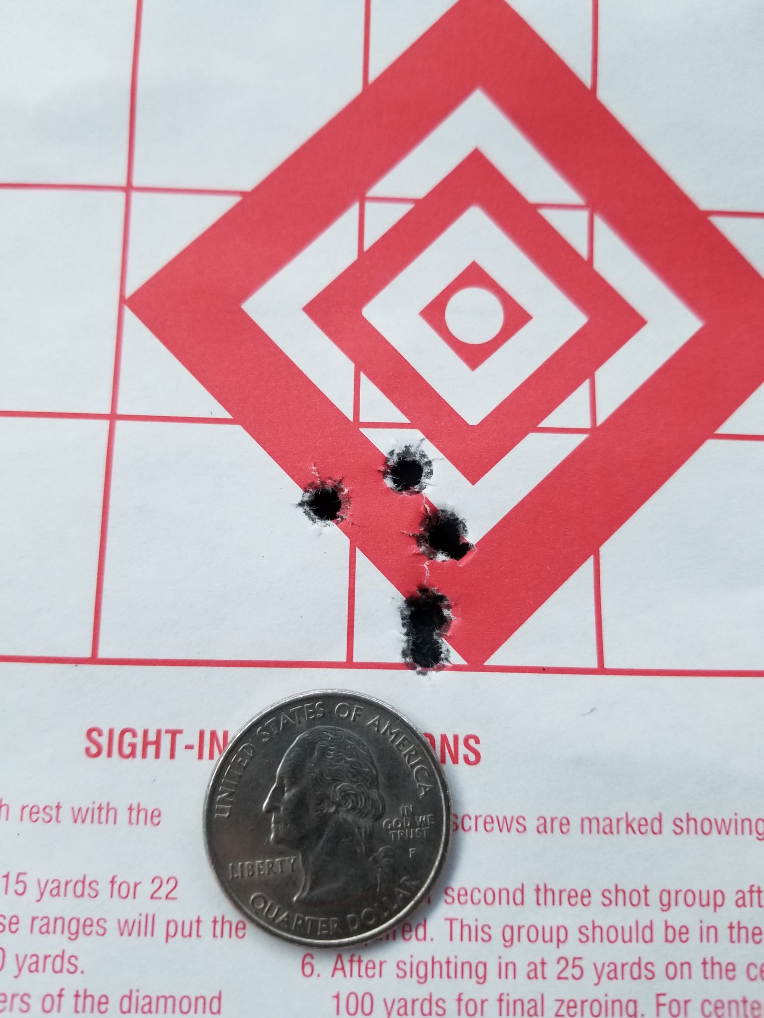

First range session with the T1x.
Groups were shot at 86m/94y at 0 degrees C / 32F, using CCI SV.
The smallest groups meassured 15 mm / 0.6" but most had that one flyer that pushed'em to just about 1 MOA.
Can't wait to see what it'll do with some Center-x or SK rifle match.
