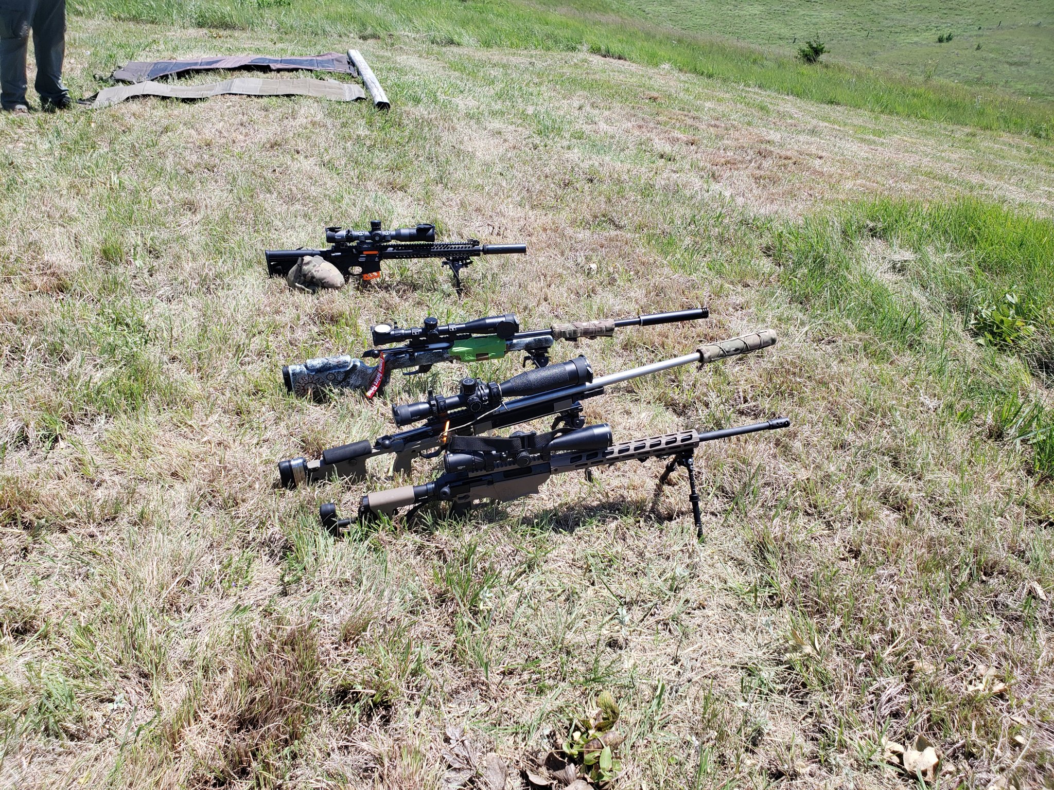

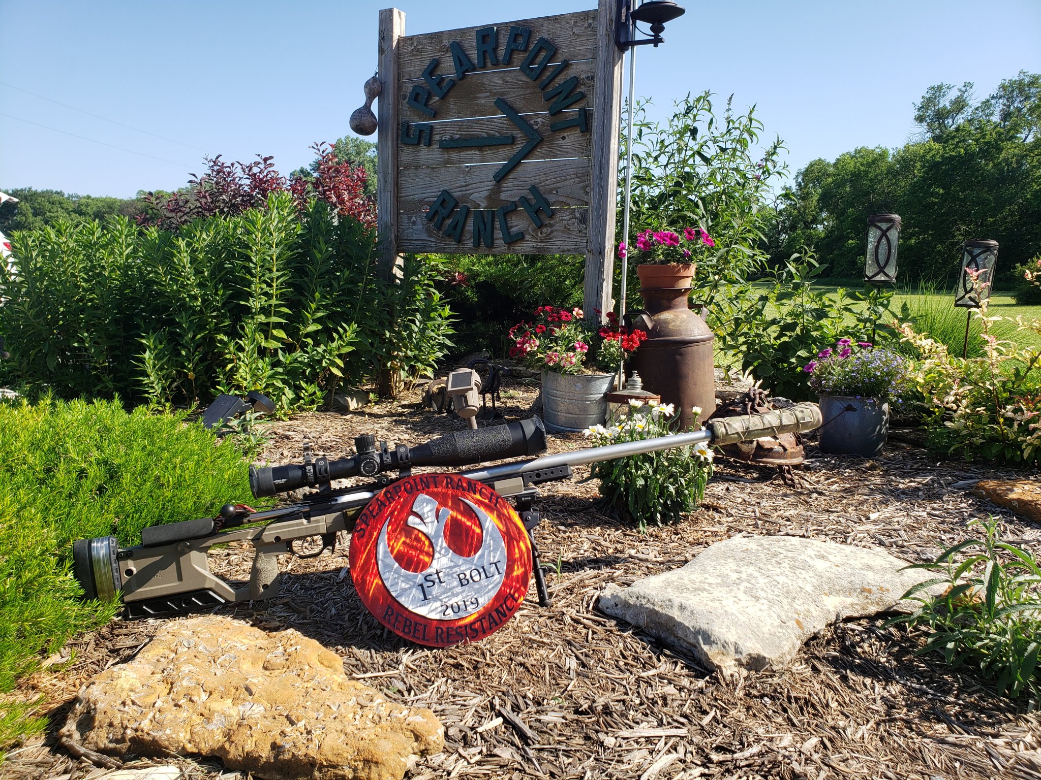

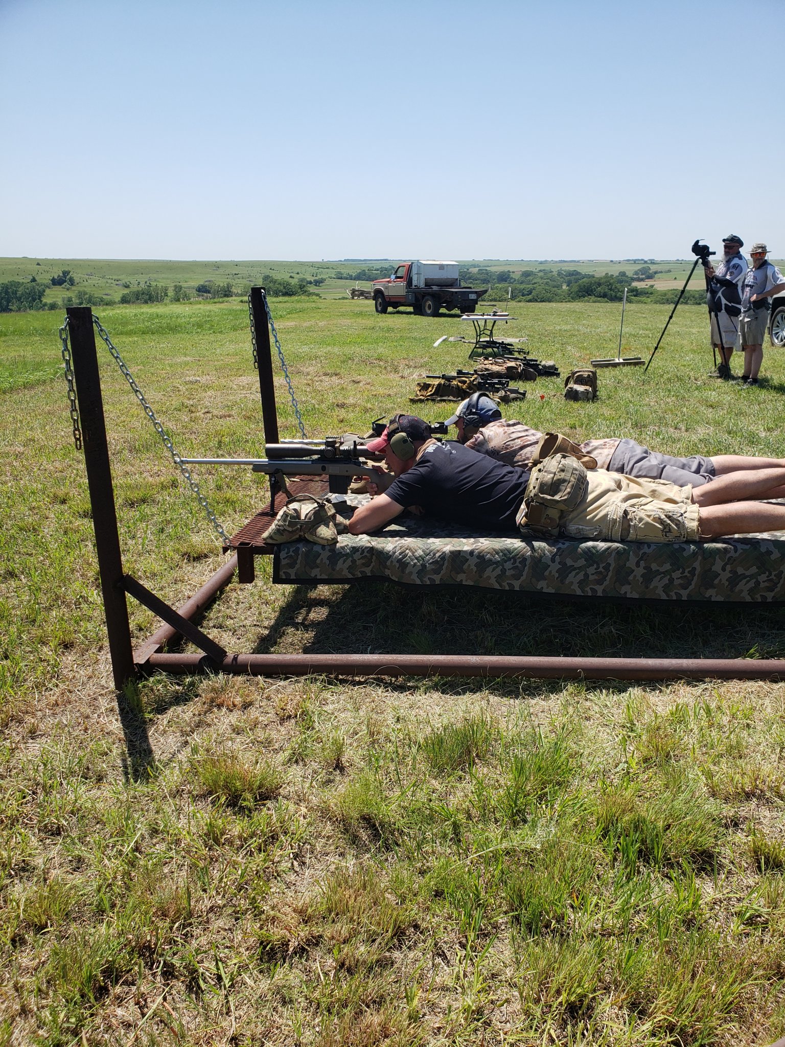

My son and I shot a Jim See format team match at Spearpoint Ranch on Saturday. One rifle had to be a 223 and they had seperate bolt/AR classes, 5 targets/stage, and all targets had to be hit twice to clear the stage. You start the stopwatch before you shoot and stop it when finished. 15 second penalty per target not cleared.
Went up Friday to confirm dope before the match and spend the night in their lodge. The farthest targerts were going to be 995, so we made use of their 300-1400 yard range and confirmed to 1000. I went on out to 1400 with my Tikka 22BR, so my son decided to take a shot at the 1400 with the Tikka Varmint 223. I should have had the video going, because he dialed 15 mils and hit it on the first shot. I was amazed what the 75gr ELDM did at that distance.
We took the penalty on one stage and cleared all the rest. It was a great time except for the 97 degree heat and the fact that I didn't contribute near as much as my son did. We ended up 1st in bolt and 5th overall, and it was because he was on fire with the 223.
My son shot the best he has ever shot at any match and he has decided the German Gun Stock Raptor is the way to go. There was a rock stage that he couldn't fit any of our bags in, so he taped my Gittings Equalizer Skid pad on the forend and ran with it.

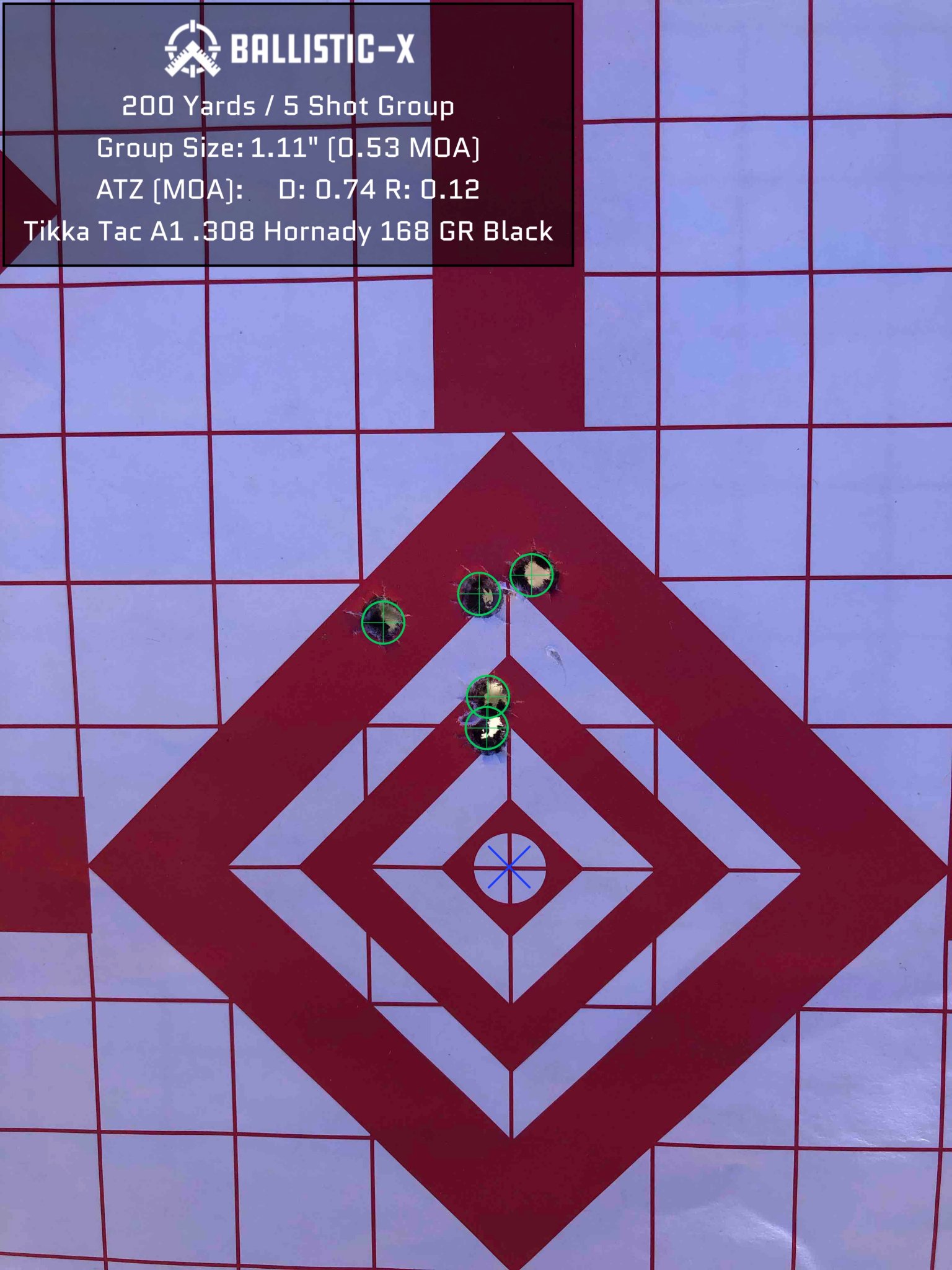

I just cannot seem to get below 1/2” groups out of my Tac A1 .308 using factory loads. But I was reminded by a buddy whom I respect, that 1/2” groups from a mass produced rifle using factory ammo is excellent, and unless I reload, this is probably as good as it gets
7105817
Are you saying you want 1/2" inch groups @ 200 yards? (1/4 moa) expectation?
I met someone with the Tac A1 in 6.5cm getting 1/4-1/2 moa with American Gunner 6.5cm ammo, so maybe that's just a lucky pairing of factory ammo.
He's also a much better shooter than me.

I am shooting 1/2” groups now...i want sub 1/2 moa at any distance....doesn’t matter 100-200. 1/2 moa is 1/2 moa, regardless of distance,

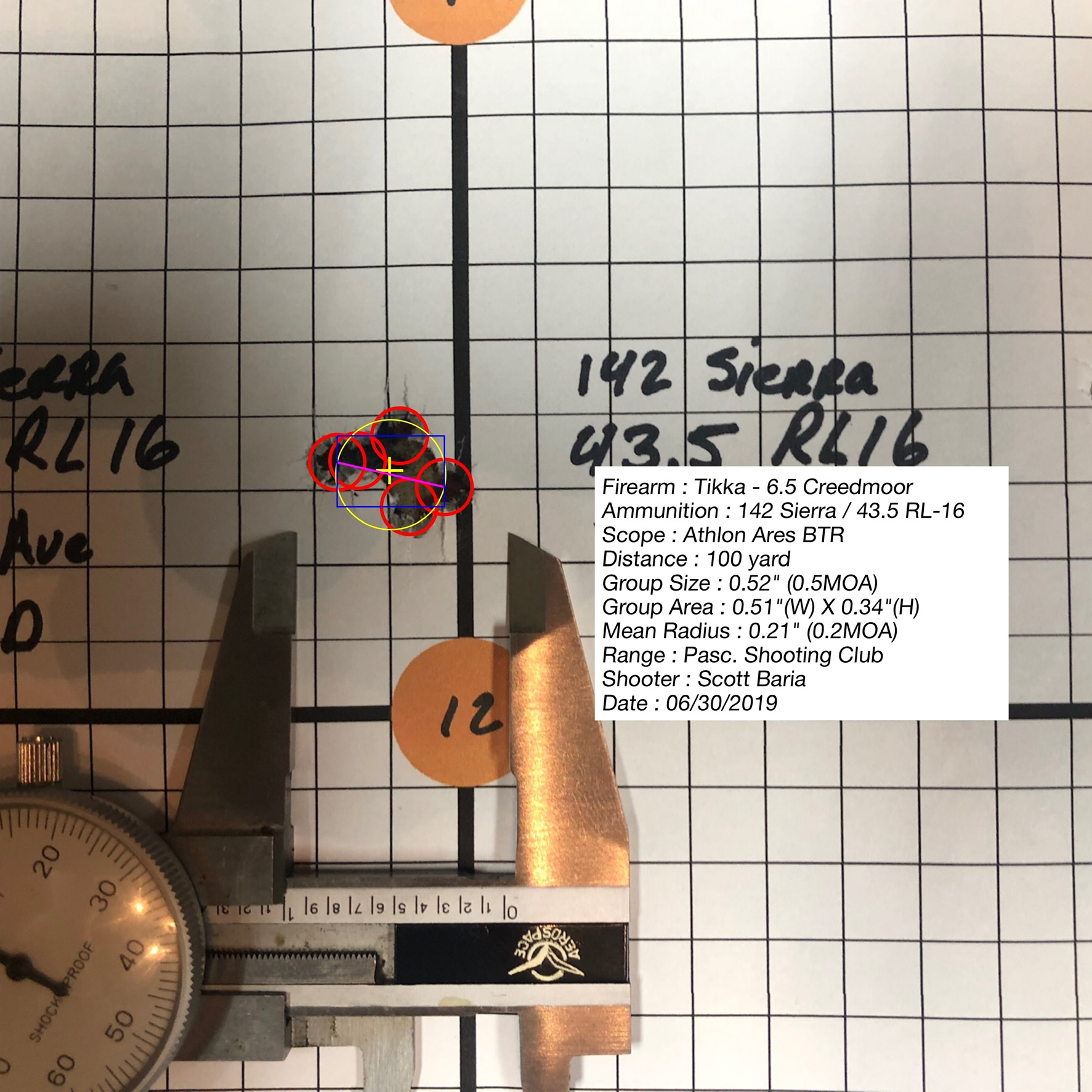

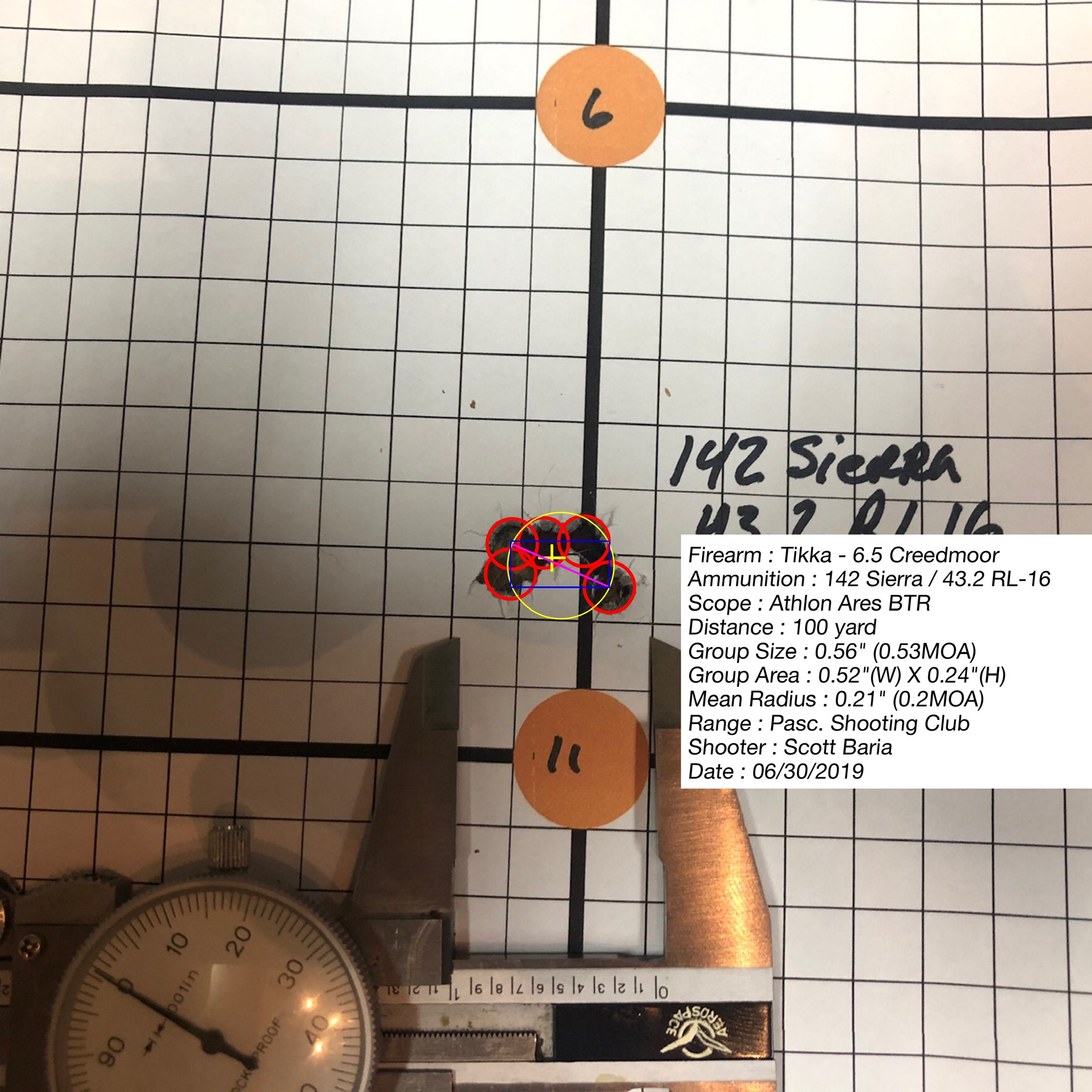

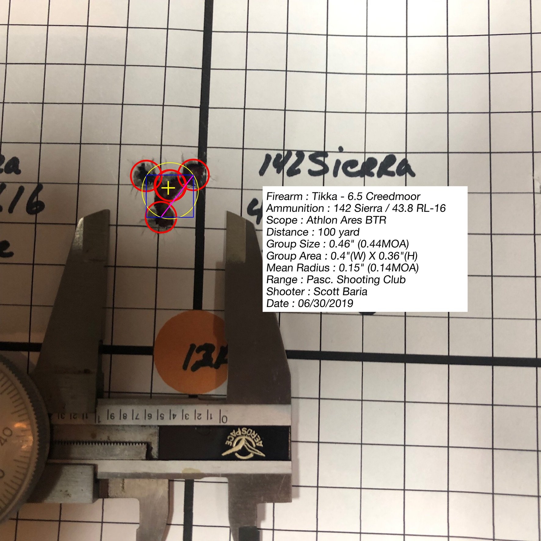

I had a chance to get some range time in this past Sunday after working out the kinks in the Midas trigger and reinstalling in the Bravo Chassis.
I had cleaned and de-coppered the bore after the last range trip a couple of months ago, so I ran a couple of dry patches down the bore to mop out the CLP followed by 20 rounds of factory Hornady 120 grain match ammo to burn any oil out and foul the bore.
50 hand loads of Nosler 140 shot ok, but nothing to brag about, nothing worthy of further development.
I did see that RL 16 and RL 19 offer significant increases in velocity over the same loads using H4350.
I’m talking 200 FPS than my H4350 “control” loads with the same bullets.
The 24” barrel on this rifle was about 150 FPS slower than the 26” barrel on my Savage 12LRP ( yes, two inches of barrel should be worth about 50 FPS ), but I made that speed back plus some extra.
Looks like this Tikka might have a sweet tooth for 142grain Sierra projectiles.
I will be doing further development on these:
Take it from someone who chased the sub half moa fever for a long time.... just shoot the rifle. If you have a 1/2 moa factory rifle, running factory match ammo, you have a solid rifle.
Shooting 1/2 moa at 100-200 yards is easier than shooting 1/2 moa at 600-1000. Wind, mirage, etc will all come in to play.
Learn to read the wind. When you get that down and still want better, start loading your own.

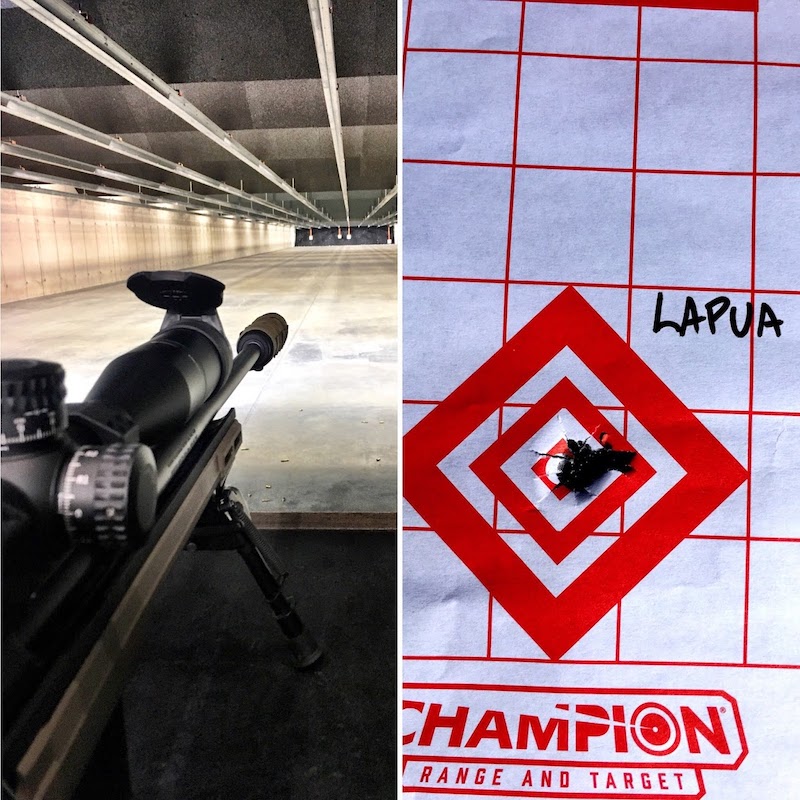

Tikka T3X TAC A1 the game changer.
7107308
Deam that this 6.5creedmoor is amazing rig.
I bough Lapua 6.5creedmoor brass and plugged it with Lapua 123gr and Vihtavuori N150 powder.
100-meter test shots were 5-9mm with 5 shots.
I tested also the same ammo in 300-meters.
3-shot group was 0,168 MOA.
14,72mm, i am very happy with this result with the factory rifle:).

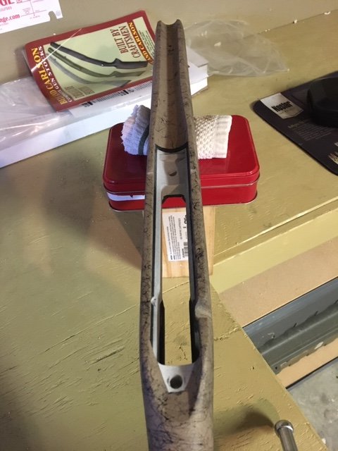

I stand corrected. I went back and looked at pic's. That is a raised lug, right?
Yes, it’s part of the bedding block.
I’ve had one of these stocks that fit well as I received it and a couple that didn’t. Bedding straightened one out, it shot very well after. I think I returned the other one.

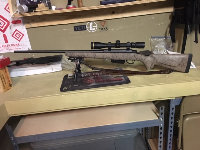

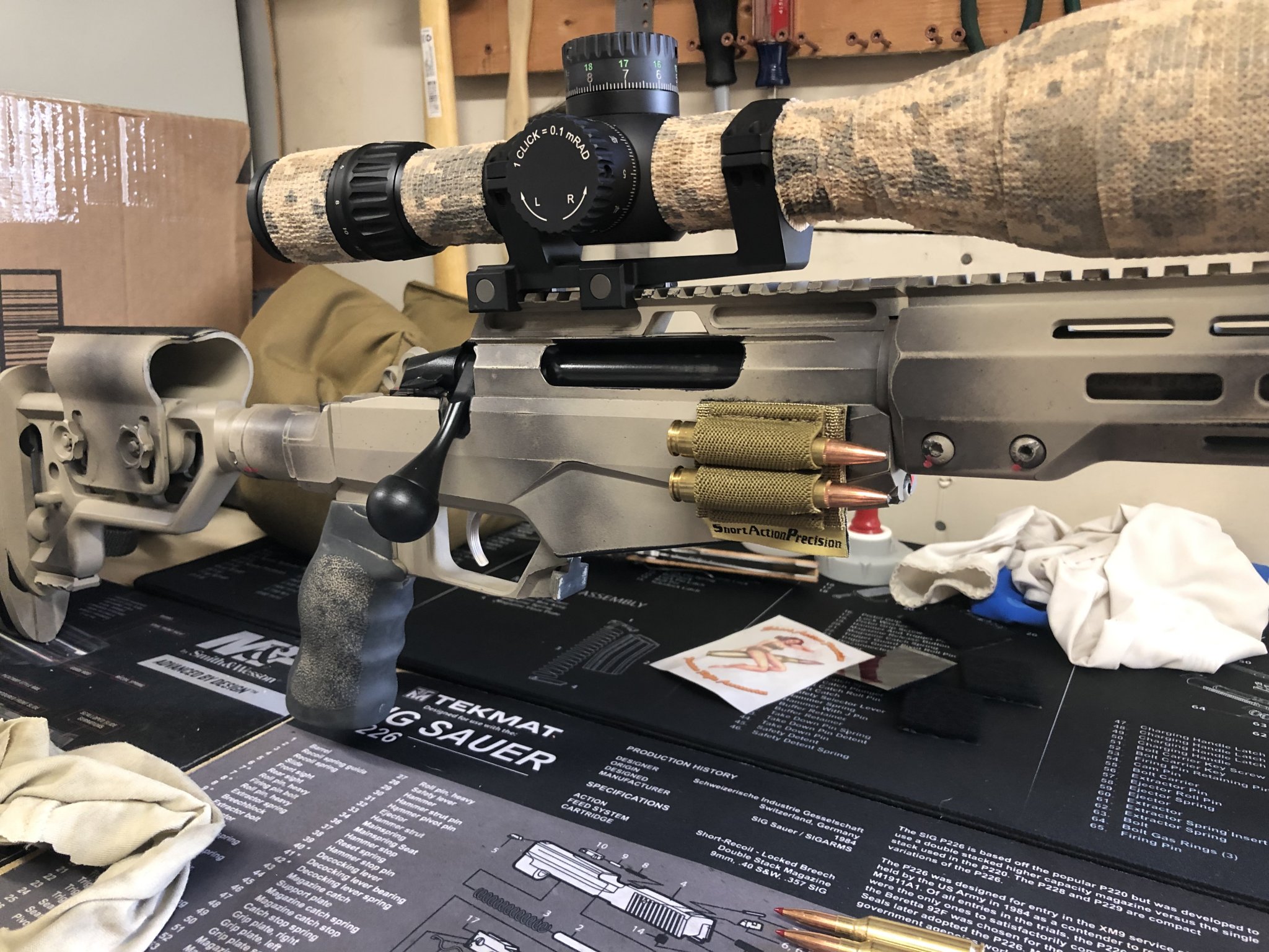

That tan with black web looks good with your rifle
Your friend is correct. People spend a LOT of time and money to get a half MOA rifle.
