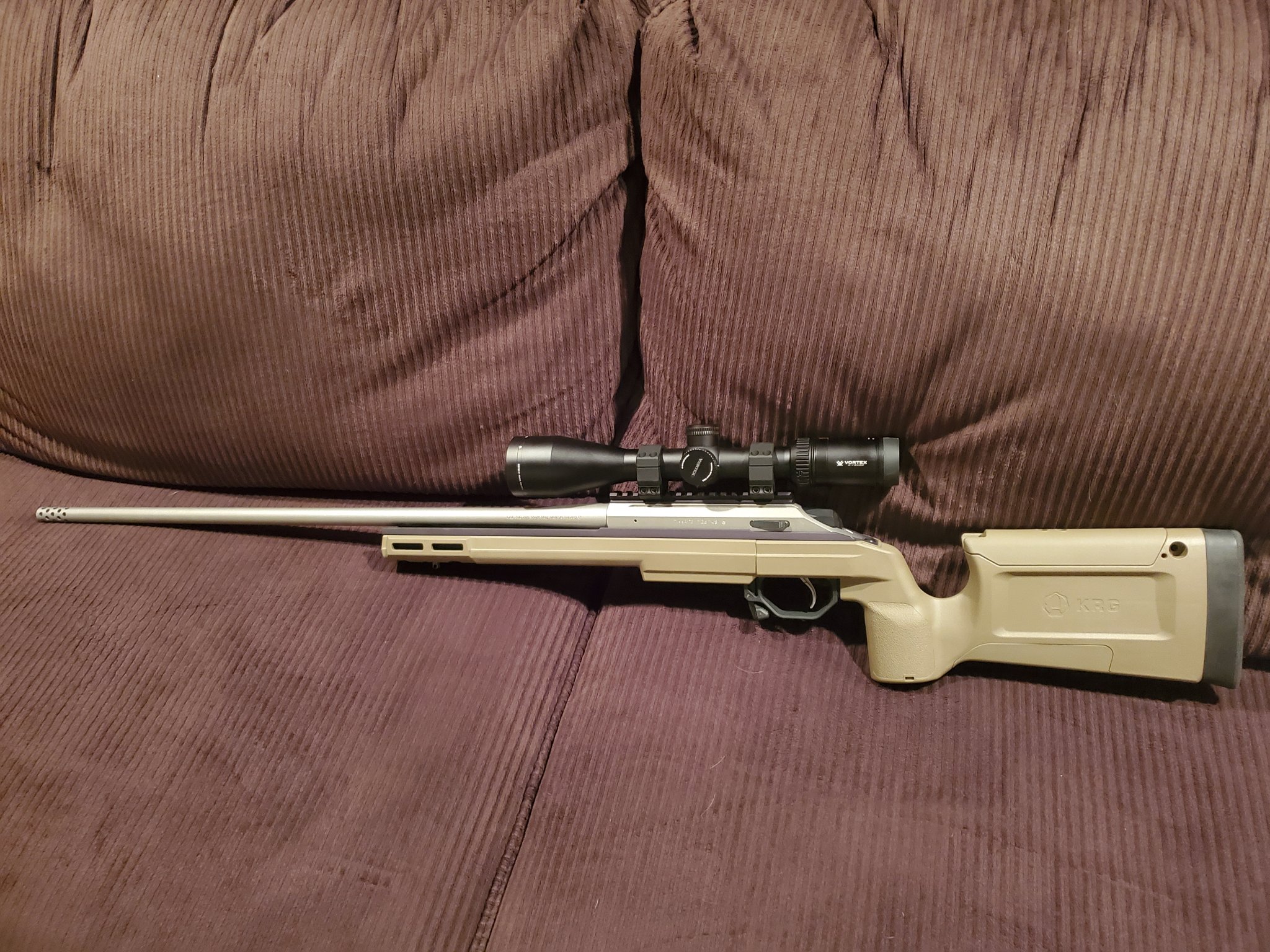

Tikka T3 Thread
Tikka T3 Stainless Lite in Eliseo Tube Chassis
30" Bartlein .299 1:12" medium palma barrel
.308 Palma--Bisely 150 chamber
155 Sierra 2156 at 2.940" feed from mag--3050 FPS

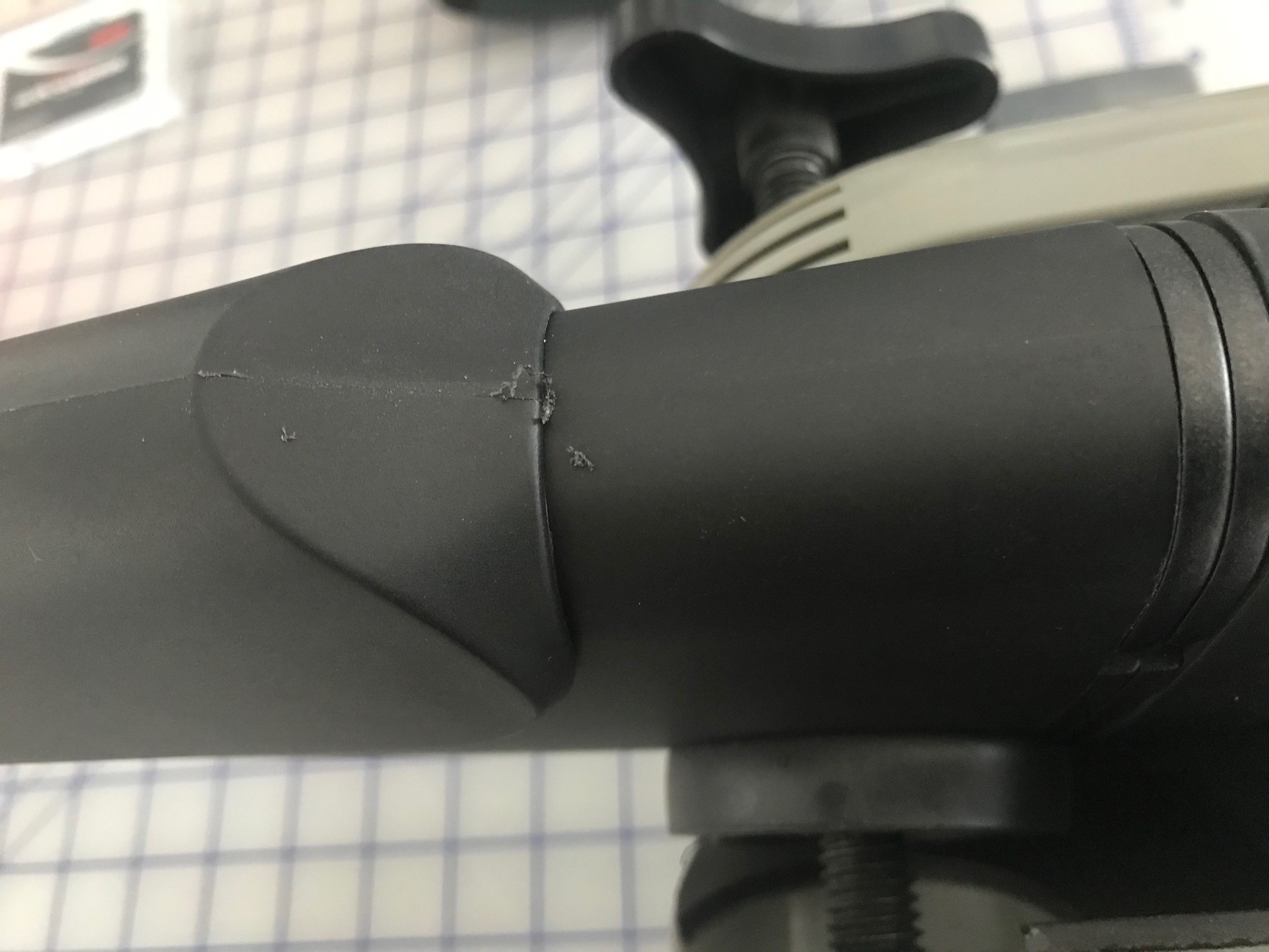

I actually like the boring black stock; to each his own. If I could only see the flashing, and not feel it, I wouldn't even bother.
I guess it comes from my time machining components - we would never let an unfinished piece out the door unless the customer specified that they wanted to finish it afterward.
I don't mean to trash Tikka - the important parts and design are great. So far a really nice rifle especially seeing as how it's so much less $$ than Sako. Granted, skipping the trimming is one more way to keep the cost down, but for me at first grab it sure feels like Toys-R-Us. I've never felt the mold flash on a stock before.
Here's a photo of my trimming to answer your question. Compared to how it shoots this isn't all that important so I won't post any more unless I get another question. Like many here I'll probably wind up with a custom stock next year anyway, and when I'm done I'll spend as much as a higher end rifle after all. :unsure:

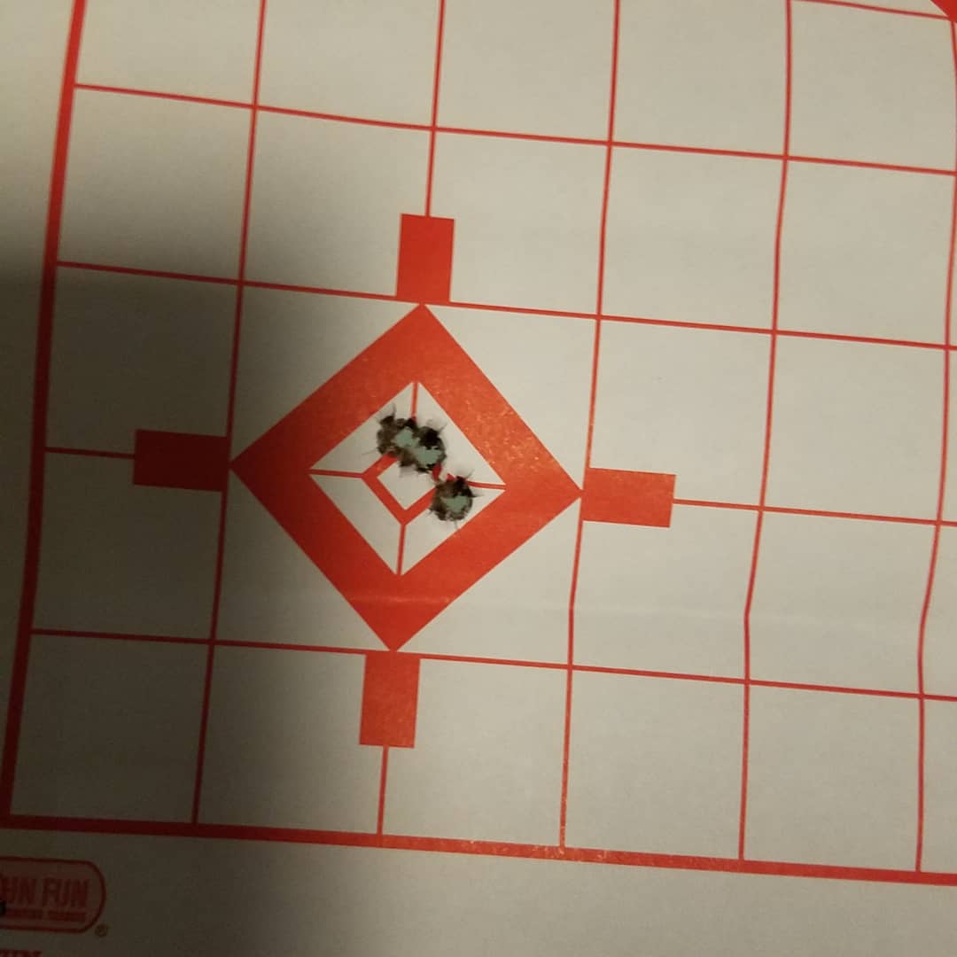

Took the new 223 CTR out for the first time and wasn’t disappointed! Grabbed some random 40 gr Vmax loads I had sitting around. I’ve got plenty of 75 gr Amax I’ll be loading up shortly.
Ended the day with this 7 shot group at 100 yards. Typical boring Tikka accuracy!
Almost boring how consistently accurate these rifles are right outta the box. Almost...
