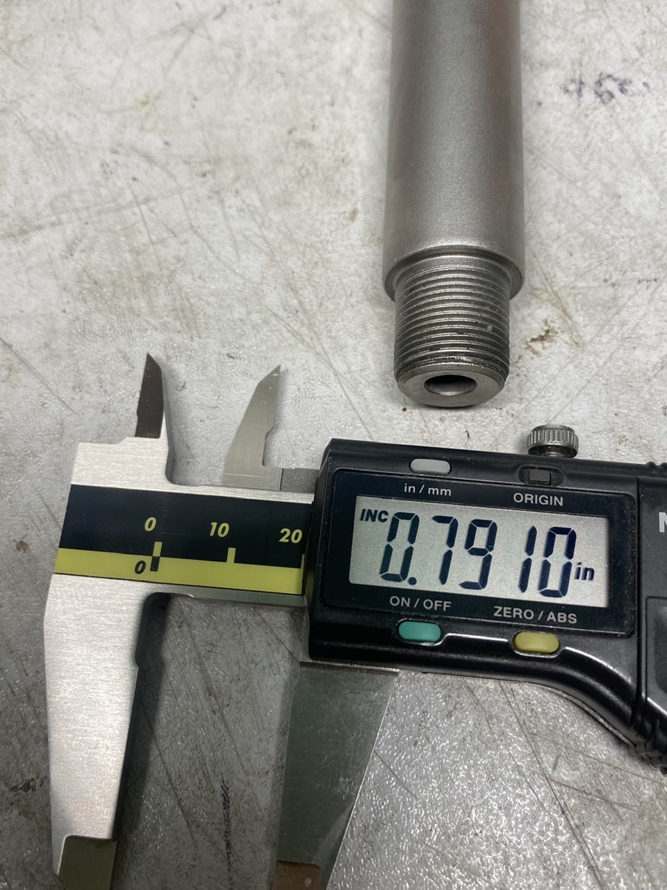

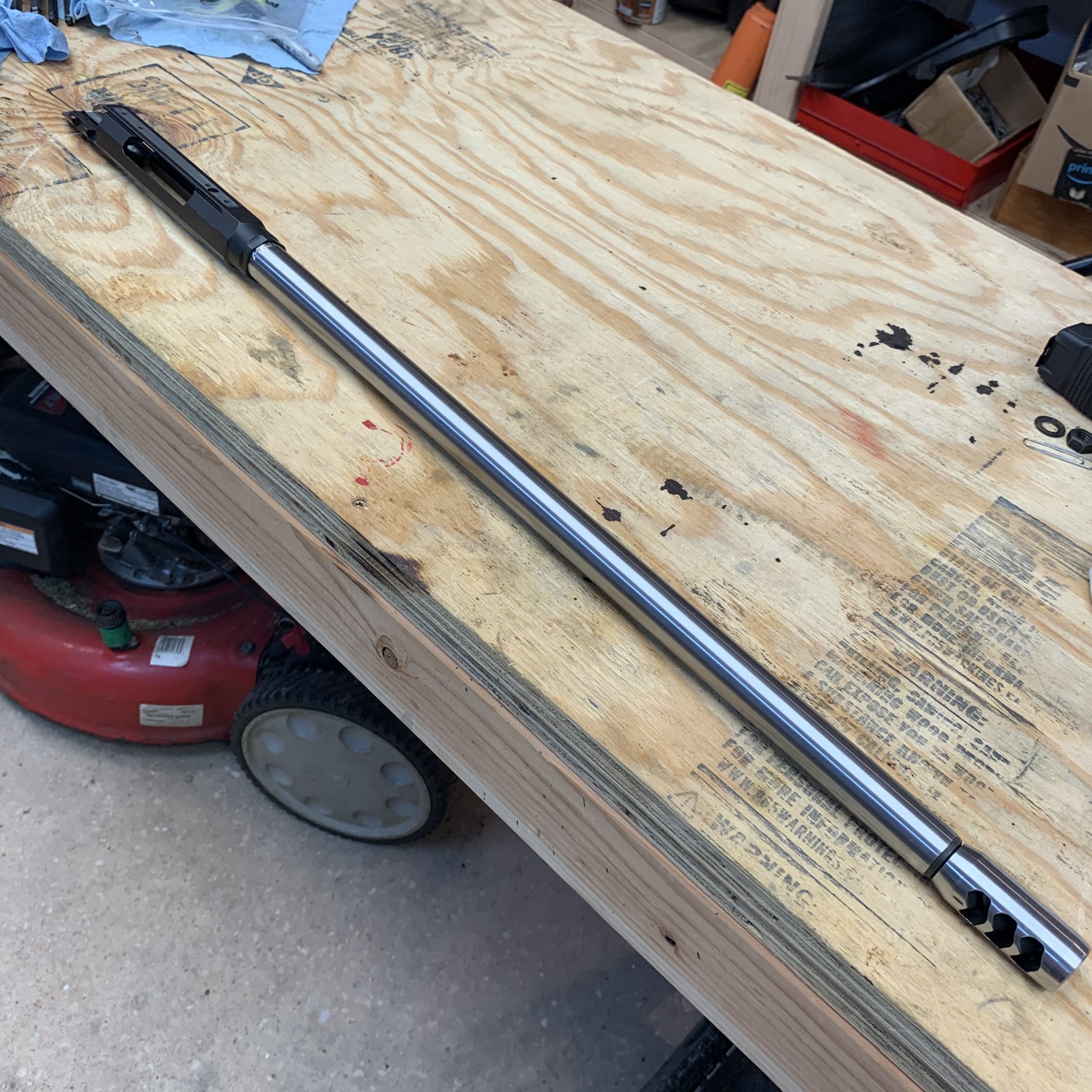

I have a CTR, 20" 6.5 cm on the way. I'm ordering a brake and want to have it tapered to match the barrel. Can anybody tell me the barrel diameter at the base of the muzzle thread on the factory threaded 20" barrel please.
Obviously if I had the rifle I would just caliper it, but I'm hoping to have the brake here when I get the gun.
Thanks in advance

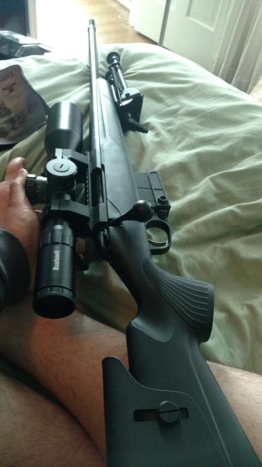

I'm looking to get some advice, I have been shooting a Tikka t3x CTR 24 inch 6.5 in competition now for about two years. It's been a great ride but at this point I find that my rifle is too light and in odd or rushed positions without a perfect prone cheek weld I really struggle to see my impacts. I have shot other competitors rifles in heavy chassis with 6 dashers and find the number of advantages to be ridiculous. I find the advantages so great that if I plan to continue competing (which is going to happen no matter what) It's going to constantly bother me unless I upgrade. I want to up my game and get a sniper fill McMillan A5 and as heavy of a barrel as possible. I really am looking to redo the rifle while keeping the tikka action. I find it difficult to rationalize spending 1000$+ on a custom when the Tikka action is butter. I was really hoping to get some feedback from the hide.
(please enjoy my hairy legs and kitty mouse pad)

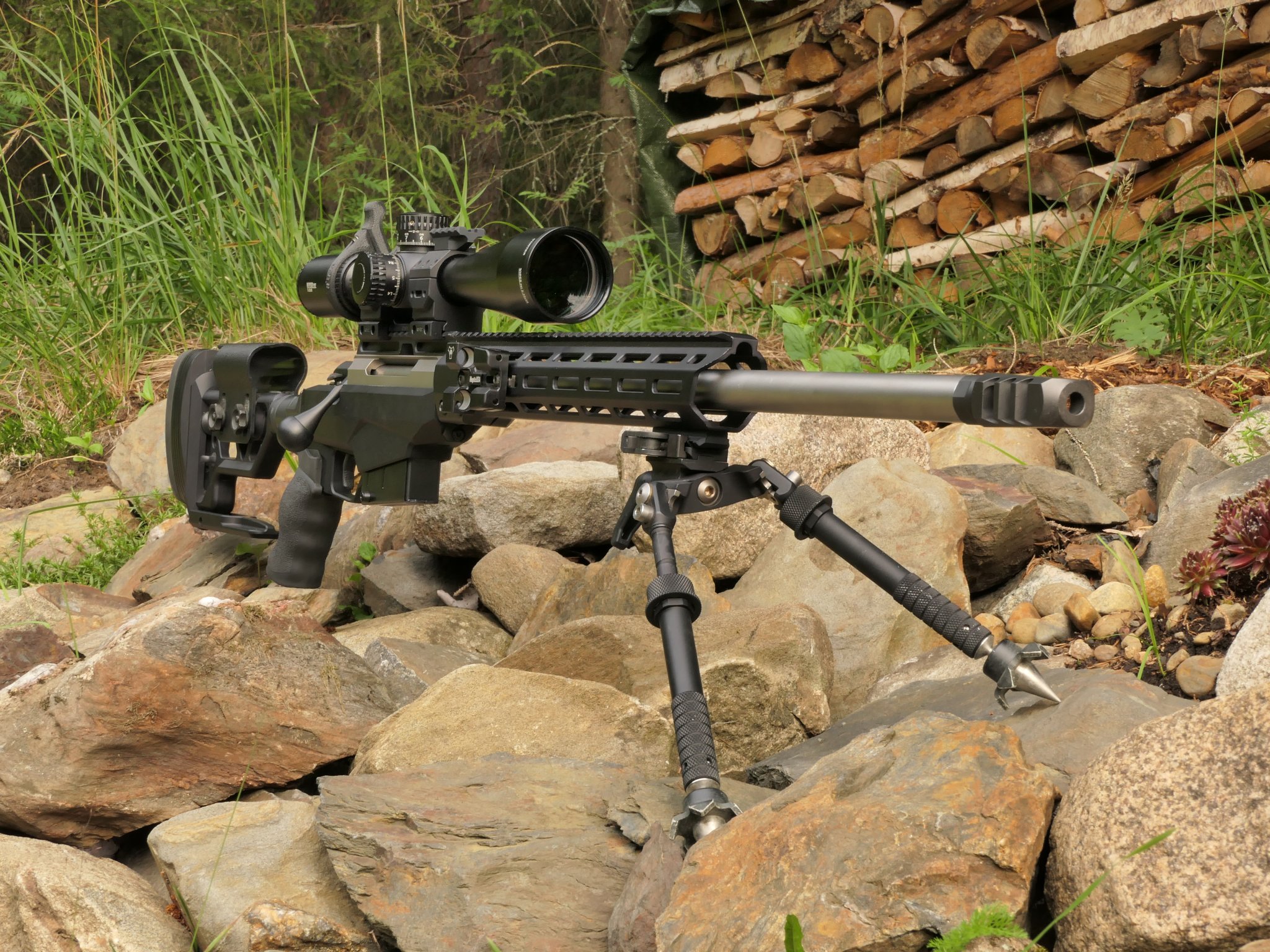

Tikka T3 Varmint SS 24" 260rem & TAC A1 chassis, TRG magazine.
Wont stay on this color theme long time, cerakoting is on the map.
Cerakote new Elite coated, will take more beating that normal cerakote, only problem is that there aint many color choises.
I have been thinking that it would be all grey, or chassis 100% and action would be on sand and barrel only in black, or sand, or the

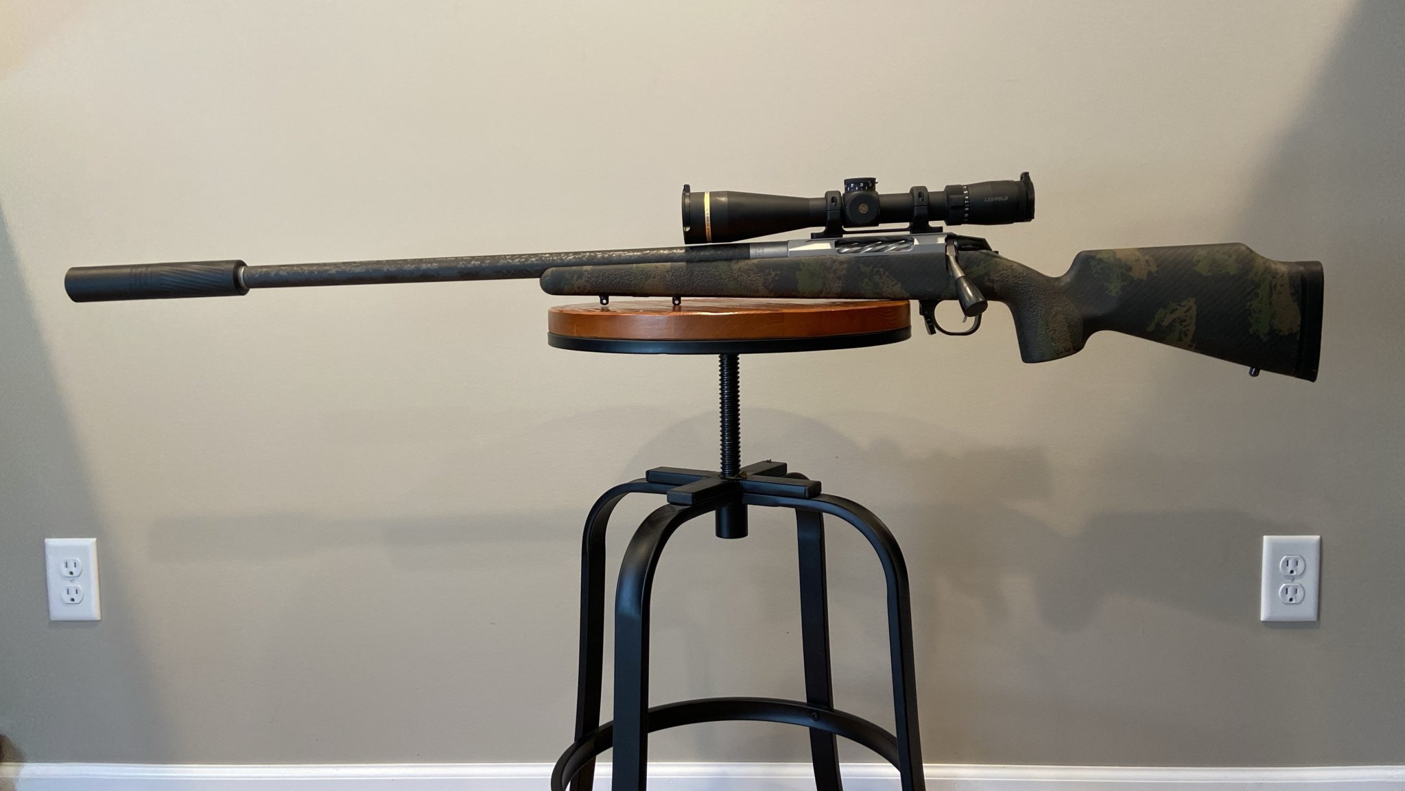

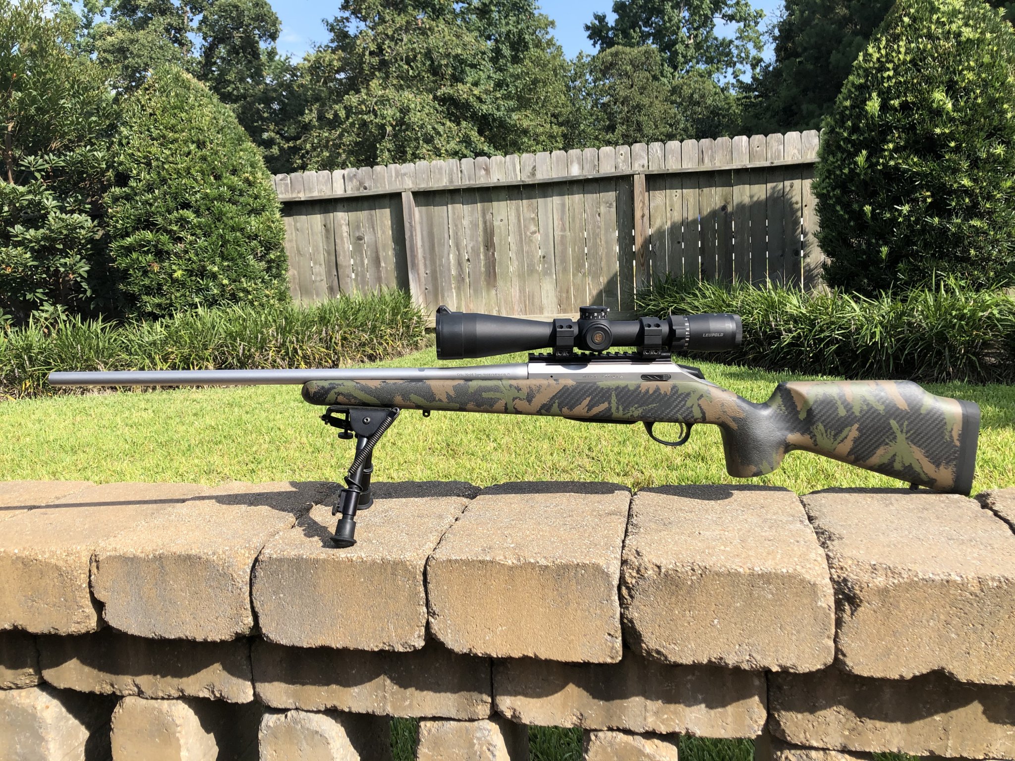

A modern take on the 30-06...
- Proof Pre-Fit
- Mesa Precision Altitude Barrel
- RedSnake L/A Bottom Metal (AICS Mags)
- VX-5HD 3-5x15 in DNZ Mount
- Ultra 7
Shooting 166 Hammer Hunters at 2940fps with .5 MOA accuracy on the regular. This rifle is certainly a better shooter than I am.
Why did you put the rifle in front of a mirror and take a photo of the reflection? :unsure:
- Proof Pre-Fit
- Ultra 7
Looks perfectly fine to me. Don't know what you're talking about @wade2big . Looks great Mark.
Reactions: Mark @ Exo

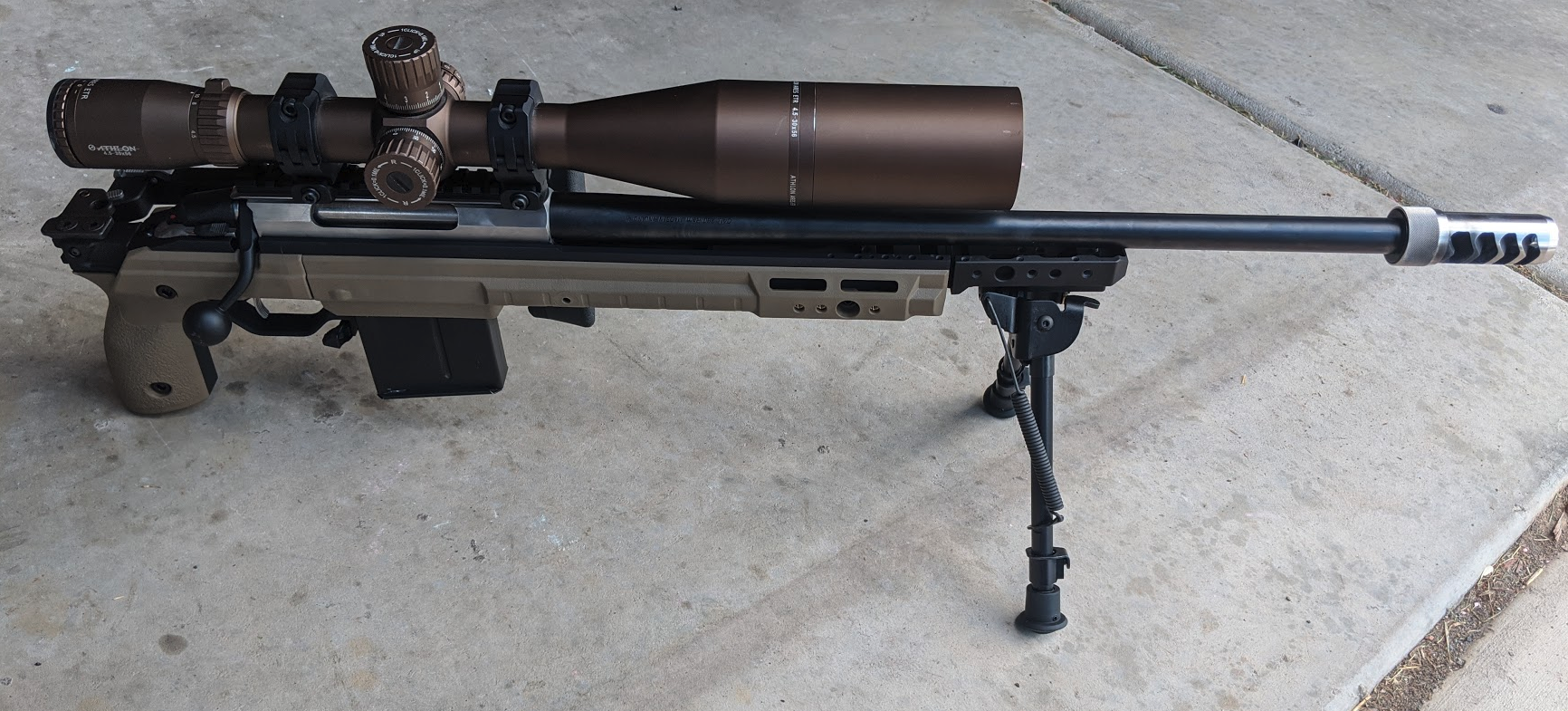

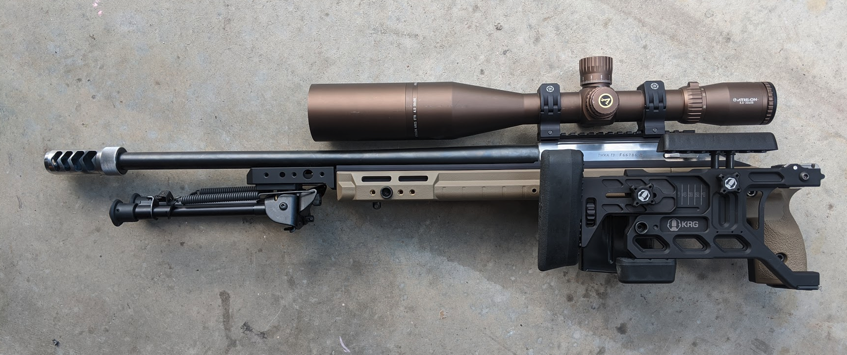

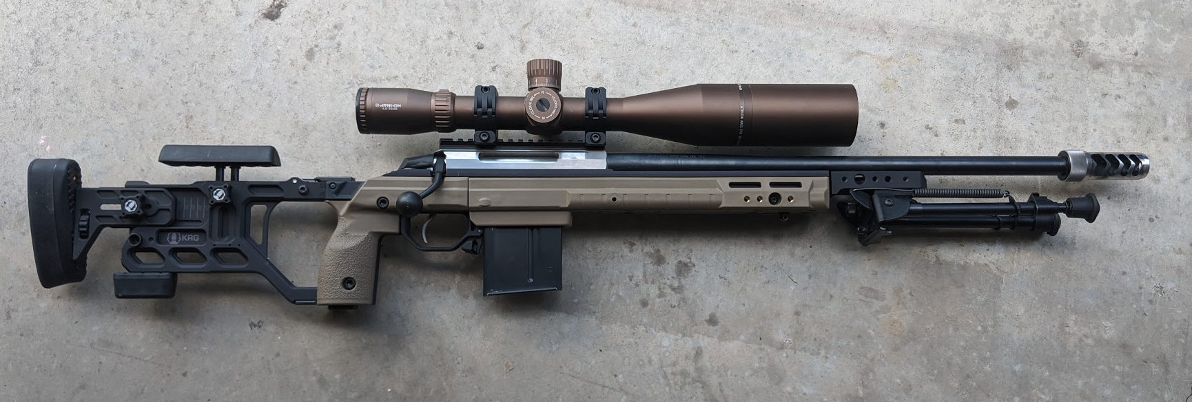

Removing my T3X CTR from the chassis and putting it in the MDT chassis was easy as heck, took 5 mins. Just make sure you have the right tools and tool sizes for the lugs, if anyone is worried about the complexity
Thank you. I need to look in to these. I should be getting my T3x 7rm tomorrow or friday and 7 saum brass is short to follow. If the cartridges dont work well in the tikka mags these look like the go to. You havent tried either of these in a tikka have you?
This is essentially the configuration I am going for with the bottom metal. I like the idea of being able to use flush mags for hunting or longer mags for steel/fun though. For hunting, its whatever is the most reliable and lightest.

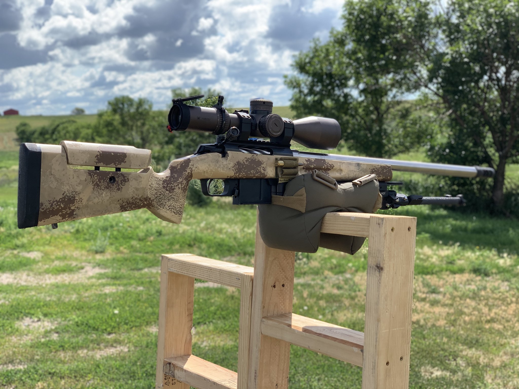

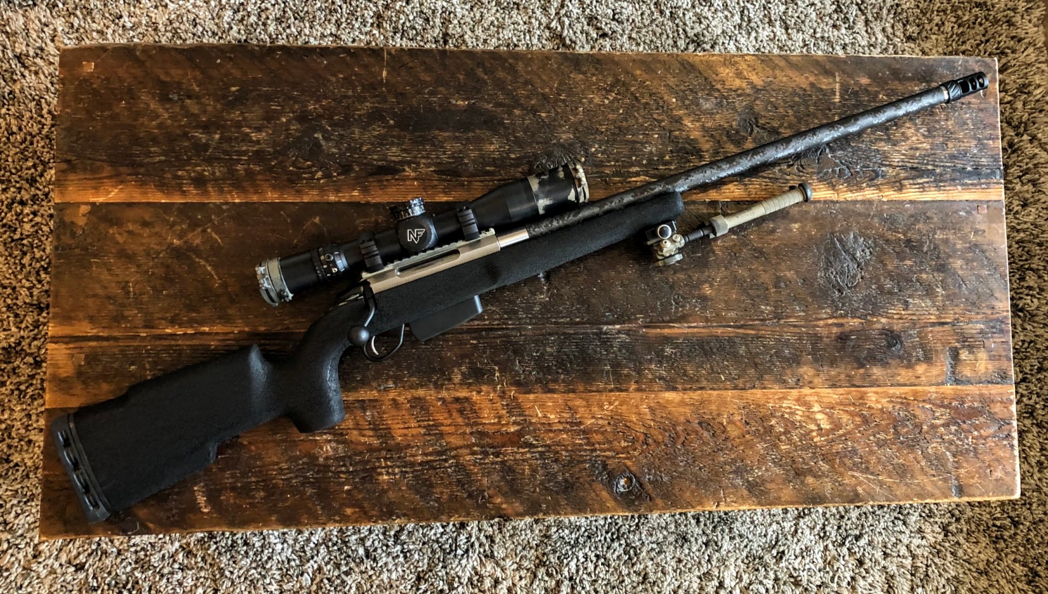

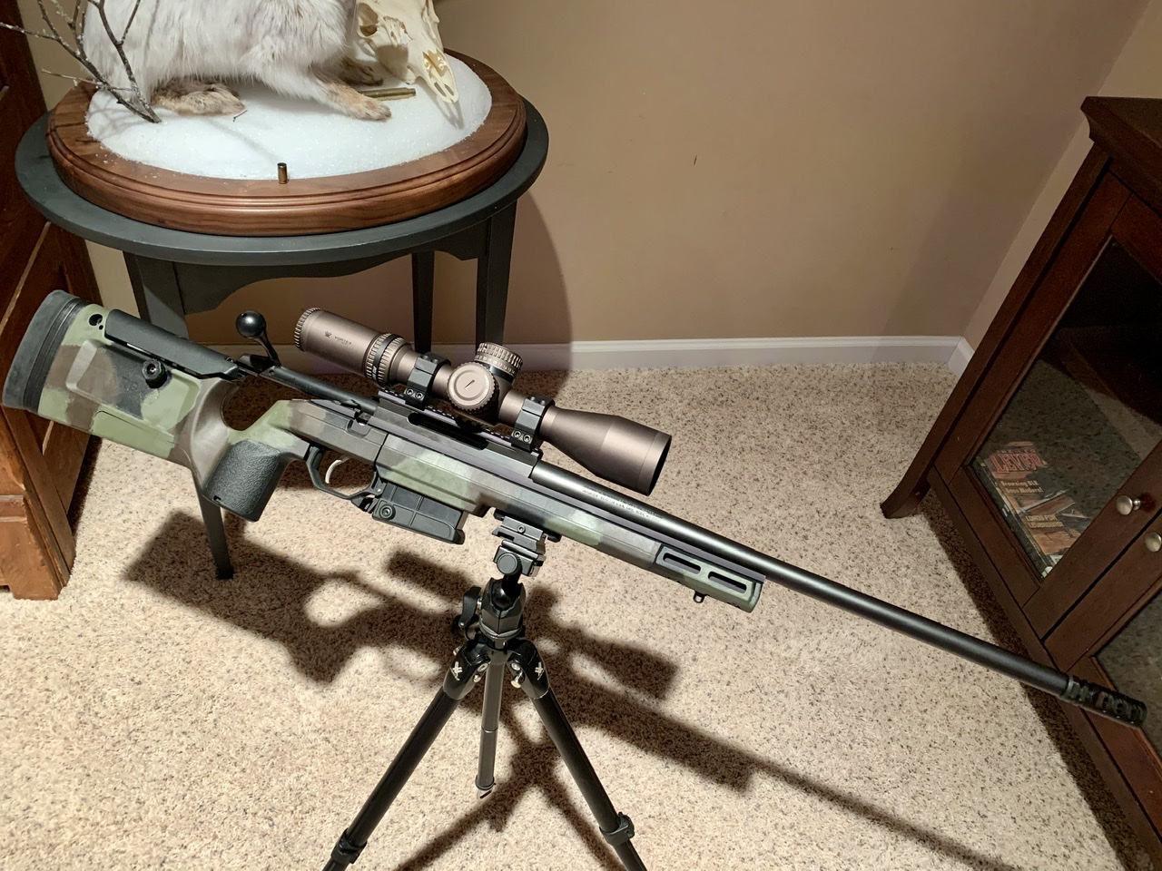

I debated that too but it’s hard to beat the performance. Criterion prefit 24” MTU profile. Manners T6A. Assembled in my garage. Per Manners no bedding is required on the tikka inlet. Rifle shoots lights out.
I like the MDT LSS XL Gen 2 Chassis, but I was looking for more tradition stock like a grayboe.

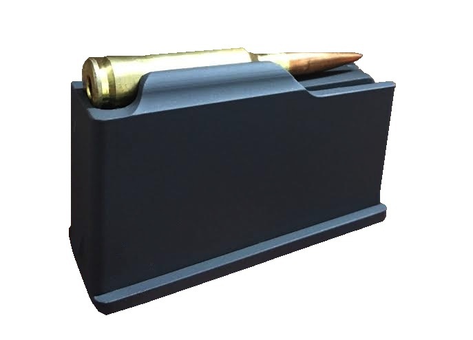

I would look at the Mountain Tactical LA billet mag and BDM.
Unless your going to load longer than 3.34 ? and want to load more than 3
They take 300 wsm so your base diameter would be the same at .555
I've got one for my 6.5 PRC in an Atlasworx BDM and they work great.
Reactions: viking78
I’d be happy to sell a MT wsm long action Magazine for factory tikka bottom metal. The hells canyon ones are better.

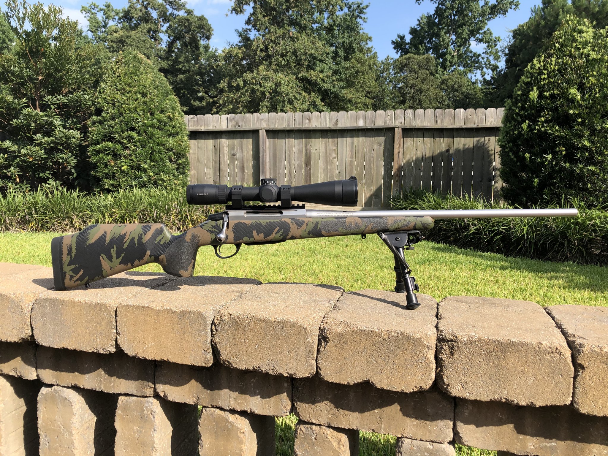

What have you guys used as far as a bipod on the original stock? Mine is a CTR for reference. Not really looking to drop it in a chassis. Not at the present moment anyhow.
Harris bipod attached to the front spigot seems to work well enough. Initial sight in with Hornady American Gunner 140 gr BTHP.

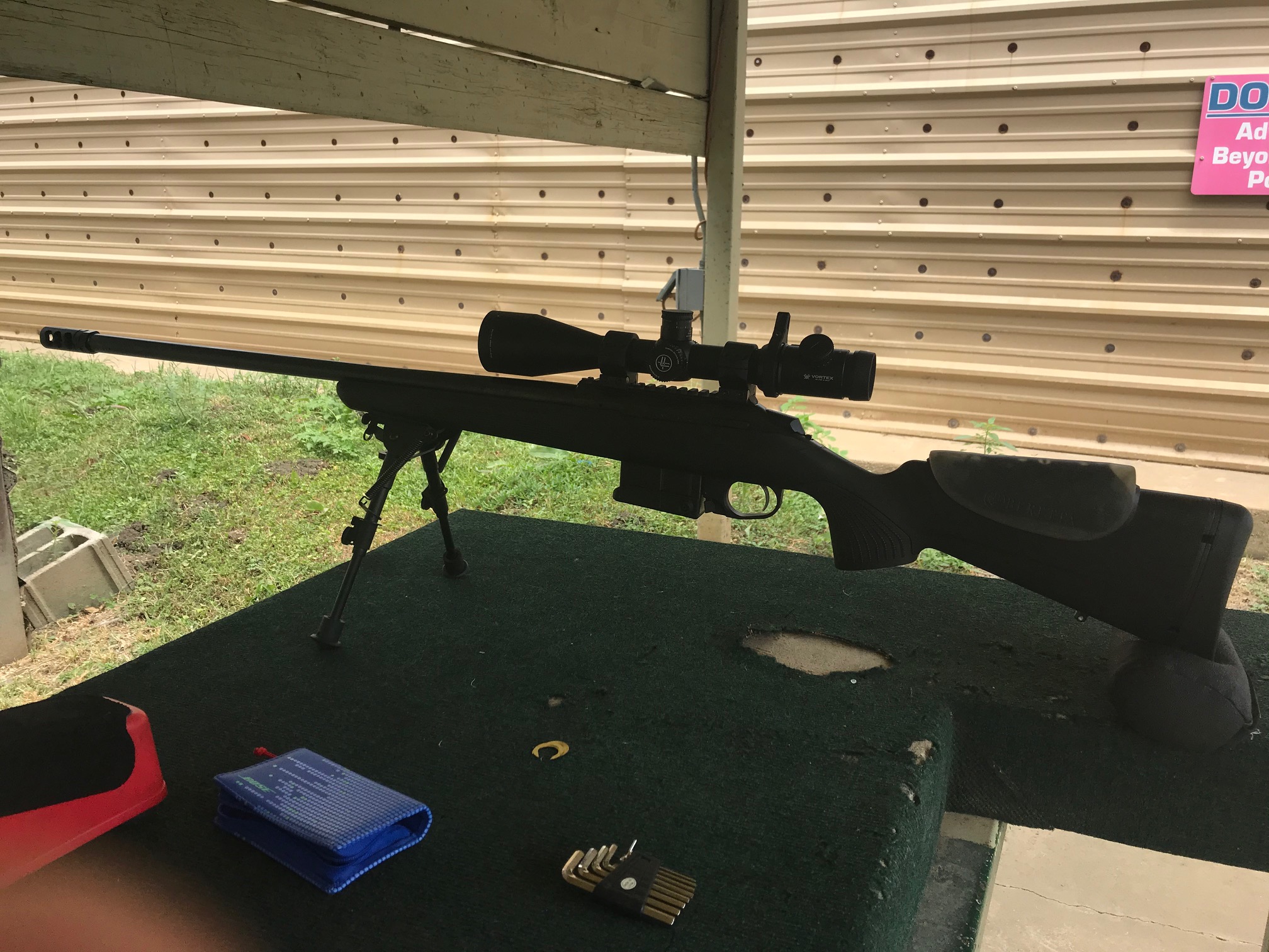

Testing my new 260rem T3 SS Varmint Tikka, with my old buddy T3X CTR with Whiskey.
Holy s..t, dont have words to say, but these Tikka rifles are just awesome, no wonder so many are buying these rifles.
Factory barrels guys, no custom here.
Only the ammo is hand loaded, but i expect that every one who loves them rifles are doing the same.
Lapua 123 Scenar, N150 Vihtavuori 38.6gr COL 73.5mm.

Has any one done a thump rest on a TAC A1 chassis?
I am going to make one on this.
Hate the death grip style shooting with these AR style pistol grip chassies.
I have 2 KRG Whiskey chassis, and they have the best thump rest on the chassis i have tested.
So i want to modified this TAC A1 chassis as much as i can, to get it perfect for me.
Also thinking the Magpul PRS rear stock, but im not sure, will it be better than the factory one.
It is front weighted now, even the factory one is, but now with the 24" varmint barrel, it is even more.
It is not a problem from shooting at prone, but PRS style shooting, it might be.

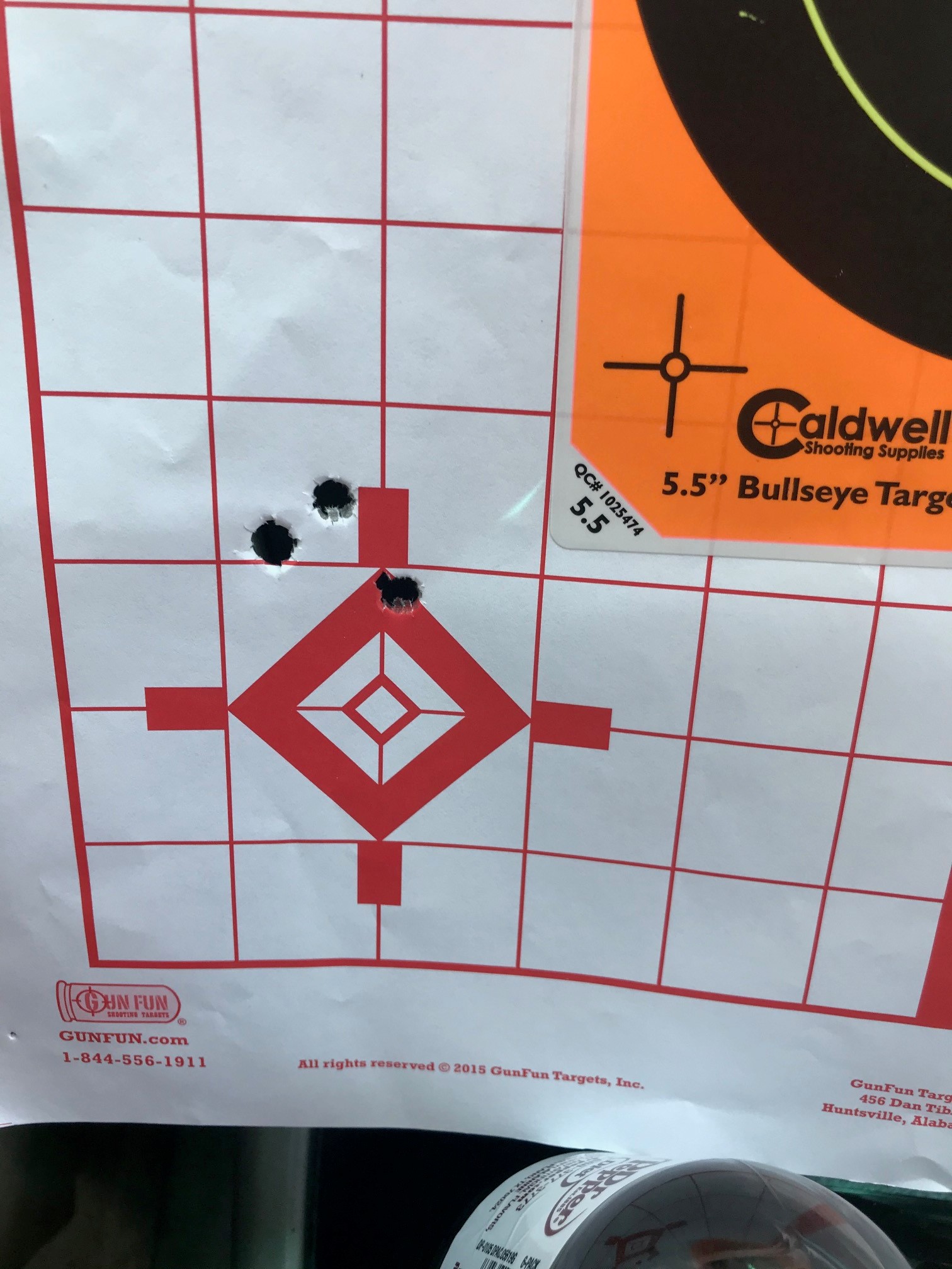

I just took my new 6.5 T3X CTR to the range this weekend and had pretty much the same reaction. I was doing a load work up with H4350 39gr - 42.6 gr in 0.2gr increments and the "group" (excluding the first couple used to get the scope sighted in) was just a bit over MOA. I'm switching up my RPR for the Tikka and I don't think I'll miss it a bit.
