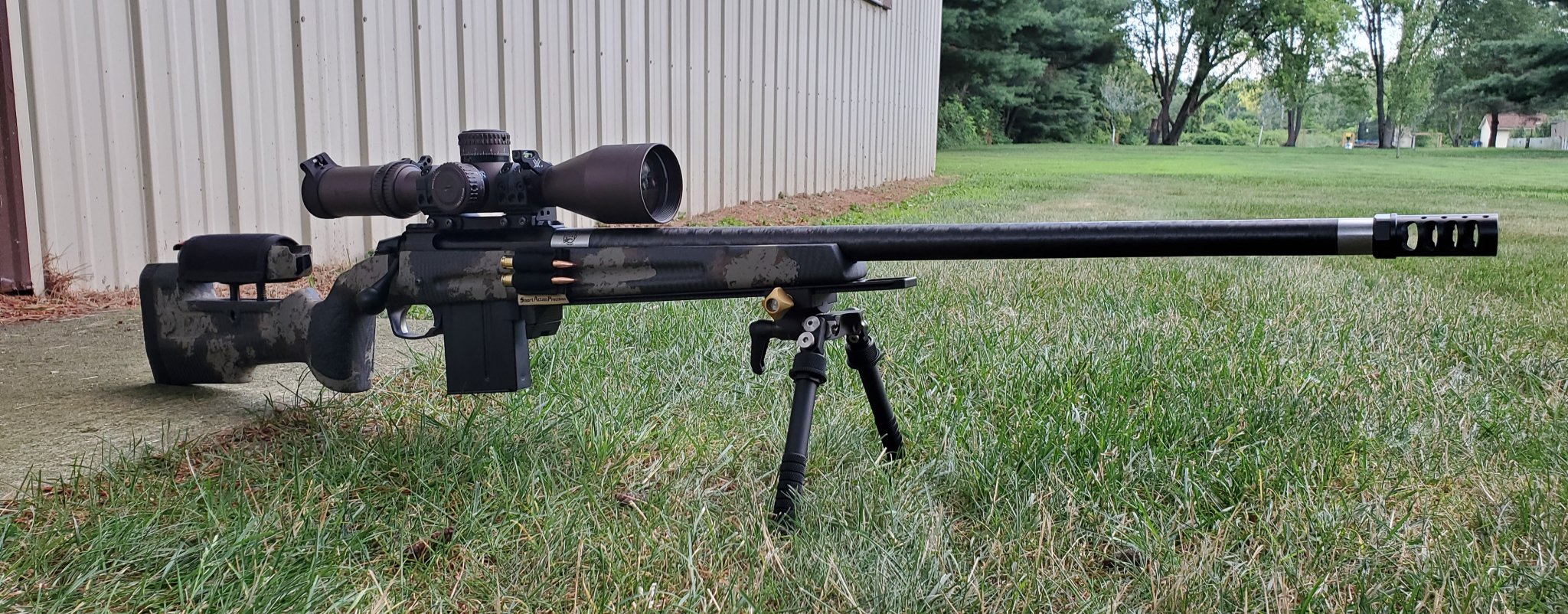

Nothing fancy. Wanted to keep this as simple as possible.
Tikka T3x CTR Adjustable Links.
A-Tec Hertz87.
Premier Reticles Heritage Tactical 3-15x50.
Spuhr mount (not shown).

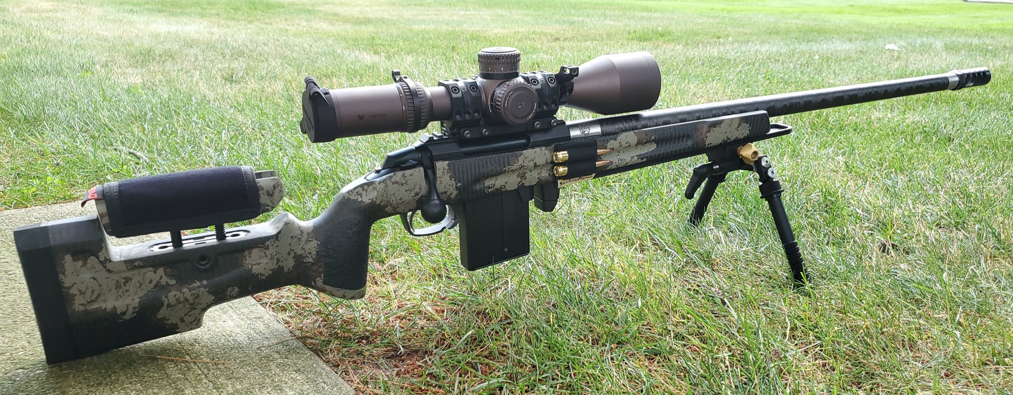

Thanks to all the comments in this thread! Got my first Tikka, a T3X CTR in 6.5CM with 24" barrel. Going to be my 1st chassis rifle

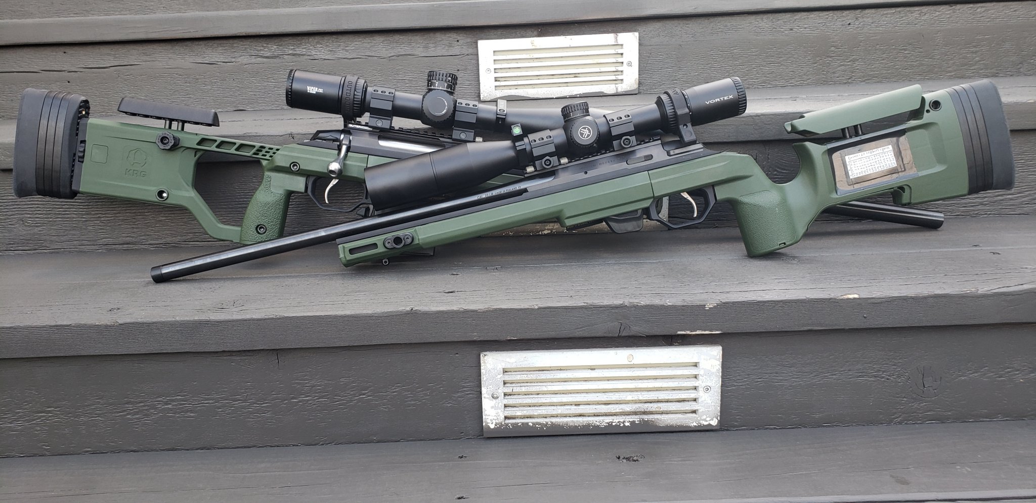

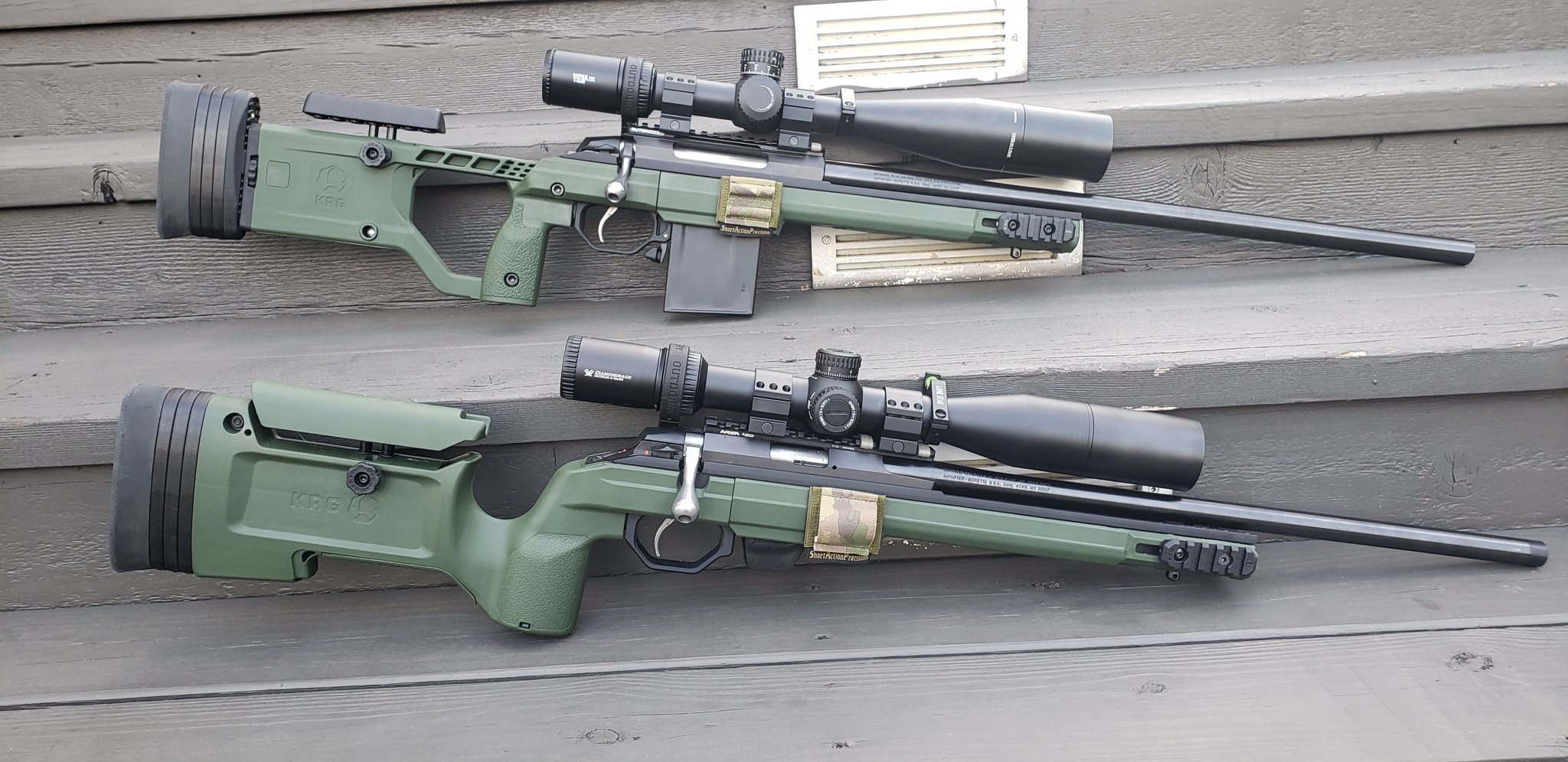

The more I look at this the more I like.
So to confirm, thats a Bravo rear end and a Whisky Polymer forend?
What would that setup weigh (minus the action) - compared to Whiskey (3.8lbs) and for the Xray (3lbs) ..?
Yep, it has Bravo rear end and Whiskey forend.
I have not scaled it, i could do it one day.
I have also Bravo stock that has original Bravo forend.

I realise I'm drilling you with questions here - but is the whiskey forend swap a simple one? I see a bolt on the front of the Bravo buttstock, above the trigger - in front of the bolt recess - did you have to drill that out to make the whiskey forend fit?
The Whiskey 3 forend and back ends should just screw right into a Bravo and vie versa. They share the same backbone. W3 forend is nicer for shooting off surfaces due to the width. Bravo is narrower, but more comfortable to hold (for my stumpy fingers anyway). That screw/bolt on his rifle looks like a personal mod.

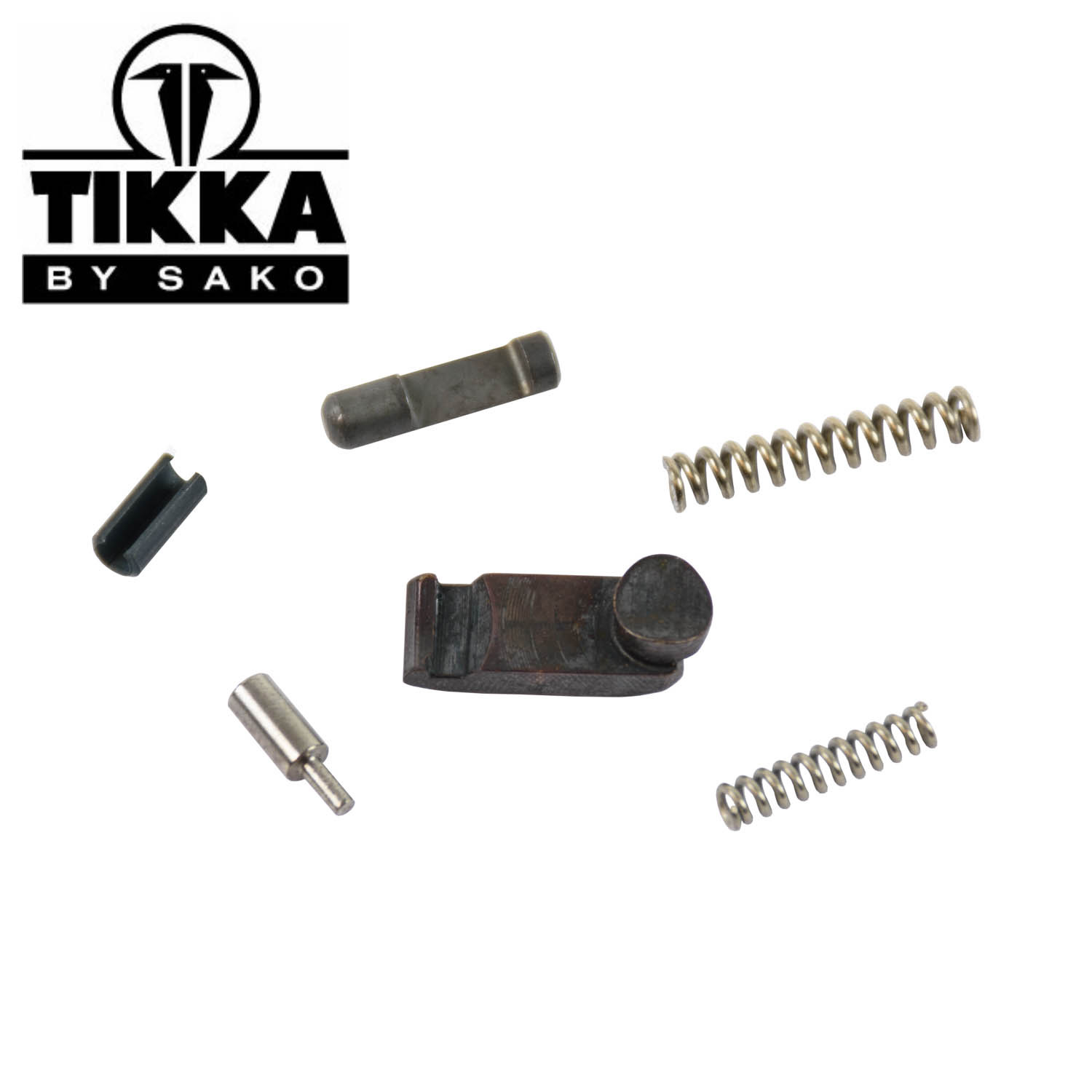

These guys used to sell just the spring but discontinued it.
Now they sell the kits....
I think Sako/Tikka/Beretta only offers it in this kit. Its worth it to buy the kit and just replace everything every so often. I did this to my Tikka last year after probably 4,000 rounds.

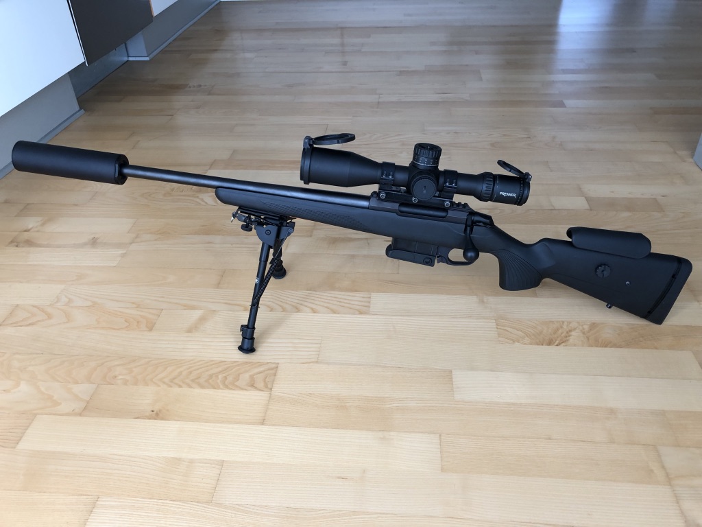

Very, very nice.. What is each one and how do you use them? Crazy levels of envy here...
Left CTR 223rem with Bravo.
Midle CTR 260rem with Whiskey, these 2 are factory barrels.
Right T3X with Krieger SS barrel 6.5 creedmoor and it´s on a Whiskey chassis.
Audere mounts, Vortex scopes.
All barrels are fluted by Ensio Firearms, that is a 2 man owned gun smith company here in Finland.
And all are M05 camo pattern cerakoted by Ceramet.
Jaki Titanium series suppressors.
Coletac covers, that small black one is having jacket too :)

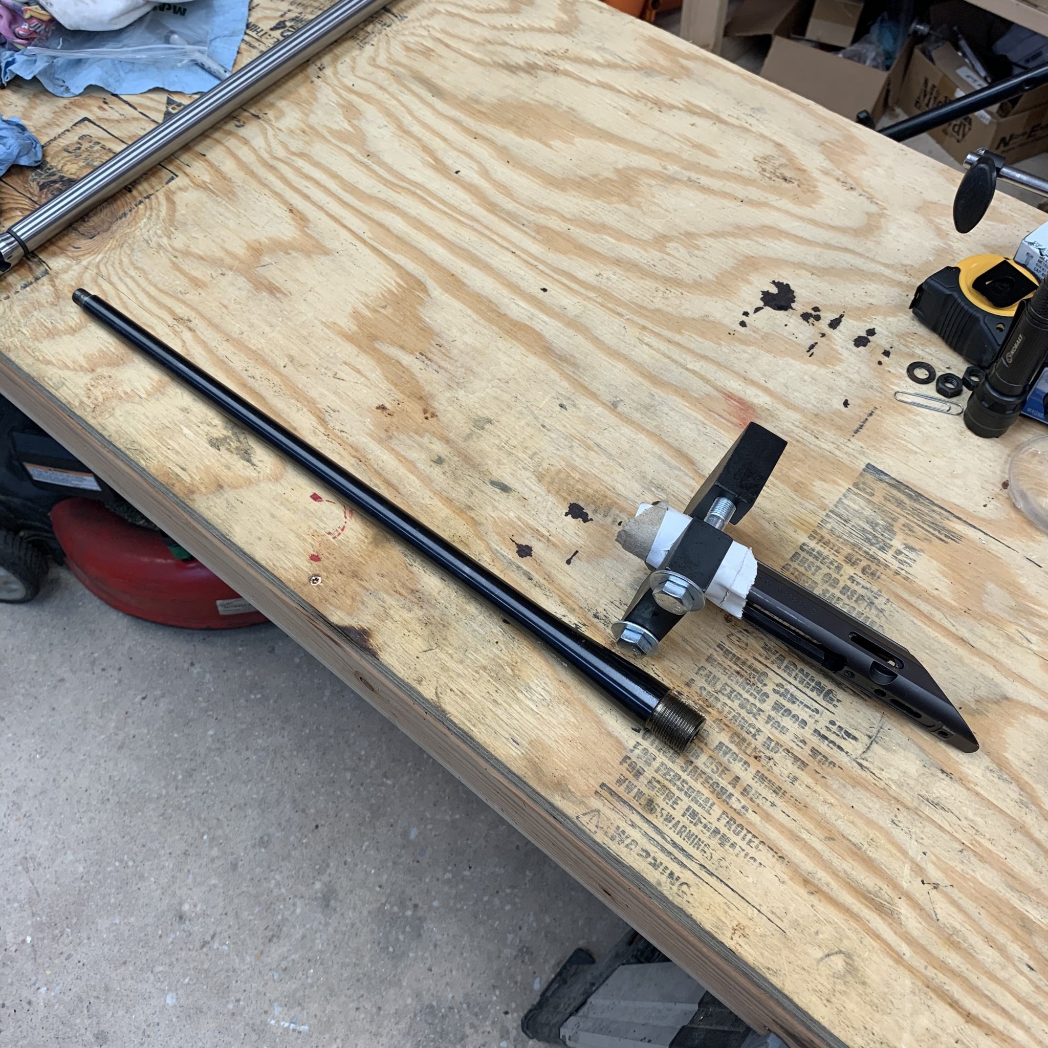

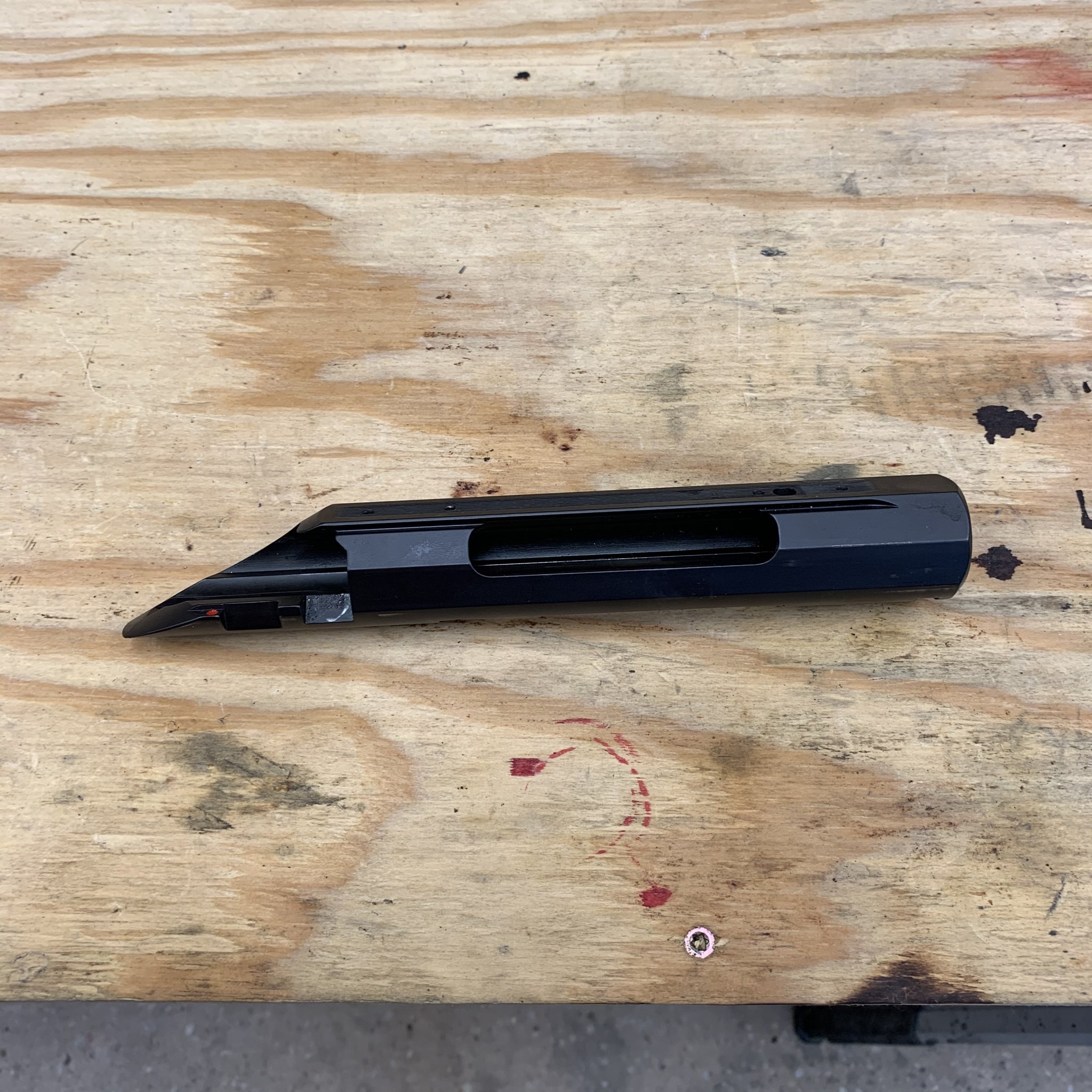

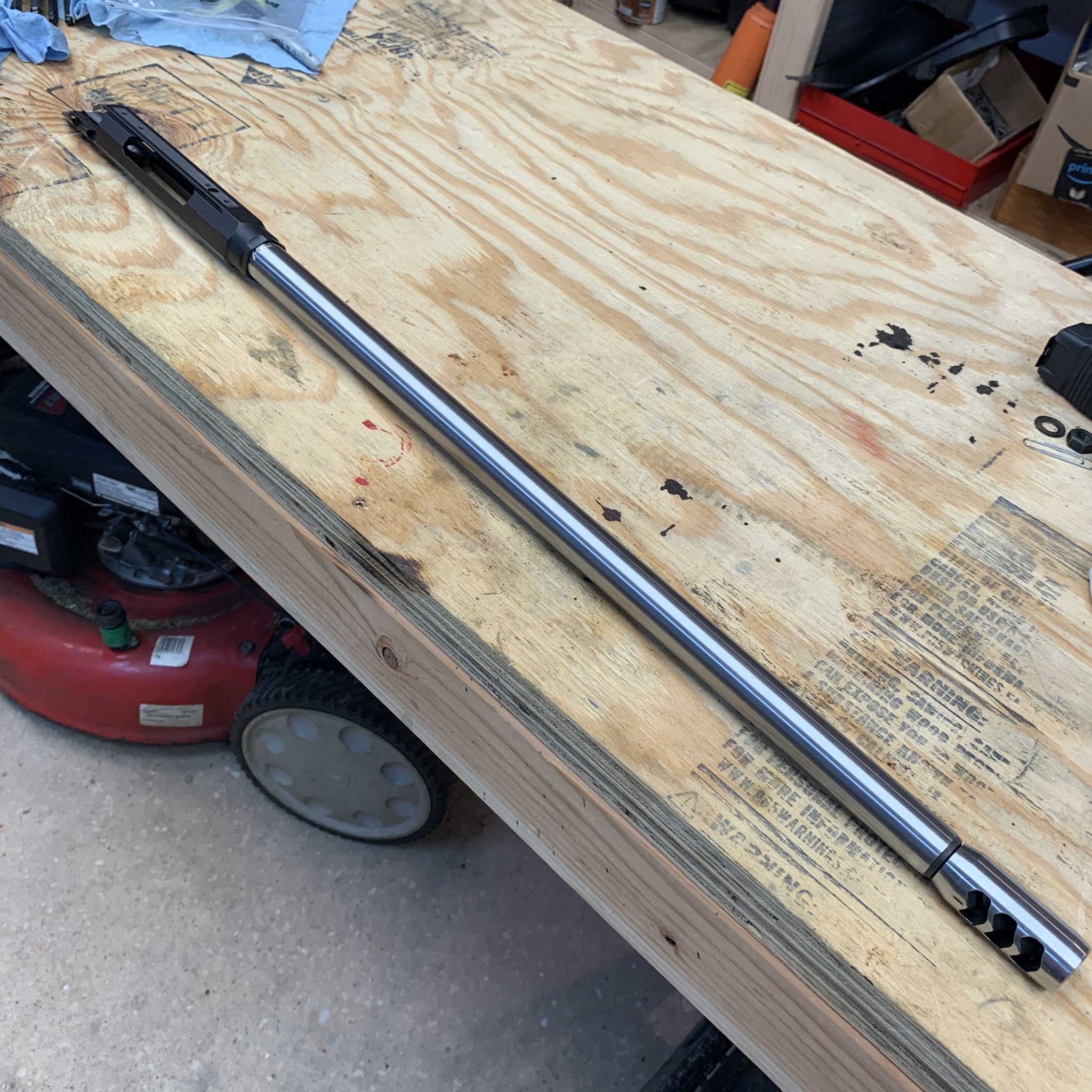

The barrel on my T3 .223 Rem was installed by King Kong. I used Kroil, heat, a 2 foot cheater pipe and a 3 lbs dead blow hammer finally knocked it looseView attachment 7388275View attachment 7388276View attachment 7388277View attachment 7388278.
Its strange how some like yours are so tight. I wonder why the difference? All the tikkas that I have rebarelled took a whack with the palm of my hand on the action wrench. No heat. No oil. No cheater. My sako TRGs were just as simple.
