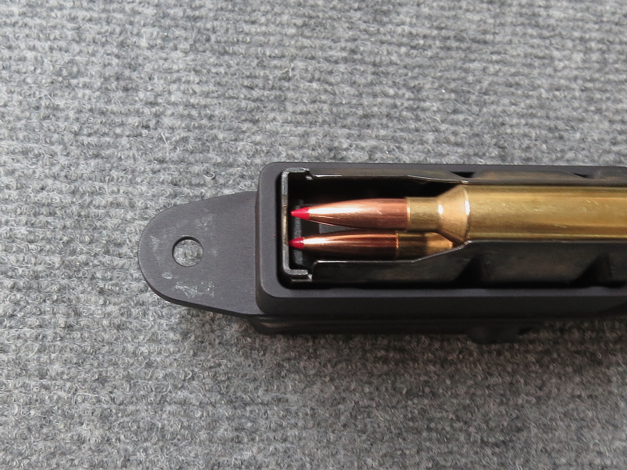

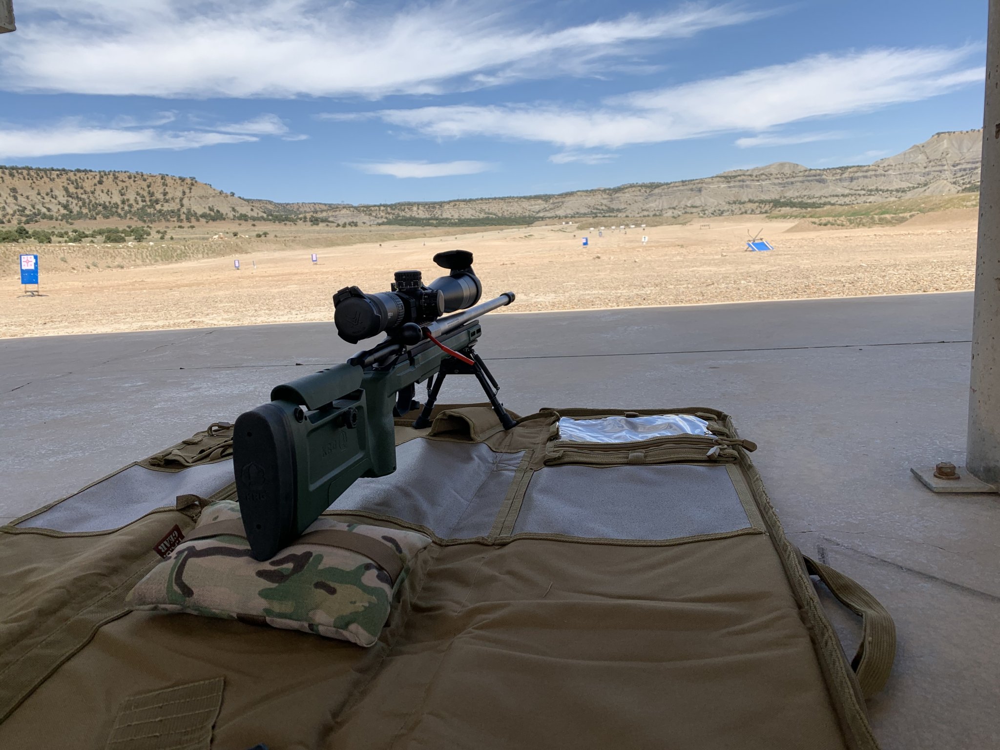

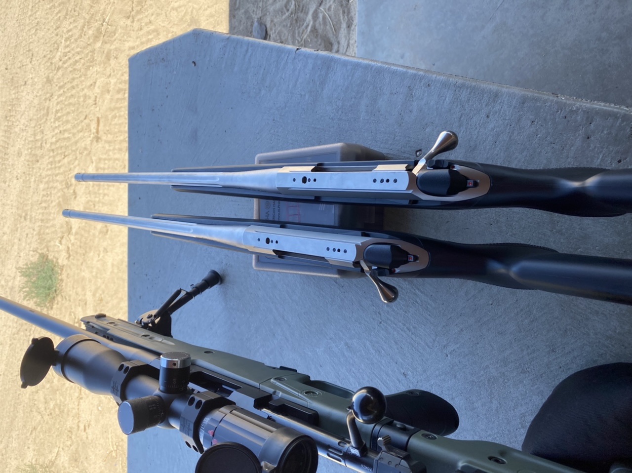

Took my Tikka to LRSU over the weekend.
My MDT polymer AICS mag didn’t work worth a damn. Had to single feed every round.

Did your rounds hit the feedramp? I found mine will sometimes do that as the mag will rock back in forth sometimes. I am thinking of adding a piece of plastic to the mag to keep it a bit snugger since there is not alot of adjustment to the Bravo in that regard. I could always sand a bit off the back end of the foreend piece to allow that adjustment.
The bolt doesn’t always pick up the next round, like the mag sits too low. When it does grab a round, it tries to feed at too steep an angle; bullet nosed too high.

In my experience Tikkas do feed best from Tikka mags. That's why I ultimately moved my T3 .223 to a McM A3 inlet for the factory bottom metal. Back to that buttery-smooth, "did I even pick-up a round on that last cycle...?" Tikka feel... ;)

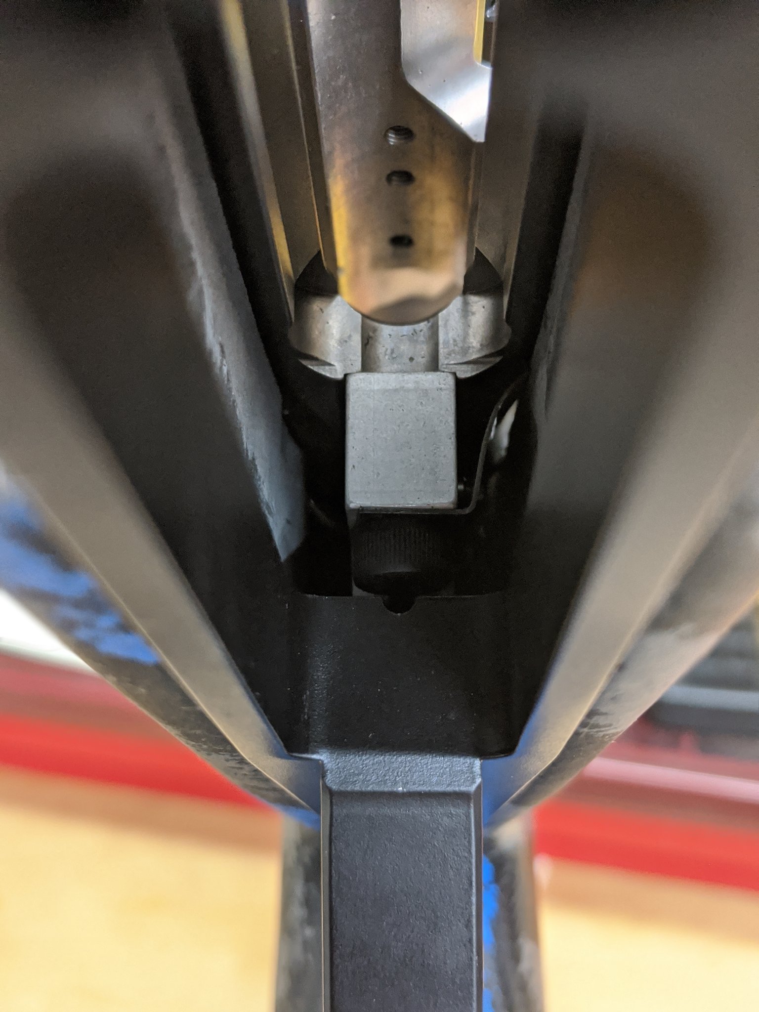

My 7SUAM that I just got done won't feed anything all the sudden from the factory mag. I even put it back into the factory stock, factory bottom metal and it still won't pickup a round. The magazine sags in the bottom metal so bad and I have no idea why.

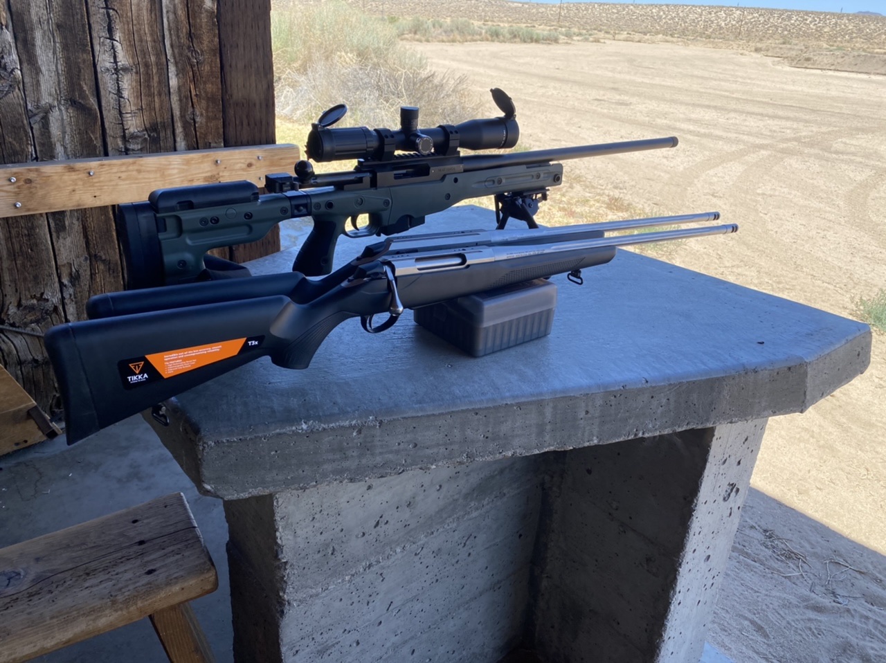

T3x 6.5 Creedmoor Super Light
Hi-Tec Carbon Stock (integral block & flush cups left side)
Atlasworxs Bottom Metal
MDT Magazine
Sterk Shroud
Velocity Trigger Spring
Greystone Guns 3K Suppressor
Just waiting to install the Stryker HD into Badger rings on the MDT 20 MOA pinned rail.

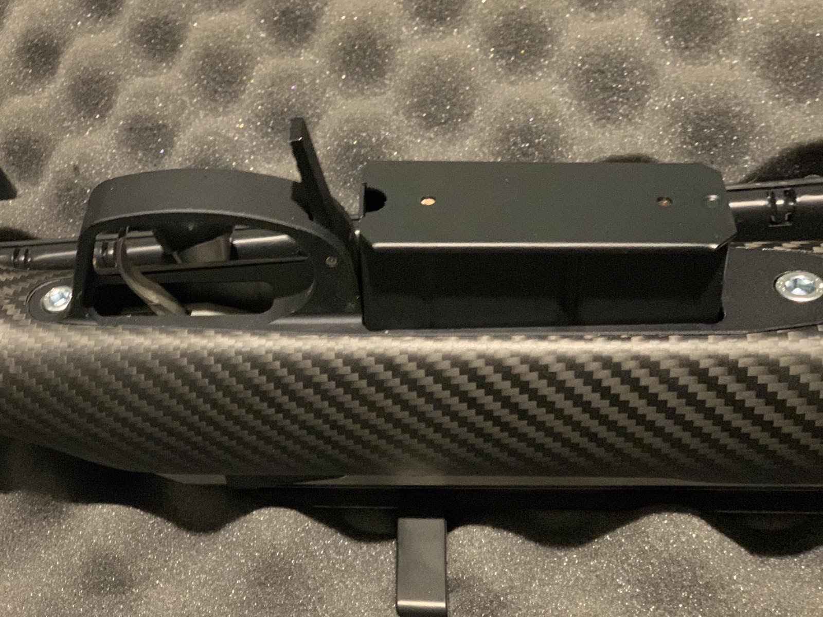

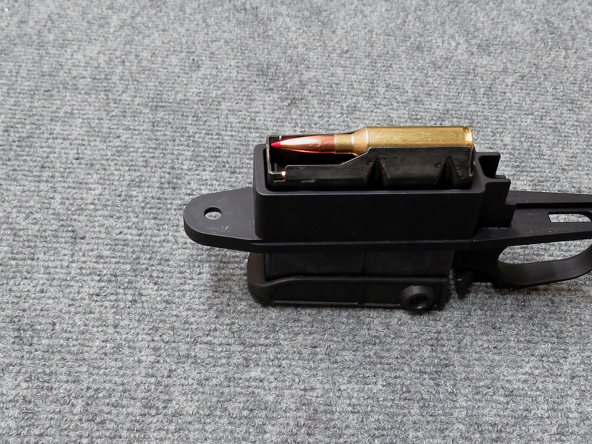

If you're not already aware: the trigger guard assembly forms the rear of the mag well. It is adjustable fore and aft to move the mag relative to the action. Once you have that where you want it you can set the forend, which forms the front and sides of the mag well opening.
(y) im aware as i too have an xray and the adjustments needed if it ever gets pulled apart for cleaning. so could we put this down to user error perhaps?
Do you still have the magazine tension spring installed on the trigger mounting bolt?
Reactions: JGR1953

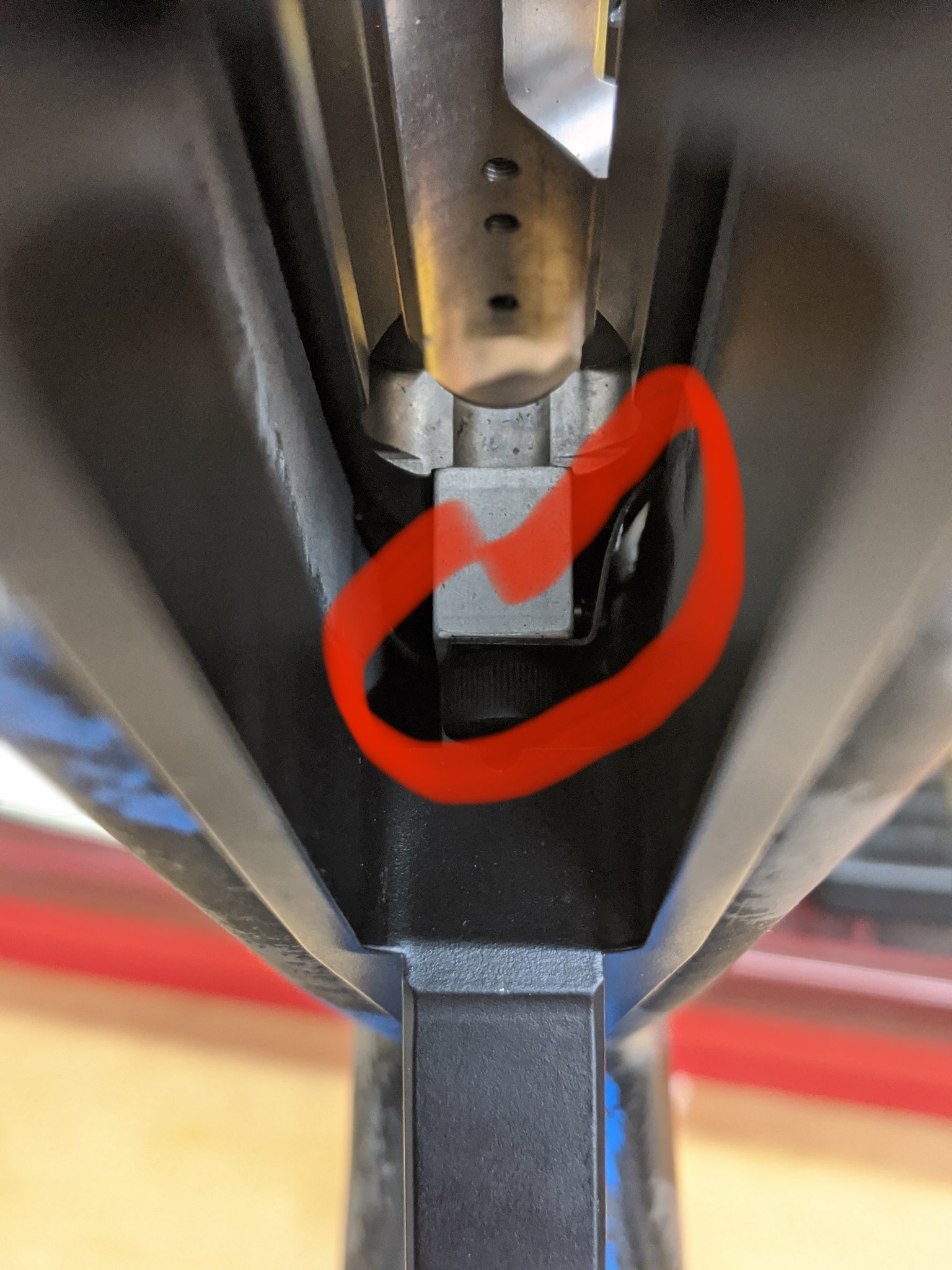

I circled it. Loosen the trigger retaining bolt and spin it counterclockwise 1/4 turn so the leaf spring would be visible if looking into the magwell just as you are in the photo and that should fix you up
Reactions: 260284
Ahhhhhh ok, for some reason I was expecting to see a small spring of some sorts. Haha my bad.
Although I think it's garbage the smith didn't make sure all this was in working condition.
Reactions: 260284 and wade2big
If your using that action in a stock/chassis that uses CTR or AICS magazines that spring has to be removed.
It's only for the original style bdm and magazines that came in the T3/T3x and their clones.
The metal CTR mags and or the AICS mags that are used in other bdm's and chassis stocks does not use that retainer .

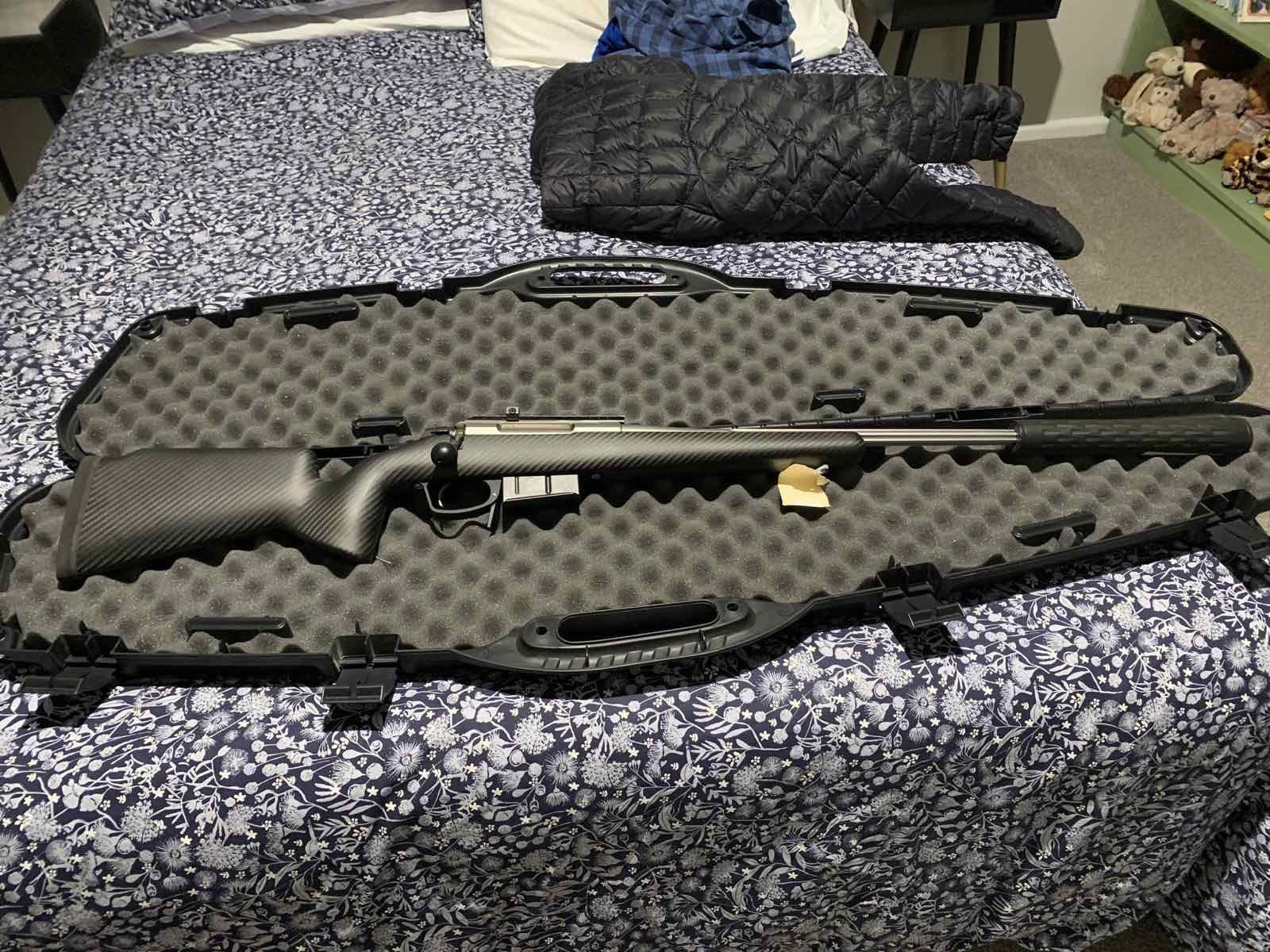

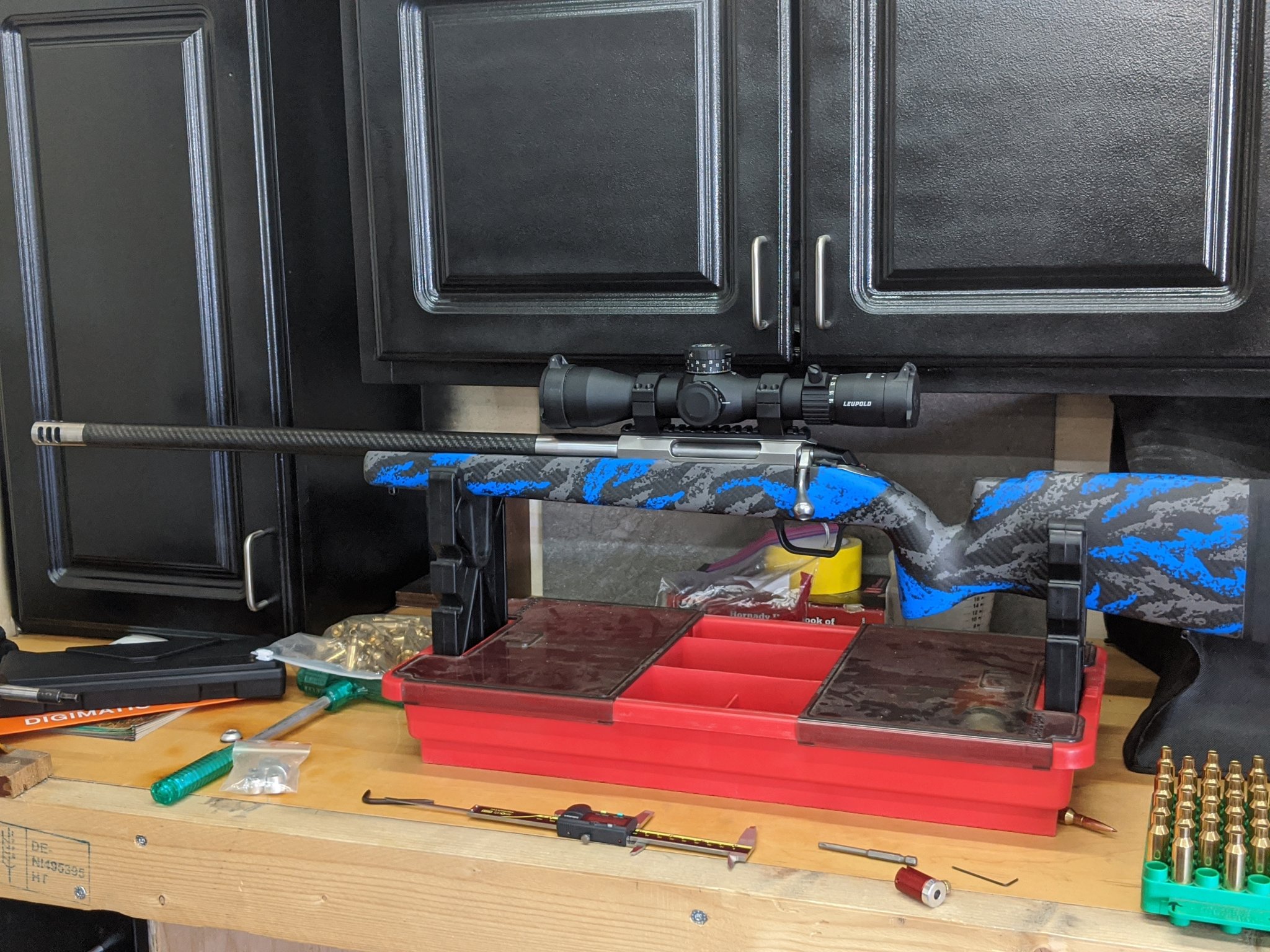

Finally broke down and bought a Bartlein carbon fiber blank and it just got dropped off at the gunsmith. Getting it back next week and will post some pics. And then running it through its paces on August 4th.
Gonna be a killer build:
- Tikka ctr 6.5cm
- 26" Bartlein carbon fiber barrel (m24/m40 contour)
- mini bastard muzzle brake
- Manners prs1tk (opened up for new barrel) with gen2 mini chassis
- razor gen2 in a sphur mount
- area 419 arca rail

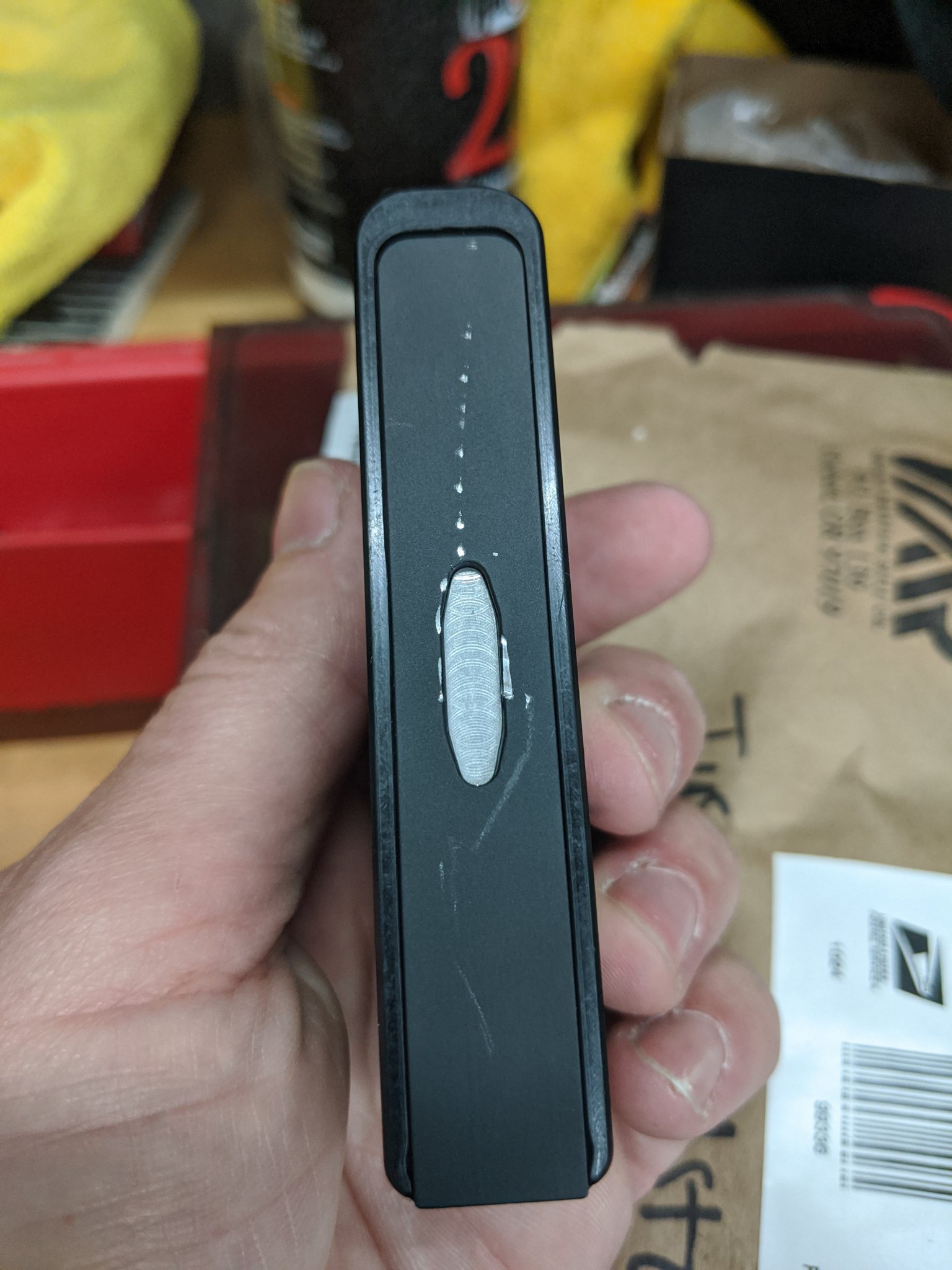

Mag was in the mail, took it out and it's got scrapes all over the bottom.
It also doesn't work,

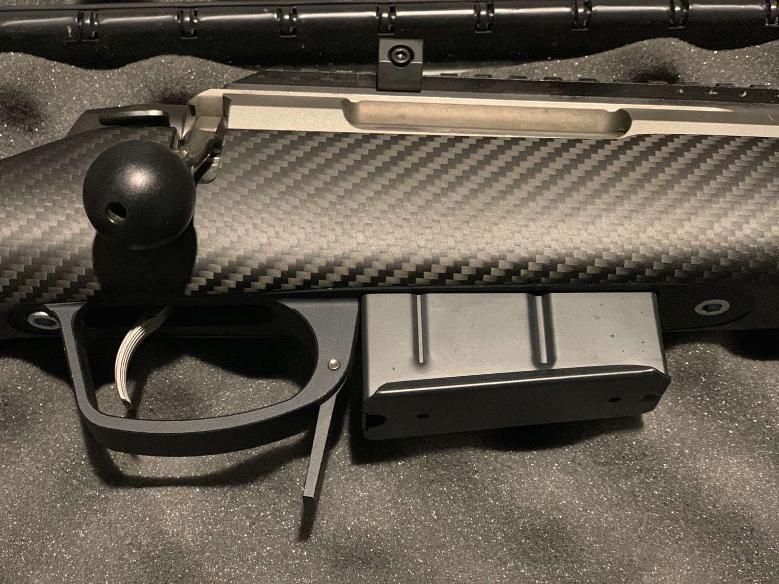

Got my mag from the smith today. No dummy rounds. (Go figure) It's scratched all to shit. Icing on the cake the mag doesn't fit regardless of what bottom metal is used as it hits the bottom of the action before it even clicks in.

Have you tried your plastic mags after lining up the magazine retainer clip yet ?

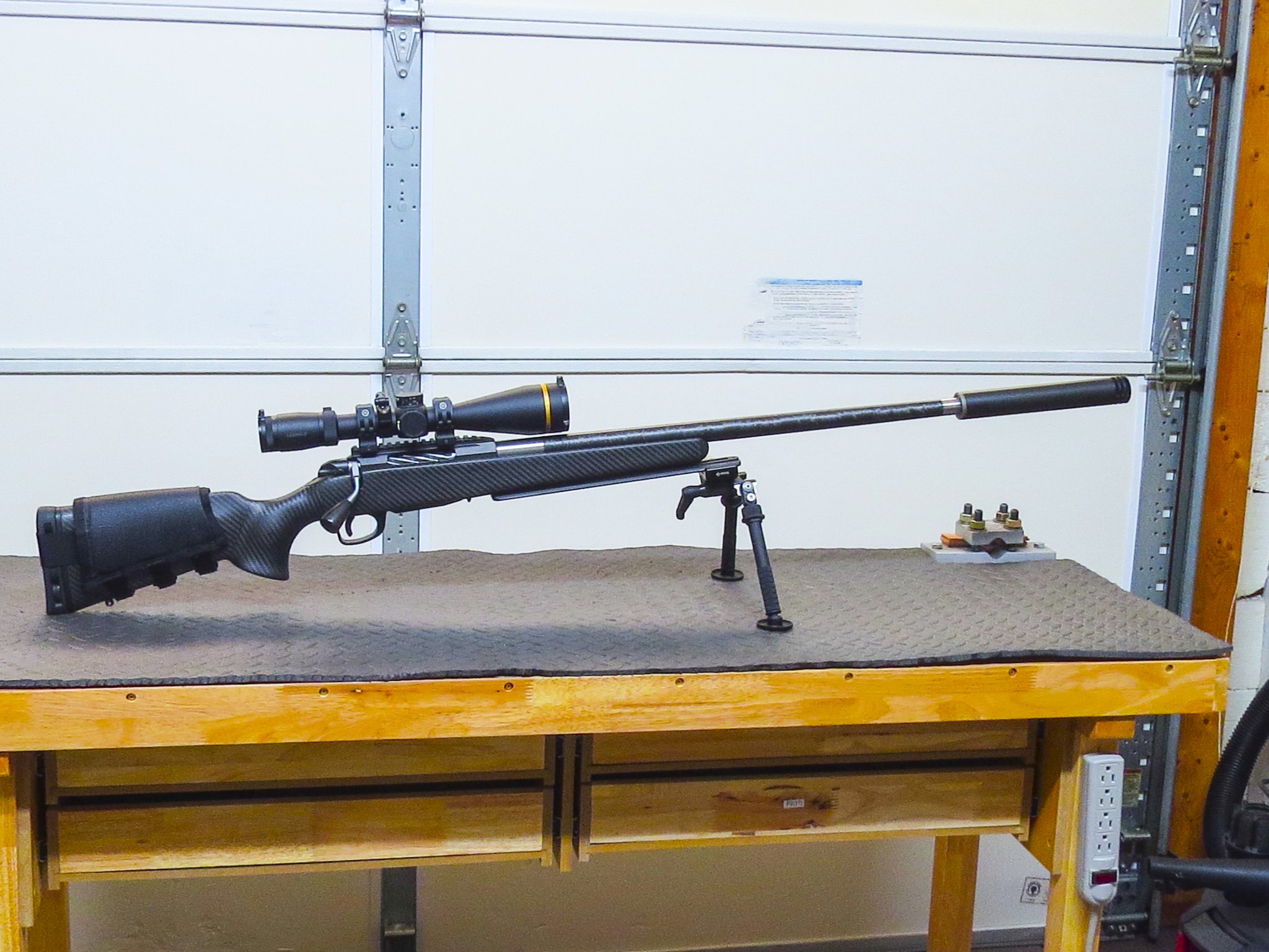

How do you find your German gun stocks? What size tapper barrel is on the rifle in the back ground? I’m thinking of ordering a raptor for my custom tikka build, I’m running a straight tapper Lilja barrel but not shore if it will fit the raptor barrel channel
I have a GGS Ranger. Love it. Was torn between the Predator and the Ranger but decided to go light (about 1 lb heavier than factory CTR stock.)
There are great stock options out there these days. I chose GGS for its drop-in-and-done design specific to Tikka T3x or T1x. No tweaking. No smithing. Just bolt straight in to the aluminum bed block and you’re done. Very ergo and rigid. Reminds me a bit of Sako TRG. They include a custom paint/camo job. Also, if shipping to the US, the price will be LESS than list price (due to removing EU VAT taxes).
Factors that some might not like:
Stock material is a birch cross laminate with epoxy. Then painted over.
No integrated mlok/keymod/dovetail system.
Took about 1.5 months for mine to arrive, order to door.
Uses a GRS-style adjustable cheek rest. Allows for rapid and very fine adjustments, but potentially less rugged than other designs.
Overall, it fit my needs perfectly.
