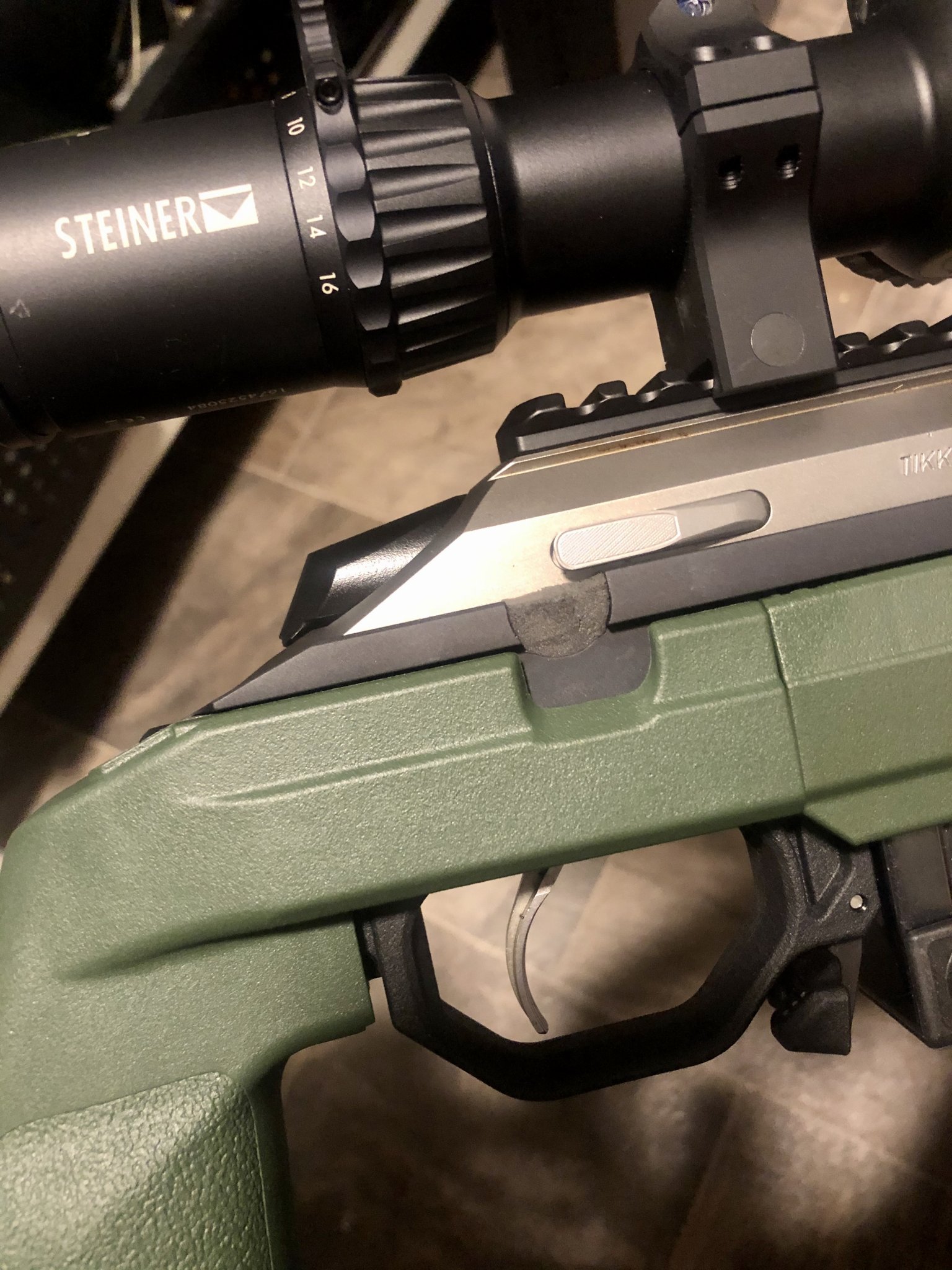

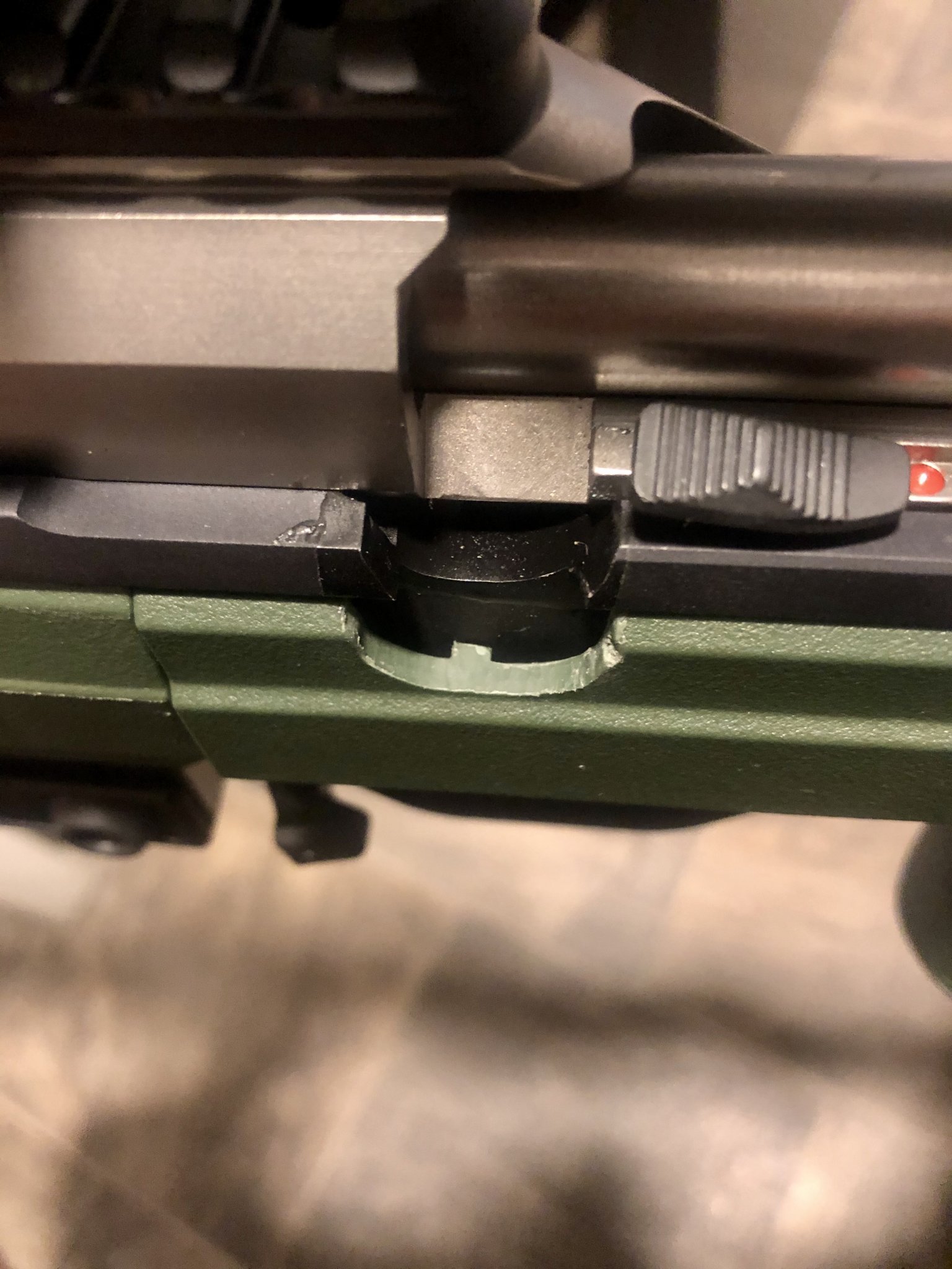

Has anyone changed their TAC A1 chassis out for a Bravo? I have another rifle in a Bravo and find it more natural and comfortable than the Tikka chassis. Is there any market for the Tikka chassis if I replace it.

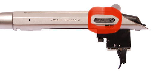

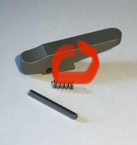

Take out your bolt stop and file the bolt stop a little bit more so the bolt can come back further which would allow it to pick up the cartridges. The ctr bolt stops allow the bolt to travel rear words a little more than the T3 lites. It would take only a couple minutes.
So first time out after doing this, no kaboom. Only very faint primer strikes. I didn't take away tons of the bolt stop material. Barreled action had been firing just fine before. Didn't mess with the barrel or the bolt. 140gr American Gunner.
Any troubleshooting tips?
Im no gunsmith but I dont see the cause as linked. Not saying something isnt wrong, but if I understand it right the bolt stop only functions to interact with the rifle what the bolt is fully rearward. It shouldnt affect the chambered round with the bolt engaged with it. Am I nuts? Wait...dont answer that last part
A bolt stop (release) would not cause that issue as it has nothing to do with the firing sequence. . Completely unrelated. Not closing the bolt all the way down against the action when chambering a round, or a dirty firing pin could cause it. The pin needs to be free of grease and oil. Check that.

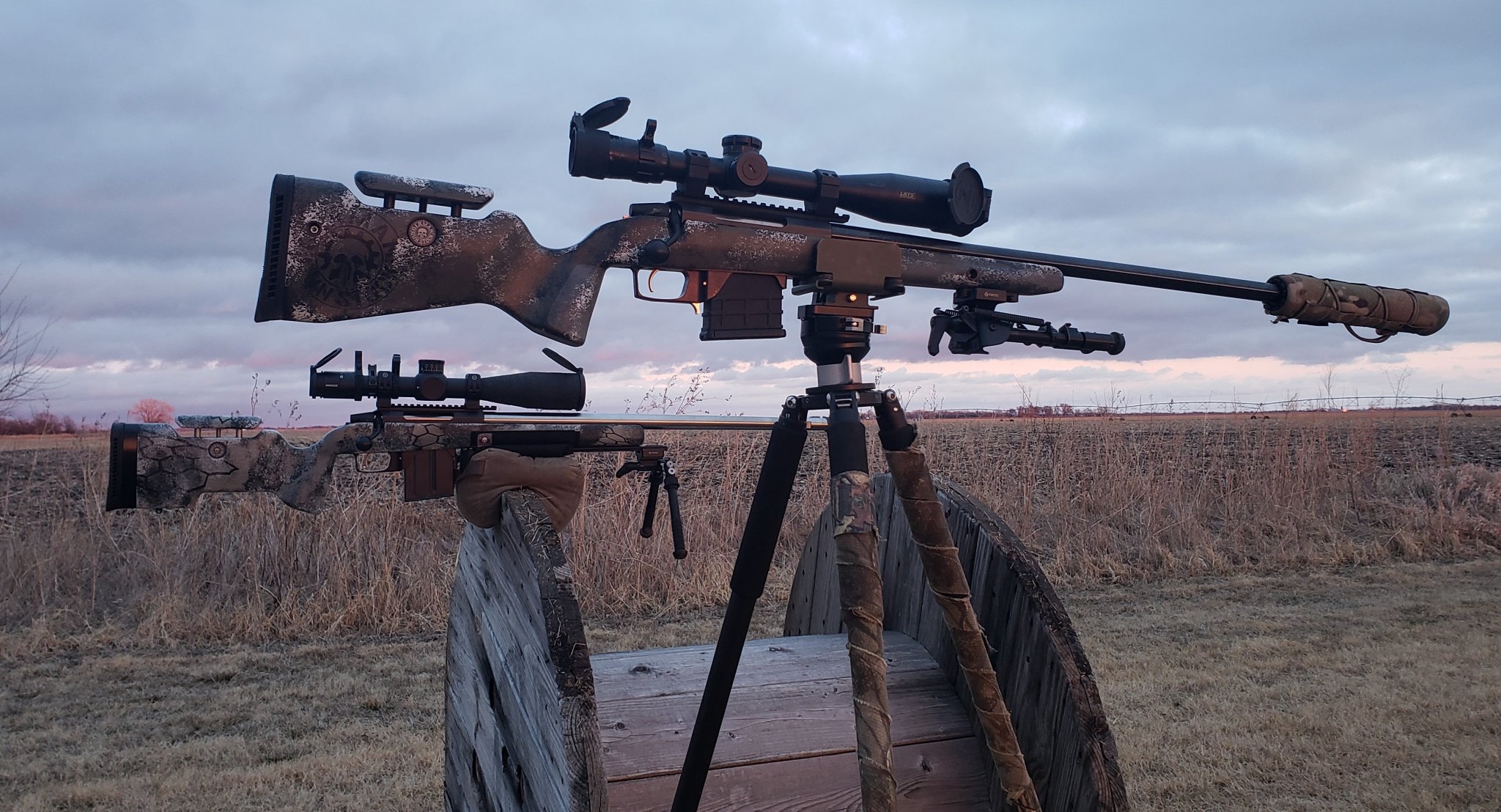

How do you find your German gun stocks? What size tapper barrel is on the rifle in the back ground? I’m thinking of ordering a raptor for my custom tikka build, I’m running a straight tapper Lilja barrel but not shore if it will fit the raptor barrel channel
The barrel on the rifle in the Raptor is a light varmint that has been profiled to match the Tikka receiver. I had to open up the barrel channel to get the clearance that I needed. Heavy palma is about the limit for a German Gun Stock without doing any work to it. They might be able to build one with a larger channel, but I have not asked.
I really like them for hunting, but I like a heavier rifle, 20+ lbs, for matches. I am eyeing the MDT ACC.

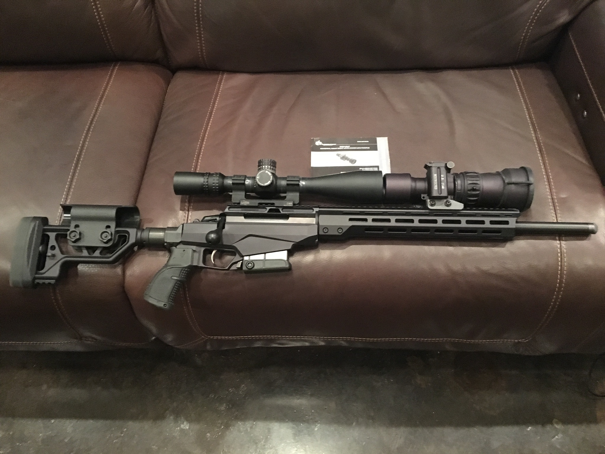

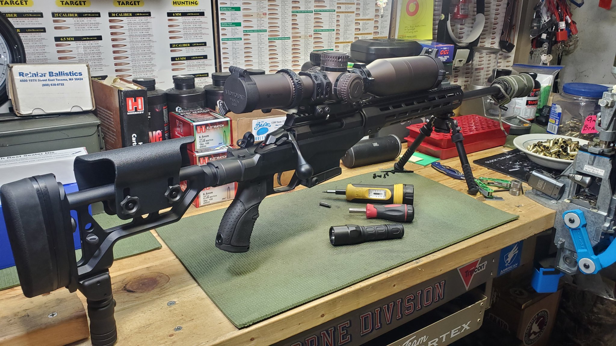

I got really lucky and scored a T3x TAC A1 with good glass from EuroOptics. That factory chassis is really a nice piece. I also have a KRG Bravo for my T1X rimfire and it is also a great chassis. I don't think you can go wrong with a KRG. Just my opinion. Lots of choices out there...

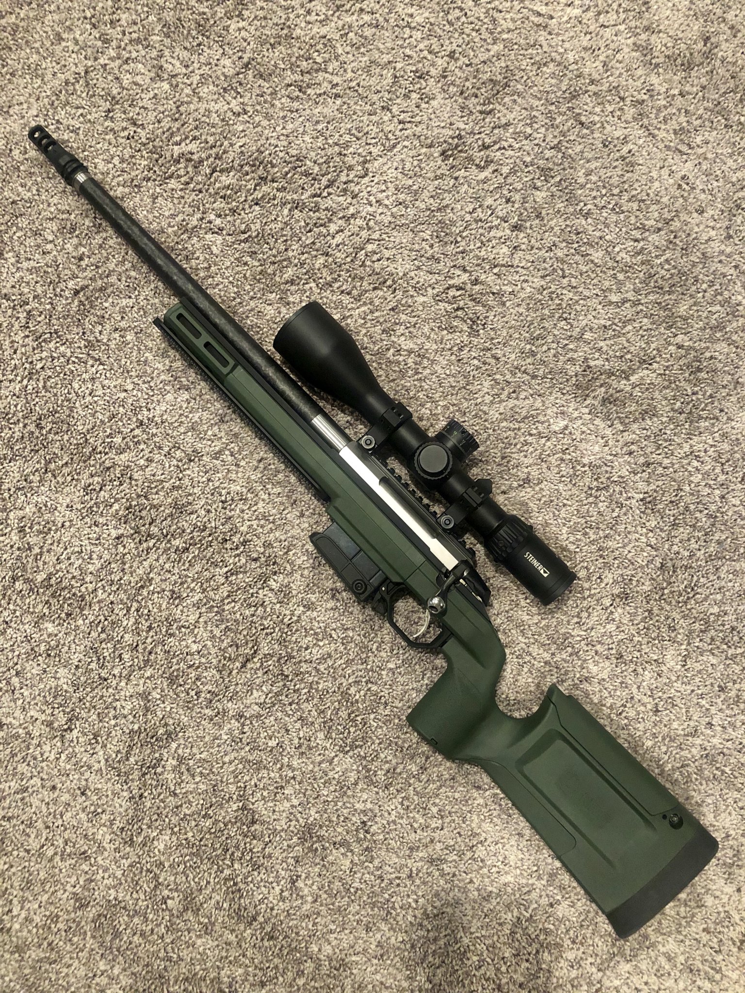

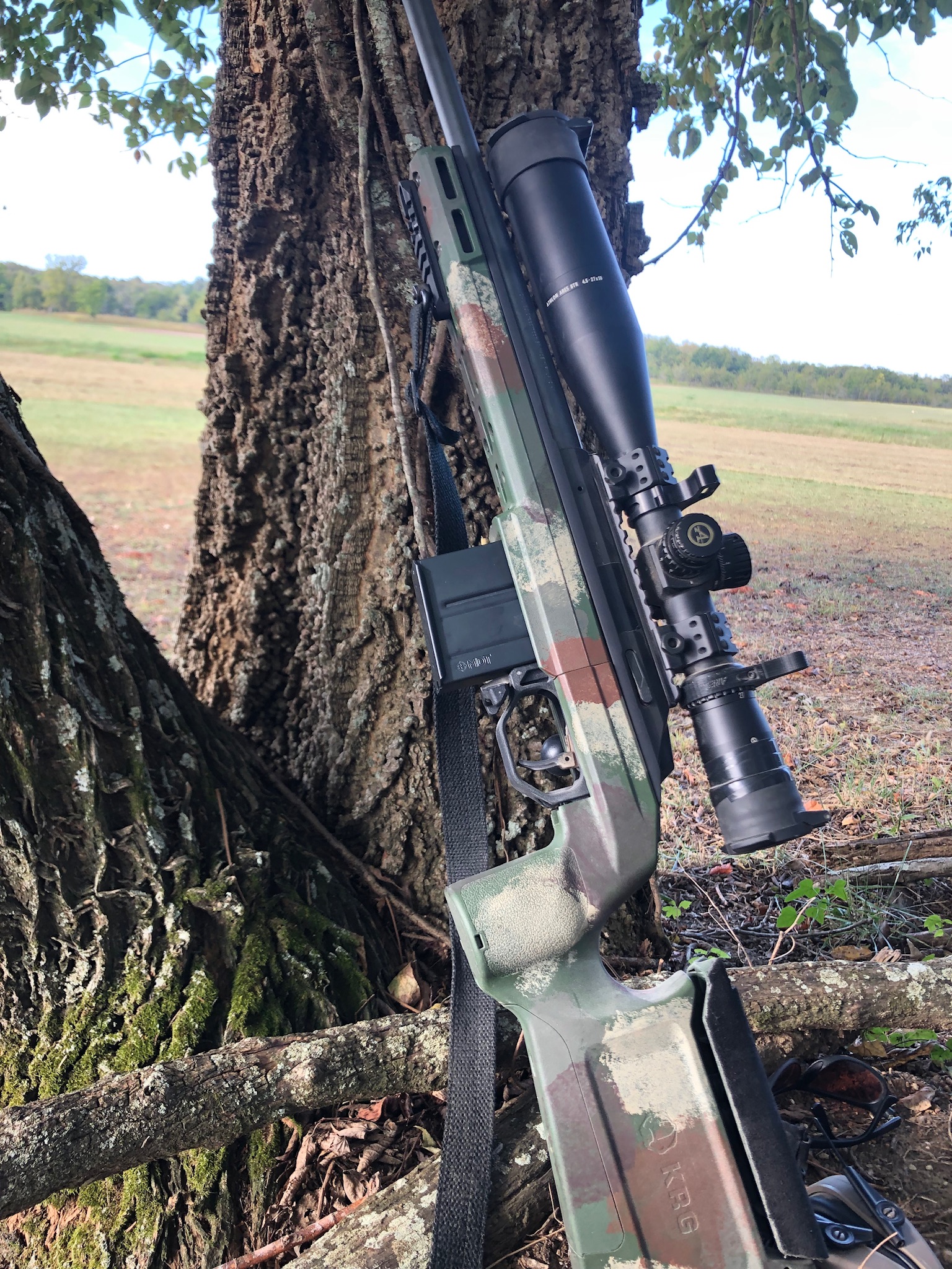

My shorty Tikka T3 got a chassis makeover. Took it out of the Grayboe Terrain in favor for a KRG Bravo with CTR inlet. Just need to source an MLOK QD sling mount for up front and it’s good to go. Put Area 419 Arcalock rail on the bottom to share the bipod and rail changer bag previously shown on my Tac A1.
Converting the Bravo for LH use wasn’t that bad. I cut the backbone and the polymer with an endmill and then blacked it out with Brownells Alumhyde. The hole on the opposite side of the action was a little more perplexing though. I ended up fitting a small piece of black dense foam (from my A419 packaging) into the void and held it in place inside with a small strip of gorilla tape. The pressure of the action bolted in also helps keep it in place. I was thinking trying to mold something out like clay or epoxy or something, but I dunno. This works for now.
I’m really digging the Bravo so far though.

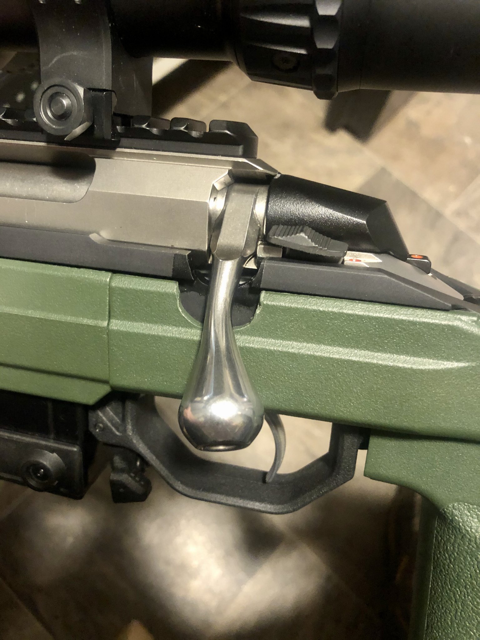

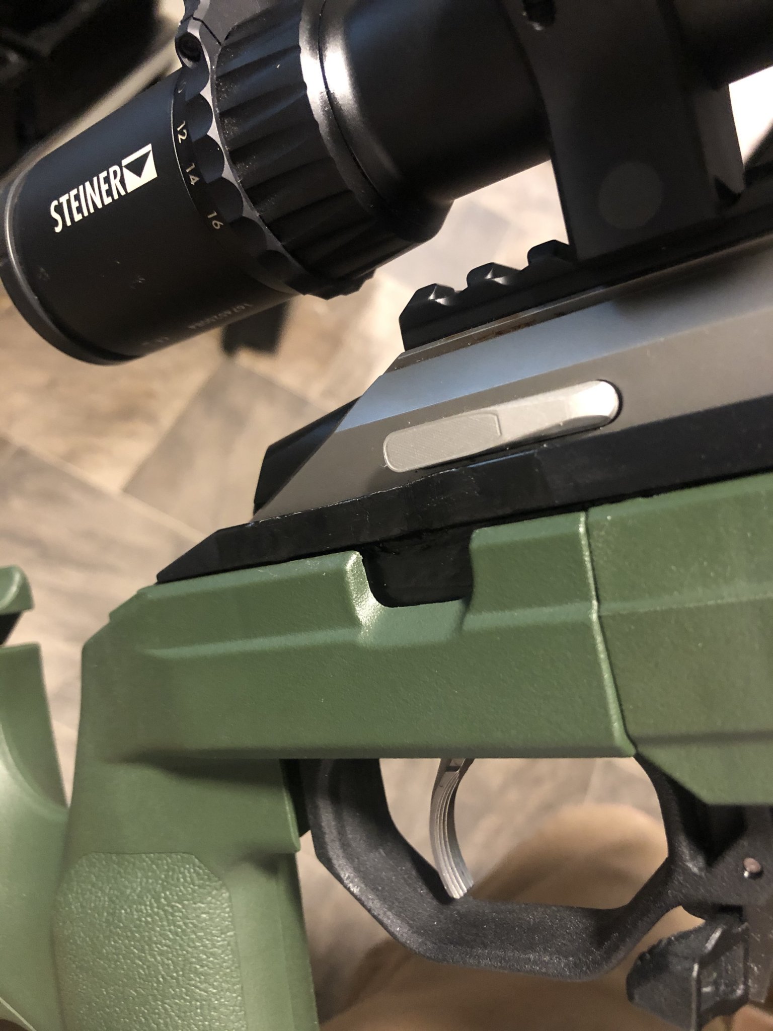

I couldn’t let it go with the foam solution on my LH Bravo. I built it up with Bondo, shaped/smoothed it, then after it was dry hit it with the Brownells Alum Hyde again. A much more solid, lasting solution.
Now I’m satisfied. A professional could have probably made it look better, but for being able to do the whole conversion at home with no wait or cost, it works for me.
