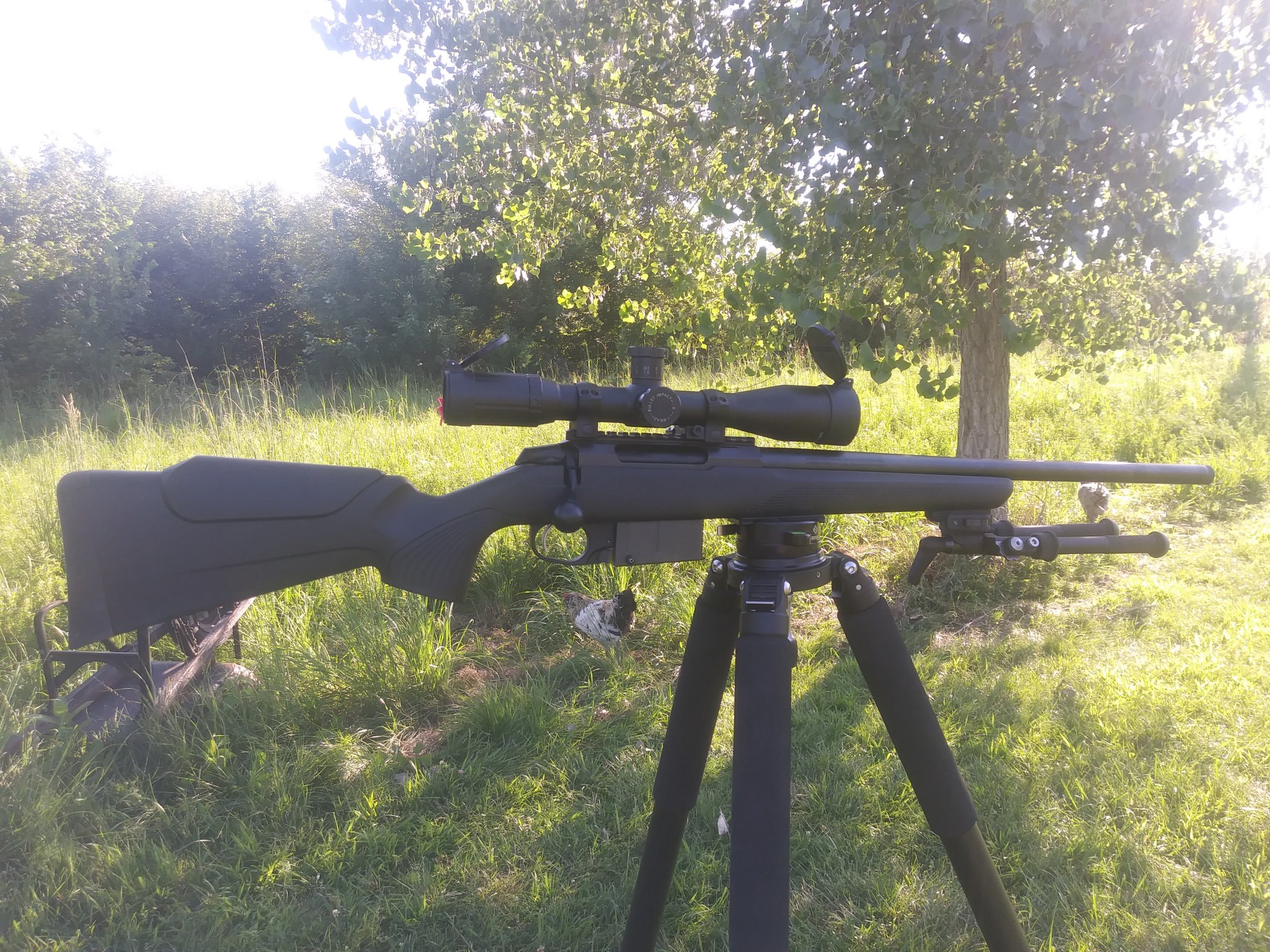

This is my deer hunting rig. Tikka ctr 6.5 cm 20 inch.

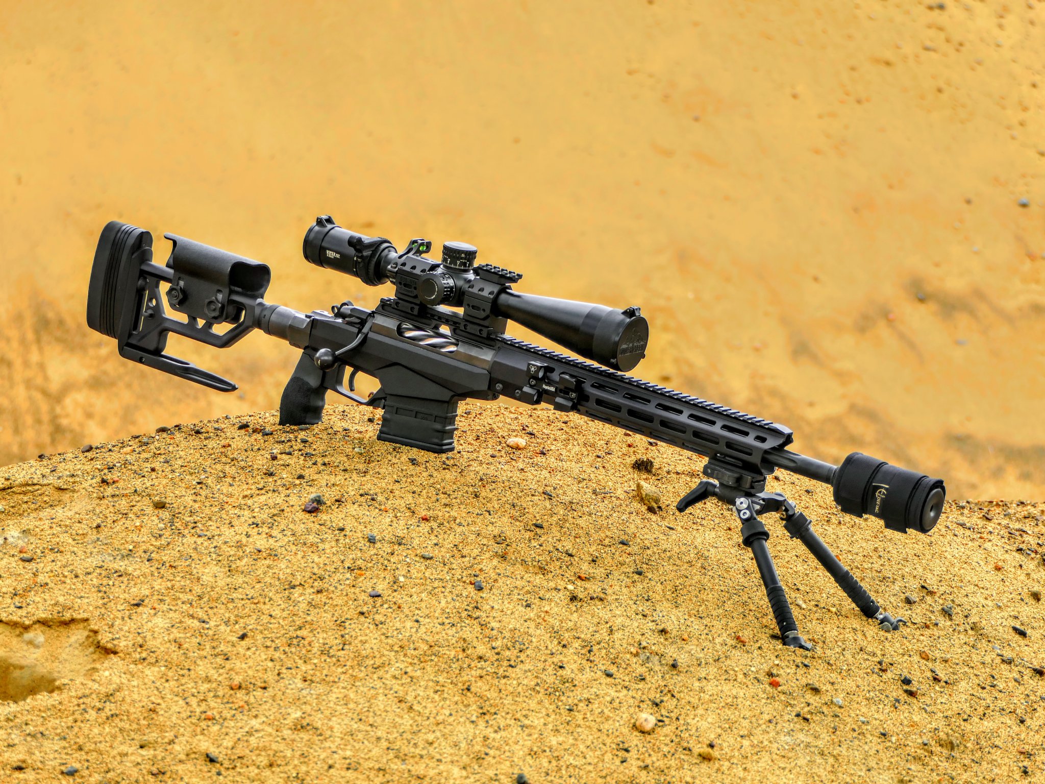

TAC A1 super short, well not that short, but shorter than it was, when it left the factory gates last year :D

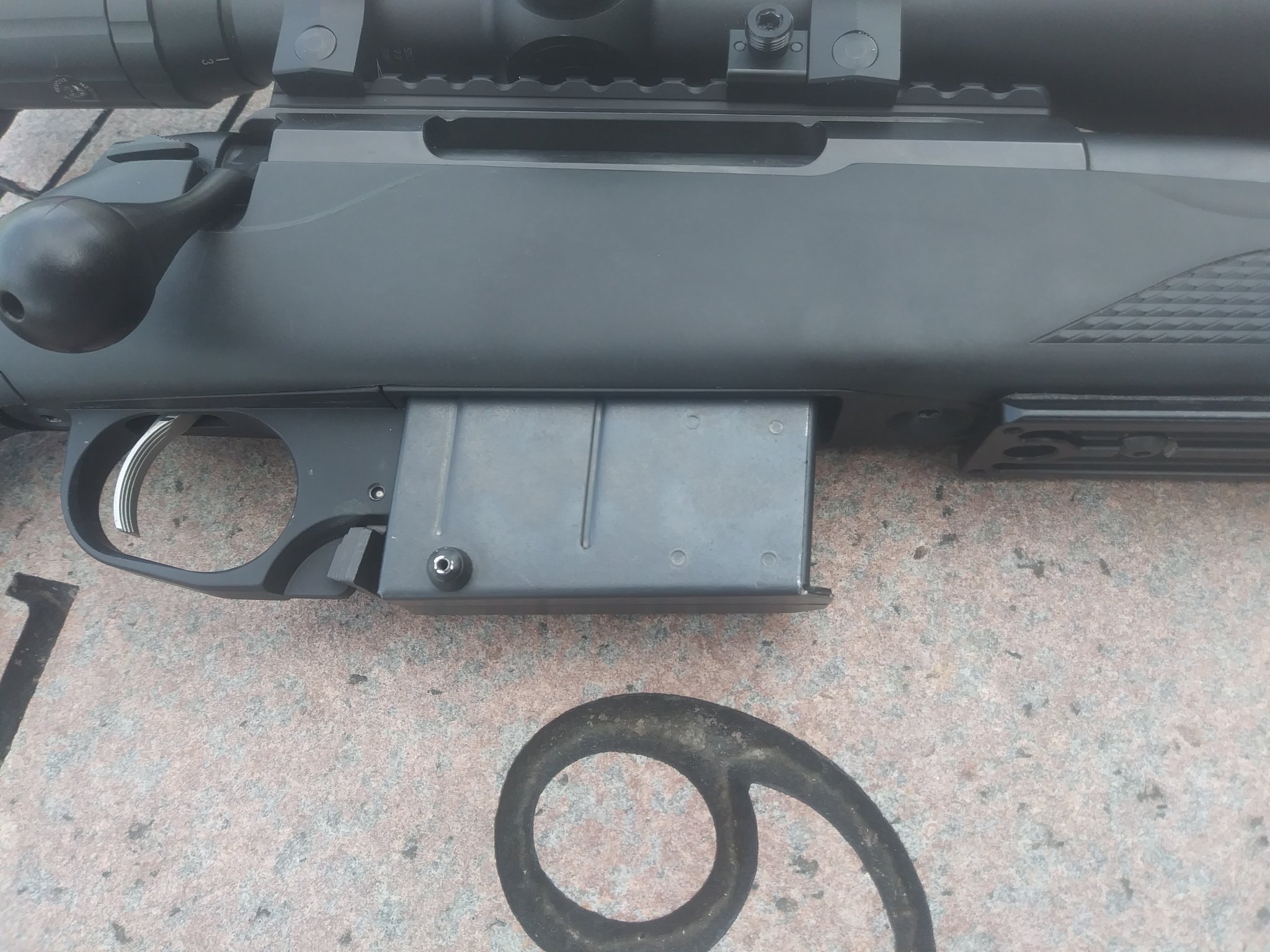

Bought this chassis yesterday.
It´s funny, i bought this rifle in TAC A1, i sold that chassis, and now i have this same type of chassis on these same frames.
Will not leave it like this, since this 223rem is my son rifle.

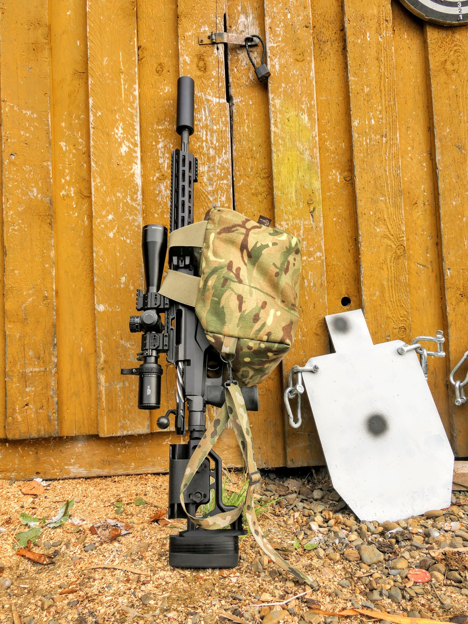

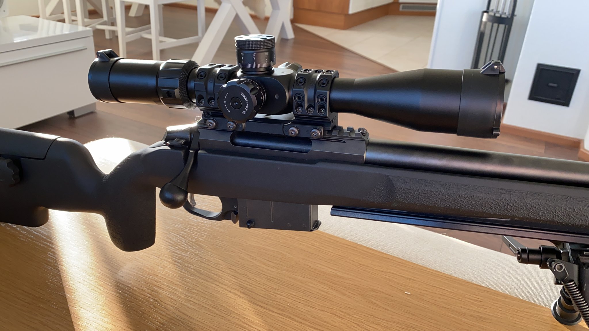

Now my CTR is quite ready! It got a nice Spuhr mount. It will have better scope someday and I need to replace picatinny rail with the 20moa rail from UPR.

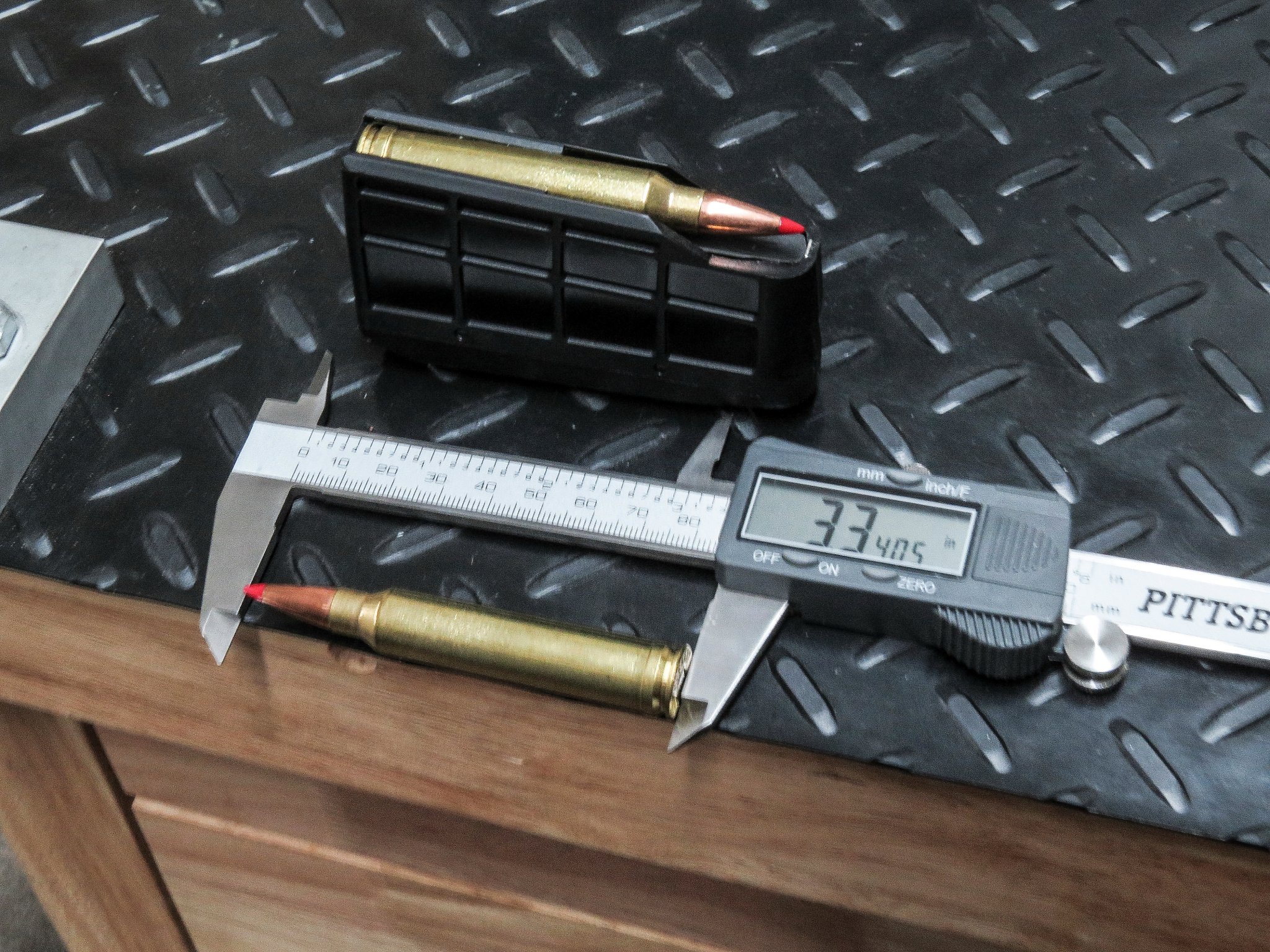

I have a question. I'm looking down the road to build a magnum hunting rifle. 22" 7mm mag or some such. I'd like to use a Tikka T3 or T3x for the action with a Proof CF barrel or maybe just a light weight stainless barrel. What's got me duped is stock and bottom metal options for the L/A cartridges.
How does the long action bottom metal on these "work"? Factory mags? AICS? plastic or aluminum factory or aftermarket bottom metal? Such a thing as a blind magazine (M700 ADL equivalent)?

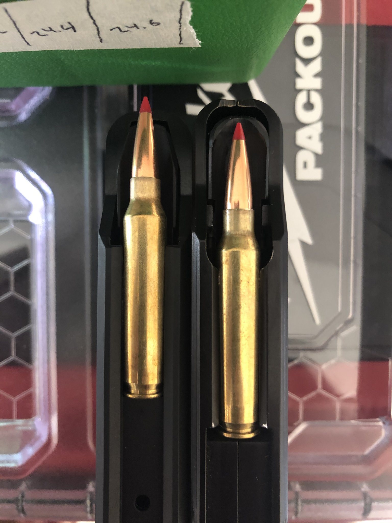

Cartridge OAL is limited.
I'm thinking a manners EH variant for the stock. Thanks for any insight. I've always appreciated the Tikkas just never got one or dug too deep into them.
Im researching the same thing right now. Im planning to build a 7 saum though, so I am anticipating being happy with the mid length action of the Tikka. From what Ive learned so far, if you are looking to do a detachable bottom metal with longer magazines there are options but you will need a dremel and a rasp and go to town on your action. Much fewer options compared to rem700 actions. In my mind the aftermarket kits for extending the coal capacity of the action makes it difficult to be attractive for hunting, but competitions might be ok.
What's the COAL limit? I'm looking for 3.340", standard L/A COAL.

All of them have Tikka T3/T3X replacement bottom metals that work with the factory plastic magazines and some of them have billet mags to replace the plastic OEM magazine .
Tikka handles and shoots SAAMI spec'd factory 300WM ammo just the way it was designed to do.
Hornady 300 WM 200 Gr ELDX......
If you need longer then you'll be looking at other BDM's that can take AICS long action mags for Tikka's and most of them avg. around the 3.50 length range.....
