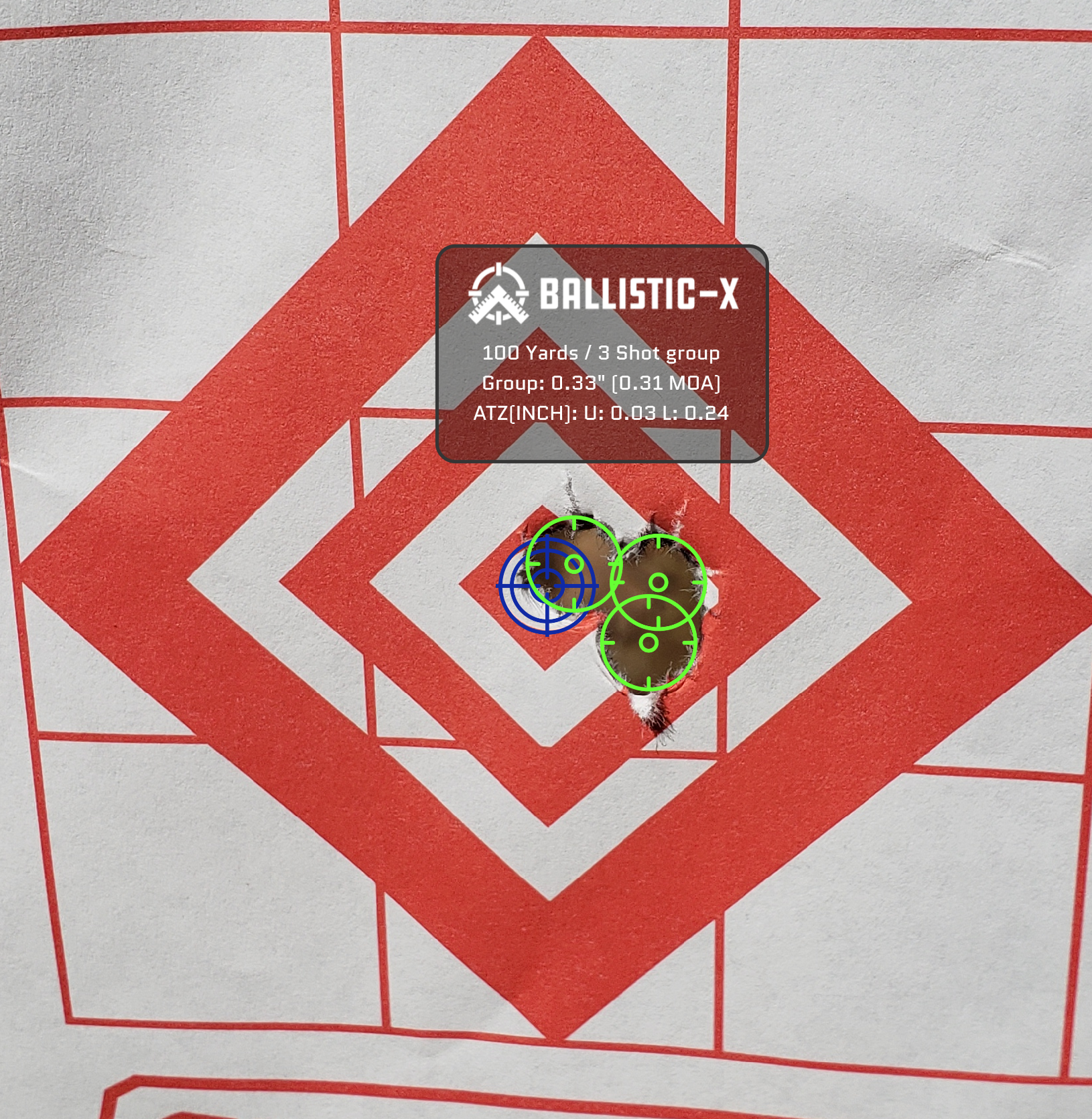

I dont think you'll be disappointed. This is with a barrel nut prefit in .308.
Ballistic-X-Export-2020-11-29 10:26:22.350567.png

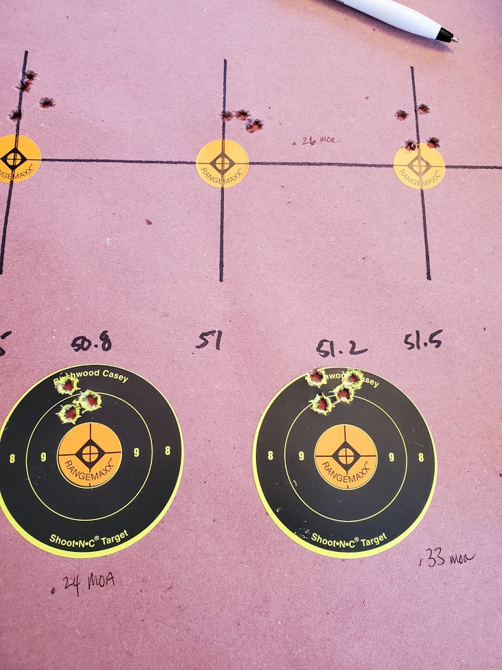

The barrel nut systems are plenty accurate. These are 200 yard load development groups with the Preferred Barrel Blanks variable shoulder (barrel nut) barrel on the rifle I posted above.

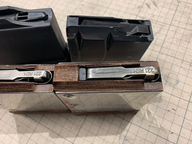

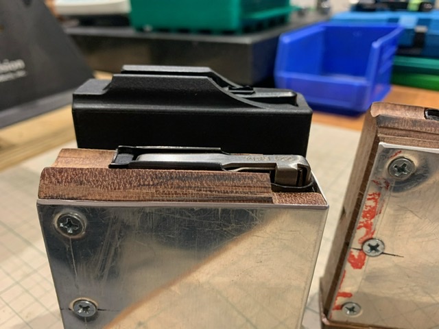

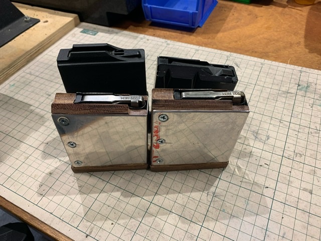

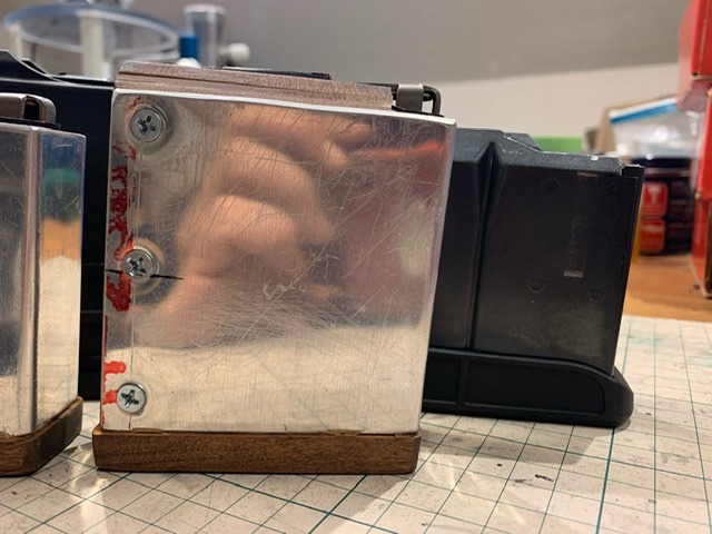

Here are pictures of the Modified CZ Fireball magazines. Tikka CTR 223 magazine and MDT AI 223 magazine for comparison.
Reactions: roggom

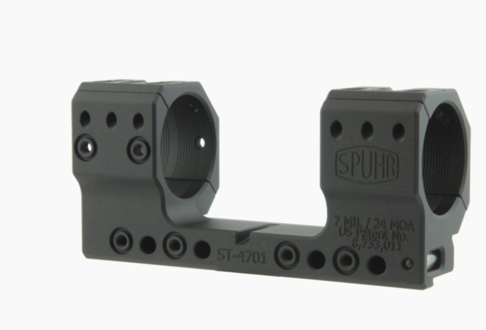

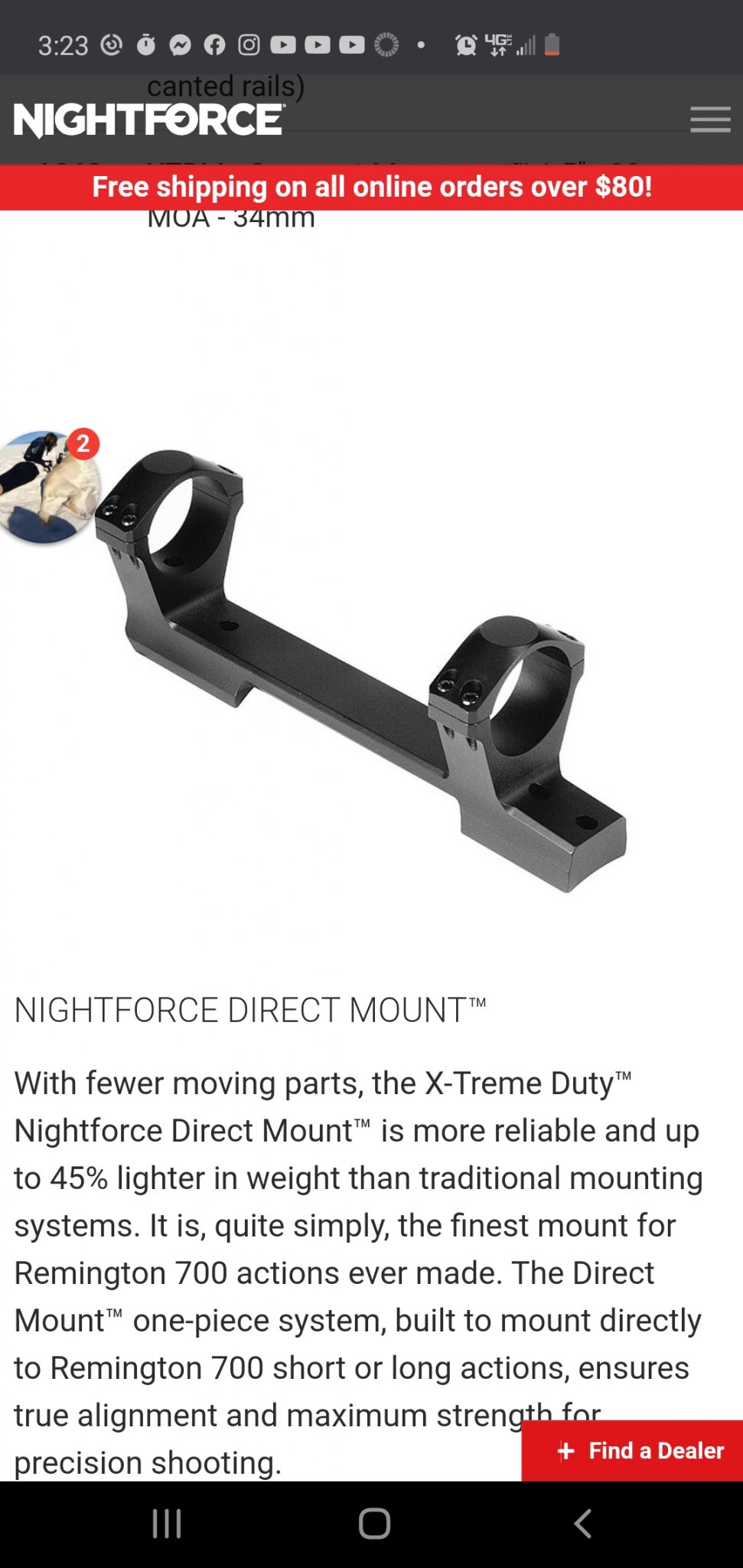

Hi all, new to the hide and just purchased a new Tikka T3X Lite D-18 Rifle .308 that I have not taken possession of yet. In the meantime I wanted to order a mount and my scope- I was looking at a Spuhr ST-4701: TRG 34mm Mount 7MIL/24MOA - 1.378" and wanted to ask the crew on here if that made sense and seemed like a great mount? It seems crazy expensive but I have heard good things? I had read earlier on here that the Tikka came with a factory dovetail and so it should fit right on there?
I also saw one a mount that looked useful with a bubble level, not sure who makes- any thoughts on those? do you guys use a bubble level?
lastly I saw the game reaper mounts which seem way less expensive but still good quality? but disadvantage for this is no 20 Moa
I will be using it for some long range shooting maxed at 1,000 yards and hunting.
My scope will be a Nightforce ATACR 5-25 F1 which is 34mm. Thanks
Honestly, that Night Force will likely make it to 1000 w/o any fancy mounting cant...even with a .308. That being said...
DNZ mounts are made just up the road from where I used to live in NC. I've never had any QA/QC issues with them at all, they stood up fine to the 7mm RM I ran them on.

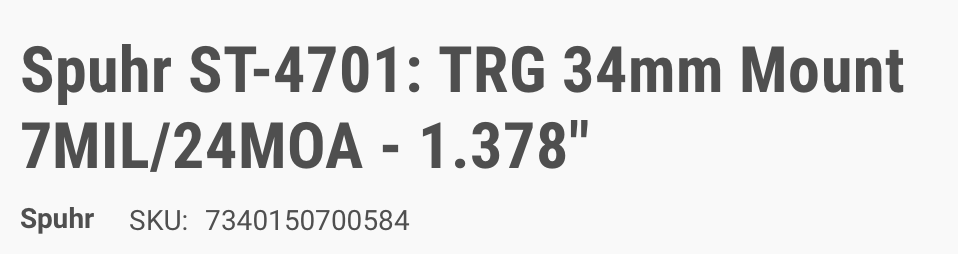

I have a Spuhr 4701 from Mile High sitting on my KRG SOTIC right now. My only gripe is that I've got it as far forward on the receiver as it'll go and, frankly, and the scope all the way forward in the mount. Definitely worth checking to see if you've got the eye relief you need...or, buy from someone that'll take it back without hassle if it doesn't work for you. I use a SIG Tango6 4-24x50mm on that rifle for sake of comparison...not sure what your eye relief is like on the NF.
