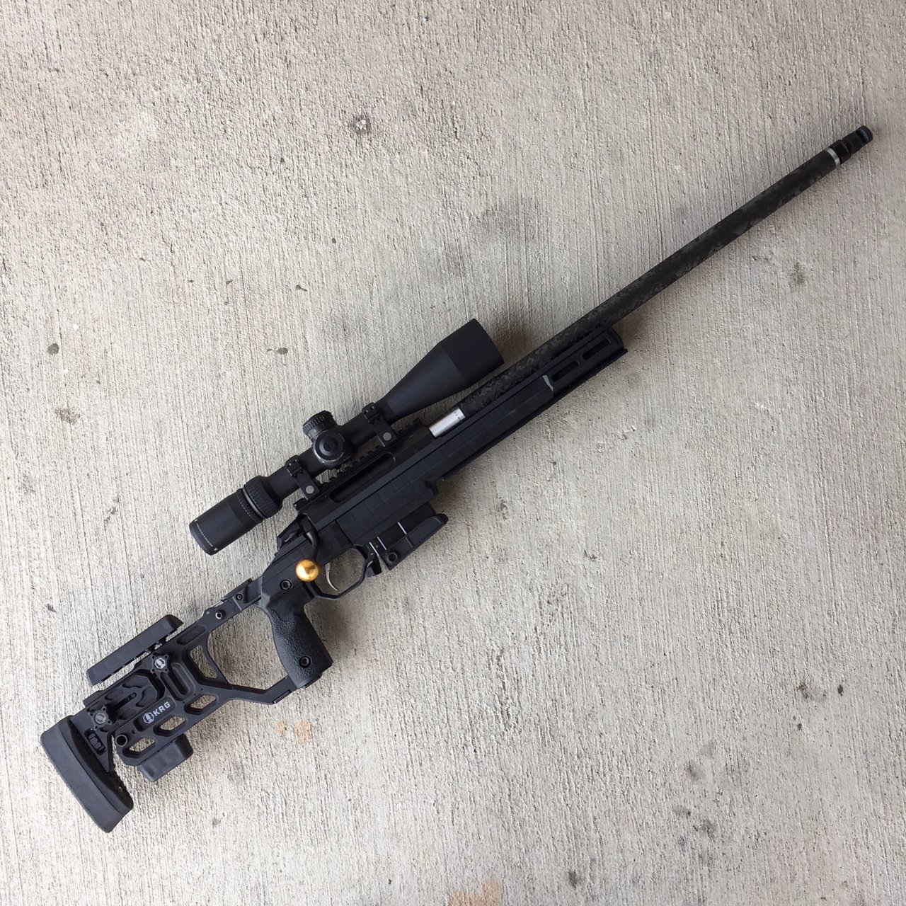

Tikka T3 Thread

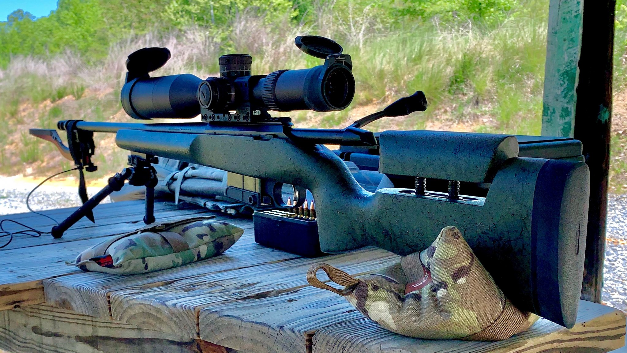

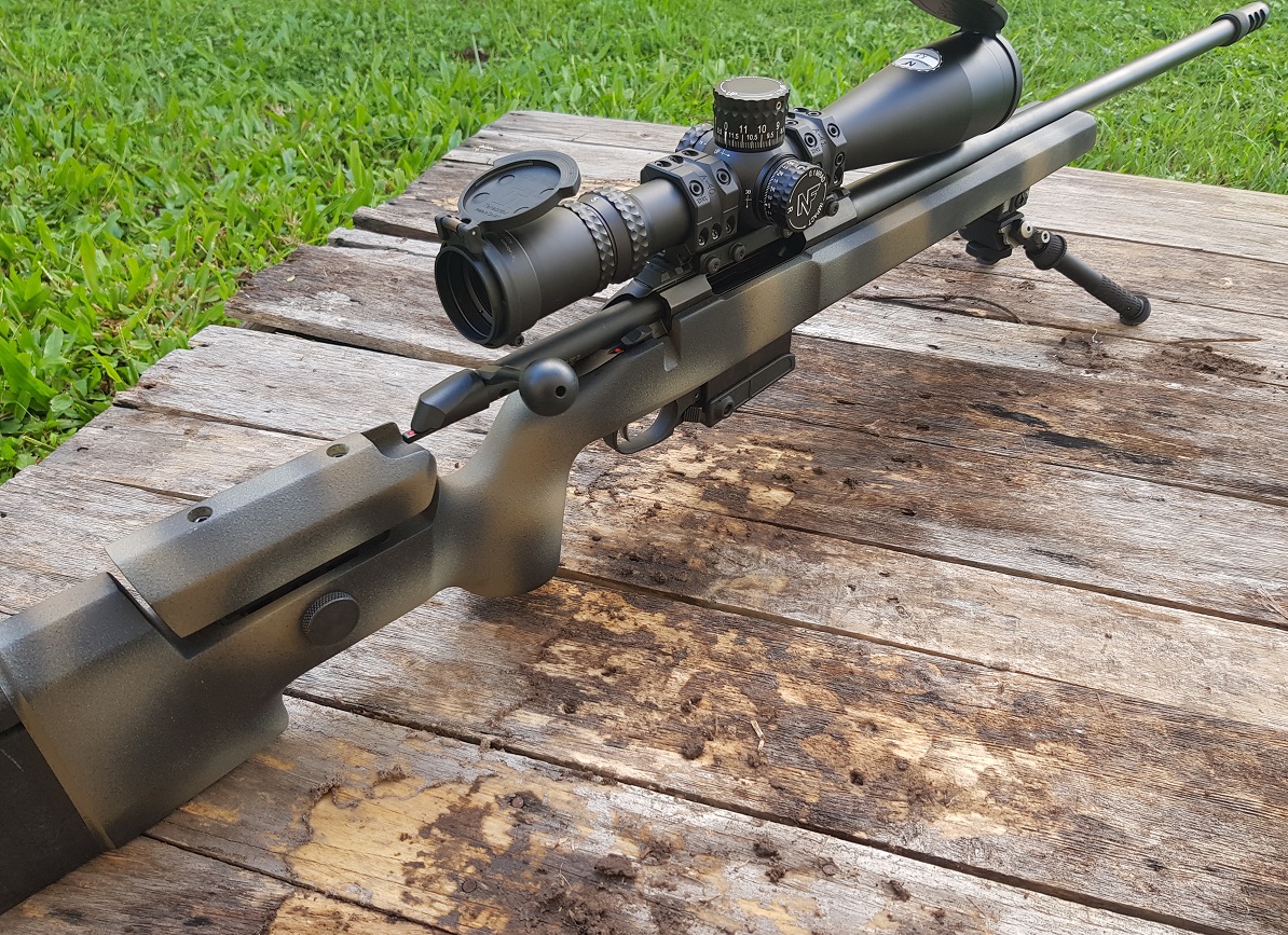

Just added a 26” heavy contour prefit in 6.5 CM from International Barrels to the Tikka T3x Tac A1
Other spec:
Vortex Razor HD Gen II 4.5-27
Spuhr SP-4902 30moa mount
CKYE-POD
MDT Muzzel Brak, Arca Rail, Vertical Grip, Forend Weights
Sterk swept bolt knob
GRS bag riderView attachment 7547790

My factory 6.5 CM barrel on my T3X TAC A1 is getting a little long in the tooth and I'll be looking to replace it soon. Does the barrel nut from International Barrels fit under the collar which the handguard attaches to? I haven't recently taken the handguard off to measure the inner diameter of that collar but I'm trying to figure out the max diameter of the barrel shank that I can use. Or if I can use a barrel nut.
BTW, nice looking rifle. Did you have to modify the MDT vertical grip in any way to get it to work on the Tikka chassis?
Thanks.

Just get a shouldered prefit. No need to go barrel nut if you don't want to.

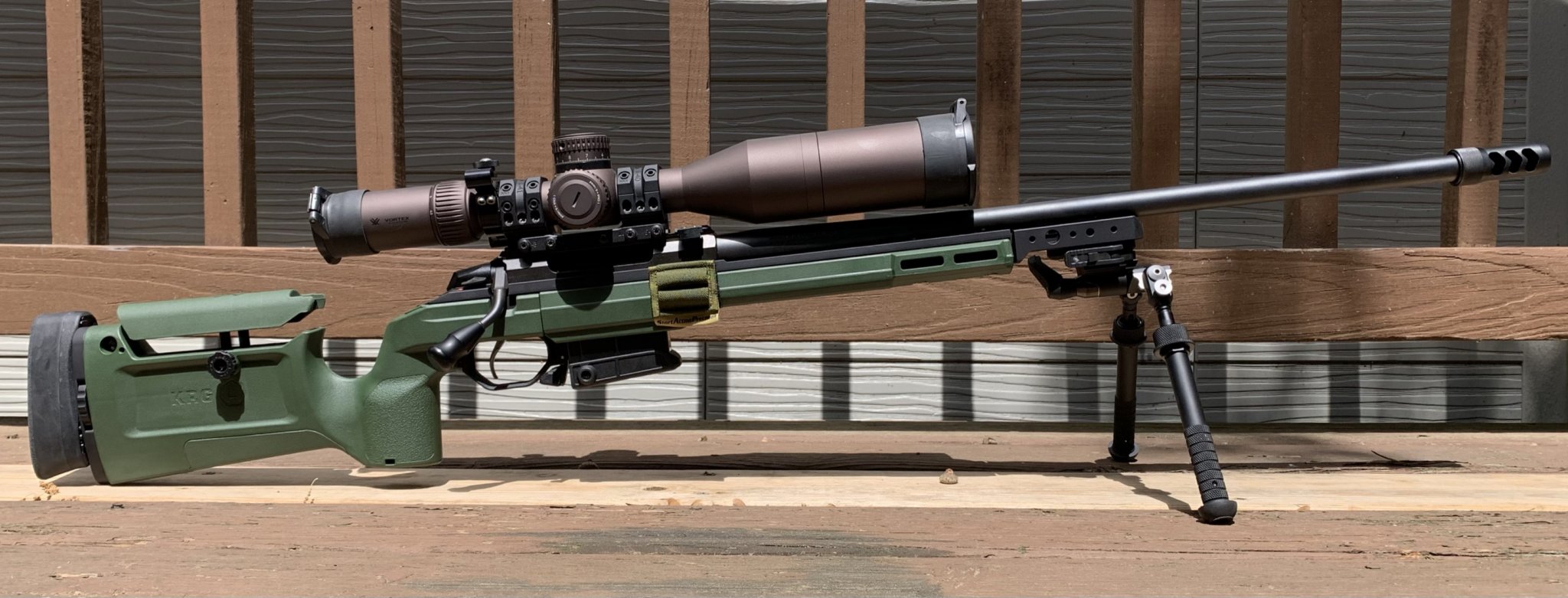

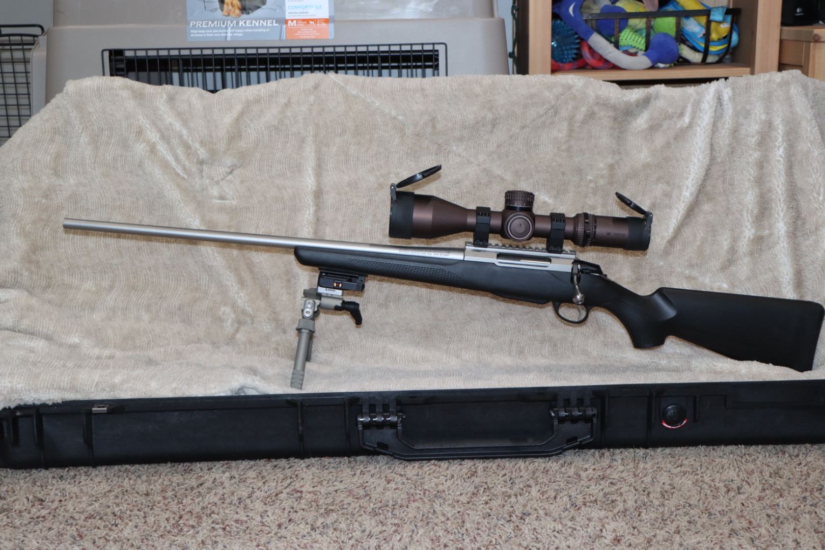

I went with the lite stainless in 6.5 creed. I wanted stainless on the action. Will upgrade the barrel later. Going to be ordering a KRG whiskey 3 in SAKO green in the very near future. Been working crazy overtime. 40hrs of 1.5x pay this last paycheck.
Here it is as it sits now.
Razor 2 4.5-27 7c mrad
Vortex rings and caps
Murphy precision titanium 20moa rail
Atlas cal no dye with atlas spike bare finish
Rrs Sc-lr and adapter

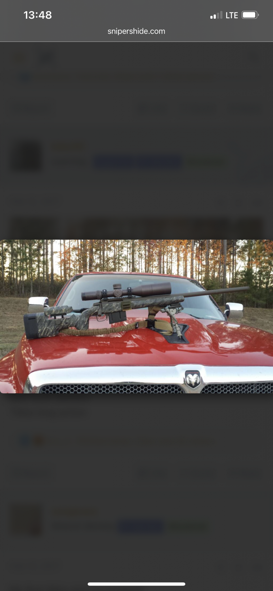

Anyone know what stock this is? I would ask him but the post was from 2017 lol.

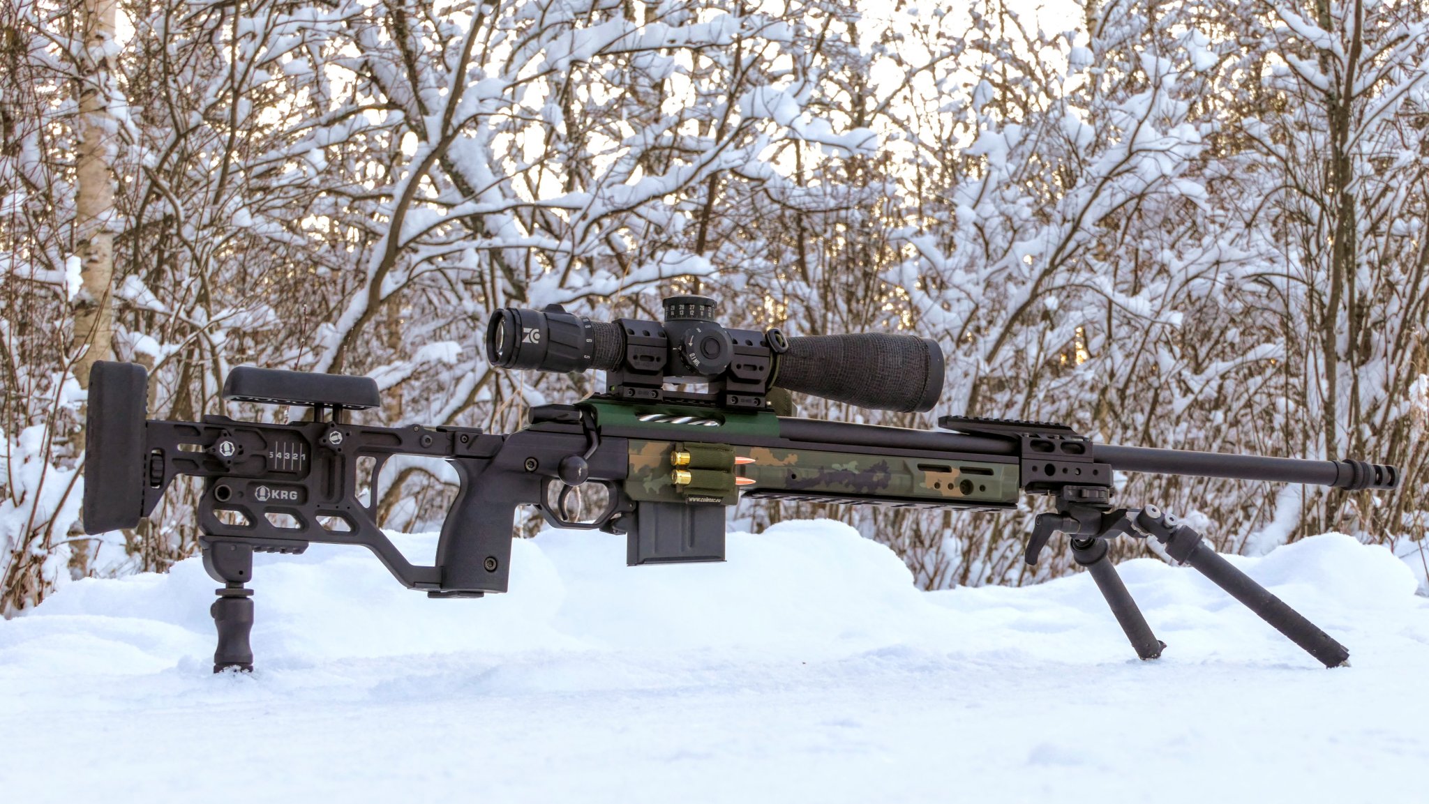

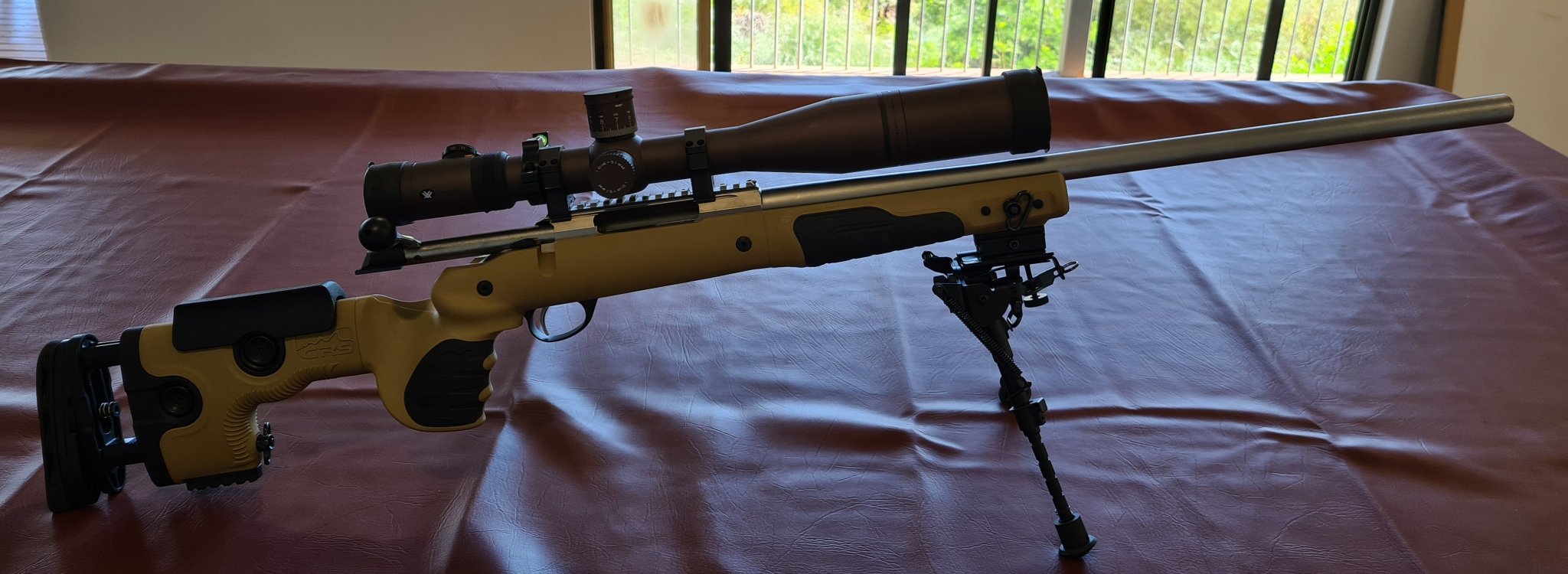

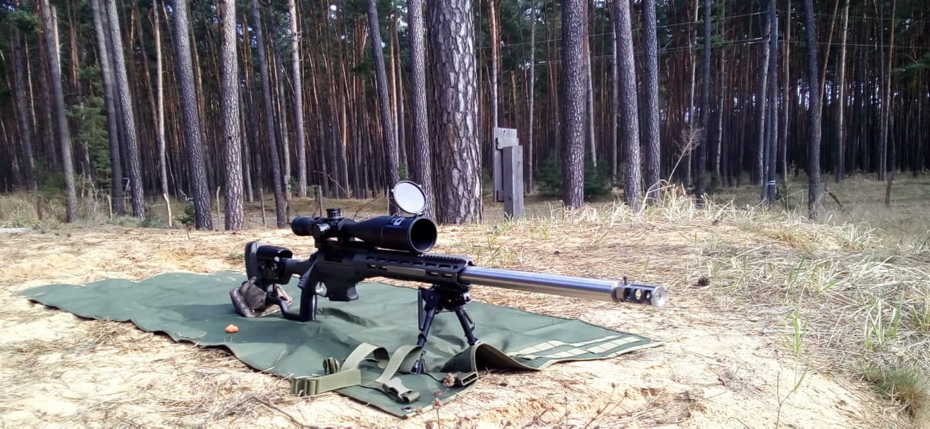

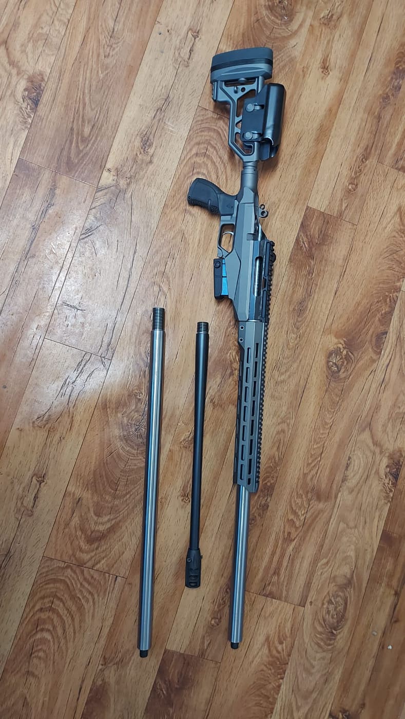

Hi guys,
after long time i have just finished and tested my little project to make tikka more "accurate". so i added a new barrel and make it multical (308 win barrel primary, 6,5 cm as secondary). i think it will be very good medal harvester at competition's :)
chassis original
system modified with my designed barrel nut
barrels- sassen engineering (border)
scope sigthron SIII 8-32x56
and some harris bipod ( i looking for something new like fortmaier).
Target 4 round on 300 m with my ammo.
but back to the bipod, any recomend to good and stable one ?

I sent the rifle to IBI to have the prefit installed as they hadn’t done one on a Tac A1. They said that they just had to increase the ID of the collar by about 1/4” to clear the barrel nut.
The MDT vertical grip ships with a SAE bolt that is longer than the M6-1.0 bolt that is in the stock Tikka grip. I just had to get a metric bolt of the same length to get the MDT grip to fit.

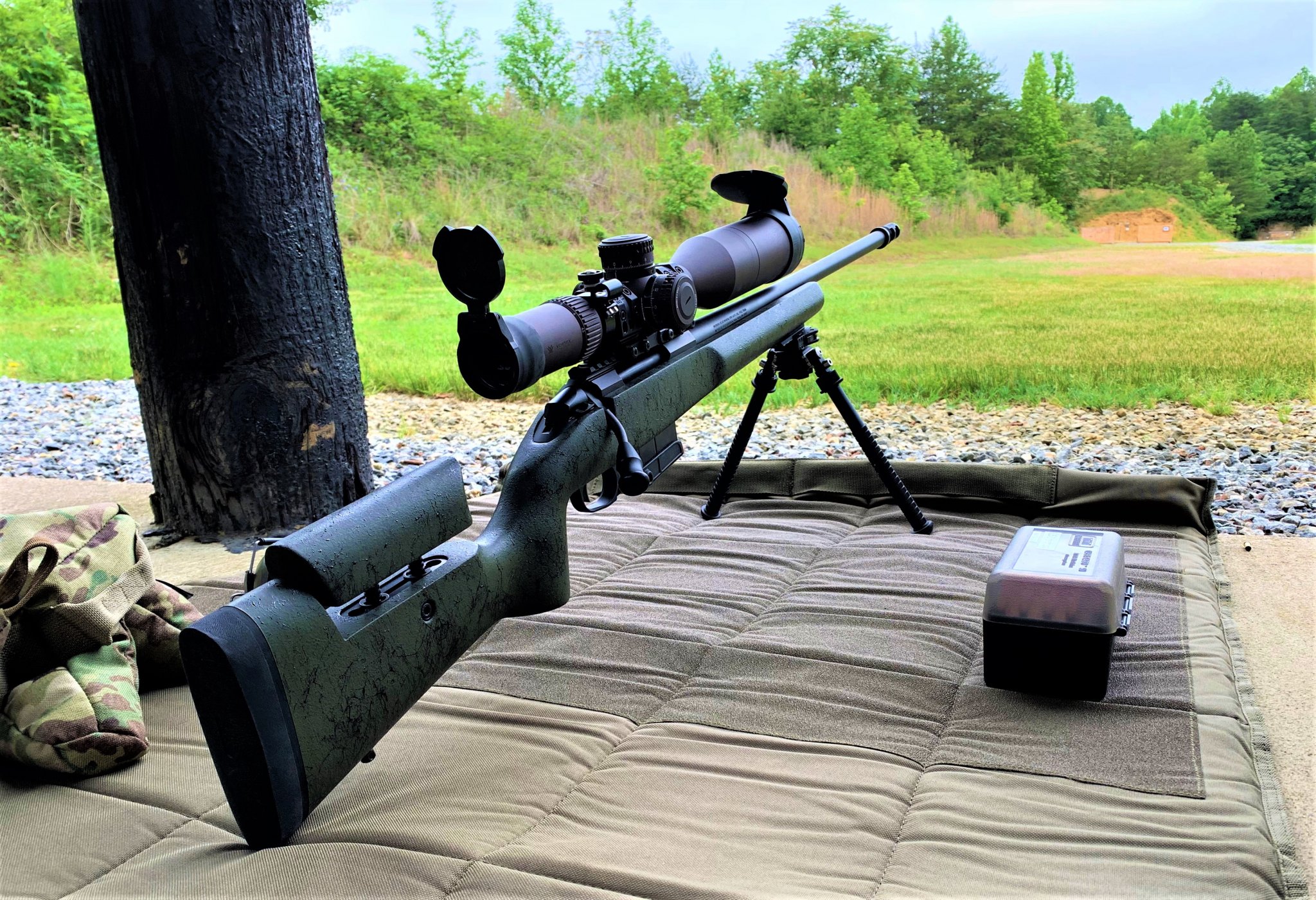

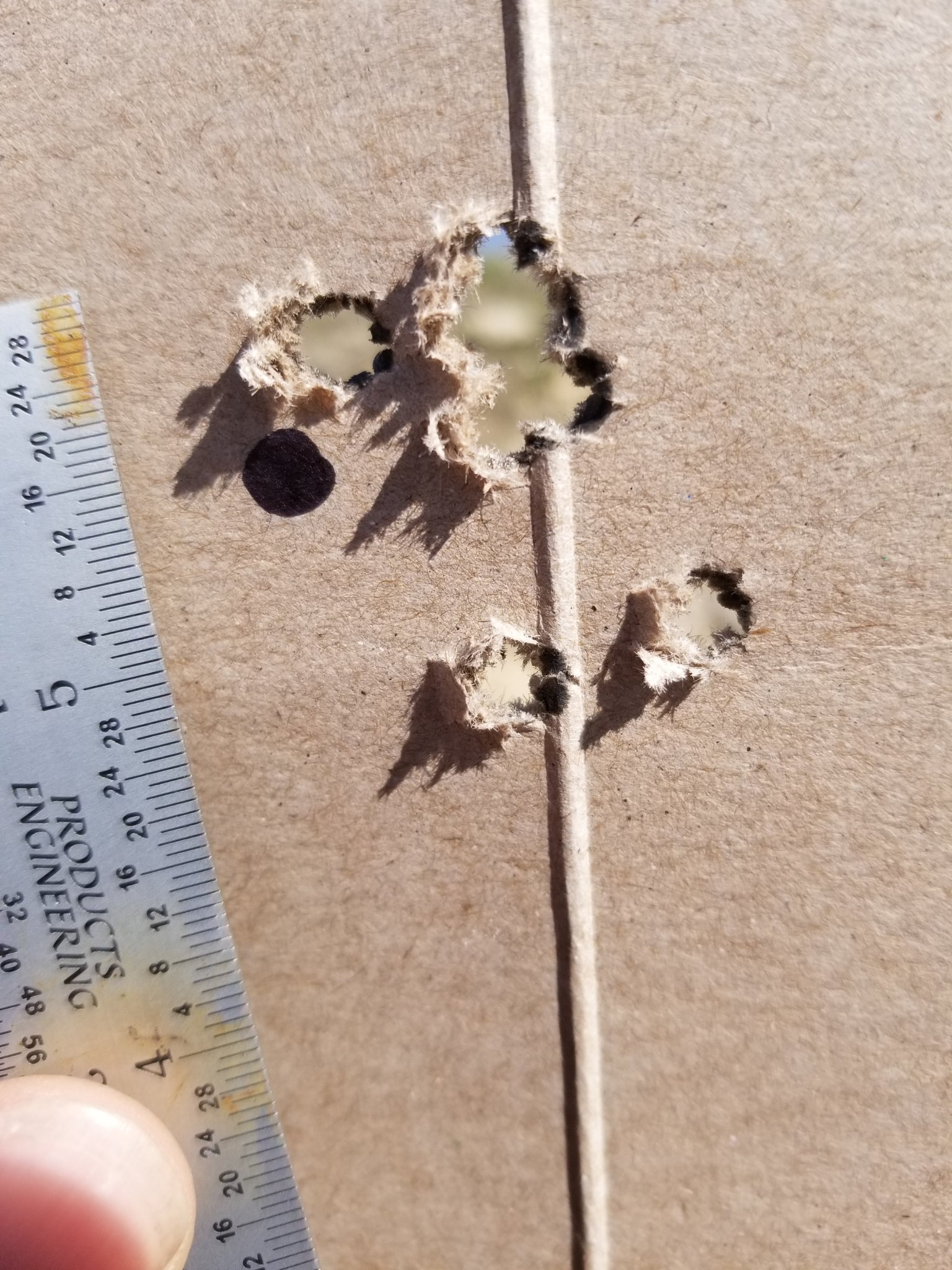

Put my first 50 rounds through the new IBI barrel yesterday. This is a 10 shot group of rounds 31-40. Those 3 little guys? Dont worry about those 3 little guys. 7 rounds into 1/2". Those "flyers" are the result of 30 mph kansas wind shaking the truck and breaking my target stand too. Barrel needs some settling in but is starting to show its colors and tightening things up very quickly as it does

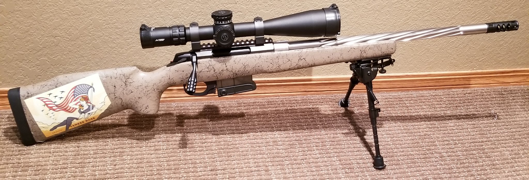

This T3 varmint 260rem in now on the Ensio Firearms gunsmith.
That 24" barrel will be took 2" off and it will have spiral fluted.
Then it will go to rest of that rear stock and pistol grip in to a Ceramet on to a M05 camo cerakoting.
Man, i bet it will be a bad ass.
Barrel and action will stay on black cerakote, so that all my rigs would not have the same look.

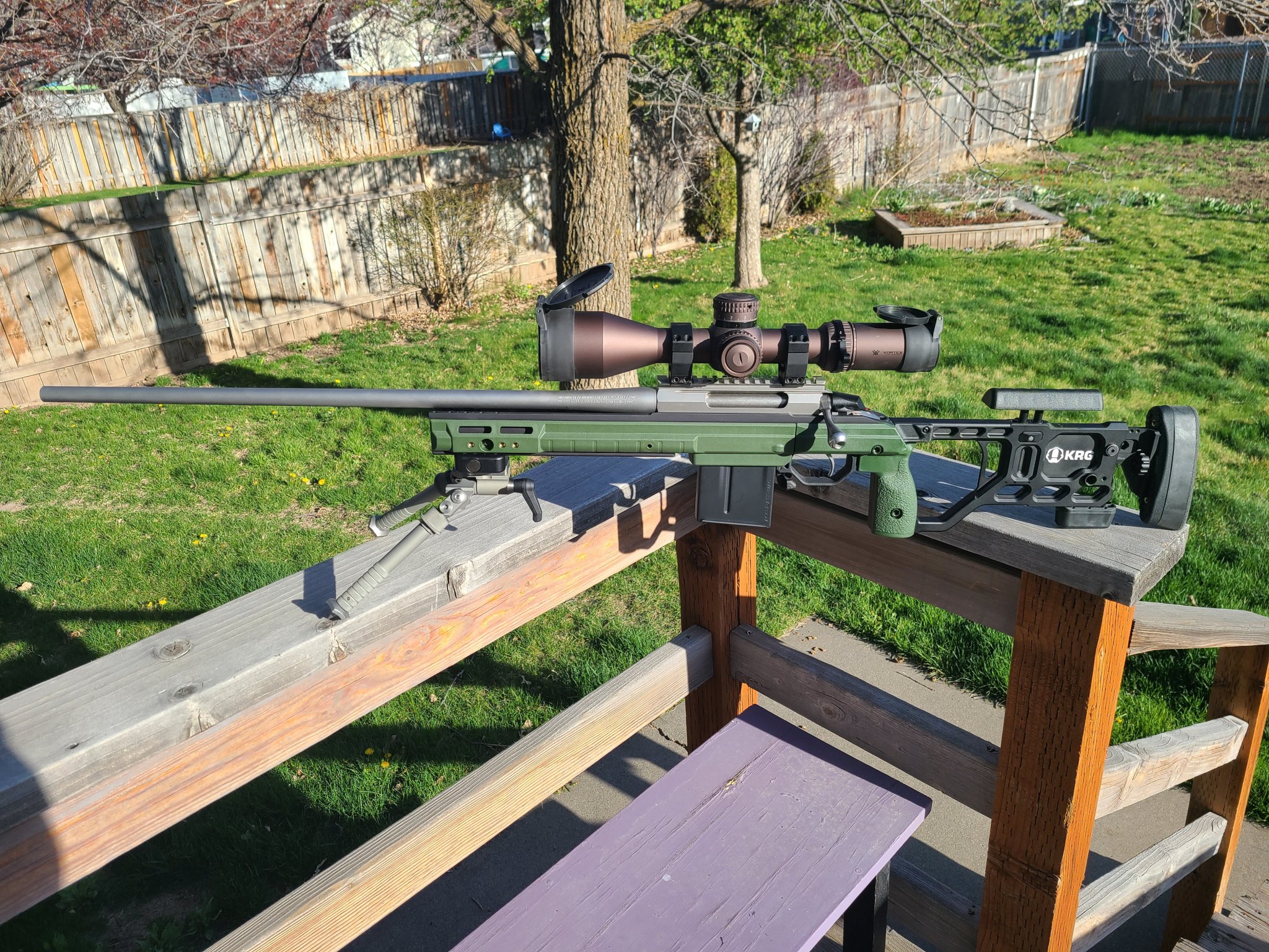

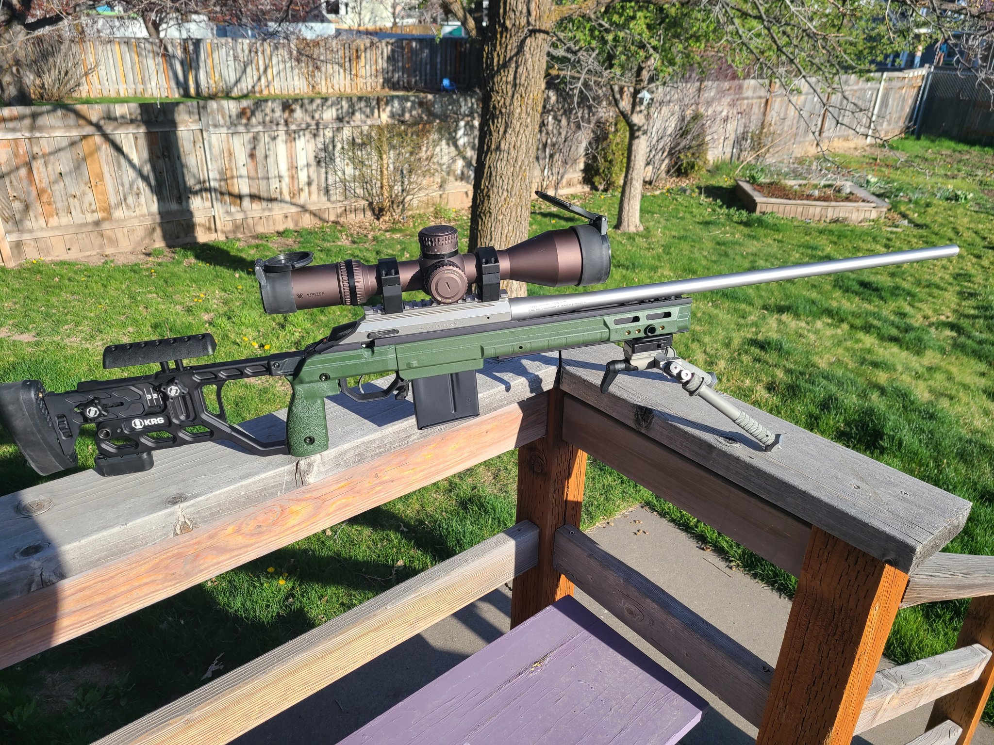

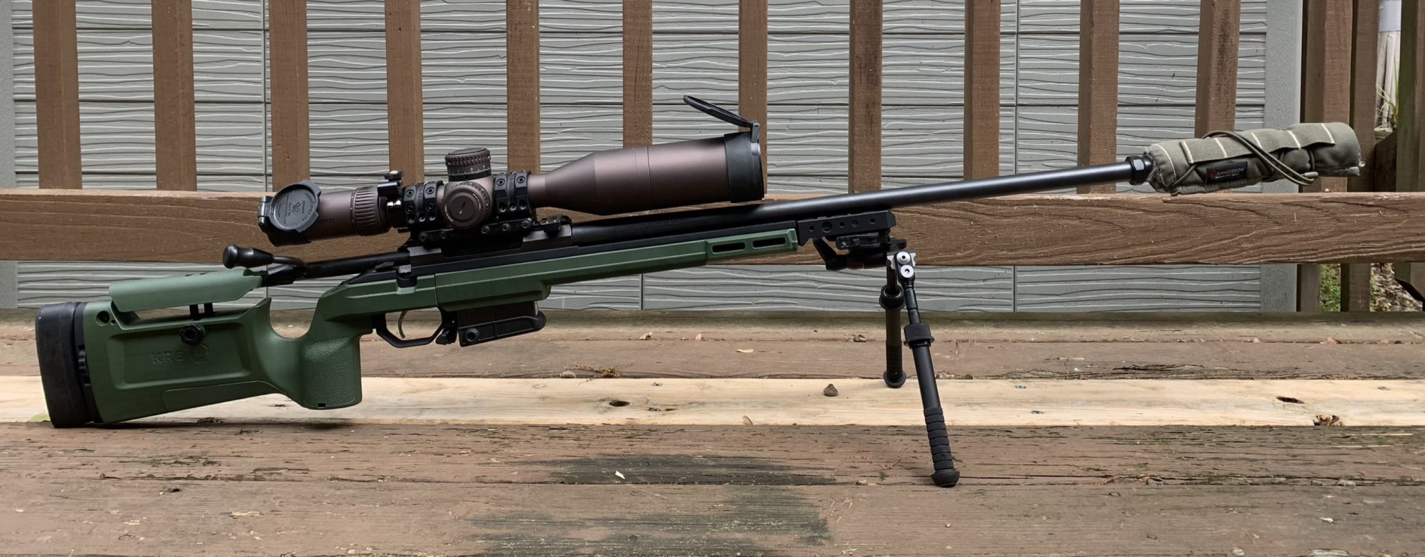

Update day! Purple orange Santa came today.
Tikka JRTXB482 lefty stainless t3x lite 6.5 creed
Vortex razor 2 4.5-27x56 7c mil in vortex precision rings (used off the hide)
Murphy tactical 20moa titanium rail (just cause I could)
RRS sc-lr, RRS atlas adapter spacer, Atlas CAL gen 2 no dye with Atlas spike feet (thanks @Kasey)
New part
KRG whiskey 3 with arca rail. Krg branded accurate mags.
Note: bolt handle isn't all the way down. Will have to make a slot for the bolt handle on the correct side.
Weight with everything listed above with empty mag 14.8lbs.

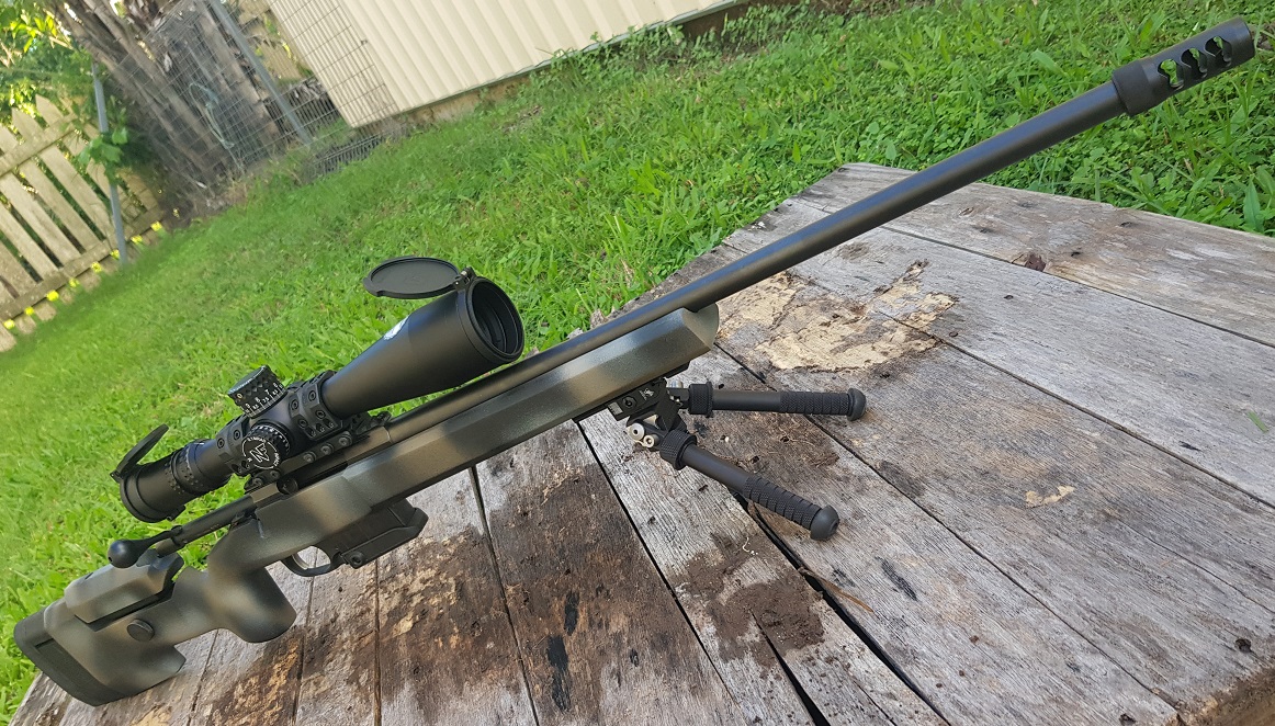

T3 Varmint SS 260rem got grooves.
Next stop to cerakoting.
