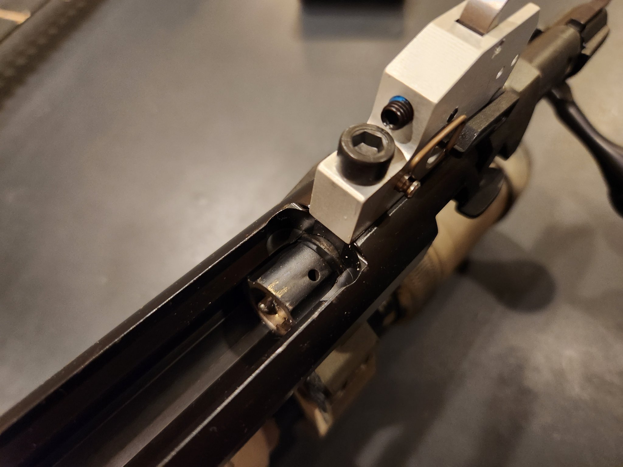

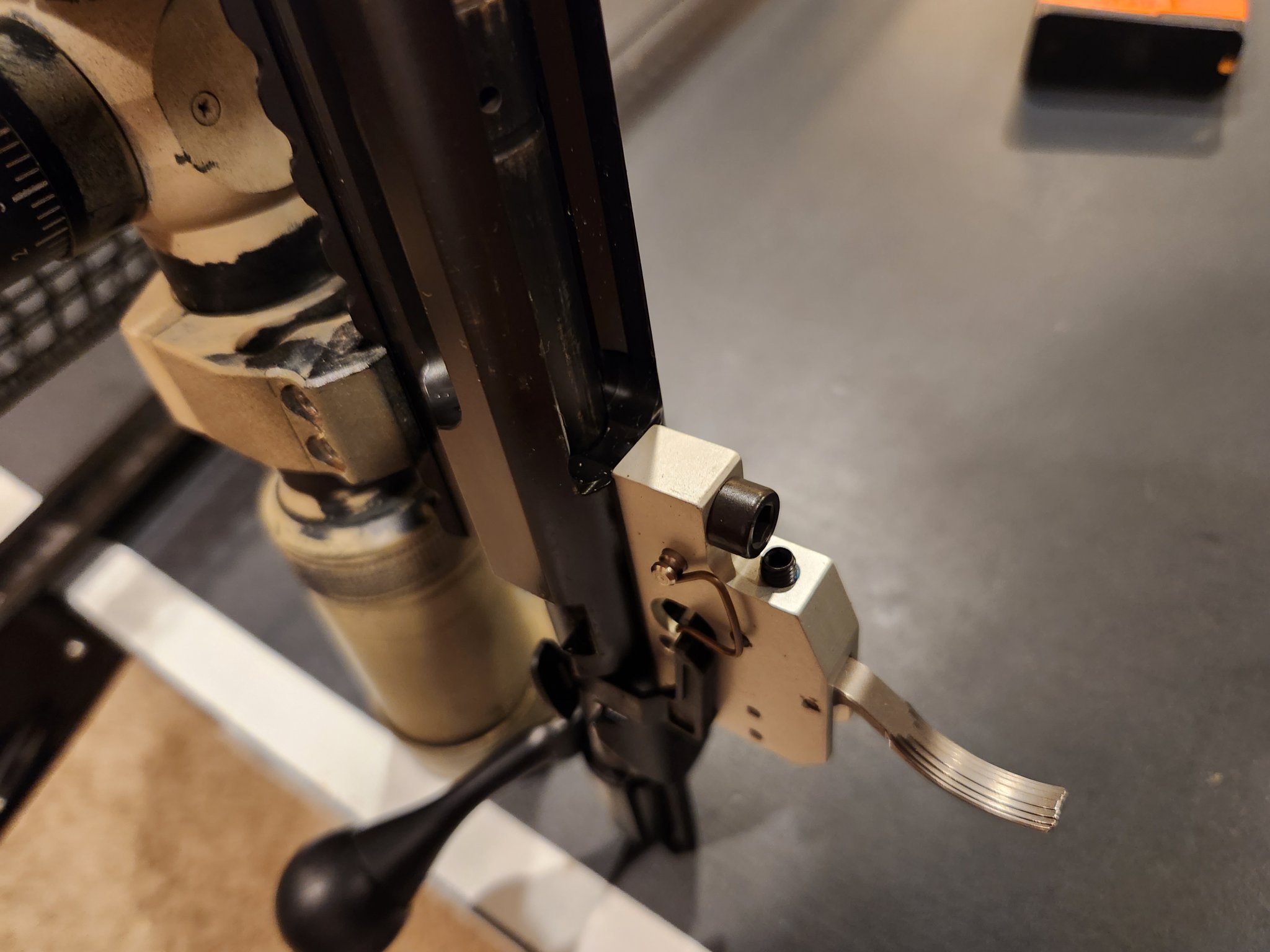

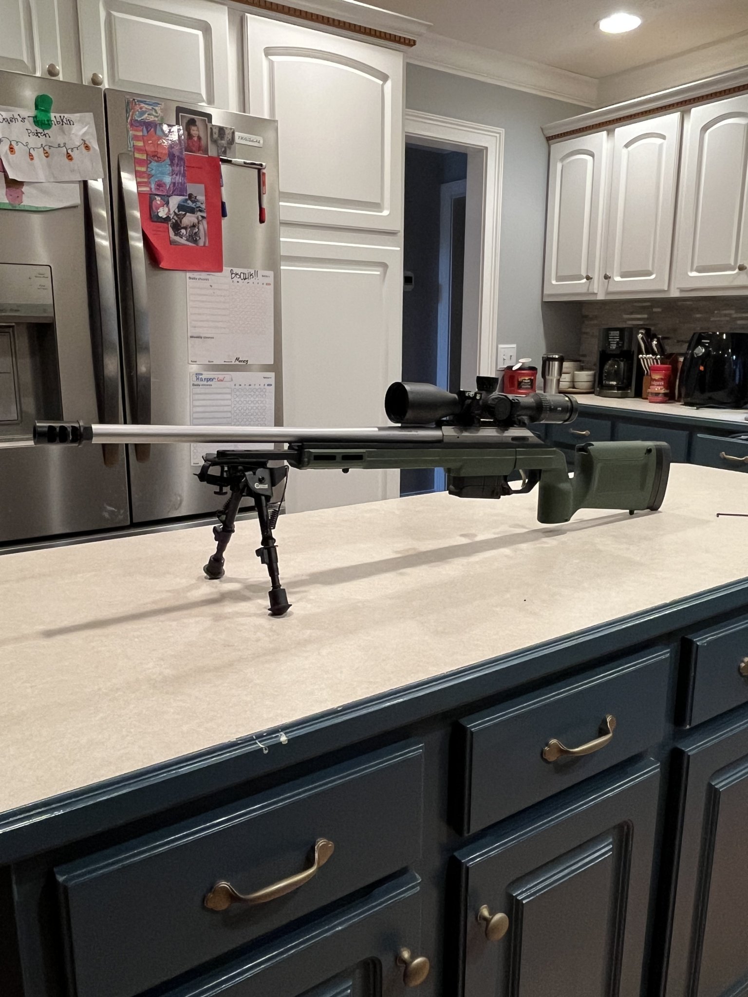

Quick question on Tikka CTR fit in the Bravo chassis.
I installed barreled action, seated it on recoil lug and torqued action screws to 65 lbs. Are y’all seeing a similar gap between the barrel and chassis fore end?
I don’t think you have it hitting the recoil lug properly. It can take some try’s to get the lug engaged in the action.
Reactions: General RE LEE
It took me a couple tries to get it to the position it’s at now. I was very careful in my approach seating it on the lug and applying torque to the screws. Maybe it’s just me being OCD.
Remove the bolt and check position of action screws with a torch into the action and rear easily visible. If these screws are not engaging almost to the top I would be very careful with 65inlb. It is only a wobbly M6 thread. I'd be running max 55inlb. Roughly 6nm.
If the front screw is way low it could mean lug is not engaged.

In this case, torch = flashlight. I would not recommend checking with a blowtorch or flame. :)

I confirmed both action screws are fully seated in threads. I’m good. I’m just not used to such a larger opening around the barrel. This is my first chassis.
