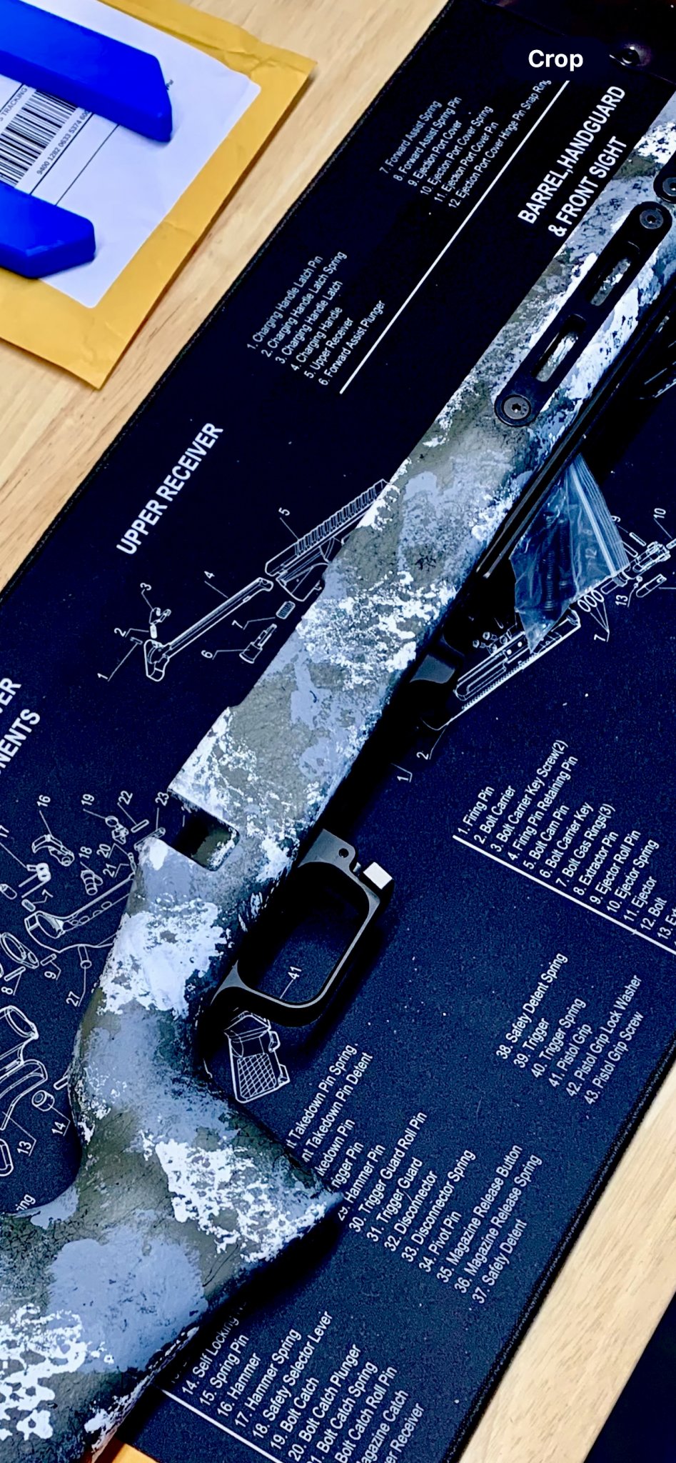

Anyone have a KRG chassis in sako green that they sponge painted? Looking for some inspiration, specifically for the sako green color since that'll be the base color.
I've got an x-ray on the way and plan to paint in before dropping the action in. Curious to see the color combos anyone else may have done.
Cheers!
Cheers!
Not a perfect comparison, but this was an ODG Ridgeback that I did a while back. Probably would have picked some brown/tan supplemental colors in hindsight, but it turned out fine.
Sako green would definitely be a little more vibrant - could probably turn it down a little with some black “overspray” first before sponging.

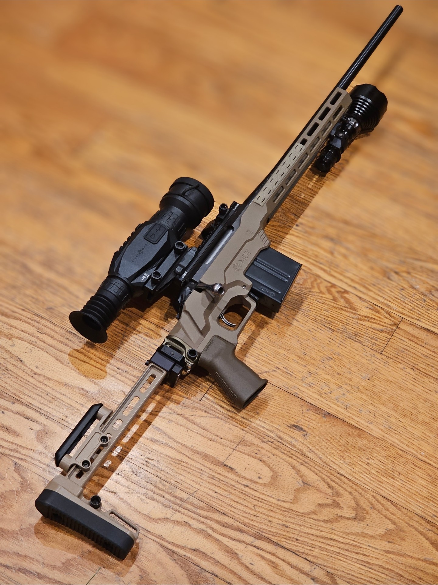

Mine feels great, it's an MDT chassis with an A3 Tactical folding stock. I just finished putting it together last night, going to zero it on Friday and hopefully get some predator hunting at night these next few days while away for white tail.
My hot take is well made, points and handles well, not too heavy. Mag Release sucks, mag well is way too tight (using mdt mags as well), and the thumb rest slot they cut in it is a total waste. I'm probably going to put the chassis on my 3 axis and cut off what I don't need quite frankly.

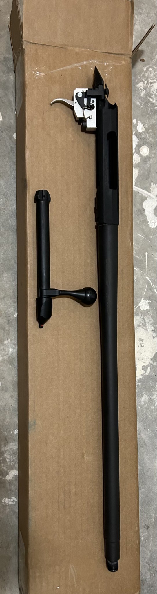

Ok. Need some help. Just purchase this barreled action from another member.

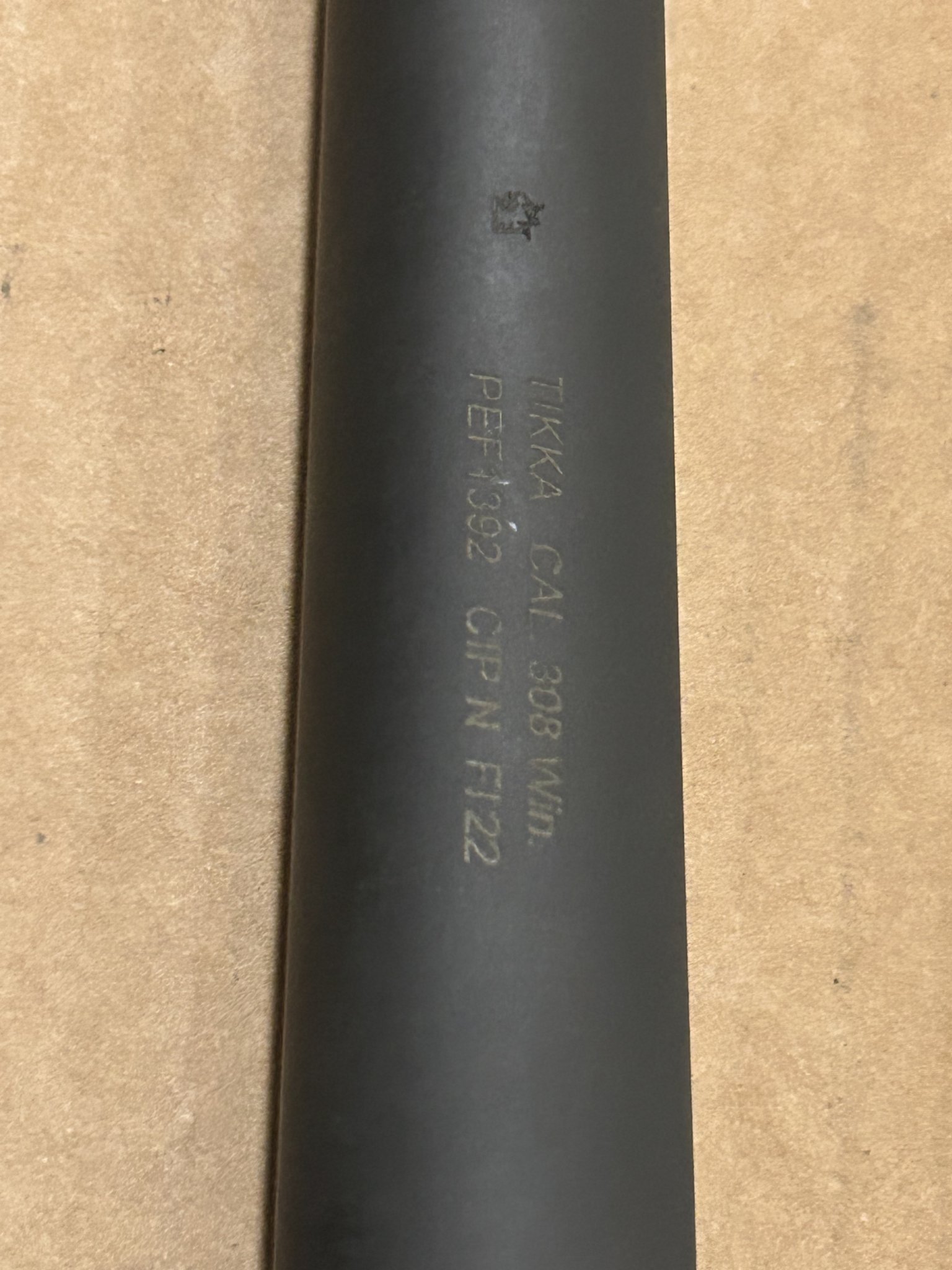

has anyone ever seen a step down barrel contour like the one on this barrel on a Tac A1?
WHAT BARREL THAT IS?
Not from factory, or some one has done the muzzle thread afterwards, that is not made by TIKKA.
There is like a spigot done on lathe after the threads.
Profile of that barrel look like varmint, much thicker than TAC/CTR/UPR, those 3 has same profile barrel.
Reactions: HolyCity73

None of my tikkas have barrel markings like this. Thought it may be an early Gen TacA1
That looks like Finnish proof marks. From 2022? Probably engraved by the proofing facility, not Tikka.
The thread reminds me of the "spigot" attachment for a can, that I have on a rifle. There are different metric sizes like 17x1 Spigot or 19x1 Spigot.
