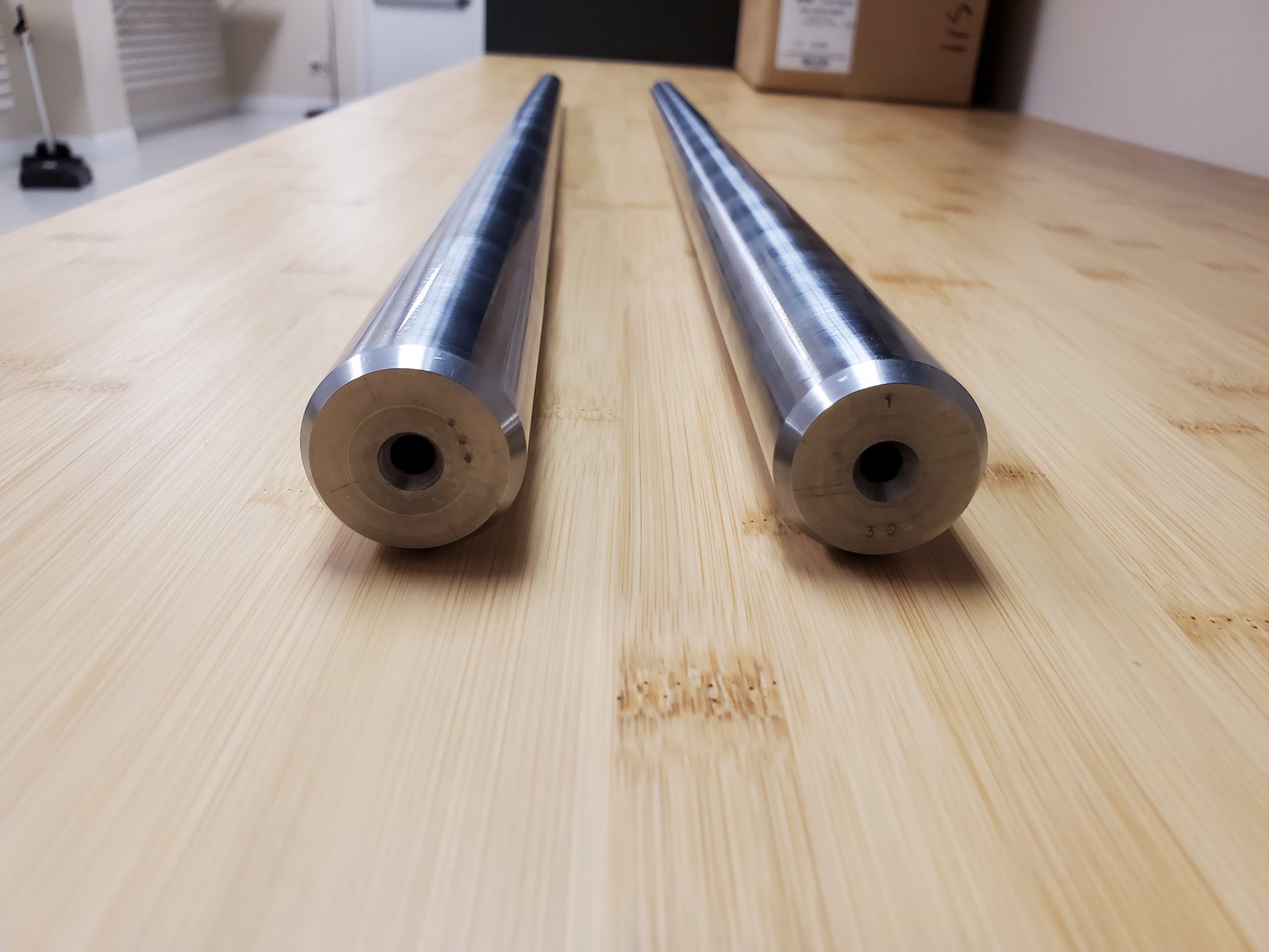

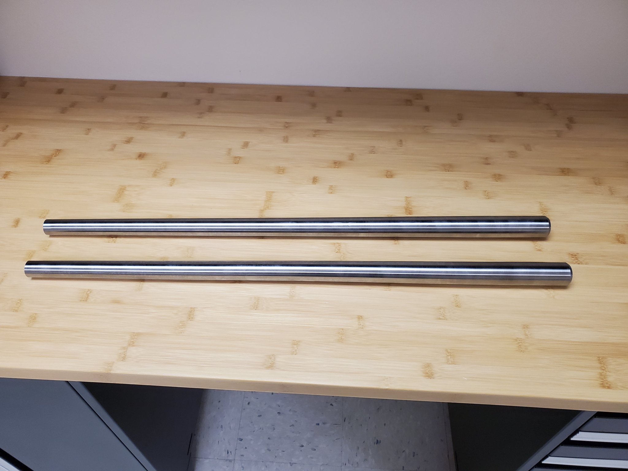

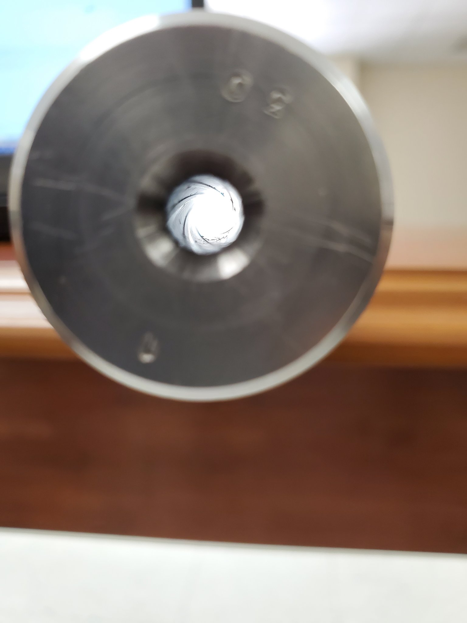

    Time for industry to update its' rifling method manuals?
    Testing will determine :)
    Not cut rifled
    Not button rifled
    Not hammer forged
    No heat, no friction and no stresses induced.
    Sincerely,
    Theis

    Aermat100 barrels coming right up
    Yeah, maybe not Aermet, but if Hoplite wants to really take advantage of running higher pressures in the actions, I think advances in barrels will be needed, and I imagine this is the goal here. I know the military has been working on this for a long time, and it seems like a hard problem. You also have more options with bigger guns in terms of adding liners and such.
    Inconel would be pretty sweet. Curious if there has been much discussion yet on reamer design and how even good carbide reamer will hold up to inconel?
    I imagine the reamers can be considered disposable. How does one drill the blank, I wonder.
    The blank I'm less concerned about. We just did some 8" holes through inconel last week at work. Tooling life would definitely be short and cycle time would be longer, but drilling could be accomplished on standard gundrilling machines. I'm more thinking of the learning curve (if any) for the guys chambering the barrels.
    I bet with a carbide reamer and the right feed and speed even Inconel would not be a huge issue.
    Entering new territory in barrel production for sure. I've heard of people experimenting with EDM to make barrels, but never heard any results from those experiments. ECM/PECM is a different take on machining with electricity. Even though I'm new here, I've been lurking for a while. I remember a thread where Theis expressed some interest in PECM. Around that time I was reading up on new machining tech so that little tidbit stuck with me. If ECM lives up to the marketing hype, it will probably replace all other barrel making methods but the mass produced hammer forged barrels. How's the surface finish on those barrels?
    I don't know how electronic dance music is going to help make barrels, but I guess if it helps morale around the shop....I'm cool with it. 👍🏼

    This is neat stuff. What do you hypothesize the benefit may be? Longevity? Repeatability? Accuracy?
    Also curious how you'll perform testing, or rather what tests you will perrform.

    Hi,
    ECM can get and hold some crazy tolerances.
    Most people know ECM work as a deburring and polishing process; one in which there is no equal. Polishing internal "ports" is more than half of ECM equipment utilization.
    @sinister
    I can spin up 1 of these normal 416R alloy ECM barrels and send over to you. Just let me know what "prefit" action you want it for.
