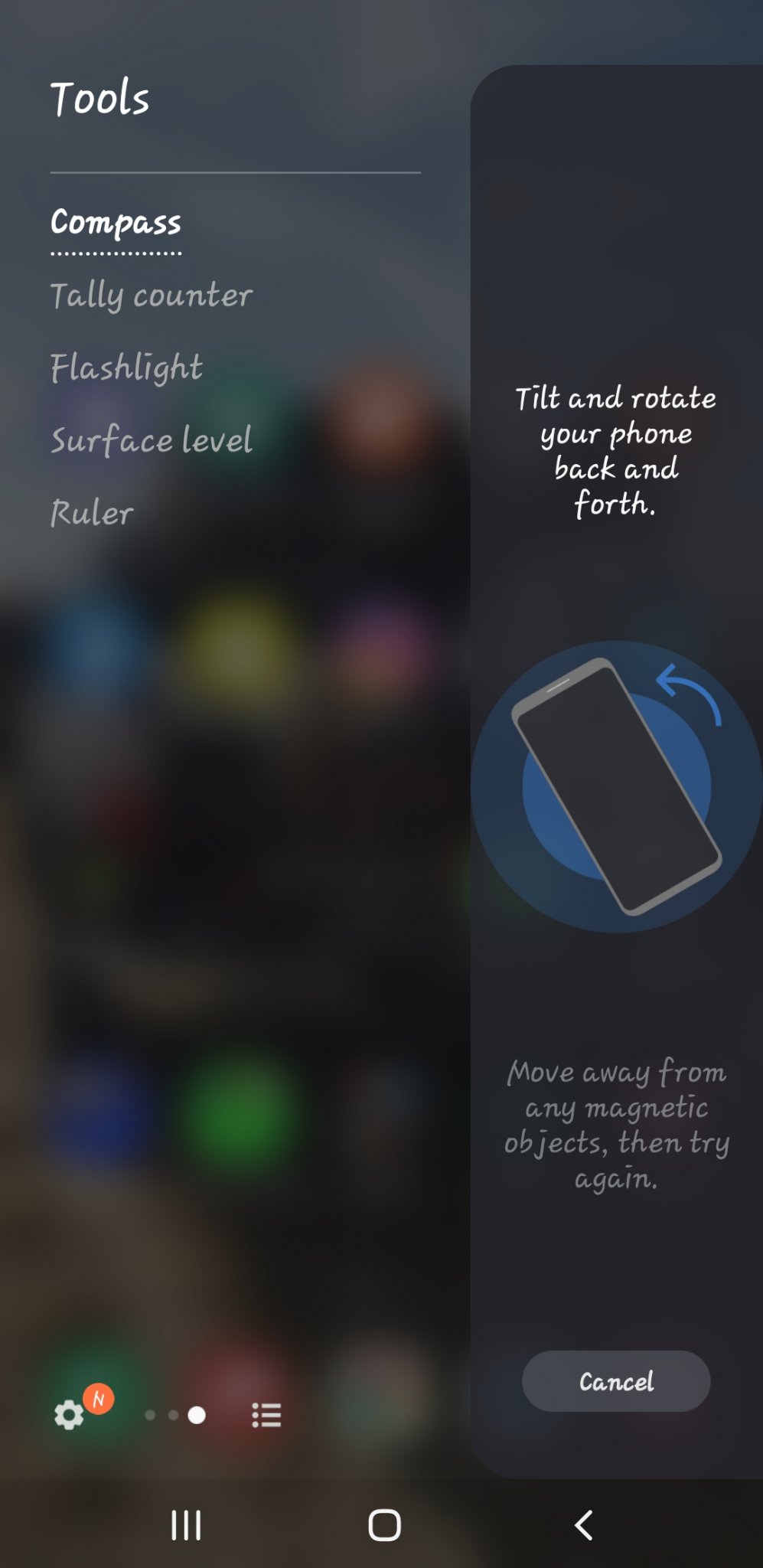

Every time I try and use my compass the phone wants it recalibrated. Galaxy S9+ My Kestrel hasnt needed it yet.I don't know anything about amazon prime, but I have a Samsung Galaxy with a compass in it that doesn't have to be re calibrated all the time. Doesn't seem like much to ask for from a $700 instrument.
