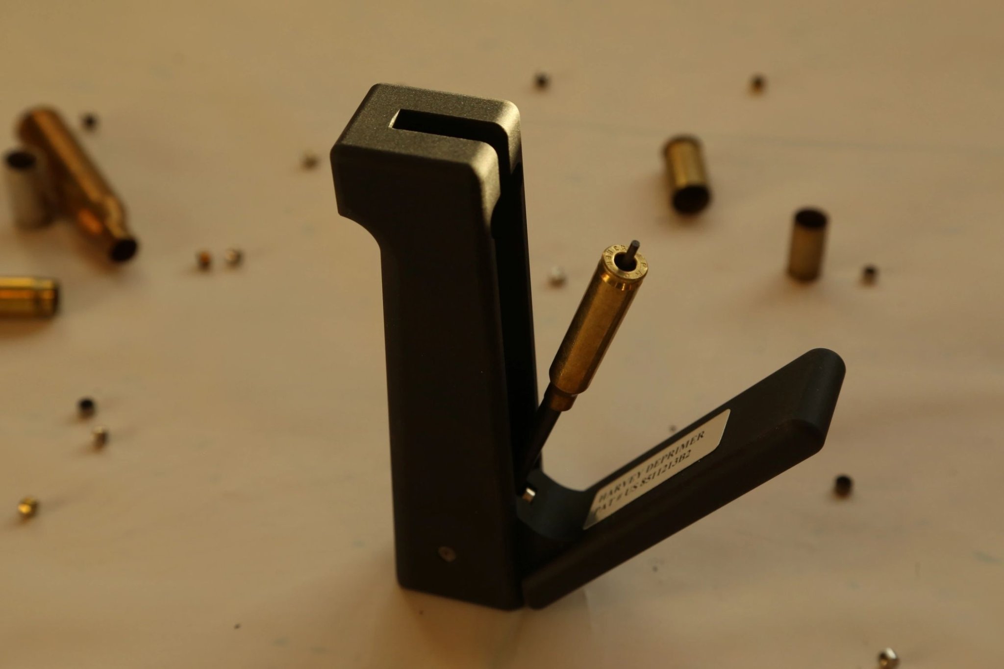

I have a mighty armory decapper so I deprime first and still get clean pockets and dirty brass never touches my resizing die...
I also use the MA decapper on my D750 and decap 5.56 and 7.62/6.5 cases by the hundred. Its a great tool. Then i stick them in the tumblers. I dont have the magnum adapters for the case feeder yet but will soon. Then its 100% decap before tumbling.
Reactions: seaflar and simonp
I'm with the majority when it comes to rifle reloading, MA decapper, wet tumble, dry then size.

Harvey hand deprimer then tumble. Clean brass in dies.
