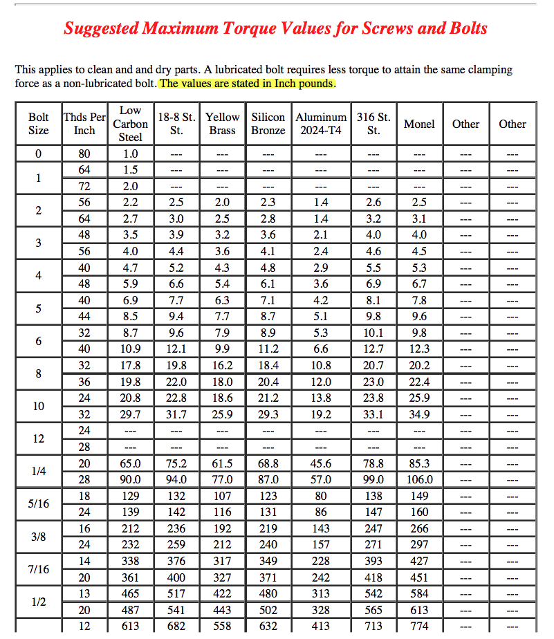

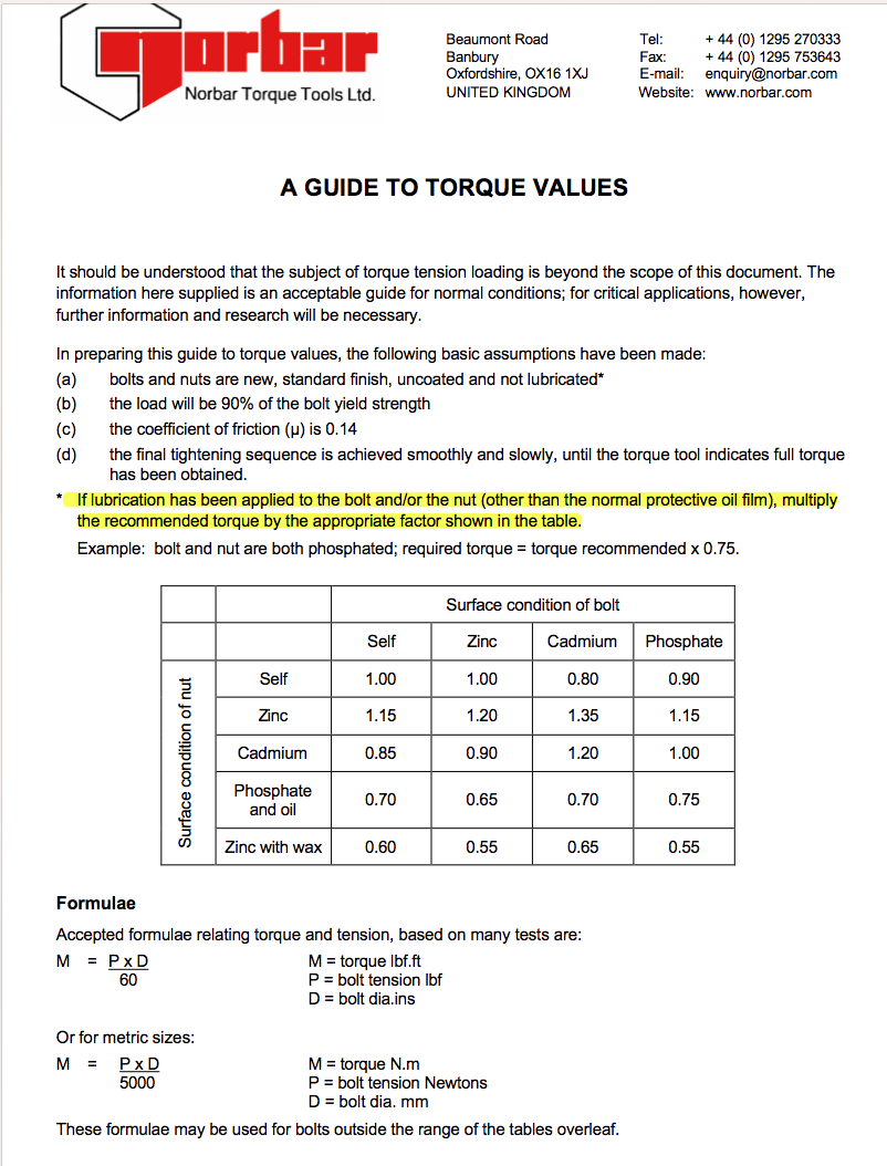

There are a number of mfg. charts for fastener-torque recommendations with addendums for any thread added material(s).
Some tables I have in my library.

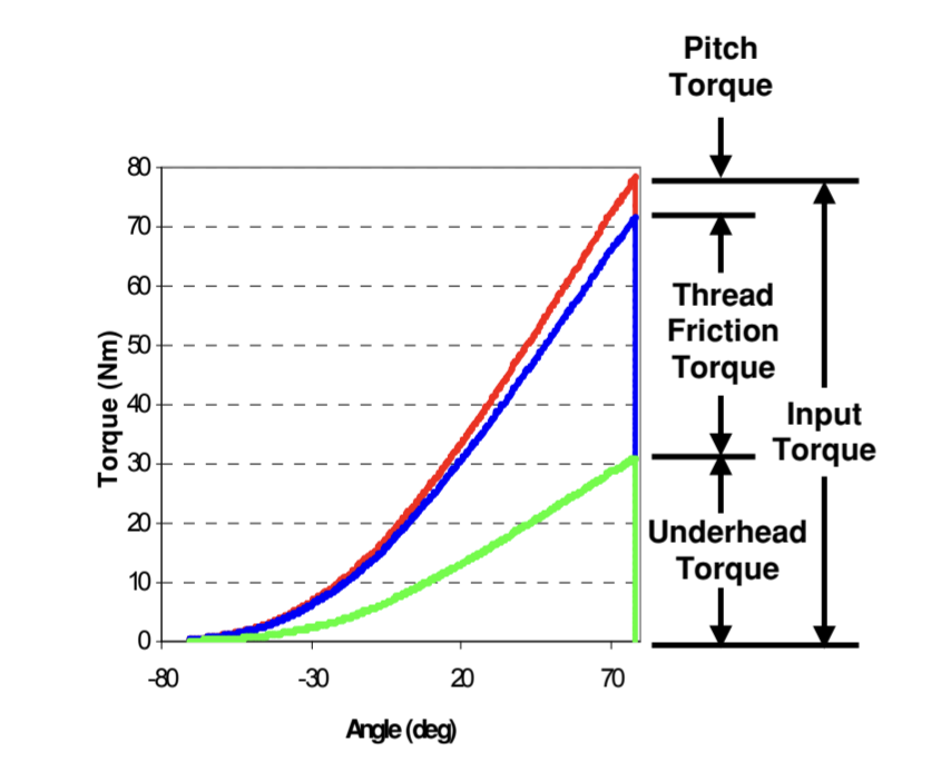

A useful graphic to back up your point:
Underhead and thread friction torque should be self-explanatory. "Pitch torque" is what results in the stretch of the fastener, which is what we are trying to accomplish. Maximizing pitch torque is useful - recall that it's the only one that matters in operation - and we need to keep maximum total torque low enough to avoid breaking something (usually the male fastener at the point where it first enters the female fastener, which is instructive as to where maximum loads occur during tightening).

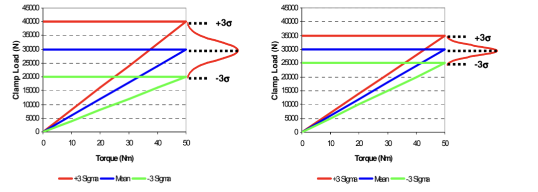

We also want to minimize "torque scatter", which is often attributed solely to the torture limiting device but generally can be applied to anything which influences the relationship between torque and strain.
Friction variation is often far more prevalent of a factor than tool variation, but lubrication can often reduce this factor which is why most "serious" work is performed with generous lube applied to the mating parts.
