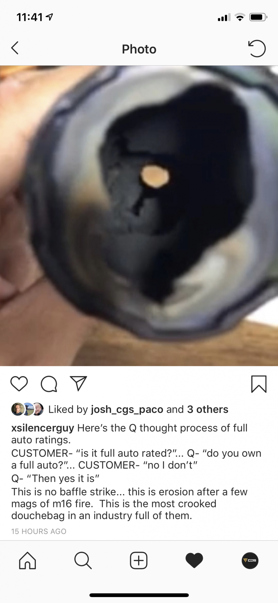

This is not my ig post but I saw it online yesterday. I have previously seen a video of a similarly destroyed can that someone in the Industry was sharing.
Did you send it back and have them deny a Warranty clam ?
How does Sage rip 500 rounds through the Q causing it to glow in broad daylight, and it only suffers coating discoloration, and someone else puts a “few mags” through another one and melts the shit out of it? Wouldn’t that shooter have noticed something was wrong? Could he have been intentionally trying to kill it, and a “few mags” isn’t quite accurate? I know that wasn’t your post, but doesn’t that seem fishy to you?
Doesn’t really matter to me. Just letting you know what it looks like when you tell people your product is full auto rated with no barrel length restrictions. And they run outside and check.
I believe that Capitol Armory destroyed one of these cans pretty quick on a 7.62x39 pws Diablo. (7inch) IIRC it didn’t last long.
This is most likely that can. It looks like it to me anyway
Not sure if they sent it for warranty. Much different for them to do that than it is for you as an individual if this is form 4 to you.
This was a 5" 7.62 machine gun shot full-auto to failure by Capital Armory. It was a purposeful destruction test, shot to failure. Welds held up. They returned it, we cut the core off, welded a new one on to the serialized mount and returned it in short order, free of charge. This is the only commercial silencer that's been returned for a rebuild due to baffle failure. I can destroy any inconel or stellite silencer performing the same test.
"A few mags" and moderate" and false statements and intentionally misleading. Haters and wannabes. It was a destruction test. Shoot non-stop until failure. Can silencer can be destroyed doing it.
But we could have a 5in 308 machine gun?! At that rate how would it do with a 300 Norma mag 5in barrel?
/s
With enough heat and pressure I can make anything fail.

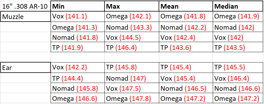

In case anyone is interested, I was playing around with Suppressed Nation's data a bit, here is a table that lists the cans in the video from quietest to loudest based on four different values: Minimum in the set, Maximum in the set, Mean and Median.
There is not a whole lot of significant difference between any of them, but it's something to look at I suppose.
The median and the average aren't really meaningful because there isn't enough data. 5 shots really isn't telling the story. Some cans start off loud and get quite after a few shots. Some start quiet and then get loud after a few shots (like the VOX did). Some stay pretty consistent. 5 shot averages and medians blurs this. It isn't captured. 10 shots would probably capture it since the 2-3 shots for the can to settle down wouldn't dominate the average or the median.
Mean and median usually can't stand alone and are most useful in conjunction with the data set, this situation is no different. Don't use them if you don't want to.
I find it interesting that at the extremes the omega is the quietest at the muzzle and the loudest at the ear and the inverse with the trash panda. Then the nomad and the Cox are the same swap situation but in the middle.
I’m guessing that is indicative of how much back pressure they make? Higher backpressure is loud at the ejection port. I wish a thunderbeast has been in there just for more data.

The ear numbers on a semi-auto don't tell you which can would be quietest at the ear on a bolt gun. The muzzle numbers in that test aren't useless because they give you an idea of which can is going to be quietest at your ear on a bolt gun. I understand all about Mil-Specs and why the muzzle test is done the way it is, but bolt gun use is why I care about both the muzzle numbers and the ear numbers in that particular video. No conspiracy or narrative, just a little bit of logic.
Wouldnt you need to meter at the ear on a boltgun to know which is quieter at the ear on a boltgun? Cant be that easy can it?
Or are we guessing again and pretending to science...
Metering at the ear on a bolt gun would have been nice, but they didn't, so we don't have those numbers in a valid direct comparison do we?

Ear numbers on bolt guns are almost directly proportional to muzzle numbers. Check out thunder Beasts videos on it. Beyond a certain point, ear numbers on semi autos are also dependent, ie 150+ at the muzzle will always be 150+ at the ear.
Reactions: Potss and Gtscotty
Of course there are lots of variables at play, that's why Suppressed Nation did that testing with the same ammo, host, on the same day to minimize variance.
Your theories based on your reading seem to be directly contradicted by the results of that test. Which one are we going to accept as valid?
Illuminate me, where is the contradiction between what I said about at ear SPL on a bolt gun, and what you saw at ear with the AR-10 in the video. You do realize the difference between what's going on at the ear with a DI auto vs a bolt gun right?
What is that ‘certain point’ where ear and muzzle numbers are equal on a semi auto?
Is that ‘certain point’ barrel length or action type specific? Or better yet applicable to this discussion and occuring in the band of possible results of an average suppressed rifle?
On a bolt gun they are proportional. Muzzle and ear. Not disagreeing there.
I am disagreeing that the results of one metering session of 5 rnds on a random semi auto will tell us how a random bolt gun would meter at the ear if it was used instead.

I found the test results I was remembering:
Some had a bigger spread between the muzzle and ear than others, and the Omega was actually louder at the ear...?
The Omega is the only one on there that's louder at the ear than the muzzle. If I had to venture a guess, I'd say they probably metered it with the brake end cap in place, which increased the sound level at the shooters ear. The 7.13" length they list would seem to support the brake being attached, I believe it's shorter than that with the flat end cap.
It is, the Omega is ~6in with the flat cap.
Also, muzzle is almost directly proportional to ear on bolt guns.
And the above testing chart data, keep in mind certain designs perform differently with various pressures as well. .300blk subs are very low pressure, so results in the chart may change when stepping up to 5.56, .308, 6.5CM, etc.
