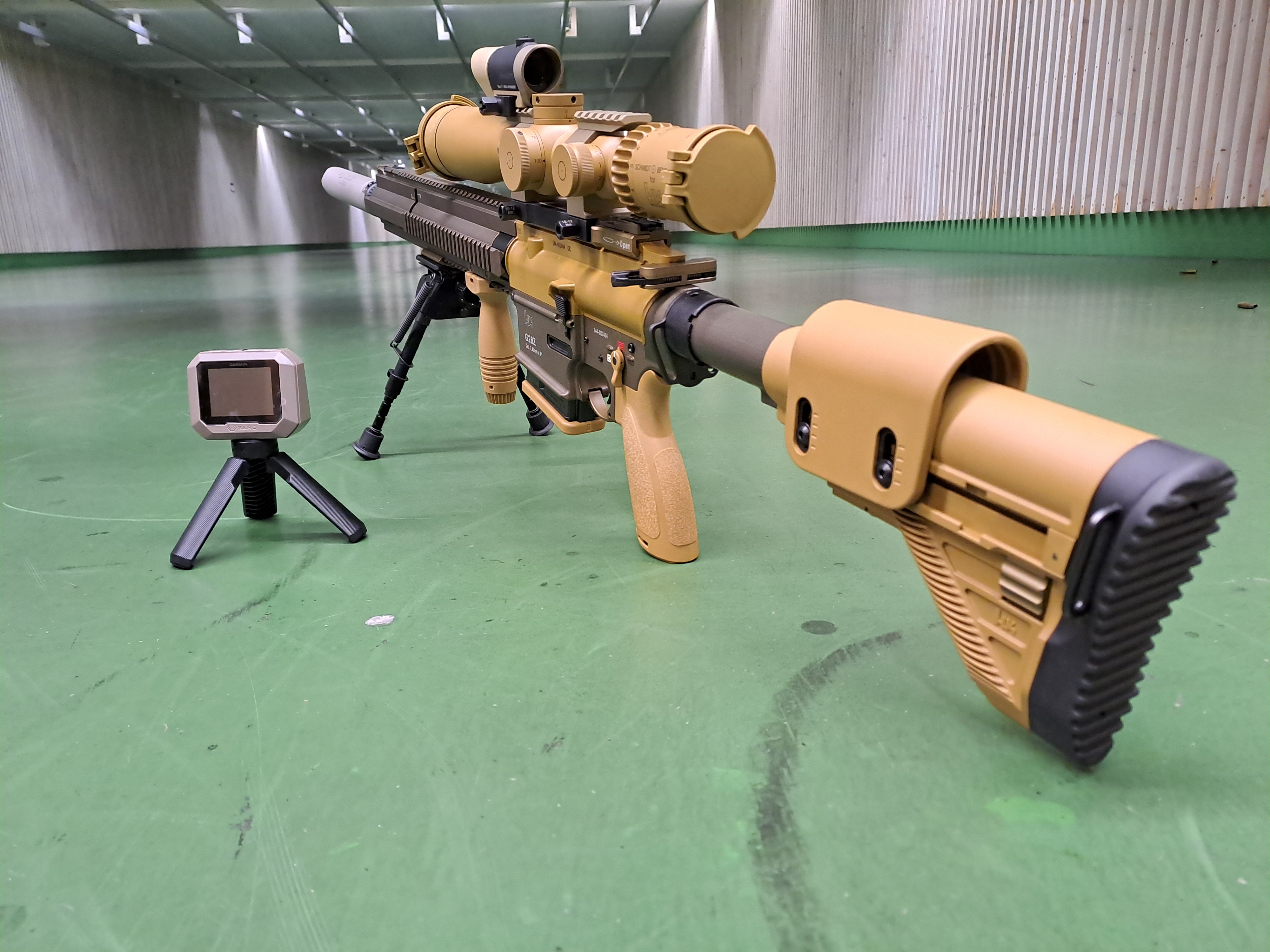

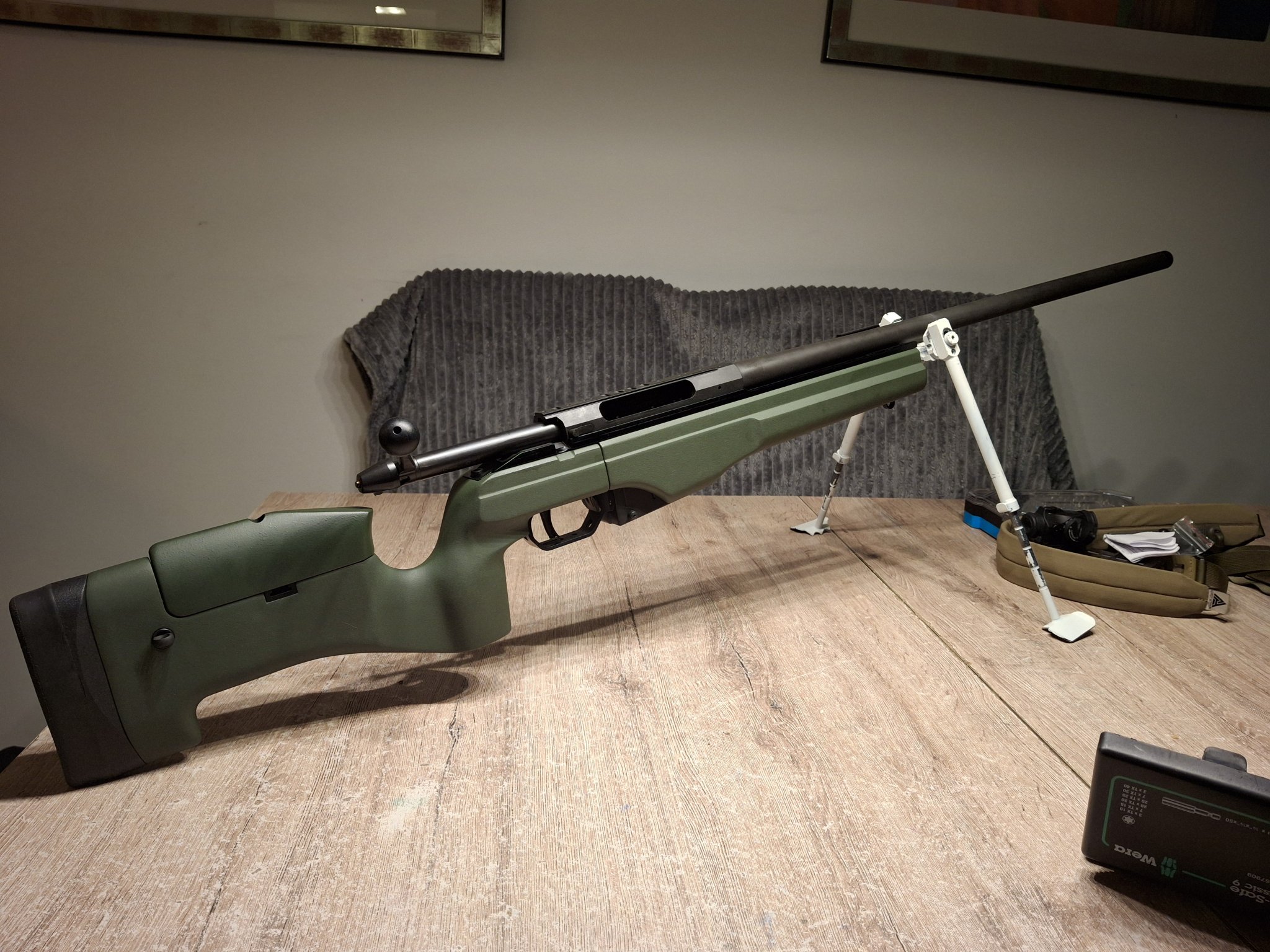

Brand New TRG 42 338LM. Still waiting for the bipod, longer backbone with ITRS and a 5-25x56 PMII with MSR2 reticle.

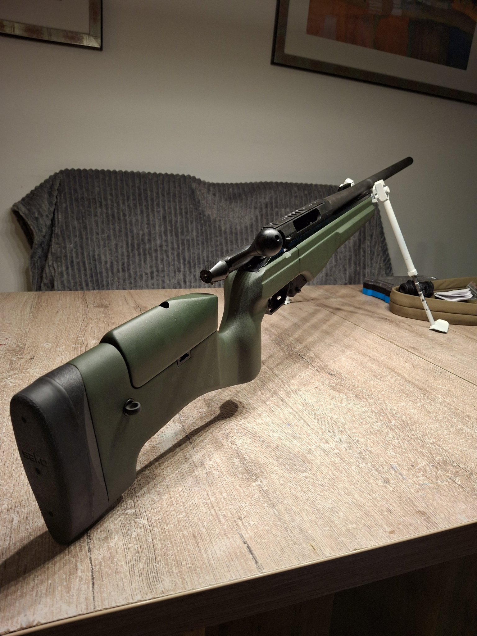

New Snipers Hide forum enthusiast and TRG owner. Absolutely in love with this rifle, haven't had this much excitement in a long while.
Questions- I've searched high and low and seen conflicting information. Am I crazy in thinking there's no way the Tikka CTR mags *don't* fit the A1? Even if I had to trim some plastic from the base plate? Or have they gone and made them just different enough to not fit?
Beyond that, I guess this is also a WTB for .308 TRG 22A1 mags. Eager to learn more!

Tikka first CTR versions originally came factory with Sako TRG-22 mags. The business end is the same.

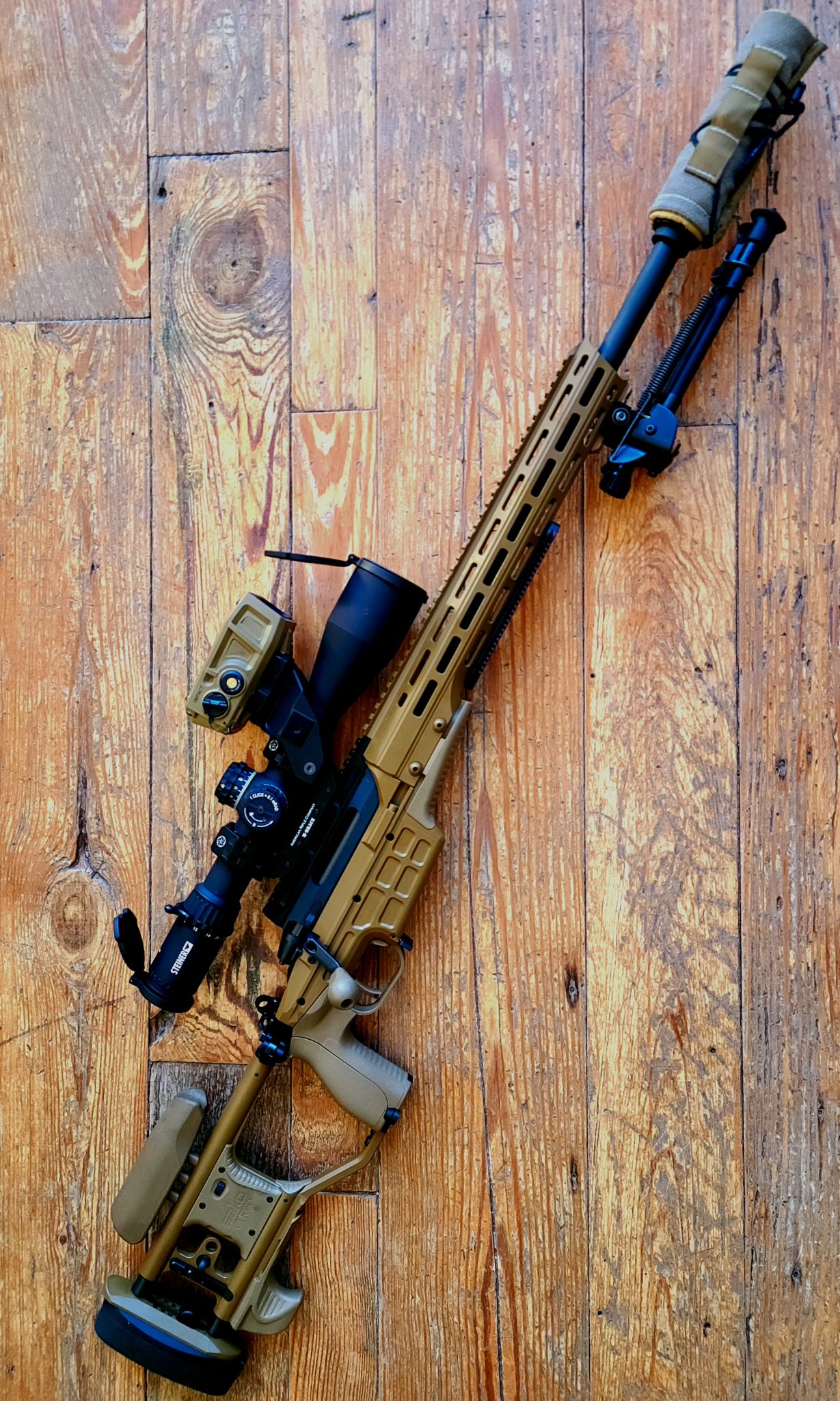

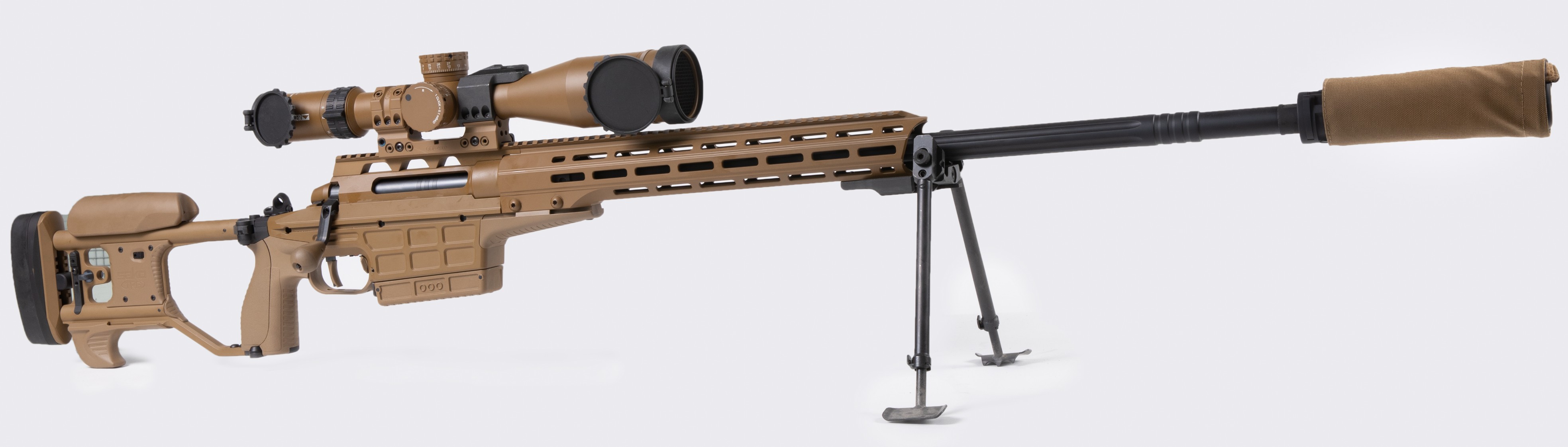

Sometimes I regret not getting the Tan. Very nice rifle

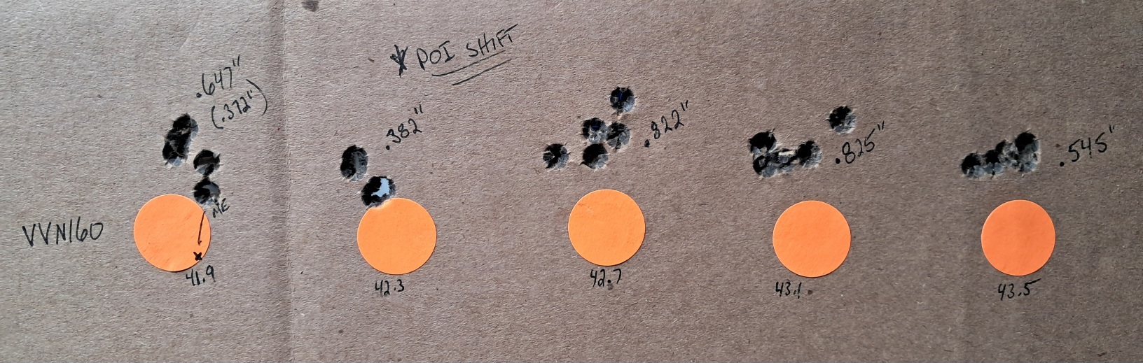

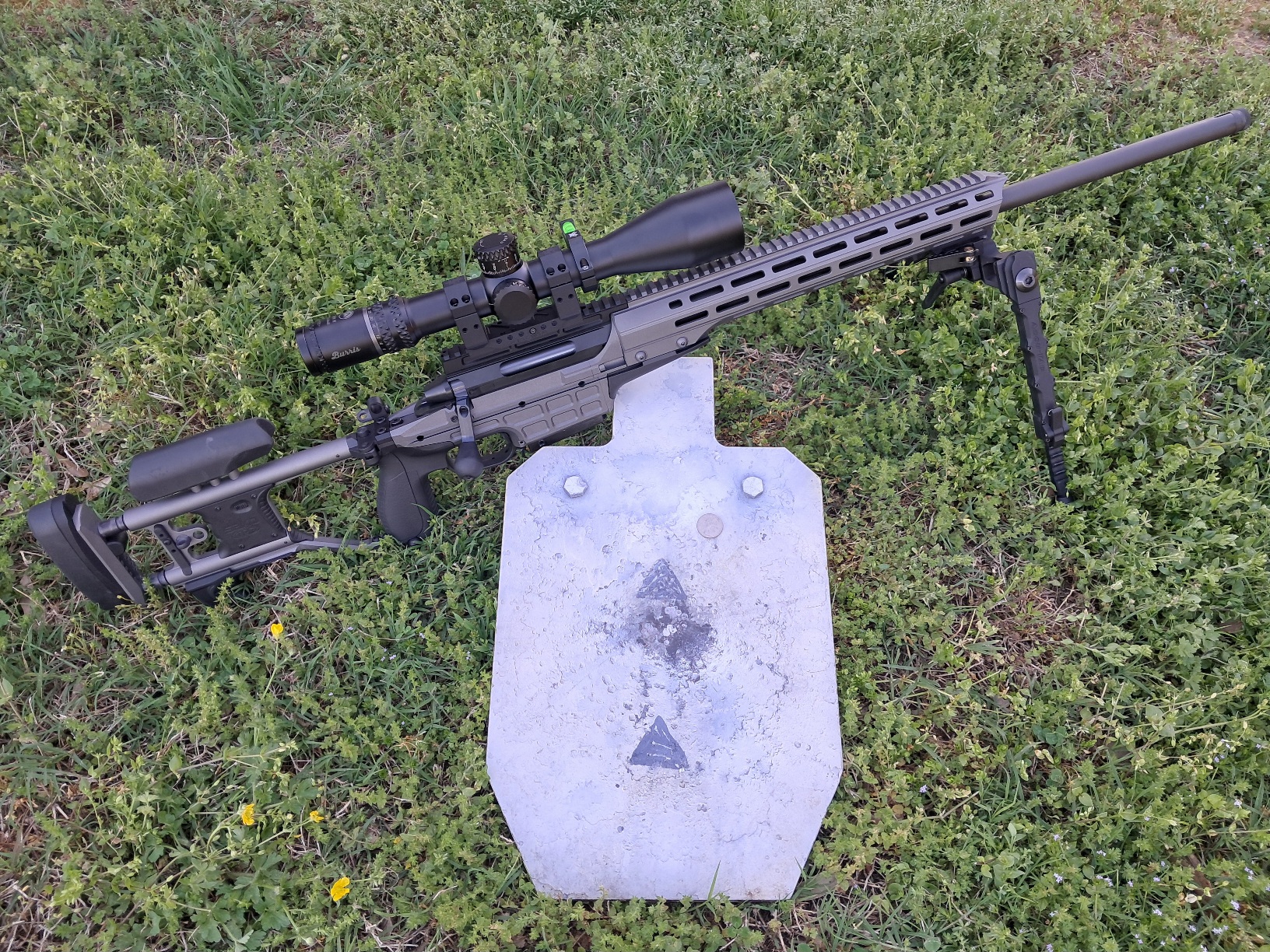

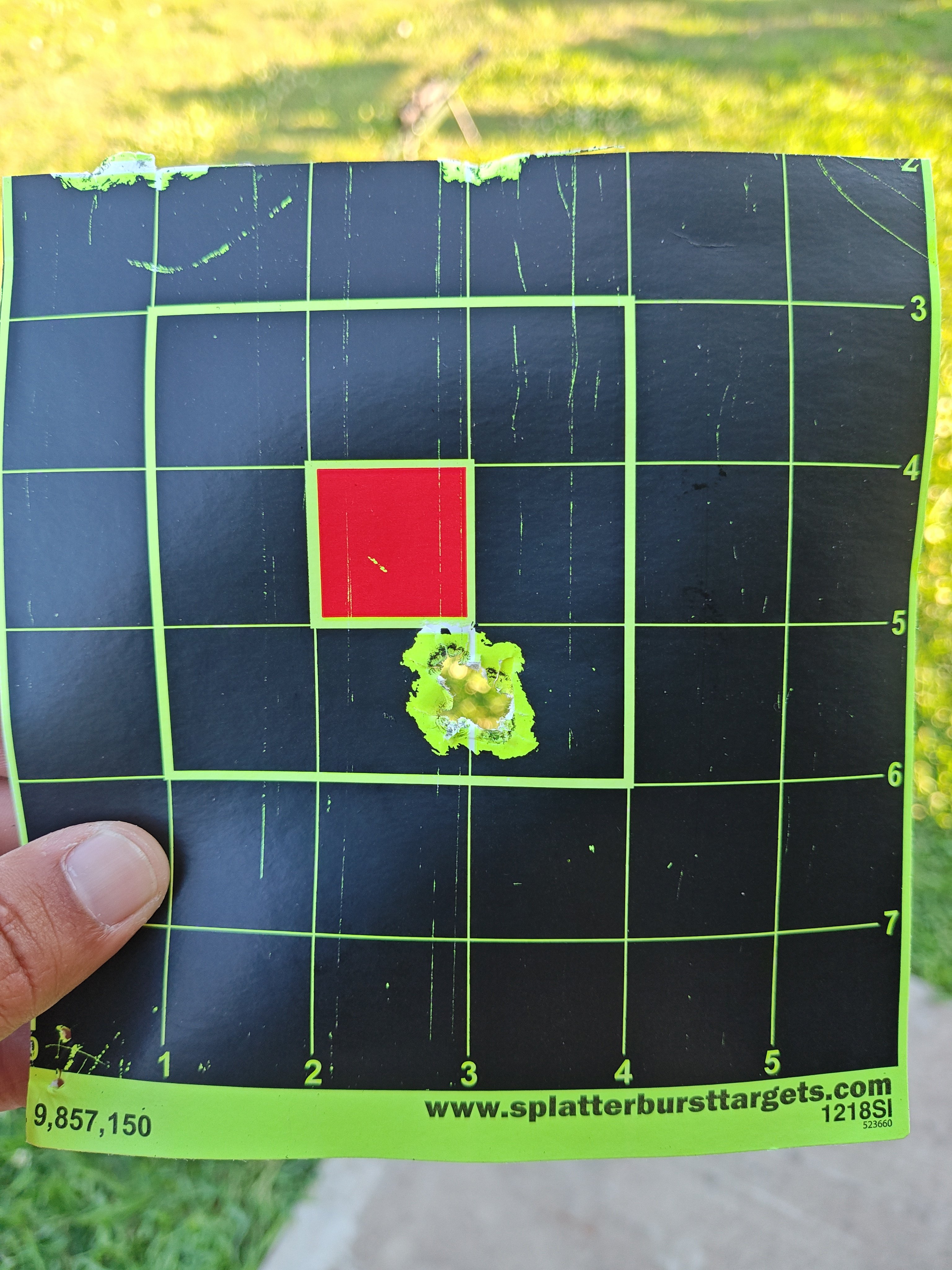

First attempt at load development on my 22 A1 between rain storms today. My rifle showed a decent liking to the factory Hornady 130gr ELD-M (.260 Rem), so I just copied the seating depth and ran a mid range charge of N160.
Barrel has 65 rounds on it now, so we're just getting started. I've also got a ton of .264 projos around from my 6.5CM and 6.5x47L builds.
Managed to chunk a shot on my very first group too. It happens and it counts, but where the cross hairs were when the shot broke should put that low right one in with the others.
Also had some guests come and watch me shoot the entire 25 rounds. They were directly behind my berm at about 280 yards.

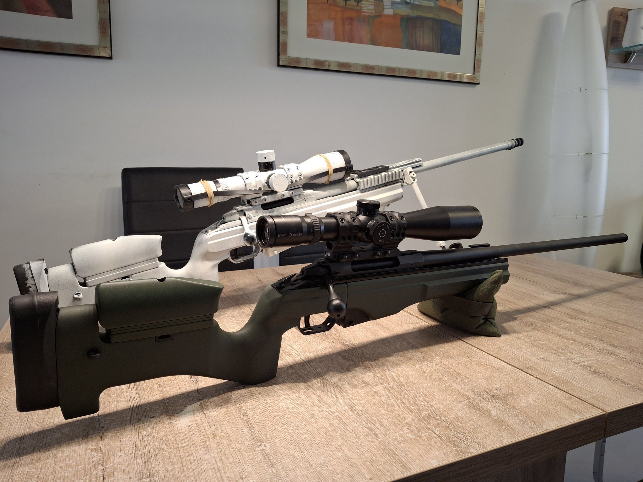

So i decided to stay classic with my classic TRGs. Would have the option of a PMII 5-25x56 with MSR2 reticle. Right now there is a PMII 4-16x50 mounted on the 338. The 308 has the 3-12x50. Might lower the mount on the 338 but went for the higher one initially since i ordered the longer backbone with ITRS rail for thermals. Will decide when the ITRS arrives so i can check how much height i need.

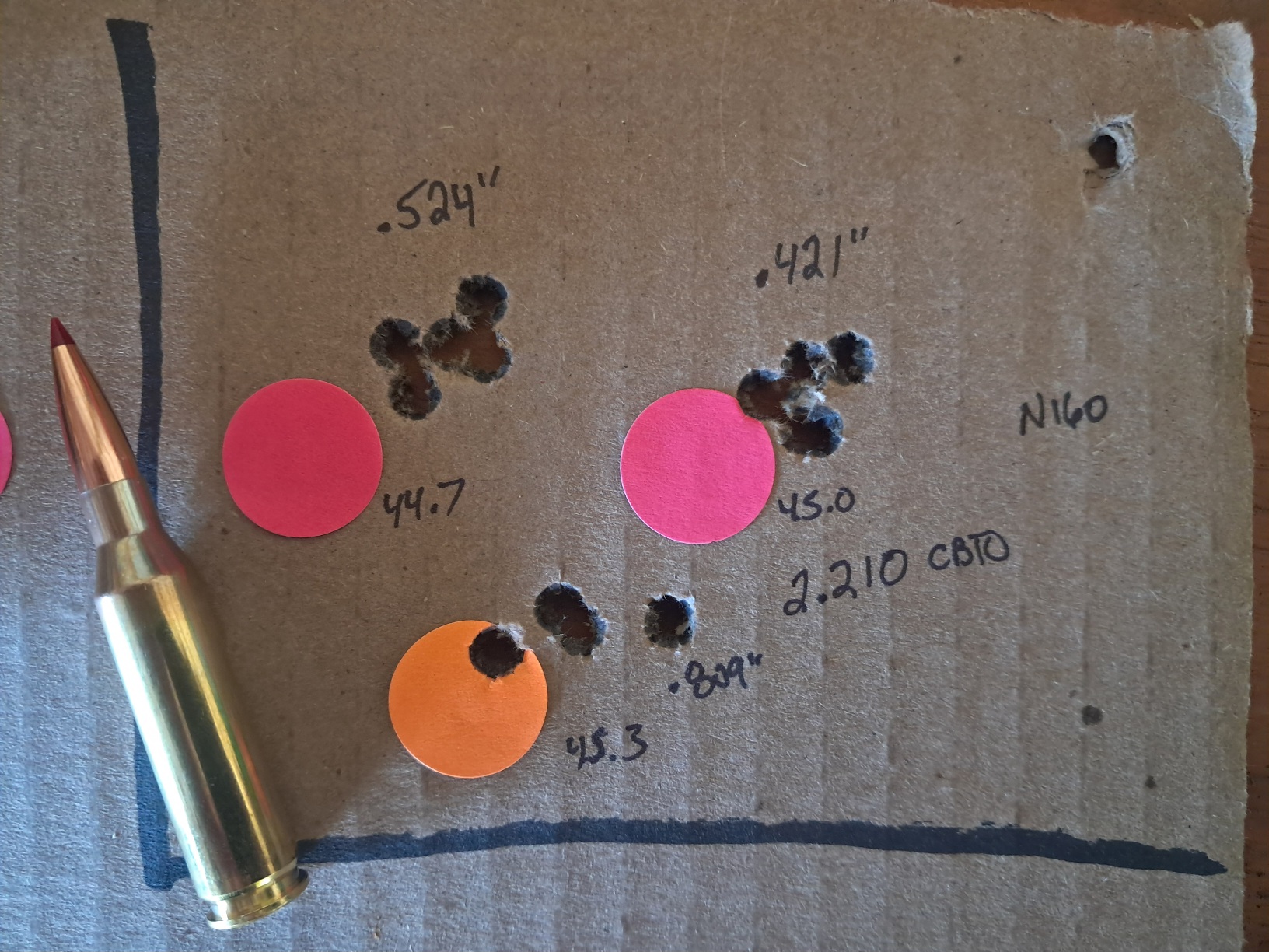

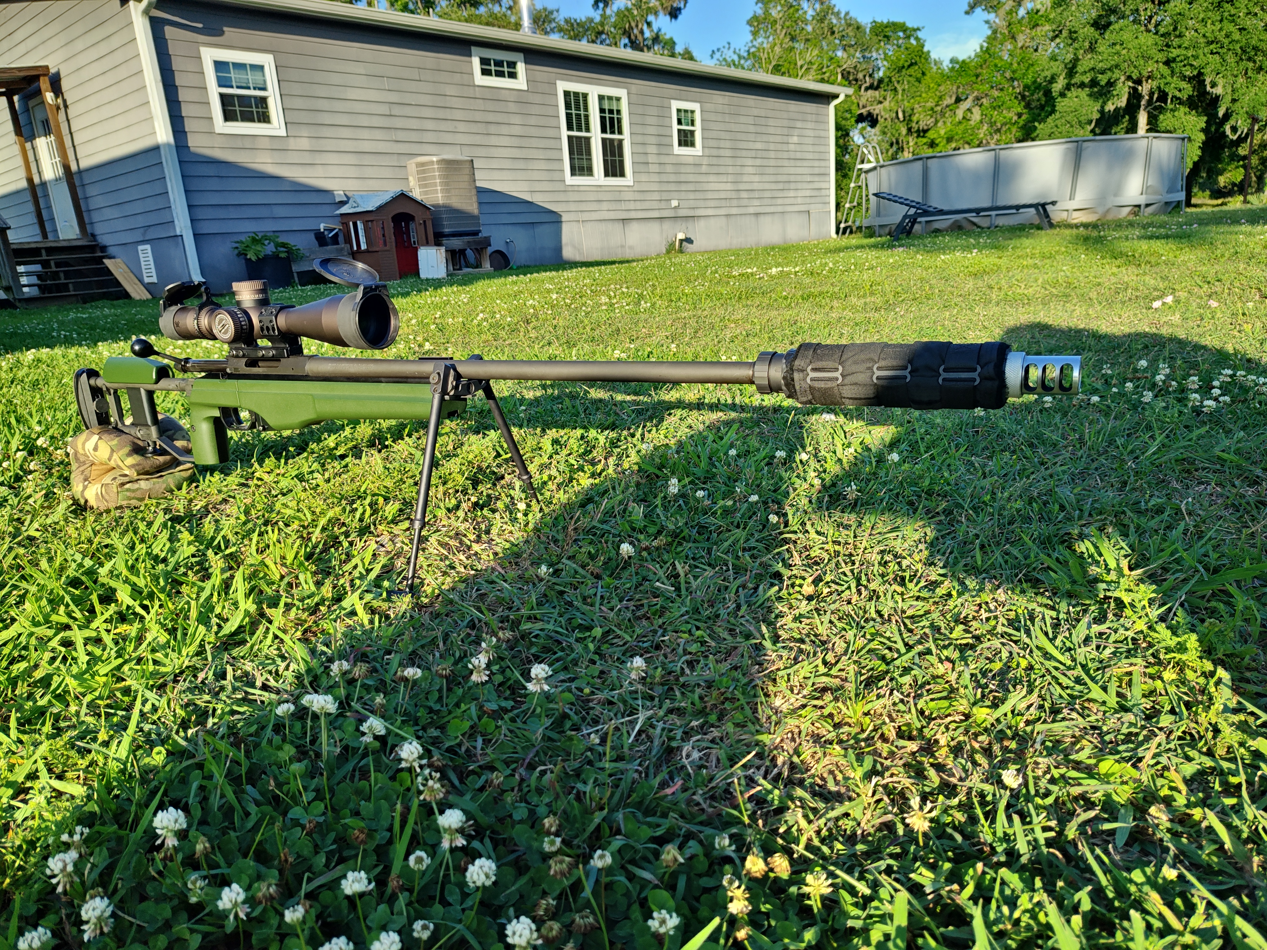

Farted around for just a few minutes today between fence, gutters, and tree trimming chores. Rifle is my new 22A1 in .260.
Went from 44.4 - 45.3 of N160 in just .3gr increments as published data is more scarce, and I want to ease into pressure signs rather than go full-send, redneck style.
Looks like 44.7 - 45.0 has a bit of a window where accuracy is acceptable (so far). I loaded 10 more up at 44.8 to shoot at 300 to see if the results will be repeatable the next time the weather is nice.
Both 44.4 and 45.3 had horizontal stringing.
