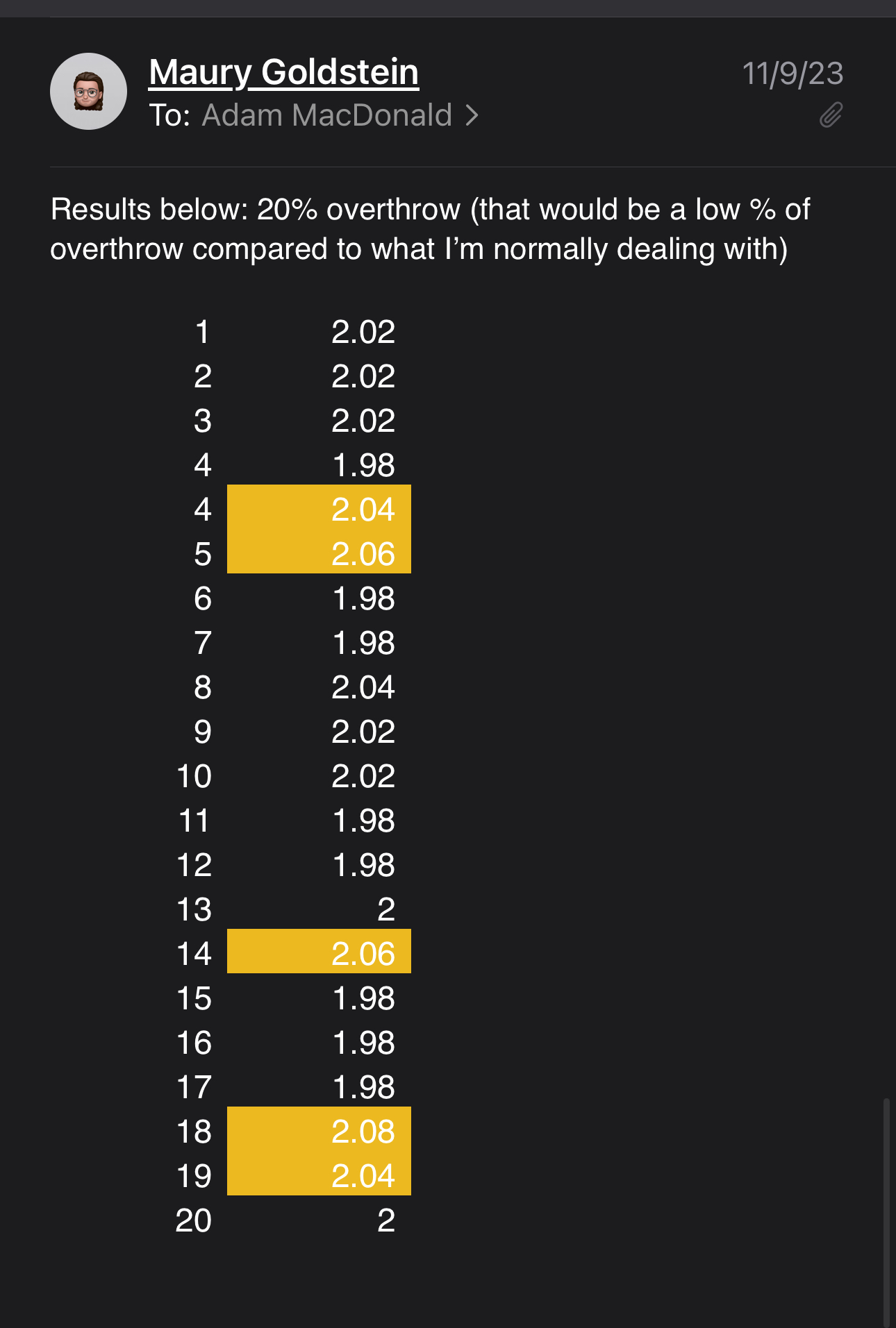

My v4 was 25-30% overthrow on the slowest settings after calibrating everytime. And talking to Adam 6 times. Because I know you’ll not believe - see email with 20% overthrow using only the trickler tube only. H4350 in this and tried h1000 (some of the most common powders used)
V3 + IP is 2-5%overthrow and faster than the V4 ever considered going (maybe 7-10 seconds avg). Cannot rec enough

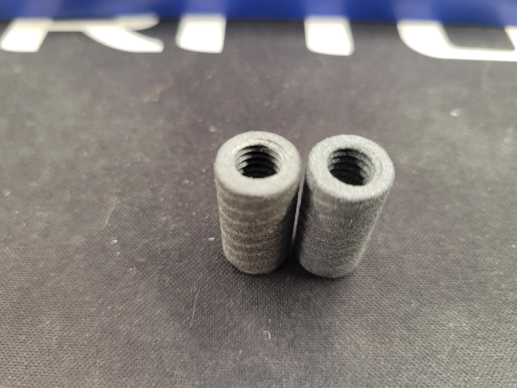

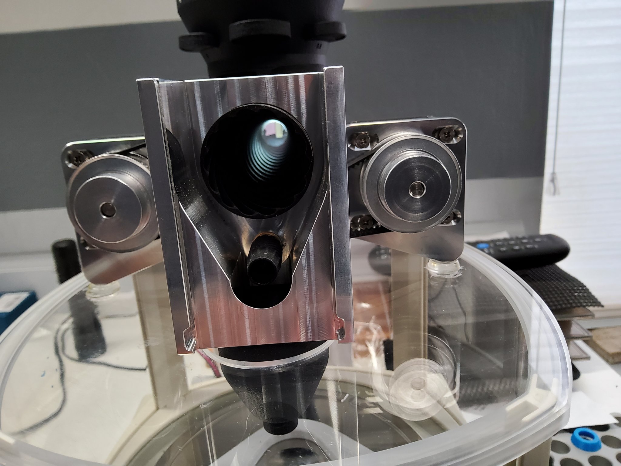

I am also running a beta test set up in colaboration with MK Machining. Better shim system and threaded tips for small tube which reduce (almost eliminate) the column stacking in the small tube which is the primary cause for overthrows
How are those tips working out? I've been thinking of something like this. I think the tips would need to have a more coarse thread, more like rifling in a barrel and grooves that basically match the size of a kernel to separate kernels.
They are working very well. You are correct, they are coarse threads of various pitch for the type powder. We should be finalizing this fairly soon. I am not sure of a timeline for production. MK Machining is very thorough in testing.
