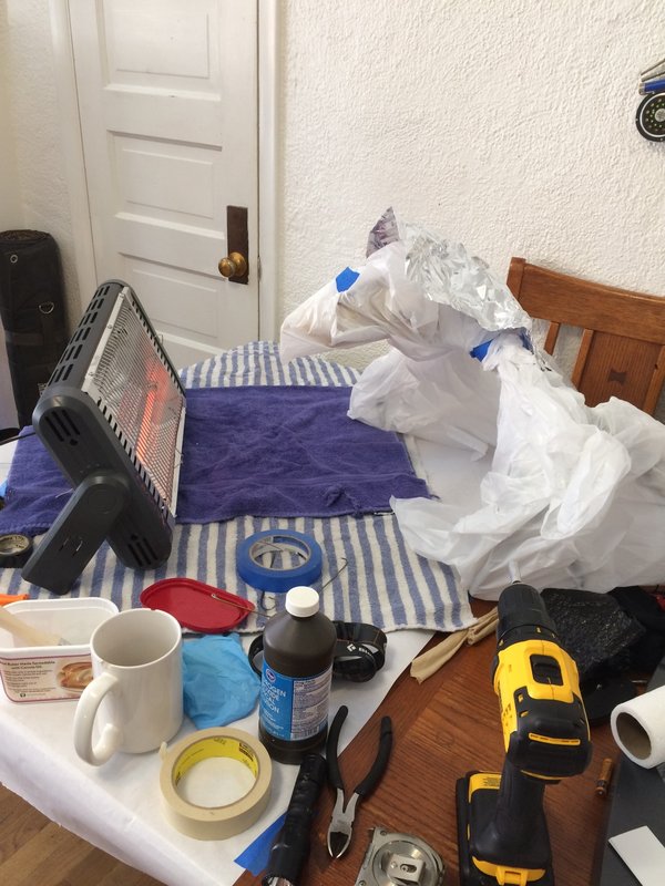

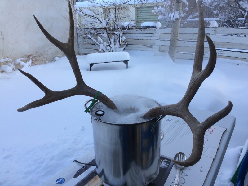

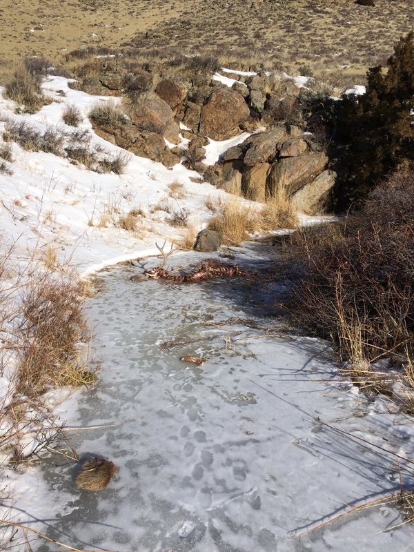

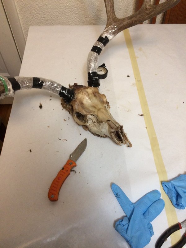

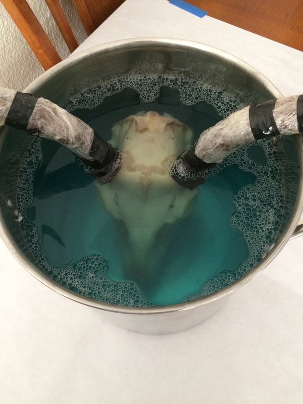

Found a dead Muley and got a tag from Wyo Game & Fish to keep the head. Then I bought a pan and struck out on my first boil, in sub zero temps using a hot plate. I used regular household peroxide and heat for the final bleaching. I didn't go super white. I wanted a more natural patina. I then bought a Herron Outdoors Next Generation Skull Mount which is the bomb! The process was easy and I won't hesitate to do it again. My antelope buck head has been at my buddy's beetle place for months(since oct)......fingers crossed on that.

Thanks! I was nervous going in, but after some YouTube videos, I dove in. I was lucky it had been cold, so there was no stench at all. And I can smell a mouse fart at 1000 paces.
I learned a lot. Late in the evening when the boiling was done, and I had picked most the meat off, I left it soaking in a strong solution of Dawn. I was a amazed at how must work that did by morning. The peroxide also ate away some left over organic material. the one thing I learned is that most folks on the net don't really understand how peroxide works. rather than kicking up the strength, and the time, heat is key. Household peroxide will do the job unless you want super white. You just need some heat to kick it.Its a heell of a lot safer to work with. I've date my share of hair salon workers......:cool:
The antlers were a tad grimy but I did not want to mess with them much so I used some microcrystalline Renaissance Museum wax If you don't have that stuff around for guns, Milt Sparks holsters and other projects, you need some: http://shop.brownells.com/gunsmith-t...nmwaApfS8P8HAQ
Wyoming is dusty so this summer I may seal it but we'll see.

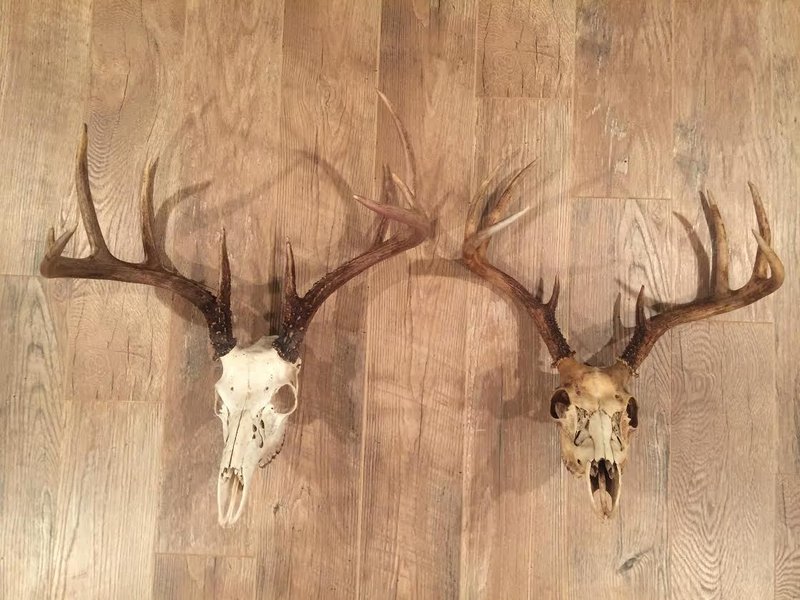

Here are some more pictures, taken outside in natural light. Left is the one buried for a year in the ground. Center is one I boiled. Right is one I brought to the taxidermist and is bleached.

I just got the one on the right back I shot this last fall I had brought to a guy that uses the beetles, and his shop was odorific too.They look about equal. His came with a plaque though. I think his nosebones and nasal cavity is a smidge better.
