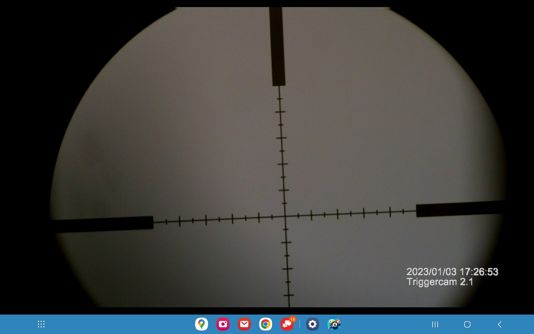

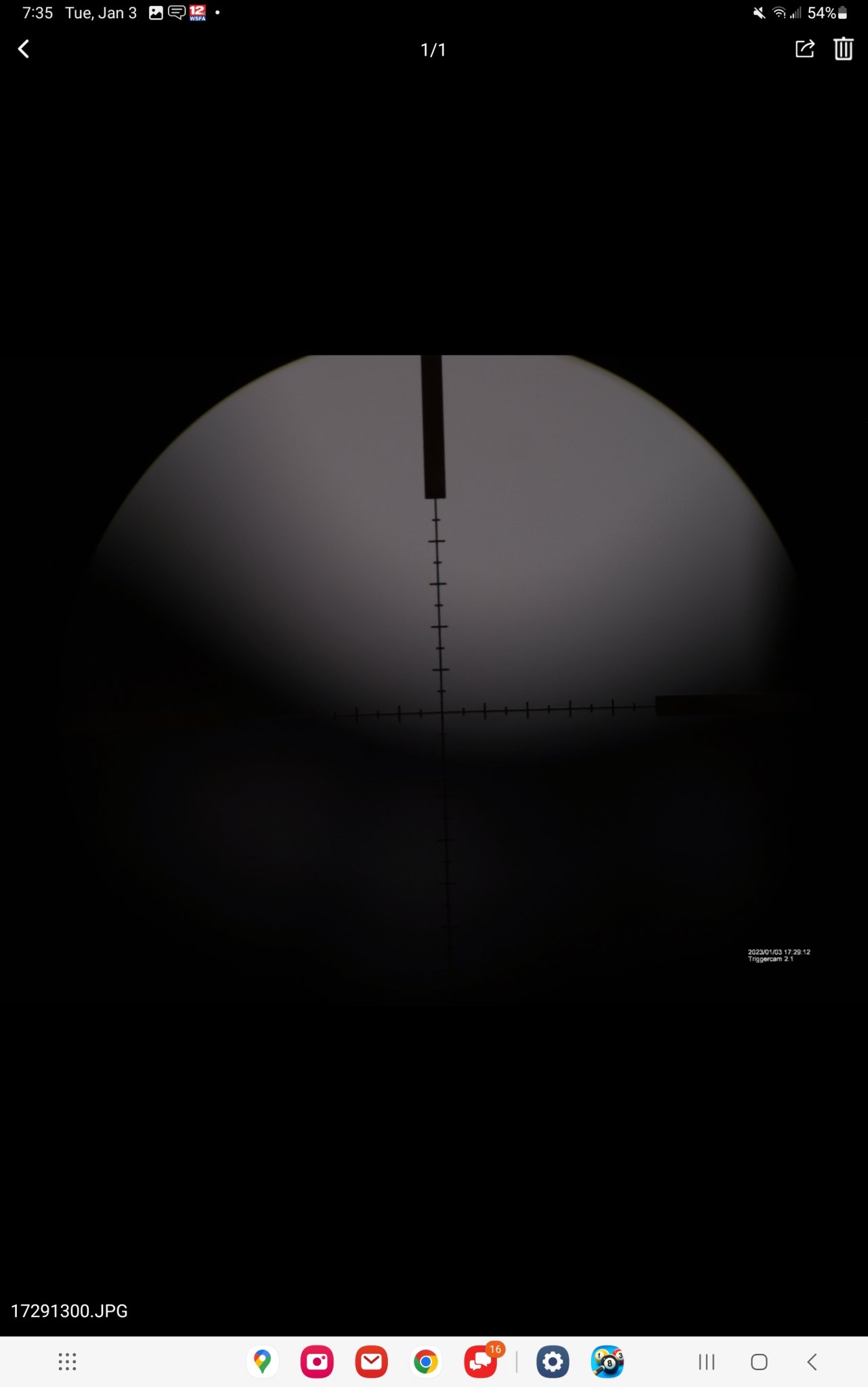

You know, I gave this thing a very good review on my channel, but I'm sorry, it's really a bad product after using it for sometime. I can't get the app to CONSISTANLY work and so I'm shooting video that ends up out of focus for some reason (no, not touching diopter or parallax) and since I can't get the app to work, I'm just guessing in the dark here. I've spent a lot of money on this thing to get my videos right, but I think folks should now look at other options.
Just tried installing my triggercam on my rifle and it would line up with the scope correctly (cocked) tried it on 3 rifles and only one would simply slide on like they say it will . I did get it to show most of the crosshairs by leaving it back off the scope . Anyone else have this problem
Have a pic? Mine couldn’t be easier to use and fits any scope the collars fit without issue
I finally reached out to TriggerCam after my battery would no longer keep a charge and they sent me one via DHL in 3 days. Andre took care of me and the new unit seems to be working fine as well as the mobile app now. Reach out to them...They will put things right.
Slid all the way up and screw tightened up
