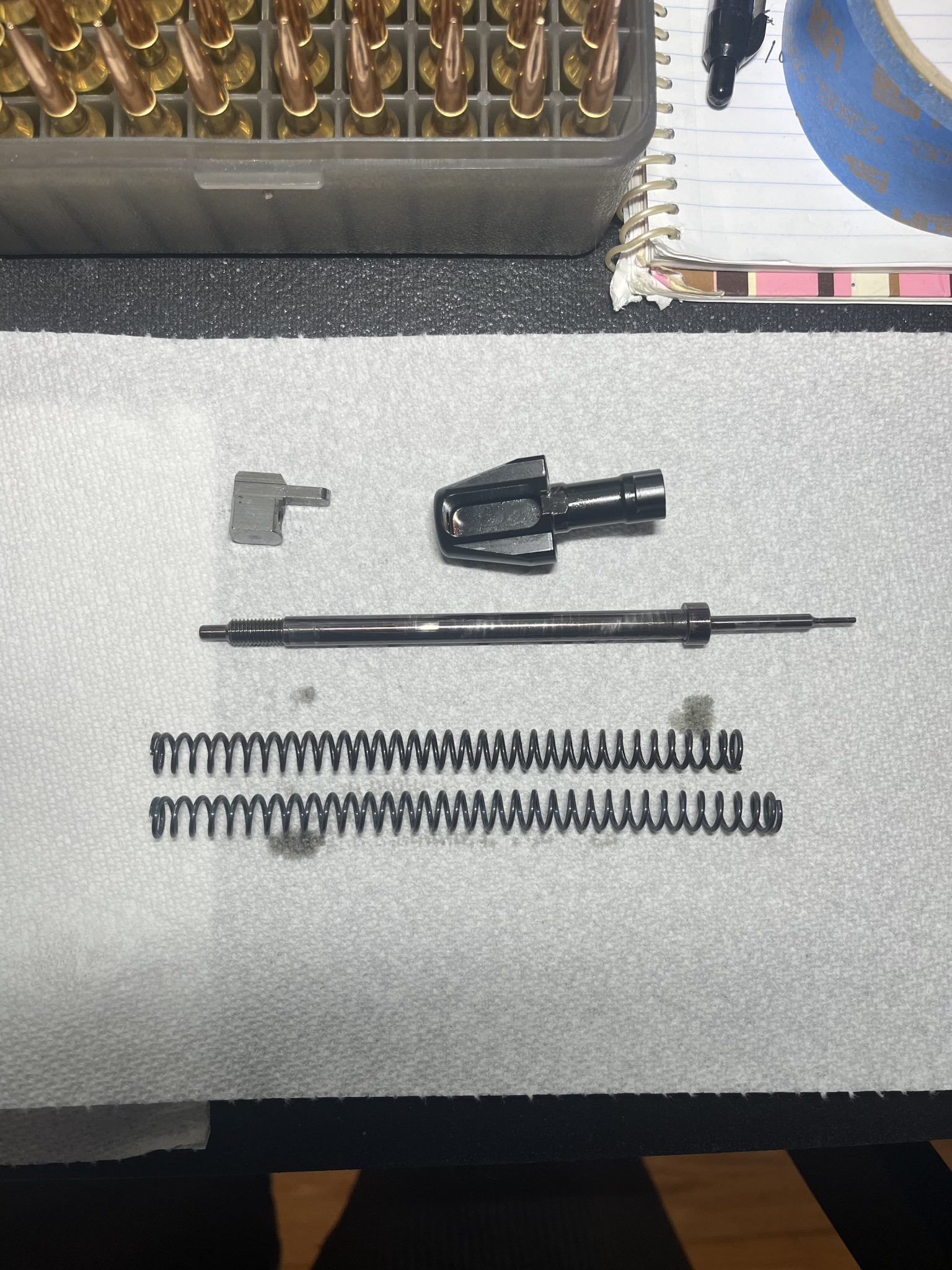

TT Diamond sneaky pull-weight increase..?
CK1.0
\m/ SLAYER \m/
Sep 2, 2020
2,840
3,403
Nashville
This is not a basher thread, love the TT Diamond... everyone should enjoy the YOLO only a top-shelf trigger can provide (be poor somewhere else).
That said... TT Diamond single-stage, ~3800rds on it. When I installed it I set it at ~8-9 ounces (via cheapo-style Wheeler trigger-pull gauge), and haven't touched it since. But, while going over my rig trying to find excuses as to why I suck at shooting more than usual lately, I discovered the pull had increased to ~15-16 ounces.
Que da fuk?
No worries, a few clicks lefty loosey, and all is right in the world again, but has anyone else heard of this..? Should I pull the sucker and blow it out? More than that? Will I eventually run out of clicks? What say you sniper Illuminati?
Yes.
And I'm not sure I've ever heard of having to do that with a TT, I guess it's possible, but I don't think TT mentions them needing that in their instructions that I didn't read.
I don't think any mfg calls that out in their instructions but alot of people who compete do this.....
Super low strength thread locker of your choice works with a needle or liquid wax or nail polish. Put a drop on the end and insert it on the thread wall on top of the set screws
Reactions: pineoak and CK1.0
It makes total sense, I think I may try that. TT says to keep the set screw "at least three clicks" tight, there's nothing in there about using thread locker... but it jives. The Diamonds go so low that I've still got plenty of clicks of engagement, so it's not that, and I figured the "click" is what kept it from walking, but I guess it can use a little help.
I'd just rather not chance to get gunk into nice trigger clockwork if it's not necessary.
More than anything I'm just curious if other guys have seen this before (while being lazy and hoping to avoid having to pull the BA to blow it out correctly, have to re-zero, etc).
  • Your triggers pull weight should not change suddenly. A sudden change in pull weight is a sign that something is not right, and your firearm may not be safe. Stop using your trigger and contact TriggerTech Support ([email protected]) 1-888-795-1485.
  • Your triggers pull weight may change slightly over the triggers lifetime as the parts wear in. Any change should be gradual and not in excess of 6oz or 15% (whichever is less). A change in excess of this is a sign that something is not right, and your firearm may not be safe. Stop using your trigger and contact TriggerTech Support ([email protected]) .
I’ve always assumed it’s just parts mating better, it was only rough high points and now they’ve worn in a smidge and it’s contacting more surface area and thus dragging more.
I’ve never put a guage on mine but I feel have noticed something similar. They feel heavier later. Probably are.
I have had a timney get heavier during a match to the point that the bolt lift also got heavier. have you noticed a change in your bolt lift? If so I would give TT a call and let the check out the trigger. (Timney sent me a new trigger) That said I do use clear nail polish on my set screws for a low strength loctite. Other wise I would reset and test it.
Now that you mention it... I said "dang this shit is smooth" to myself the first few times I cocked it and dry-fired after resetting it to where I had it. This is with an Origin (with the same ~3800rds on it) which has always had a bolt-lift as nice or nicer than anything else, but yep, it got a bit lighter/better after the adjustment for sure, I noticed it.
I'm going to give them a call Monday and get their thoughts...
Yeah, I would give them a call.
FWIW, to update the thread, I talked to Triggertech and they said the trigger getting heavier is more than likely just due to debris having worked its way into the closed trigger housing. They told me to pull it and blow it out with brake cleaner and compressed air (which I did).
I put the rig back together and hit the range today, and voila, I can shoot groups again (printed a ~.3" 5 shot at 100, all rounds touching)!

Ok, to update the thread:
TT CS are awesome, no issues whatsoever with them providing me a new trigger, good on them all around. 👍
...and @Zermatt Arms are awesome too, Ray shipped me a fresh firing pin spring the same day he answered my email asking if it might be time for a new one (his answer: probably not a bad idea). 👍🤘
BTW/FWIW as an aside, the Origin SA never ceases to impress, I could/can afford any action out there and I'm glad I chose the Origin every time I use it, and not just "for the money". It shouldn't have been a surprise that changing the firing pin spring was a breeze and didn't require any special tools (beyond a block with a hole in it).
Honestly, I don't think the firing pin spring had anything to do with my trigger turning wonky and yielding inconsistent pulls... and I hadn't had any light strike issues at all. That said, I figured since I was putting in a brand new trigger anyway and would be re-zeroing, "freshening up" the whole fire control wasn't a bad idea. I was leaning towards saying "fuck it" and leaving the old spring in, but, what the hell...
I'd heard of guys saying that a worn-out firing pin spring could be the cause of random flyers and such and that serious F-class/Benchrest dudes would change them out regularly. But honestly, a lot of those same dudes believe and put stock in a whole list of things that I now know is BS lol... so I thought that the action would act the same, fresh spring or not.
Doh!
Yep, you can see by the length of the old spring (top) vs the new/fresh spring (bottom) that the older one had taken a set (which usually means it's lost some power). After changing it out I felt the difference right away just dry-firing... the new spring is much louder and snaps home with more authority (I can feel it through the cheek weld). Thanks to @iceng for mentioning the FPS, not sure what it'll fix, but now it's fixed.
So, will the fresh spring make a difference? IDK, I'll see I guess... but thanks to TT CS and Zermatt CS I now have to go back to not being able to blame the gun. 😜
