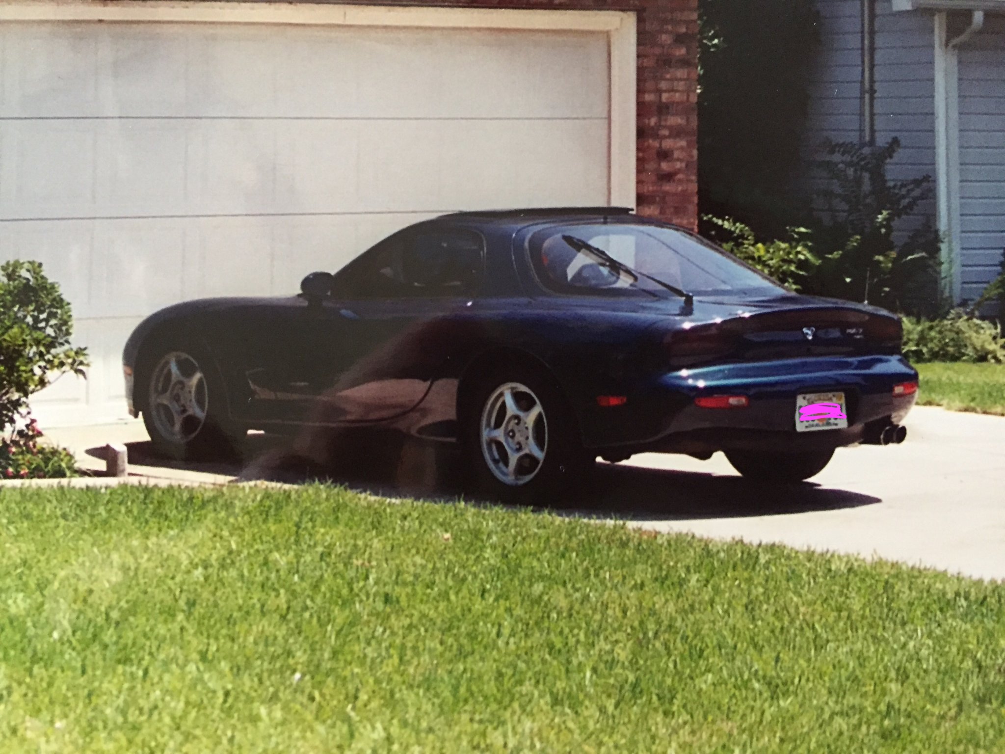

My RX7 would max out the Pyro gauges (1600 F)at anything over 12psi, I ran it as much as 20psi. Exhaust would glow red to the rear tires after "spirited" driving. I beat on that car like i stole it.
I put 70,000 extremely hard miles on that Garret GT35r, Turbine wheel ate an Apex seal and was still silky smooth as new after all that abuse.

FC or FD? I'd still consider shelling out for a 95. 13b twin would be satisfying, but a 20b triple rotor would make me smile.
04 evo MR 400/400 @ wheels was my closest attempt at that level of ear to ear grin
They are a blast, love the way they handle, but if I every get another its going to have an Aluminum LS/Lt in it. Rotary's are too expensive and finicky.

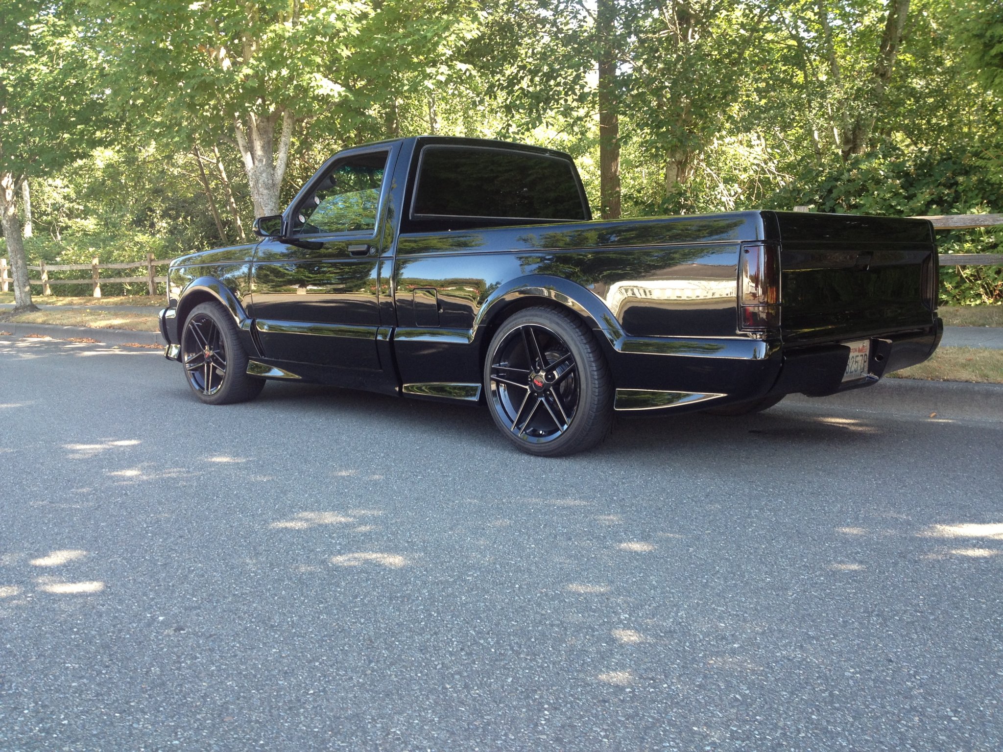

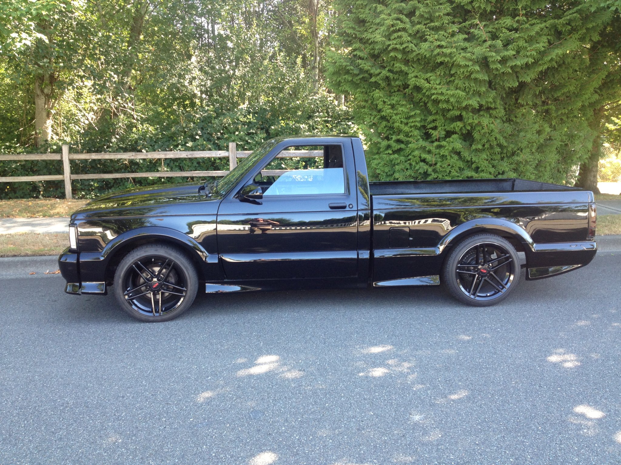

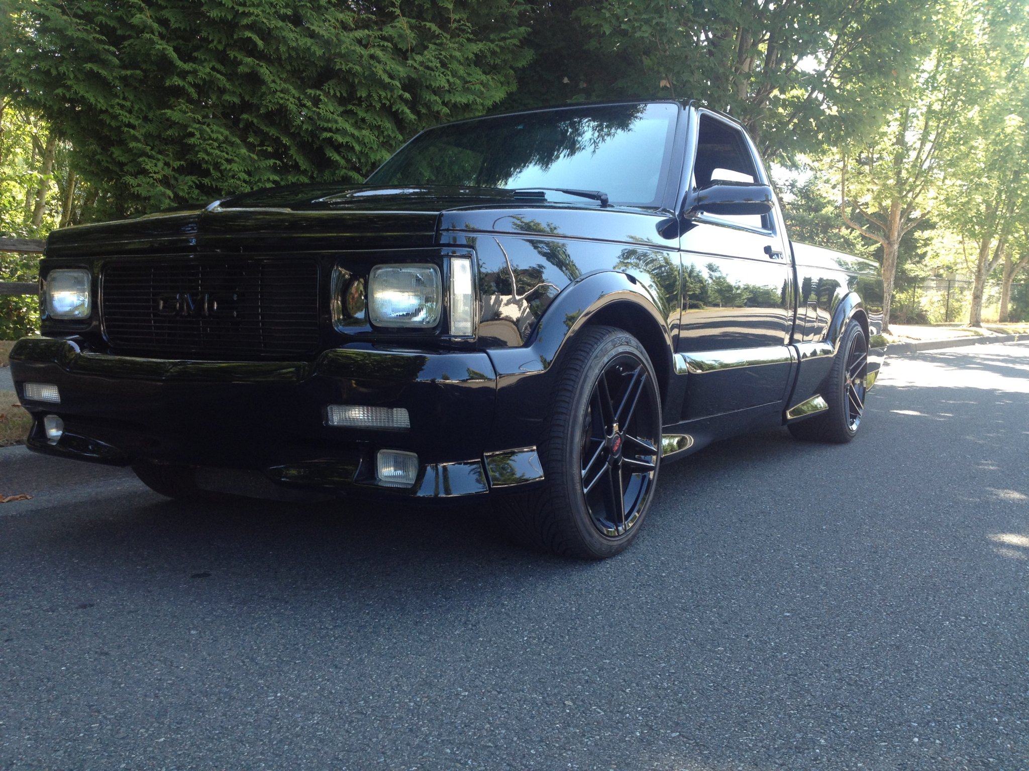

My first turbo’d vehicle. I still miss it
♥️ that thing. I'm utterly shocked it was sold. Reigning champ of fastest production truck for a great many years. Took a supercharged v8 to do it (lightning). You could buy a few AI's for what that bad boy is worth right now. But to drive it; for someone that never had/has, wow. Never would've thought of an S-10 in that way.

I was telling a coworker just last week that the 90s RX-7 has not aged a single day. It has (aesthetically speaking) stood the test of time. Still a beautiful car along with the 300ZX TT, Supra and NSX of the same vintage. All cars that I think would sell like hot cakes if on the lots today. The Japanese really had it going on in the early/mid 1990s.
