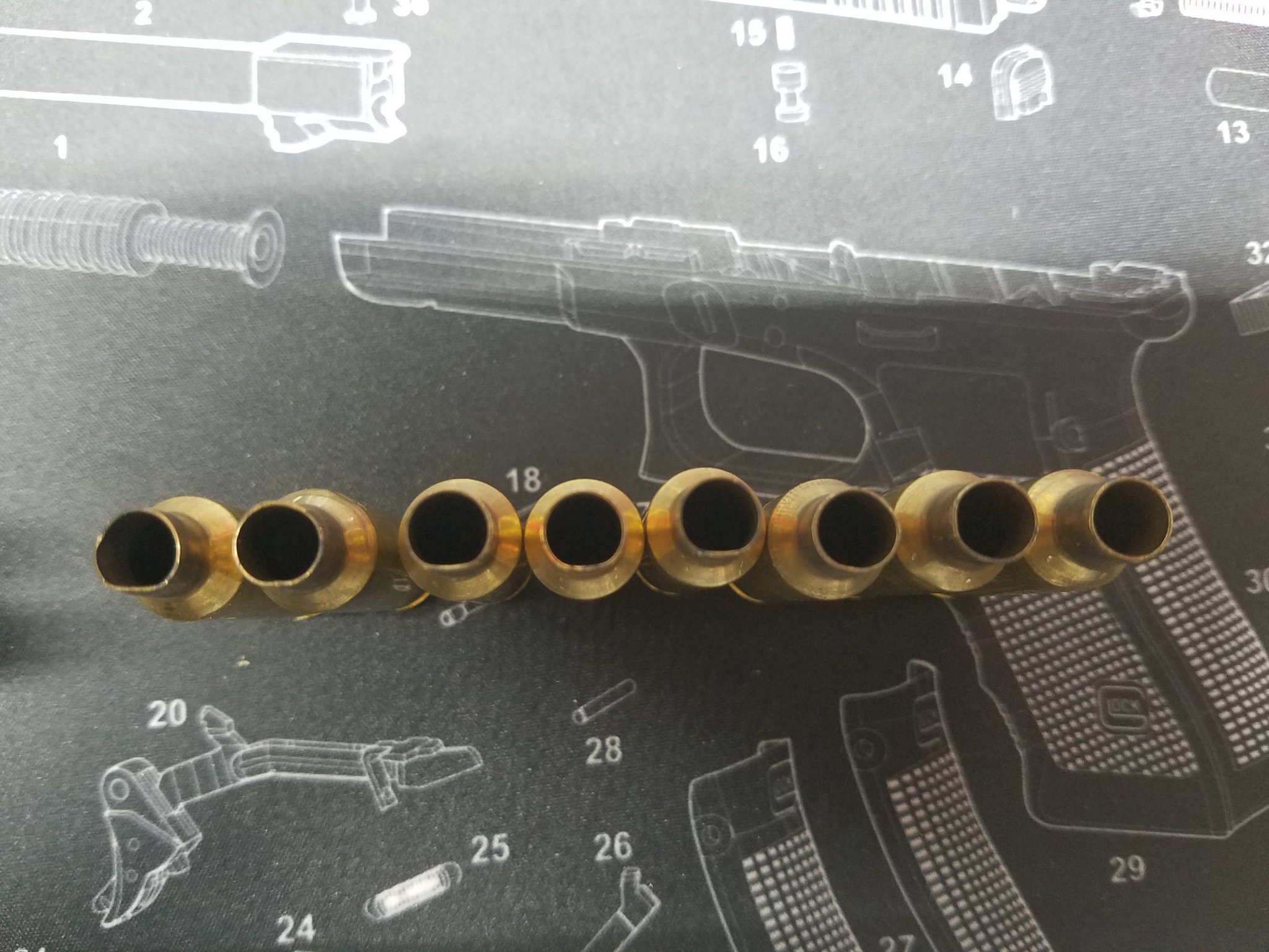

One thing I noticed when I had my gas turned way down was the case neck was denting on one side, I worked the gas pressure up and it went away once the cases were ejecting. You can see the progression as I was adjusting the block.
