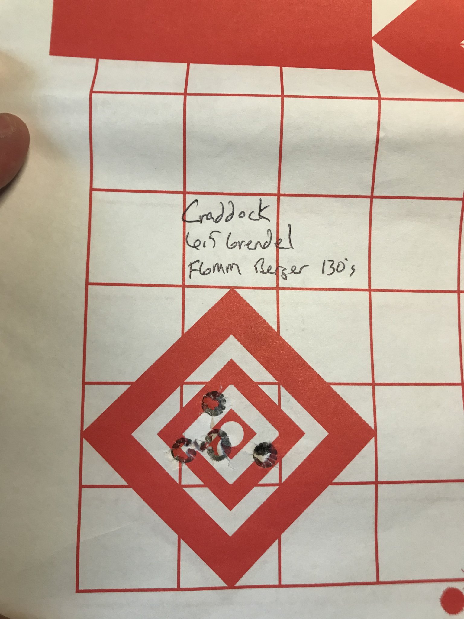

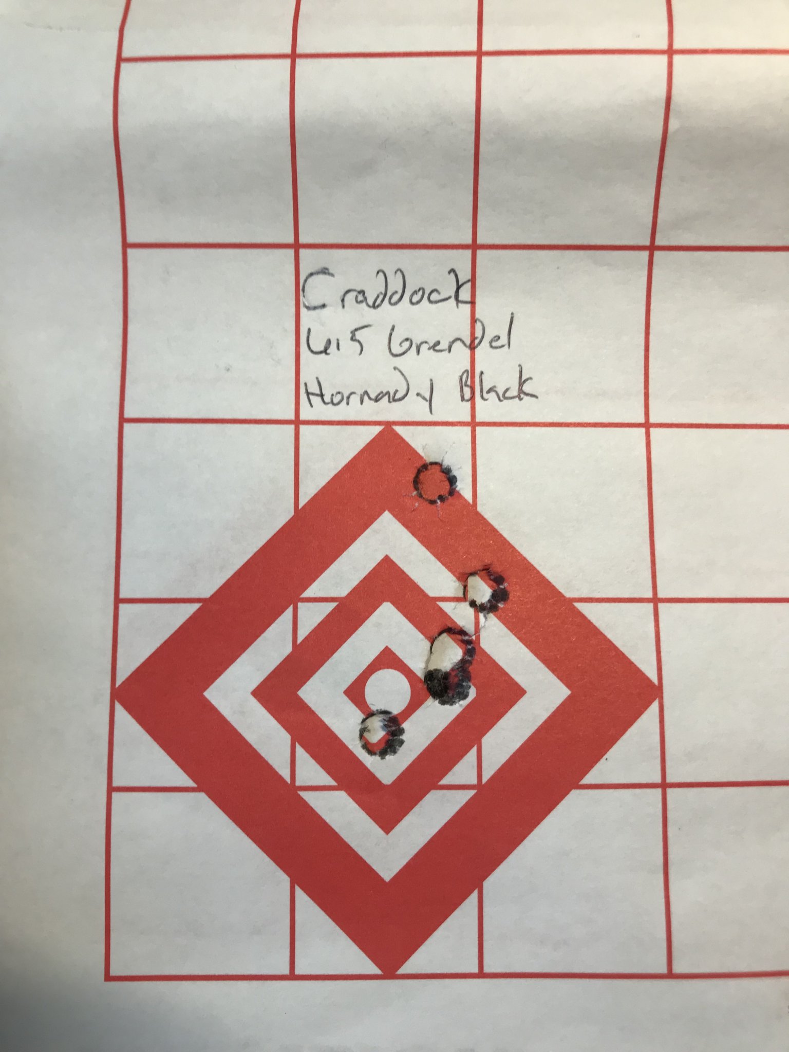

Finally got my Larue shooting. Although with a Cradfock Barrel, JP BCG, PRS stock I’m not too sure how much really is Larue.
7035277
7035278
If this is directed at my post above, Ive tried nearly all the factory offerings in both the factory barrel and the Craddock. HSM was the best and most consistent but is no longer available. The FGMM is becoming more consistent and will be my go to until I can get McCourt to spin up something else.
You can't compare the 5.56 to the Grendel even from the same manufacturer. Different animals and the Grendels tend to be much more finicky in regards to chamber specs and ammo.
The grouping in my profile picture is with my Larue Ultimate upper in 5.56. It was shot with a Vortex Viper HST 2.5-10x with Black Hills 69 gr OTM. Maybe try a different load.
The LaRue barrels seem to be hit or miss after they started making them in house. It’s rolling the dice, and they still aren’t at the level of a true match barrel even if you get one of their good ones.
