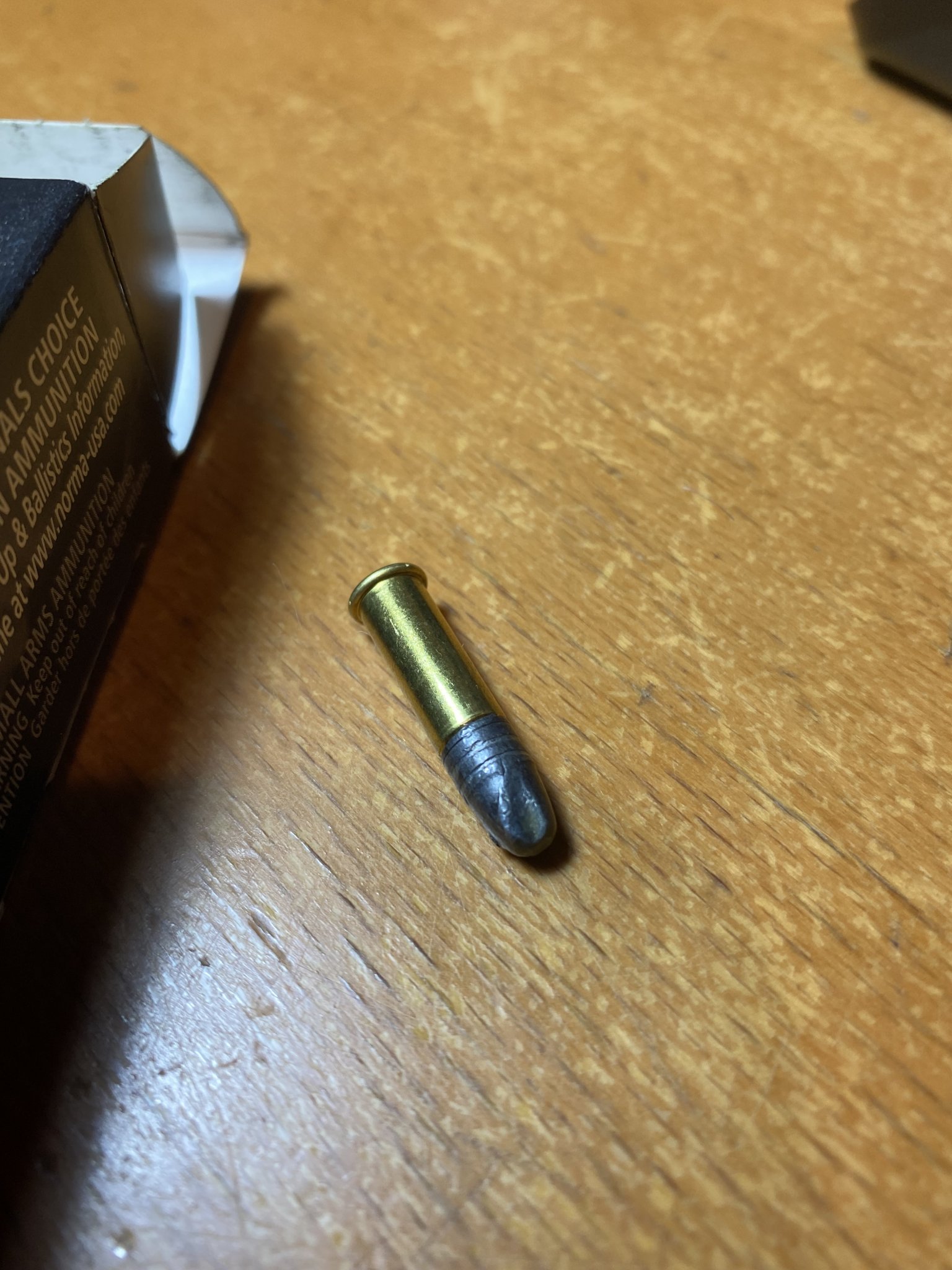

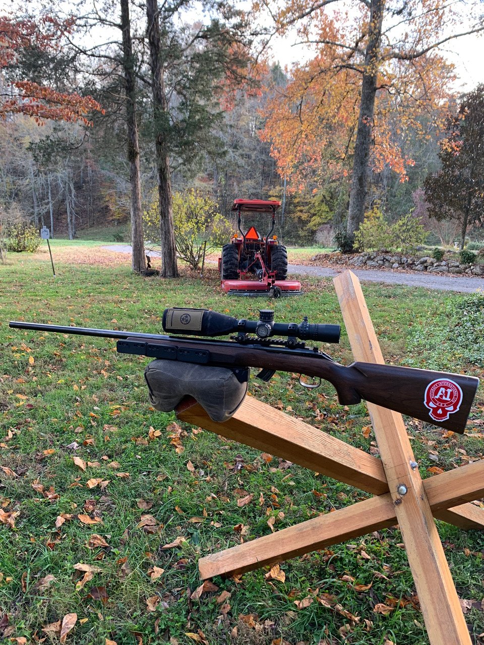

Hello, after plenty of searching for answers for ways to make shooting precision 22lr affordable, I’ve developed my “baller on a budget” process, and thought I would contribute to the community.
Gear- Bergara B14r carbon barrel in a MDT XRS chassis. 30 MOA base, 20 MOA Athlon 34 mm cantilever mount, Athlon Ares ETR 4.5 to 30x. LabRadar chronograph with remote trigger.
Process- I sort Norman tac 22 by rim thickness (of the 2k I have processed 65% measure .041”) I then take the ammo measuring at .041” and crimp to the highest available crimp with a cutting edge 22lr crimp die. ( crimping at this level has shown a 16% reduction in SD from factory crimp when compared to equivalent rim thickness)
Testing method- 25 round groups at 50 yards. 3 groups (factory crimp 14.3 sd, medium crimp 14.1 sd, heavy crimp 12 sd)
Hope this helps

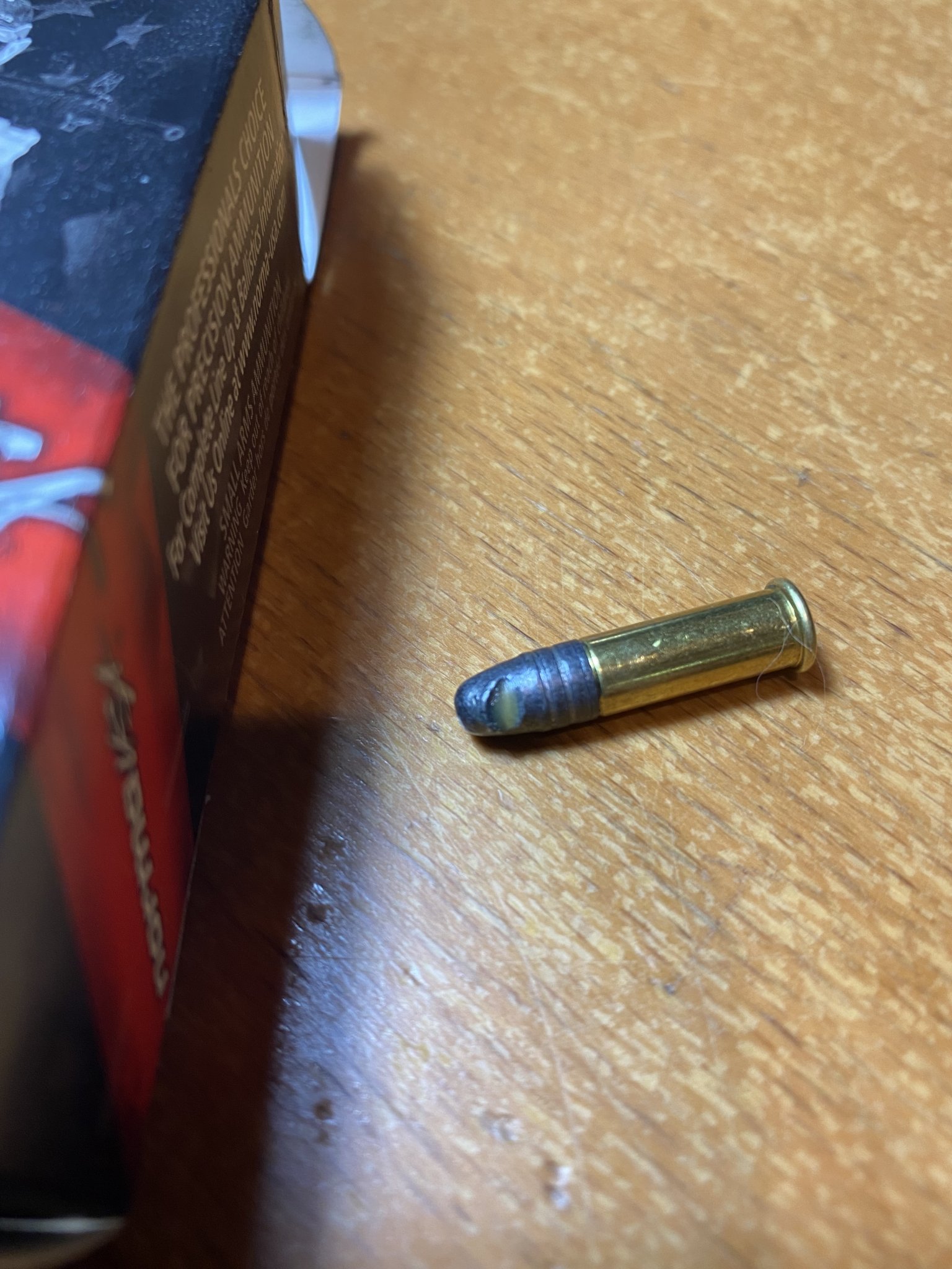

I have the Curex .22 lr 34 kit but haven't tried loading anything yet. But you are saying I can use that crimping die to upgrade my Norma ammo, right? Have you tried it on any other ammo?
The only other ammo I’ve ran through it was a couple bulk pack round (can’t remember the brand) no actual testing
I think sk standard plus is about the same price and shoots a little better than the Norma in all my rifles
I really like sk flat nose, but I tend to get some feeding issues out of the Bergara. It’s a tack driver with my daughters savage rascal

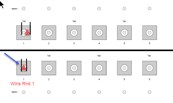

This is a pretty good test of ammo, nerves, and being able to hit what you're aiming at:
We have started doing a grouping competition where the center POA dot is printed inside a .224 circle and is counted as your first shot. This forces you to be able to hit what your are aiming at - not just to be able to hammer the same hole repeatedly. In the below example, Shooter 1 on top row puts 3 in a good group but is right of POA bull. Shooter 2 on bottom row throws exact same group but because he's closer to the bull he wins that round. Tiebreaker for the overall card is the tightest group (including the bull).
We alternate who goes first in each round (6 total rounds per card) alternating between each shot. Sighters allowed anytime, as long as you call them prior to shooting. The fun is that you can see your opponent's performance which puts ENORMOUS pressure on you as the card progresses. We bracket competitors like pro sports playoffs. Lots of fun. Heckling is encouraged. We have found that 3 shot groups keeps the match moving and makes a match not too costly on ammo. Hope this isn't off topic.

I uniform the Norma tack by pulling the ones that look like this. To be fair there aren't many.
Aside from the odd round that looks like it was chewed on, they shoot very well in my B14R.
